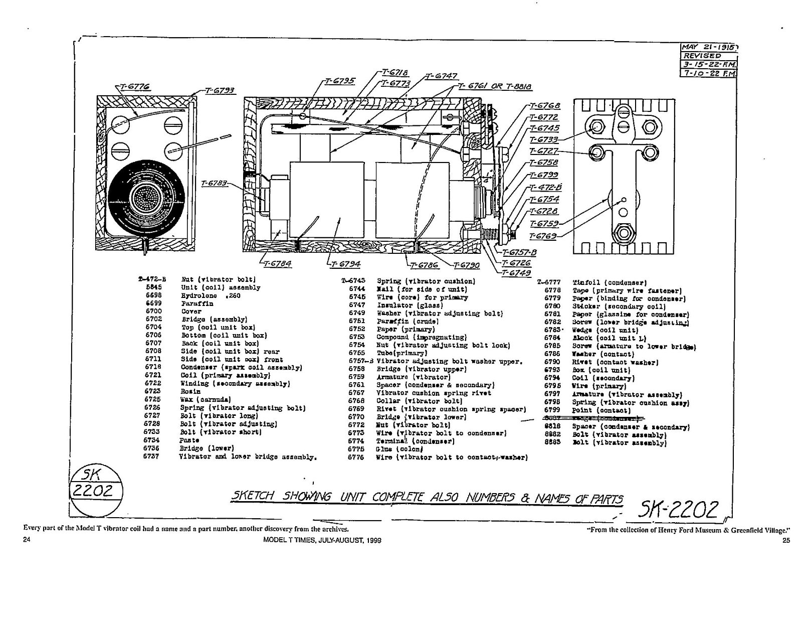

This Ford diagram depicts the details for what and where point mouning hardware should be installed on the Williams KW Ford ignition coil.
Coil Sketch SK-2202.pdf

Ron Patterson
Re: Coil hardware question
Post by Ron Patterson » Sat Apr 27, 2024 11:44 am
(1.24 MiB) Downloaded 189 times

I got this sketch out of JPG format so it is easier to print.
