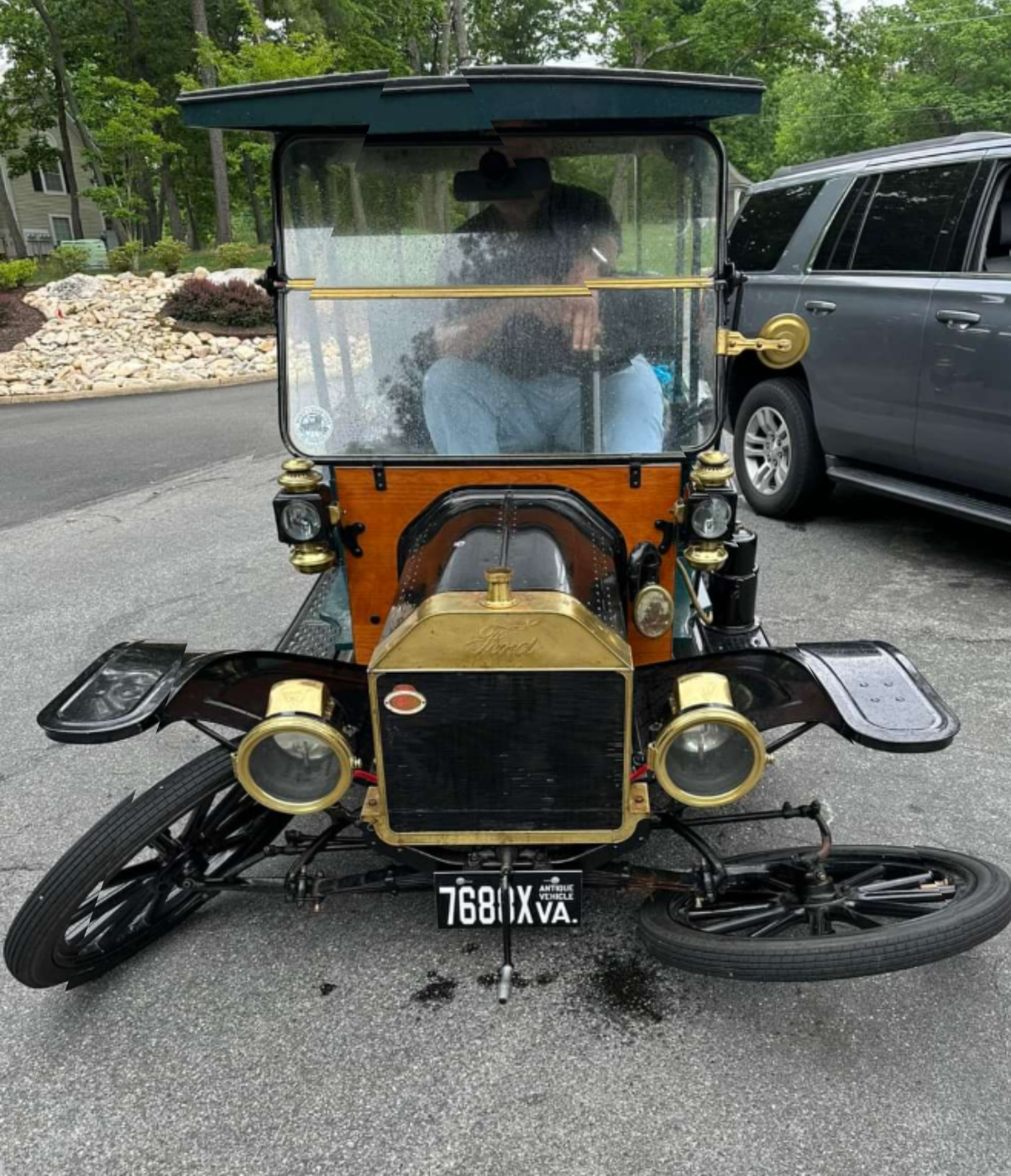

Post by Professor Fate » Mon Jun 24, 2024 8:23 am
What the heck went on here? Wow!

Mostly Photoshop BS.

Could be a wishbone failure.

And a pretty crude photoshop attempt, at that. Look closely.

Shoulda had an extra under axle wishbone.

That’s a big ole boy in the drivers seat. Thought it was me for a second ha.

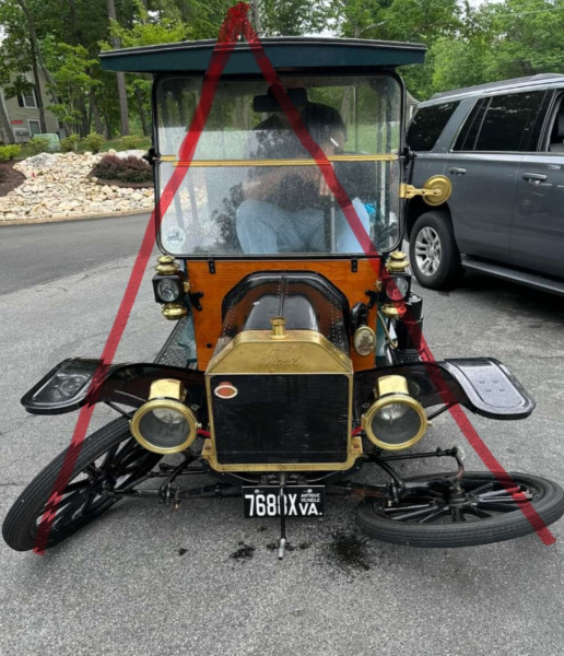

Look at the way a seam runs through the passenger side wheel, fender and windshield, angled up toward the right and a seam to the left of it that runs through the driver’s side windshield, fender and wheel, angled up toward the left. They couldn’t quite match it up.

Climate Change. Axle forging failed due to record-breaking heat.

Pic came to me via f'book. I see the pixel shenanigans now....

I agree that there is some messing with the photo but think something did happen. The driver's side (left) spindle arm does look to be badly bent, don't think the bend was photo shopped. The front axle does look to be folded under and spring looks to match as does the wish bone which as an upward bow to it.

And that explains the left side spindle arm… how ?

The photo has definitely been manipulated. But if someone spent the time to bend the drivers side radius rod, and insert a photo of the tops of the spring perchs, they have way too much time.
Based on the year, I'm in the "rolled the radius rod group"

Fu-book is rife with AI images lately, and it’s really problematic how this sort of fooling around distorts the historical record with misinformation. Folks tend to believe “photographic evidence” without question.
I sincerely hope this type of thing doesn’t become regular fare on this forum, where members rely on useful mechanical solutions and historical accuracy.
As for this particular image, spurious or not, it does illustrate what can occur with a front radius rod failure !

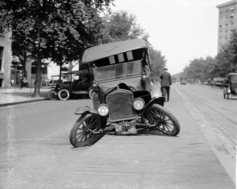

Re: WHAT HAPPENED HERE???
Post by Rich Eagle » Mon Jun 24, 2024 2:00 pm
Possibly inspired by this legitimate wreck we have seen here several times.

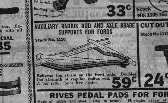

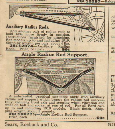

I don’t believe it’s photoshopped. It has a triangle shaped glitch or offset overlay, but no obvious pixel manipulation. The photo shows exactly what a collapsed front end looks like when the over the axle early wishbone ball breaks free. There’s a reason the wishbone design was changed. Also, it looks like it collapsed in the middle of the road, and the van is parked behind it is there to deflect oncoming traffic until the tow truck arrives. Probably a Virginia chapter tour mishap. Best case scenario is for it to happen at slower speed on a smooth paved road, if not, and it’s at speed on a rough road, it’s getting catapulted and thrown ass over tea kettle along with the passengers. I guess it was a fairly common occurrence on rough roads, because of all the accessory wishbone supports offered at the time. The one in the pic would keep the wishbone in place if the ball snapped off.

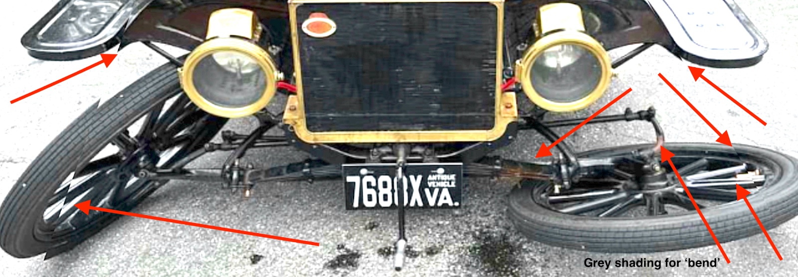

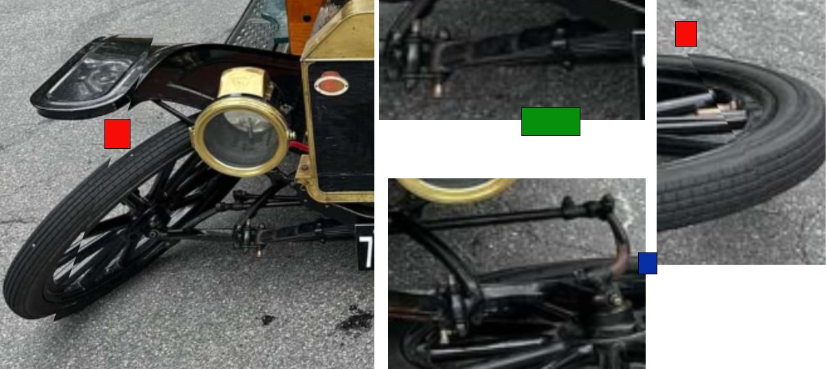

My observations are:
1. The red boxes show a shift in the image as Photoshop can do.
2. The green box shows the spring may be twisted.
3. The blue box shows the paint either burned or down to primer. I don't think a cold bend would show that there and not other places that are bent.
Without any sheet metal damage, I would guess this is staged with pre-bent parts.
Just my thoughts.

Photoshopped. Clearly, note all the areas of the photo that has been manipulated, the grey shading may look like primer, but just the result of photoshop.
click on image to enlarge
