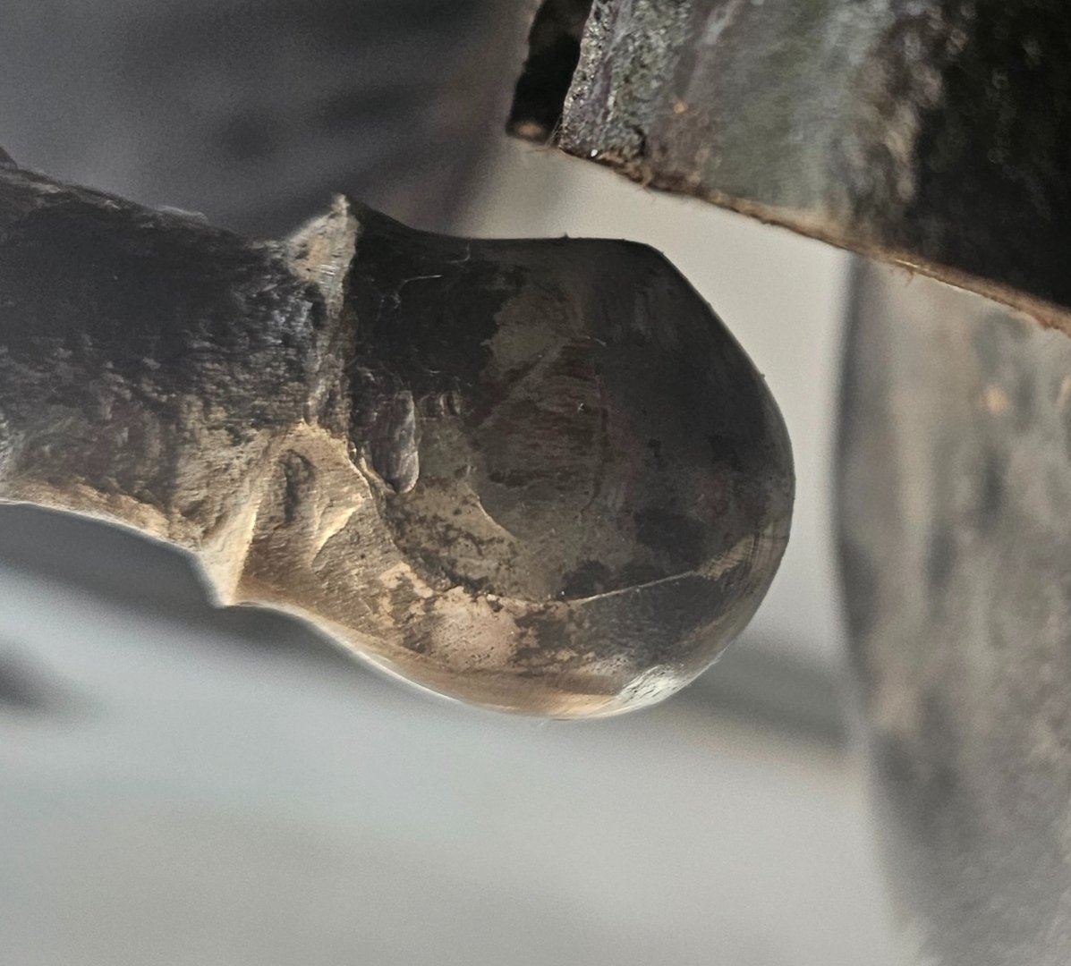

Worn radius rod ball......suggestions?
Daisy Mae
Topic author - Posts: 432
- First Name: Kurt
- Last Name: Andersson
So in my continuing adventures checking condition of all components on Daisy ('14 Touring), I have encountered the most worn part to date....the radius rod ball. The ball itself is badly worn, and, at some point in the past an APCO was installed no doubt in an effort to deal with the slop, but, it was on there long enough to wear the seat down....
Soooo...uhm, nope, don't feel safe rolling her out on the road as is...
Options...
* I imagine actually finding an early radius rod in decent condition would be chasing unicorns....
* I could weld up some material and file/shape/polish....tedious at best...but I am retired...

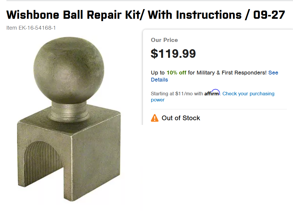

* I see Snyders has a weldable replacement ball (if they actually have it in stock), and I live in a shipyard town so finding a competent welder won't be a problem....I'm not good enough to trust myself doing that part...
Question being, has anyone done the last two? Thoughts? Recommendattions/suggestions? I know yall have 'em...let me know! Thanks...

Here is one possible solution. But, it's only half of your problem. The socket in the pan is pretty well shot too.
https://www.snydersantiqueauto.com/prod ... &cat=41901

I'm leaning to the replacement ball, was curious if anyone had done one. Sounds straight forward/simple measurements...
But ya, lots of galling on that ball every direction...the pan mount worries me not being an easy replacement part...unless I can shape/pound in some type of shim....been researching that and seems like gonna be a hurdle... this is my first stumper on Daisy as to direction to go... but also a critical one...

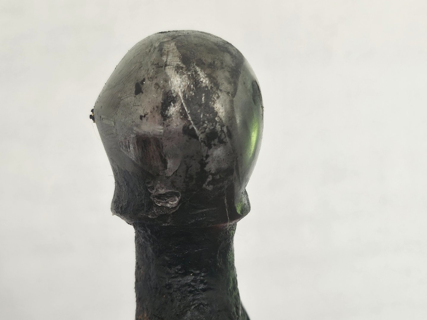

I would find a wishbone with a better ball.
Years ago, the very talented late Don Cusack welded-up and ground down a couple of wishbone balls for my father and me. However, the balls weren't anywhere near as worn as yours.
During the process of grinding down the ball, Don used a washer with a 1 1/4" inner diameter as a gauge so he could make it as uniform as possible.
If you look at this thread, you can see where Chris Bamford made a gauge to accomplish the same goal.
https://www.mtfca.com/discus/messages/1 ... 1318031604

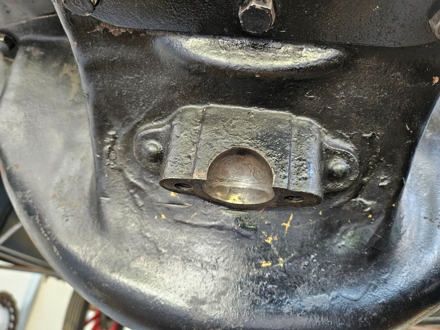

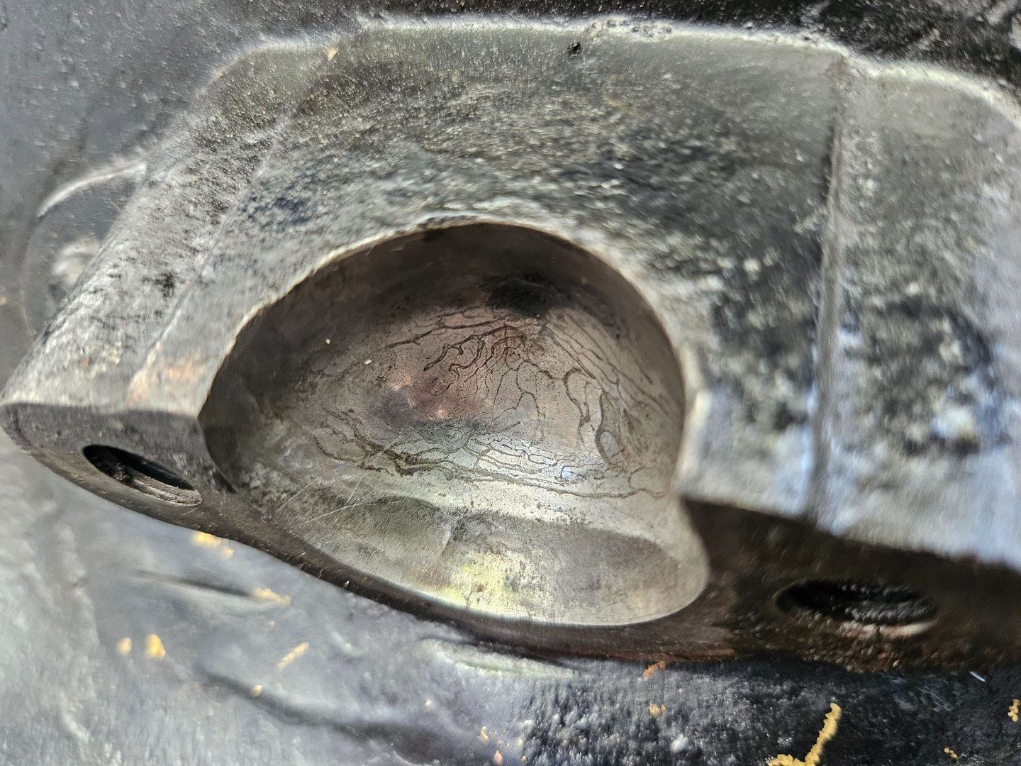

Yup, that is how I discovered it. I've been going thru the entire car checking condition, repairing/replacing as I go.
I'm now in the middle of going thru the front suspension, took it out to replace the usual...kingpin and tie rod bolts, sleeve bushings, shackles, etc etc...how I discovered the ball. The steering arm and tie rod ball were replaced by the prior owner in the late 60's, but the car was not used afterwards....they check good.
But.....the story deepens....next posts...
Daisy Mae
- First Name: Kurt
Re: Worn radius rod ball......suggestions?

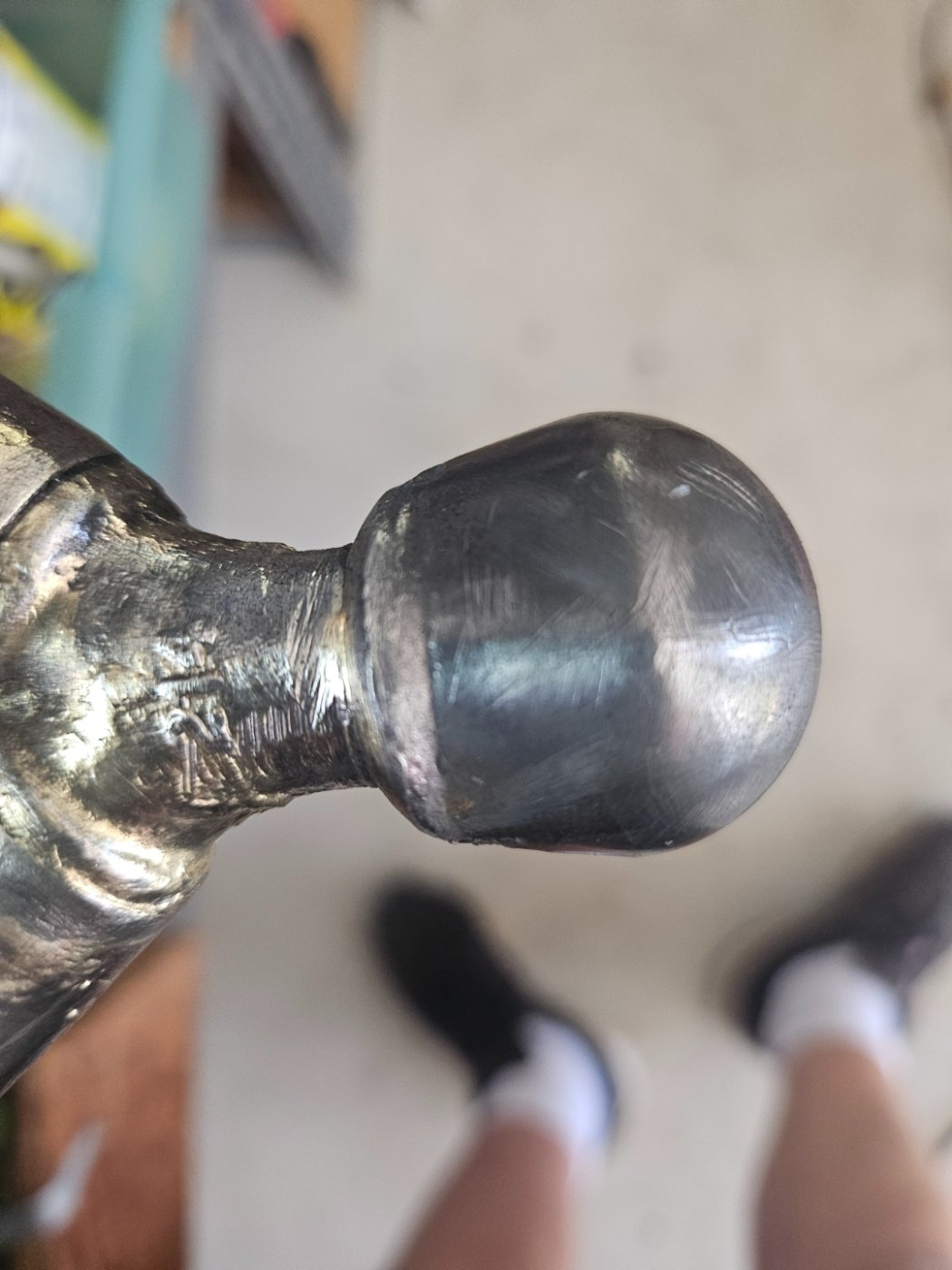

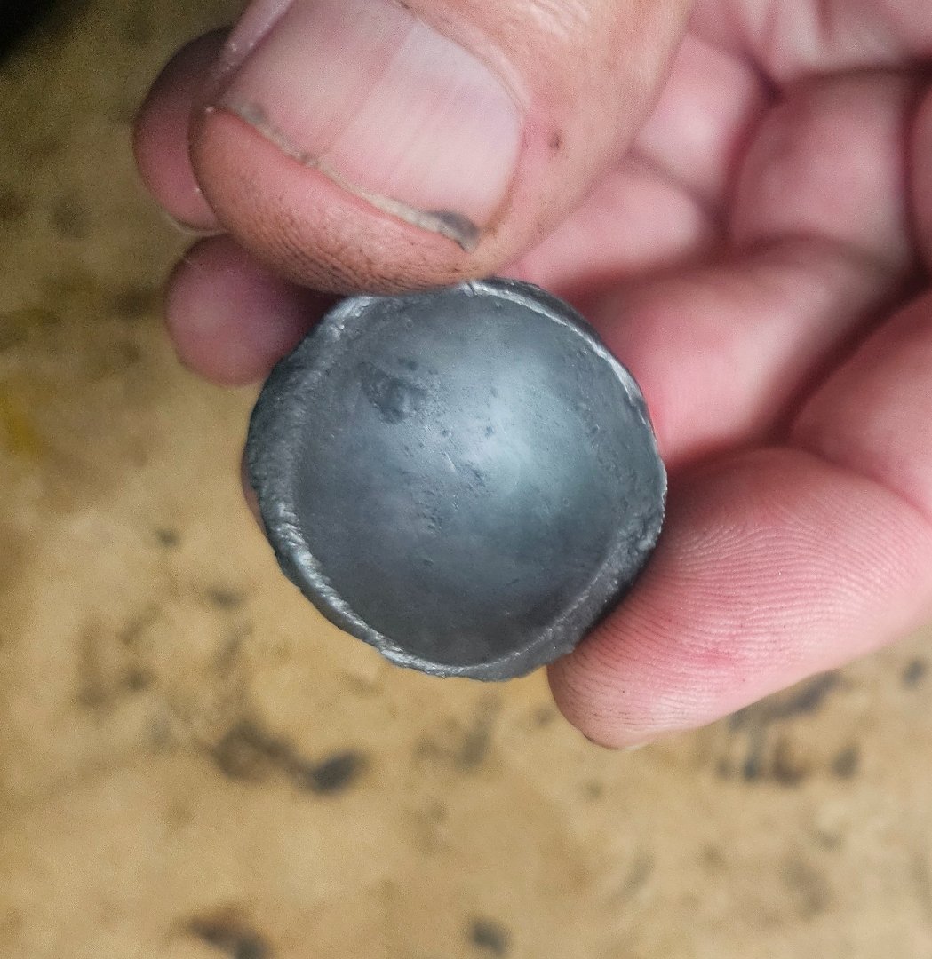

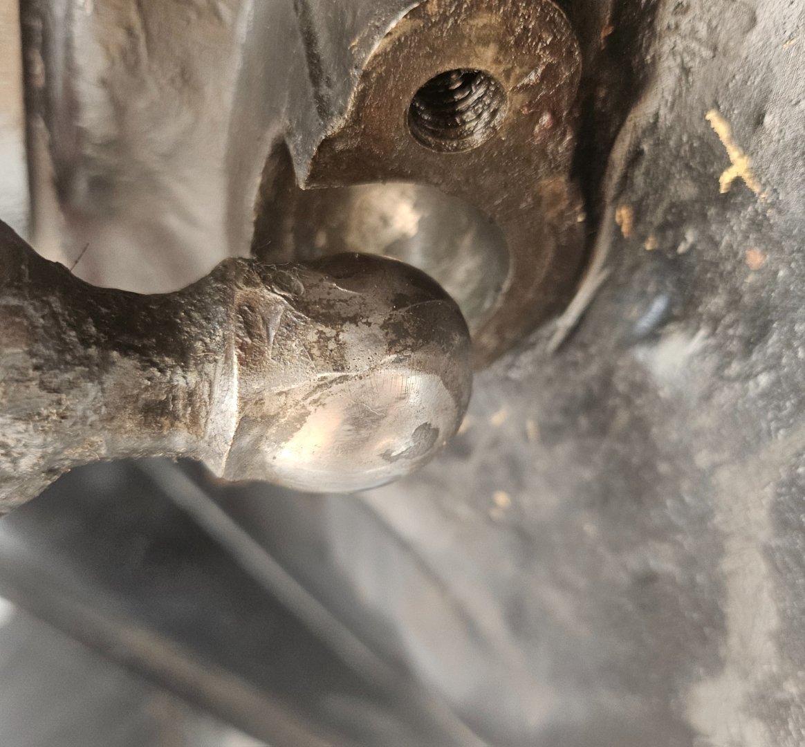

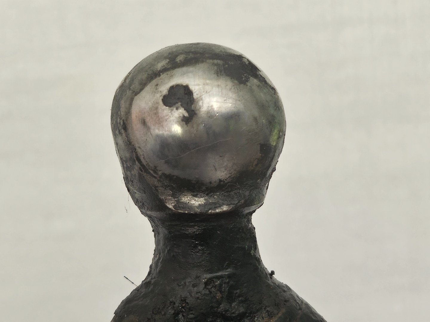

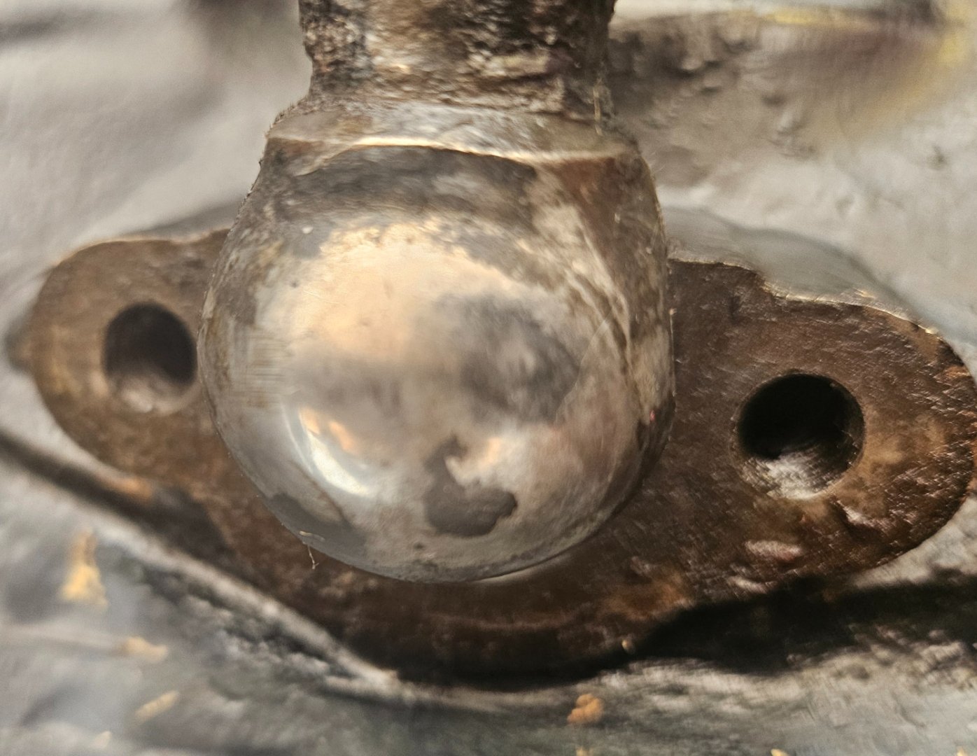

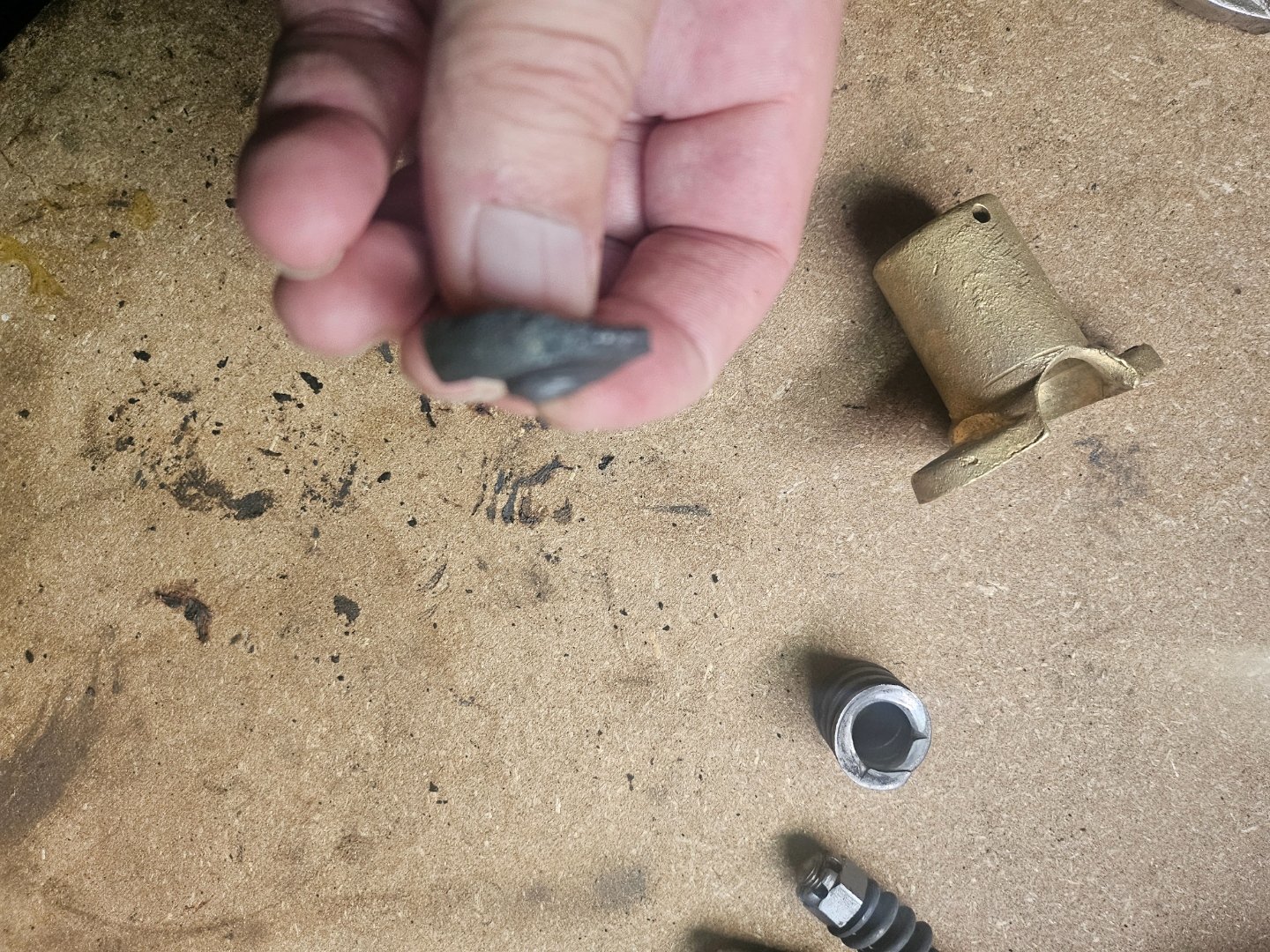

Having pulled the rod I could inspect more closely...some surprises...
The ball itself is badly worn....
Top to bottom flattened, micked at 1 1/16". Right to left, it micked out at 1 11/32".
The wear pattern was obviously more vertical vs horizontal, but also reflected a lot of fore/aft forces where the forward portion of the ball was wearing conical.
This wear pattern fore/aft was also evident in the socket, as can be seen on the lower aft portion of the socket. But with that much forward wear on the ball, I also expected to see a significant ridge developed on the forward face of the socket...while there is some, it's minor, not like I expected... It also appears in the last pic there was an indent on the pan drivers side...major bump/minor accident?

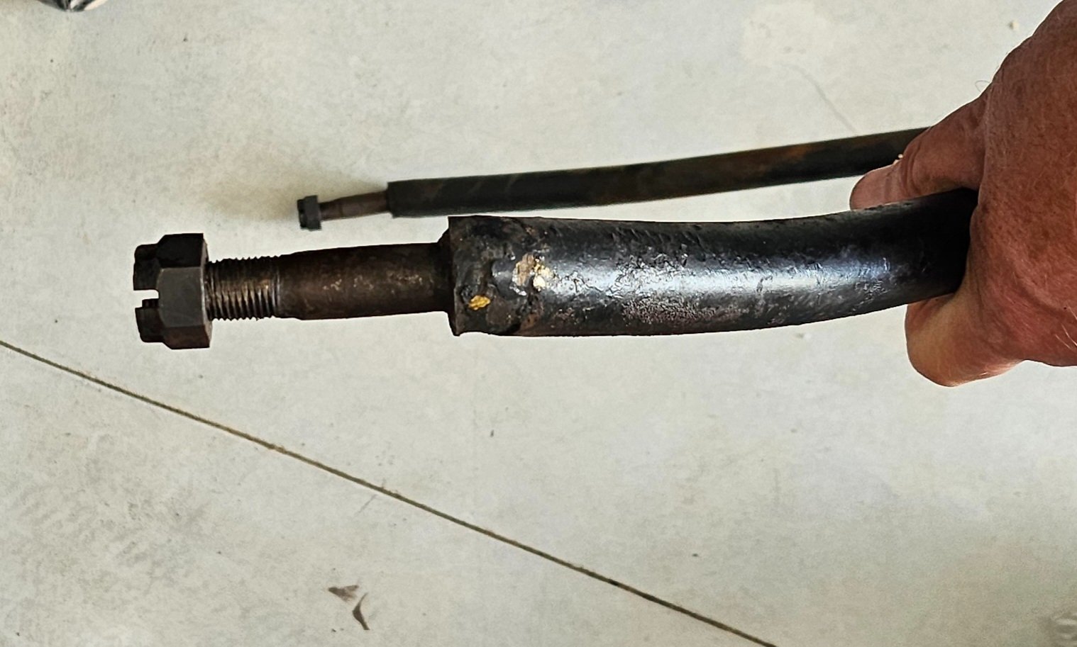

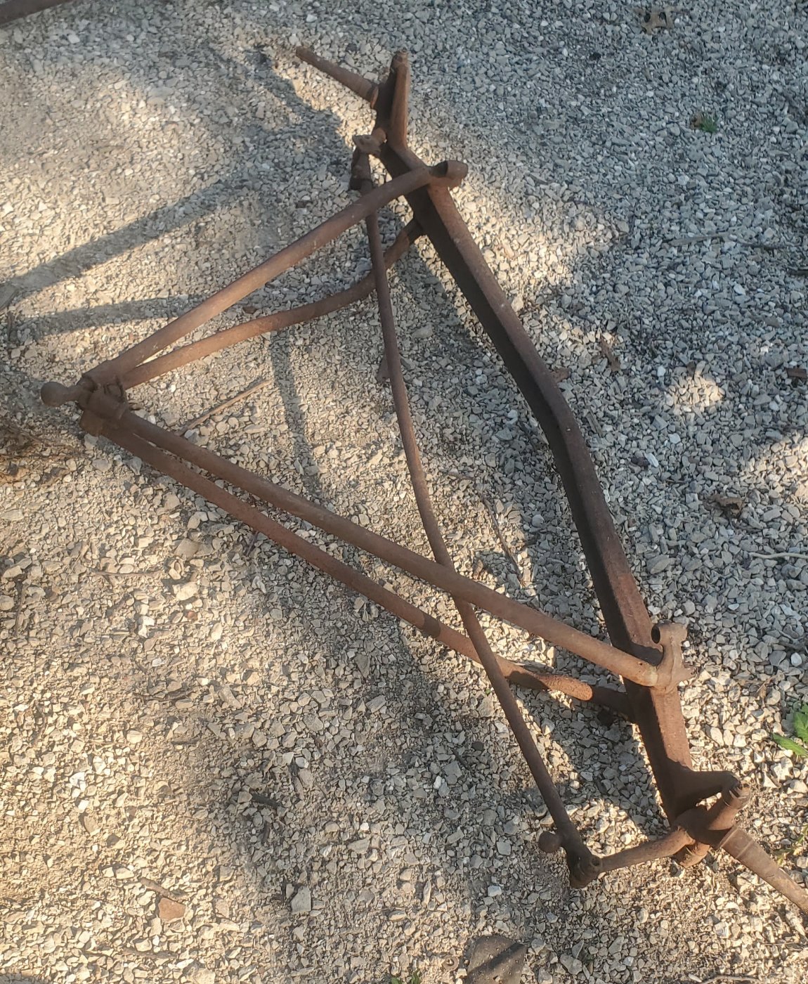

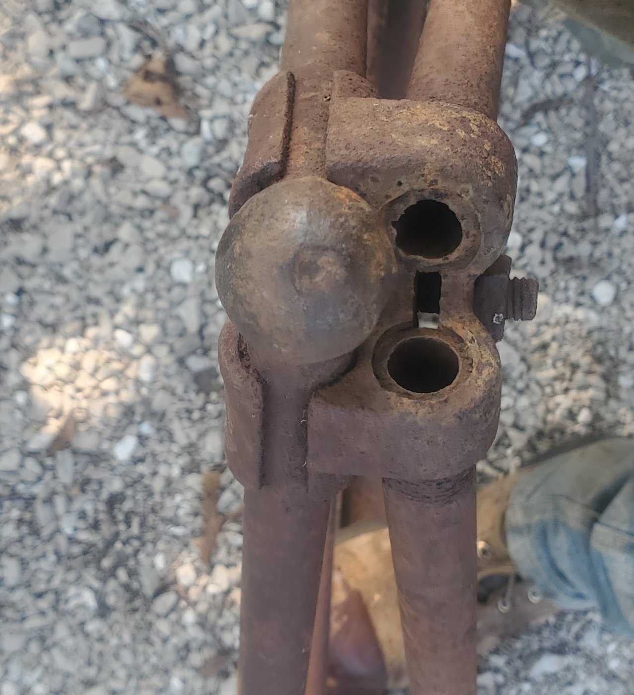

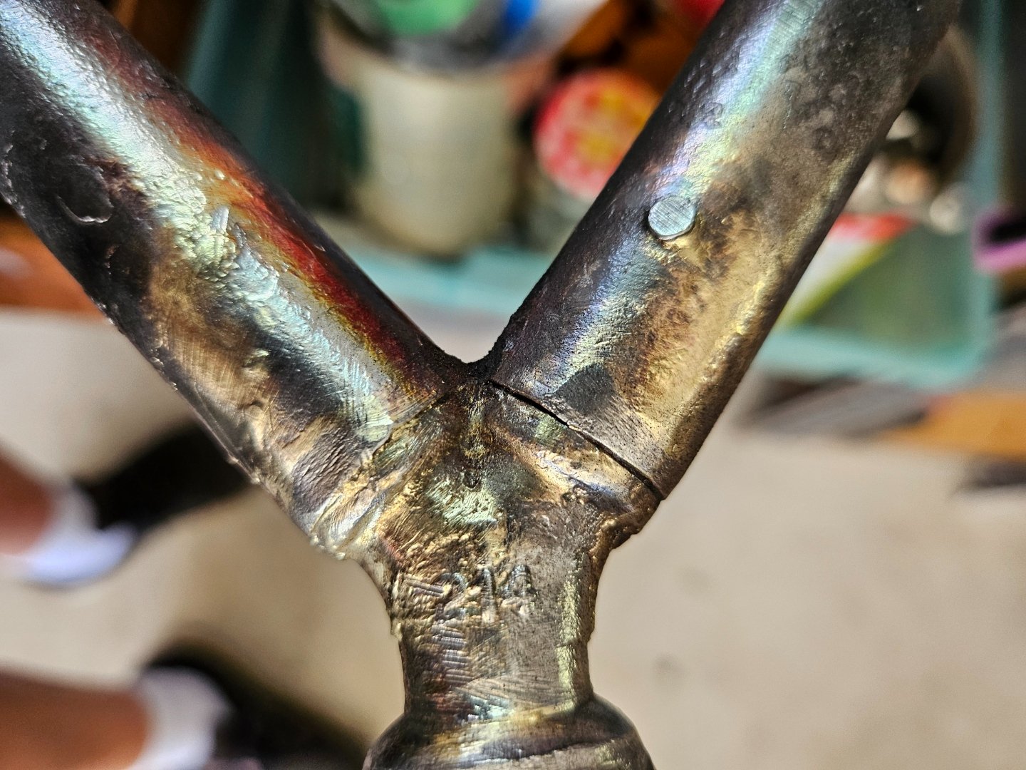

So...thinking why so much fore/aft tension...which...is to be expected, but still....
Beyond the dent in the pan, yet more evidence of some mishap in her life....
The radius rod ends are seriously bent.... Also, not sure if this amount of brazing up the shaft was factory normal, but....the ball shank and rod shaft were pinned on one side....so obviously a broke rod repaired back in the day...
The T archeological dig continues...

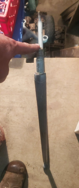

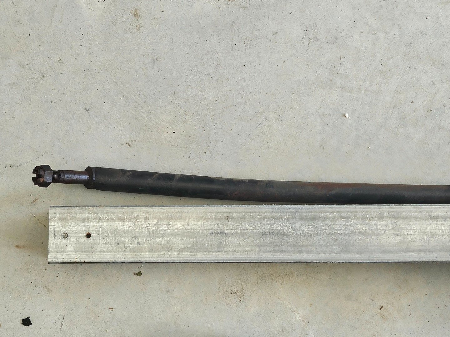

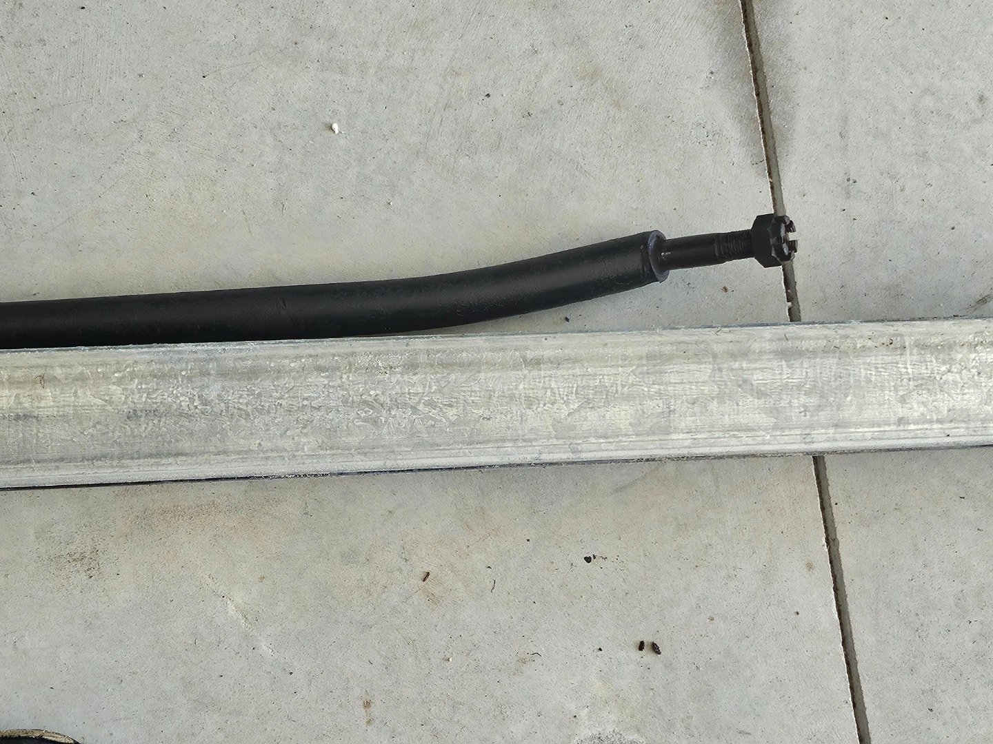

I wouldn't be so sure that the wishbone ends are bent, as in "damaged". There are some angles built into them that control your caster angle. What does appear to be the case, is that the stud ends are worn to a taper. When the studs fit into the spring perches they are supposed to be a snug fit. If they are sloppy loose, then the studs are worn and most likely, the holes in the perches as well. For safety and steering control, it is essential that these fits be snug.
Daisy Mae
- First Name: Kurt

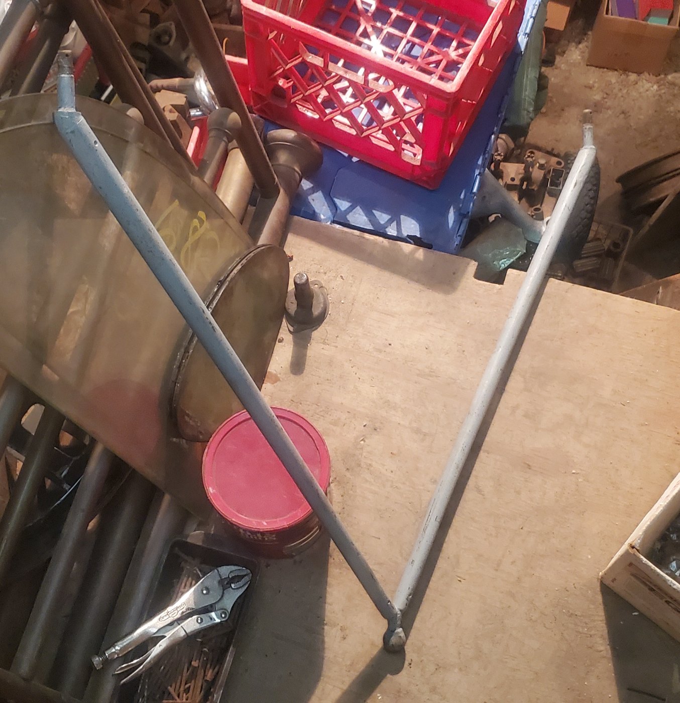

Which begs the question, if there is a built in curve, how much is it/where/radius?
Anyone have a pic of a good early rod for comparison??
Mine has a significant difference one side vs the other, as well as a torsional difference in relative angles of the pins to each other, as well as with the rods. The worst bent side also appears as if the pin was thrust at the rod end...visible flare... Thinking this rod has some serious issues...
- Posts: 4305
That's a better perspective. I'd say that wishbone is done for.Daisy Mae wrote: ↑Sun Jul 28, 2024 6:02 pmWhich begs the question, if there is a built in curve, how much is it/where/radius?
Daisy Mae
- First Name: Kurt
Beginning to think the same....Jerry VanOoteghem wrote: ↑Sun Jul 28, 2024 6:05 pmThat's a better perspective. I'd say that wishbone is done for.Daisy Mae wrote: ↑Sun Jul 28, 2024 6:02 pmWhich begs the question, if there is a built in curve, how much is it/where/radius?

Ive been looking at past wishbone posts and there is A LOT OF THEM. More than a few folks have had problems with the earlier pre 19 wishbones since they are a little weaker than the later 19-27 wishbones. The earlier would bend easier and an extra brace was put under the car along with wishbone. It seems that the later ones would fit and owners would do that to stop the bending problem of the early as the several posts about it reported. Flipping over the wishbone was done also if it was bent and the original castor was back as it should be. That’s a practice I didn’t know about if the wishbones were bent. Learn something new again on the forum.

A few years ago I found a stash of NOS early wishbones. Thought I had found King Tuts tomb, till I looked at them.
They had been stood on their ends with the balls up. But the studs had been in the dirt floor and most had the ends rusted off. Some poor soul ears were burning.
Sold a few for cheap at swap meet.
Another time I was looking at stuff at an old general store in Mississippi. There in the back warehouse along with a truck load of NOS parts for wood cook stoves was a NOS early wishbone hanging on the wall with a shipping tag still on it. Guy would not sell it, his brother in law wanted it.
I may still have a few of them. Will look if you are interested.

Some how,some way i had come across a replacement ball socket for the oil pan and i installed it on a pan with rivets, the brazing and such and that is under my ton truck now. was not difficult,just time consuming, but i have yet to ever see another replacement ball socket. Maybe I aint looked in the right places?

Is anyone else of the opinion that the cant of the axle to get the correct caster is built into the forged ends of the over axle wishbones, leaving the rods/tubes back to the pan straight?
- Posts: 7034
I read back through the posts and answered my own question. Jerry Van has also noticed that the forged ends are used to set the caster. The rods/tubes are supposed to be straight.
- Posts: 7034
With the repairs noted in the older thread by boring a ball bearing and threading it onto a ground down stem at the ball site, there is no wakening of the ball like you might get welding it up back to size. The threaded spiggot made is still larger than the neck on the ball. All that has been done is replace the worn section of the ball. A good tack weld is insurance to stop the ball coming loose on the thread.
I have done the same on early pitman arms, their forgings being lighter in appearance than any of the replacements available. Welding a stop on the thread is essential in this application.
Alan from down under.

Daisy Mae
- First Name: Kurt
Allan,
That was my belief, why I was confused at the thought that the rods had a curve....didn't make sense to me in my experience.
My pins are splayed different directions up/down, and one of the bars is significantly bent more than the other, which would only serve to torque the axle off square...
Would take a lot of bending on each component, while introducing more metal fatigue, to correct. I'm of the mind this wishbone has seen enough....
- Posts: 5020
The wear on the mounting studs tells the story. That front end has seen a lot of hard miles.
I'd be looking hard @ every component, including the front cross member.
- Posts: 2310
- Last Name: Juhl
- Location: Thumb of Michigan
If you drive your car a lot, have you considered converting to a newer style wishbone? They are more plentiful, but you'd then have to replace the the perches as well. BTW - Langs lists a replacement pan socket for 3-dip pans. Yeah, not original I know, but safer. There is a reason that they were changed in the Model T's later production. The attached article has a few errors (bad memories) but describes and event that occurred just up the road from where I live. For my 1917, I added an under-wishbone but retained the original over-wishbone.
- Posts: 7034
The socket on the pan was changed when the four dip inspection plate was introduced. It had to be redesigned to enable this change, not necessarily to make it any better/safer. The 1917 problem was addressed by adopting the under-the-axle wishbone.
Daisy Mae
- First Name: Kurt
The car did a cross country MI to CO for the inaugural Pikes Peak race. With the condition of rural roads then...or no roads... no telling what that front suspension endured just in its first two years of life!speedytinc wrote: ↑Mon Jul 29, 2024 12:45 pmThe wear on the mounting studs tells the story. That front end has seen a lot of hard miles.
But yes, not knowing the condition of this car, basically idle since 1930, she's not venturing out on the road until I've inspected/gone thru everything. At least I'll know where she stands.

- Posts: 7034
I would only use the Snyder's weld on replacement as the donor for a new ball. It will look pig ugly, but likely safe in use. I'd rather see the radius rod looking standard with the new ball fitted to a replacement radius rod. But that's just my opinion.

Daisy Mae
- First Name: Kurt
Exactly my same fear. A replacement ball was OK in my mind, I'm surrounded by professional welders. But both the rods and pins would have to be bent...and that much bending on a 110 year old part introducing that much more metal fatigue in the tubes was not something I considered safe....Allan wrote: ↑Tue Jul 30, 2024 2:00 amI would only use the Snyder's weld on replacement as the donor for a new ball. It will look pig ugly, but likely safe in use. I'd rather see the radius rod looking standard with the new ball fitted to a replacement radius rod. But that's just my opinion.
Dan Hatch has graciously offered/sold me a good spare wishbone he had. So that problem solved!
Here's a pic of what is should look like. (Been saving parts for a spare front end ) I have one on a terrible front end I found in the wild I just want the bracket off it the one leg of the bone is bent but the ball seems decent and the nuts are still on it it could be forsale if you need it I attached pics of bothDaisy Mae wrote: ↑Sun Jul 28, 2024 6:02 pmWhich begs the question, if there is a built in curve, how much is it/where/radius?
- Posts: 6475
Easy fix - not popular enough? Whatever the solution its important not to change its length. wishbone ends to top of ball
Daisy Mae
- First Name: Kurt
Thanks Karl. I was able to secure one.Karl Von Neumann wrote: ↑Wed Jul 31, 2024 11:56 amHere's a pic of what is should look like. (Been saving parts for a spare front end ) I have one on a terrible front end I found in the wild I just want the bracket off it the one leg of the bone is bent but the ball seems decent and the nuts are still on it it could be forsale if you need it I attached pics of bothDaisy Mae wrote: ↑Sun Jul 28, 2024 6:02 pmWhich begs the question, if there is a built in curve, how much is it/where/radius?
I would have loved to have had that original double wishbone setup had it been in good shape
Daisy Mae
- First Name: Kurt
Yup, that ultimately was going to be my route, if it wasn't for my rods being bent.
- Posts: 4578
Can the wishbone be straightened? Is there evidence FOR SURE that it has a built in slight off set or whatever? Or is it just conjecture. The later ones were straight and why should the earlier ones be any different if the later would work if you replaced the perches. But maybe earlier perches allowed for an offset?

If a guy had the bracket a guy could make the pipes I have a good one on my car. Really that's why I grabbed that axle was for the bracket
- Posts: 7034
True, the later ones were straight. However, the cant provided by the built in angle on the forged ends of the over-axle wishbone still needs to be in the later ones. It is provided for by the set angle on the forged ends which are held in place by the under-axle perch nut. Both rods need the cant to set caster.It is just achieved by slightly different means.
They rods can be bent, right at the axle, and the good book says it can/needs to be done to reset the caster. However, the bend required to adjust the caster is not likely noticeable to the naked eye
