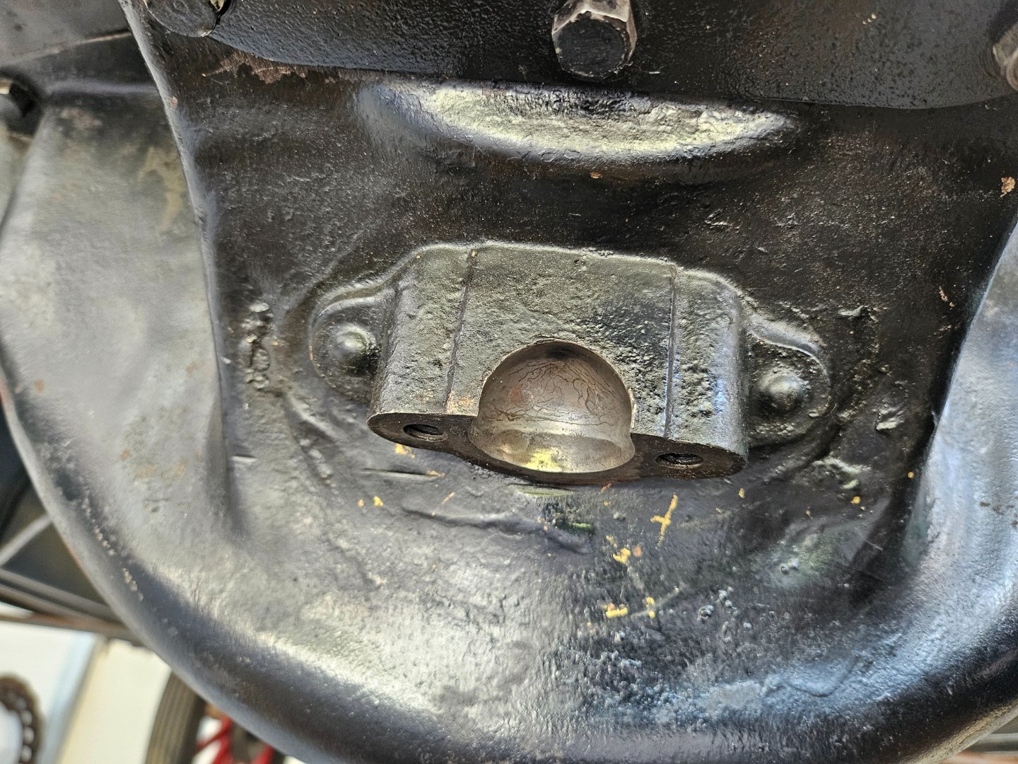

Having pulled the rod I could inspect more closely...some surprises...
The ball itself is badly worn....
Top to bottom flattened, micked at 1 1/16".
Right to left, it micked out at 1 11/32".
The wear pattern was obviously more vertical vs horizontal, but also reflected a lot of fore/aft forces where the forward portion of the ball was wearing conical.
This wear pattern fore/aft was also evident in the socket, as can be seen on the lower aft portion of the socket.
But with that much forward wear on the ball, I also expected to see a significant ridge developed on the forward face of the socket...while there is some, it's minor, not like I expected...
It also appears in the last pic there was an indent on the pan drivers side...major bump/minor accident?

Re: Worn radius rod ball......suggestions?
Post by tdump » Sun Jul 28, 2024 8:19 pm
Some how,some way i had come across a replacement ball socket for the oil pan and i installed it on a pan with rivets, the brazing and such and that is under my ton truck now. was not difficult,just time consuming, but i have yet to ever see another replacement ball socket. Maybe I aint looked in the right places?

The socket on the pan was changed when the four dip inspection plate was introduced. It had to be redesigned to enable this change, not necessarily to make it any better/safer. The 1917 problem was addressed by adopting the under-the-axle wishbone.
