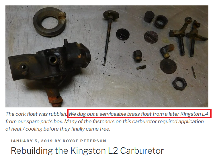

Ron says you can https://modeltfordfix.com/rebuilding-th ... arburetor/

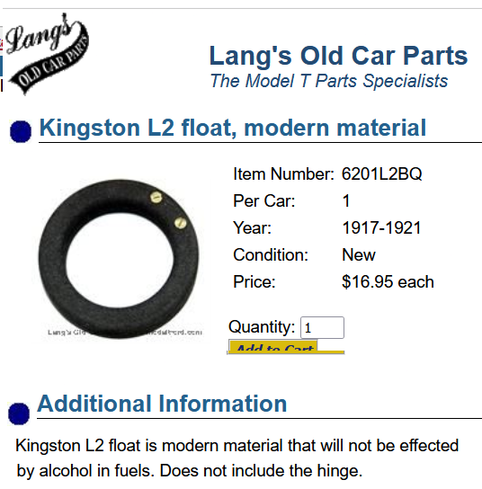

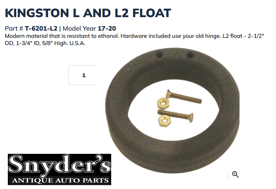

Who makes L2 floats?
Posts: 6587
Re: Brass carb float sealer???
Post by TRDxB2 » Sun Jul 28, 2024 6:37 pm
m_p_dean@yahoo.com wrote:
Sun Jul 28, 2024 6:01 pm
Don't know who makes them but Lang's, SnJ & Snyder's sell them

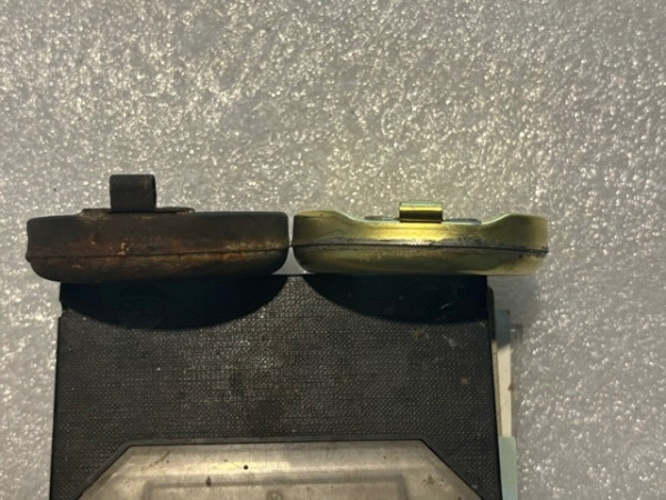

Here’s what an L2 float would look like in an L4. A little too big. If you’re good at soldering you can put an L4 hinge on an NH float. Just remove the NH hinge and solder it to the side without the recess where the NH hinge goes.
