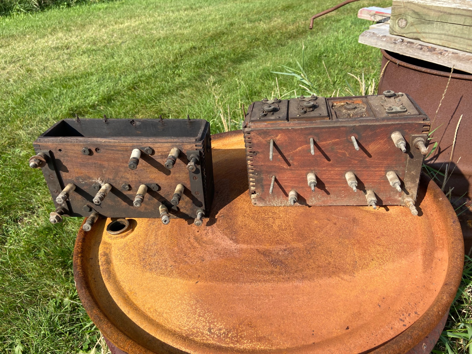

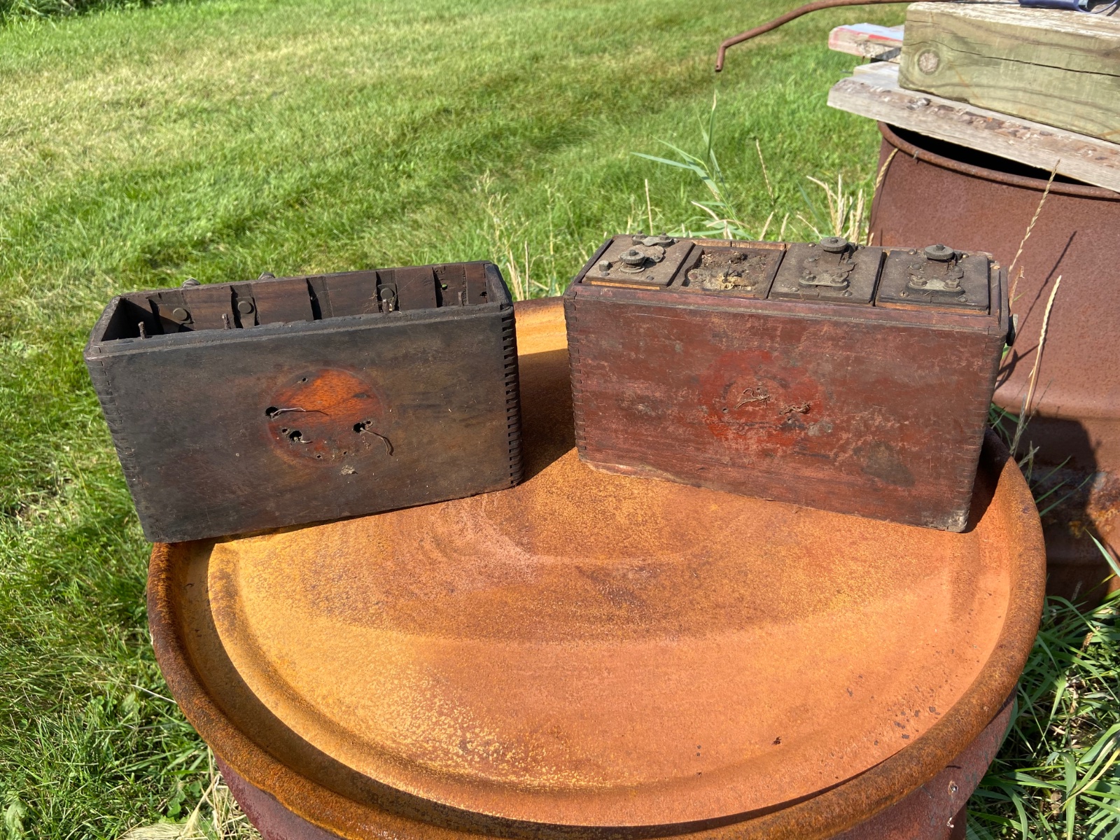

I picked these up recently. Just wanted to get a positive identification. The one on the left is narrower than the other one. Is it a Kingston and the other one a Heinz? What years?

The box on the right is Heinze.

So the Heinz would be 11-13 and the other one would be a Kingston then? It takes a quite a bit smaller coil than the Heinz, even smaller than the Ford coils. That would make it 11-13 also. Does that sound right?

Re: Early Coil box identification

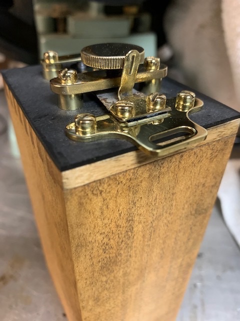

The box on the left with the vertical 10/32 studs is a Kingston box. The stud was to hold the coil in place. I attached a photo of the brass tab on the coil.

Ok that makes sense. I wondered what those were all about.
The box on the right is a 1912 Heinze box with the coils arranged in mismatched fashion. The earlier Heinze coils in 1911 used a separate post to "ground" the top, and had combinations of more screws to hold the tops down. The Heinze company must have been a favorite of whoever was selling blueprint supplies to them, because the designs changed constantly.
