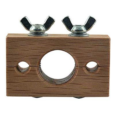

Any sell them or have a plans drawing to make one?

Texas T Parts or their successor carried them. I bought one a while back from them.

Easy enough to figure out by taking some measurements on the lower steering column.

I have some of these and can take some measurements of the hole ID's and spacing.
I would expect that the hoes for the column & rods are drilled first. the the bolt holes. The a band saw (or coping saw) to divide the bolk in two

I made mine out of red oak, then belt sanded the two halves to make the holes tighter. Then used longer carriage bolts & put stiff springs on
the bolts so it can be adjusted as needed. Les, so the levers don't flop around when worn out.

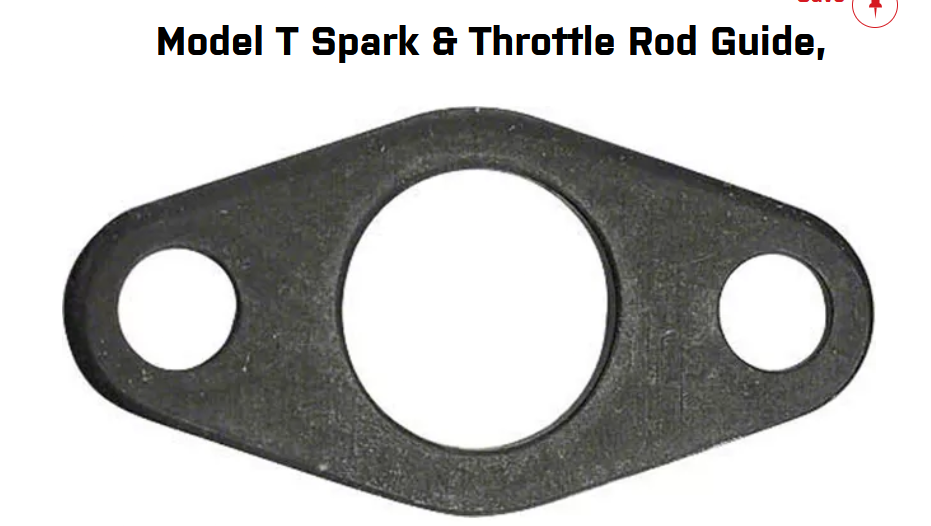

A zip tie at the rod guide that goes over both rods and the steering shaft will achieve the same in true T owner fashion, cheap. Also will quiet down vibrations should you have any in the rods as well.
