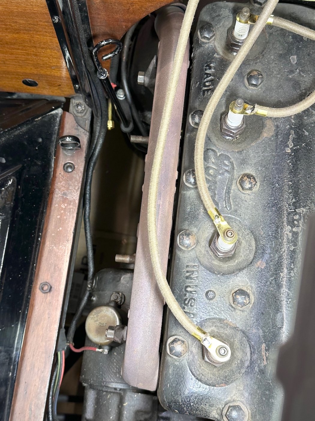

Once the ignition maladies on the '14 Touring with '19 motor were cured (I hope!) the center soft or freeze plug started leaking. I have been doing a lot of flushes with vaious brews to try to get the car to run cool like the '23 does and the latest attempt was with Evaporust cooling system flush. I had intended to drive the car several times and get it good and hot over the course of a week then drain it. When the ignition died and the ignition was being worked on the time went from one week to six or eight. When the motor was running again it got several runs in the garage and became good and hot, a bit of steam out of the neck and some mild gurgling from the engine. It never boiled and I monitored the temps with an infrared thermo.
After the last run I noticed the carb was getting wet on top. Investigation showed the center freeze plug leaking! I can only guess that the flushes cleaned out some of the crap which was sealing up the leak previously.
There are three of these plugs and to get at them, the manifolds had to come off. Getting the big exhaust nut off proved to be a job. I soaked it in Areokroil for several days and then proceeded to try getting it off with that big wrench sold for this job. It seems to me the handle should be at least two or three times longer than it was. I even tried standing on the wrench and I'm no lightweight. No soap.
More Aerokroil and some pounding with a large rubber mallet was tried but that didn't seem to move the nut either. Not having a torch, I tried a combination of more kroil followed by more and harder pounding. Eventually, I saw movement and then the nut decided to yield and allowed itself to be worked off.
The two manifolds came off easily. Those nuts had also been soaked in the Aerokroil and all came off with no who haw. One of the studs (of course) came out but that's OK, it gave more room to work on the freeze plugs. These were thick and needed to be drilled out. The two end ones were brass and the leaky center one was steel.
New brass plugs were installed with a 9/16 socket and dimpled with a punch. The Right Stuff 90 minute gasket goop was used. I have some water in the system now and they are not leaking.

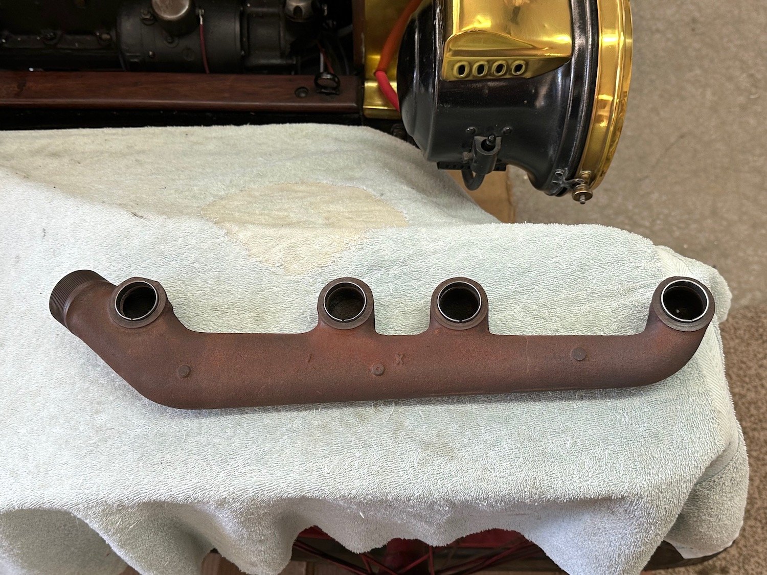

Once off the exhaust manifold was checked with a straight edge. While not perfect, it looked useable to my eyes. See the picture below.
The gaskets that were on were a copper ring with a ridge. I saw no sign of leakage and ordered a new set of the same type.
When I next have time to work on this project I would like to reinstall the manifolds. I was thinking of using The Right Stuff 90 minute gasket goop in the ports in the block to both seal & hold the gaskets in place while the manifolds are maneuvered into position & the clamps tightened. Any problem with doing this?
When I last did this on the '23, someone had told me about a trick using the stock clamps & nuts to hold one manifold in place while getting the other one in place. I tried it and it worked great. The problem is that I can't remember just how it went. Was the exhaust first with the clamps verticle?
When it comes time to reintroduce that big nut to the back of the manifold should anti seize be used? I was concerned that being just about the hottest part of the motor it might burn into some sort of cement and make the job of removing it next time tougher rather than easier.

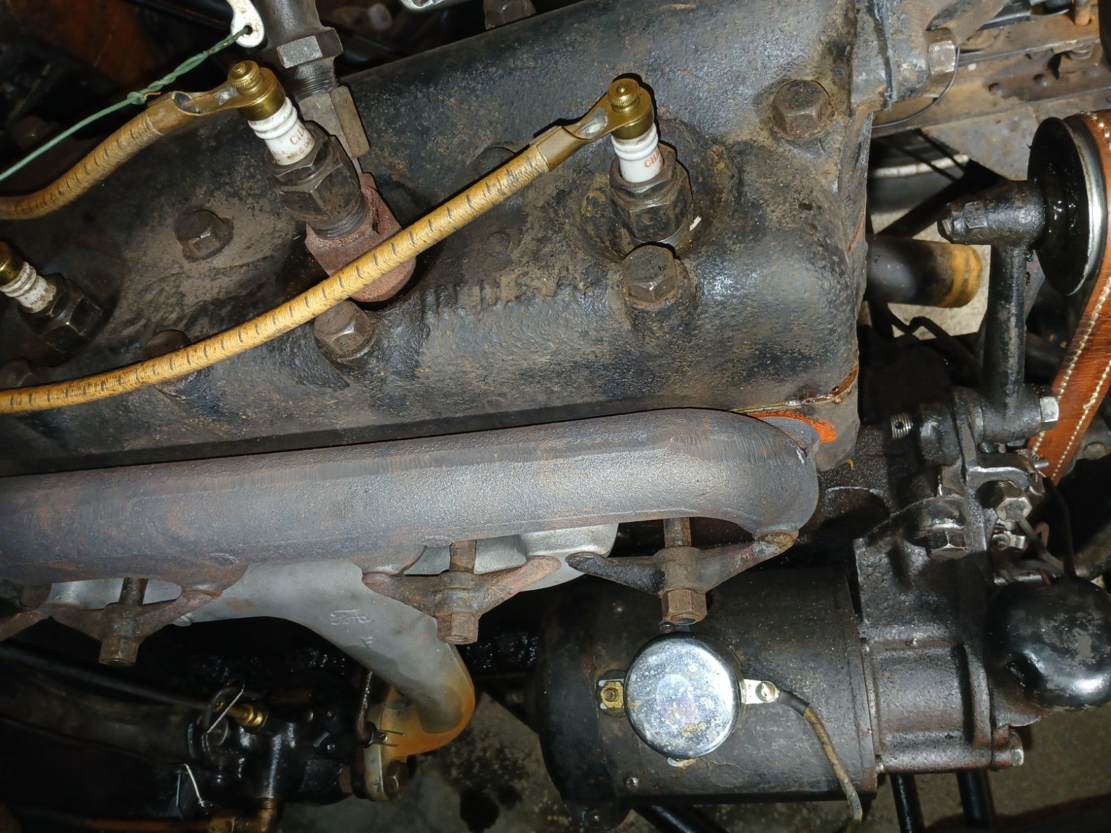

Another trick is to use two manifold clamps (or two with one ear cut off) to mount one manifold. The when mounting the second manifold use fully eared clamps and when secure, rotate the first installed clamps (or remove the half eared ones and replace with the real clamps)

Looking at the photo of the exhaust manifold and the ruler, your manifold looks to be well bent, with the back port low. If so, there is no way it will fit with the manifold rings properly located in the ports. If you can get the front thee rings fitted with the lips on the rings seated in the block ports, that type of ring with the thin copper flanges may crush well enough to seal around the back port. This is not an ideal situation, as the manifold is free to "walk" up and down on the block face with successive heat cycles. Ideally, a new manifold is the answer, with a set of the reusable heavy one piece copper rings to hold it captive against the block.

I have been doing what Roger shows in the first photo for years. No reason to cut the clamps when doing it that way.

I think your manifold looks pretty darned good. The real test is how it fits up.

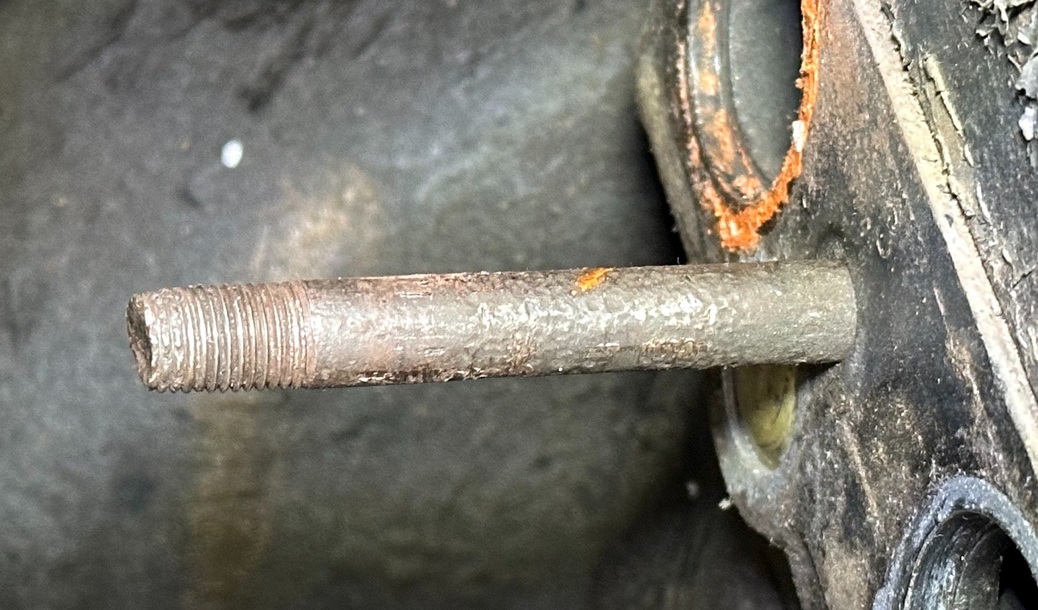

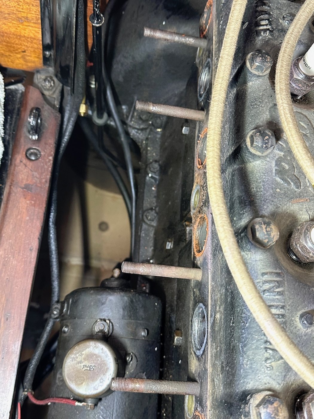

I had a try at installing the manifolds Sunday. The rear stud had come out with the nut when disassembled so I chucked it in the vice and turned the nut off. Both stud & nut had the threads chased which took plenty of oomph on the stud. Everything was scraped and cleaned with solvent on both the block & manifolds. The exhaust manifold was already checked with the old gland gaskets and fit fine. The rear stud was installed in the block, no worries at all. I had high expectations for this job.
The Right Stuff gasket goop was used on the intake manifold glands and a high temp silicone on the exhaust glands. All were inserted in the block after a trial fit in the manifold. All looked good.
The fitting of the manifolds did not go to plan. The exhaust seemed to lock in pretty well and the vertical clamp trick was used to hold it in place while the intake was maneuvered into place. All still looked good.
The problem came when tightening the nuts on the studs. The first three were good, the rear nut stripped the threads off the stud. All of these studs were short to my mind previously, see bottom picture to see how they were when I started. I like to see the stud sticking out past the nut, none of these did. In addition to being short, the stud in back had been cut at the factory at an angle so in addition to being short it had a partial amount of threads on the all important end. This morning I measured the studs, that back one was the shortest of the four.
After struggling with this for a bit I decided that it would all have to wait for another day after new and longer studs had been sourced. Off it all came and everything was cleaned up as well as I could get it. It will still need a final cleaning. Does anything remove this silicone gasket goop outside if scraping?
Now I'd like to get new studs that have the same amount of treads with an additional 1/4" or so of threaded length on the outside. I see the suppliers have studs in their catalogs. Are they the same as I have now or just a bit longer? If I have to go to McMaster or other supplier, what grade do I need to get?

Your studs were long enough. They just had terrible threads to begin with, due to age, use & rust. The rear stud was not "cut at the factory" that way. The first few threads have simply rusted away over the past 100 years. If you want an extra couple of threads showing beyond the nuts, then don't thread them into the block as deep.
Posts: 5343
Re: Installing The Manifolds?
Post by RajoRacer » Mon Sep 30, 2024 2:53 pm
New studs are relatively inexpensive - replace them all and & use brass nuts. Do away with all the "goop" ! If your exhaust manifold is true on plane of all 4 ports, just use the ring & gland set. I prefer to install my intake first verifying I got a good fit as you can see the 2 ports then I install the exhaust secondly because one can look down over it and verify it's fit.

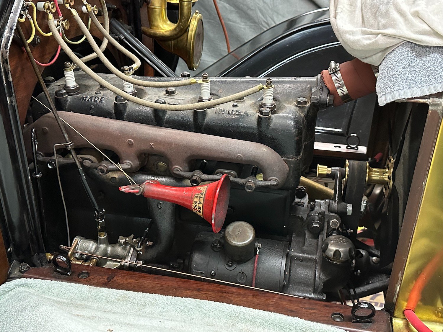

Here is a pic of the car cooling in the garage after its test drive. The temps were in the mid 40s when I left for the drive and descended to the point where even the red in the Motormeter tried to go back into the radiator to stay warm. I had on three layers and that was not enough so I was very happy to head back home. This pic shows the car "cooling" off in the garage after its first drive in months.
Paul
