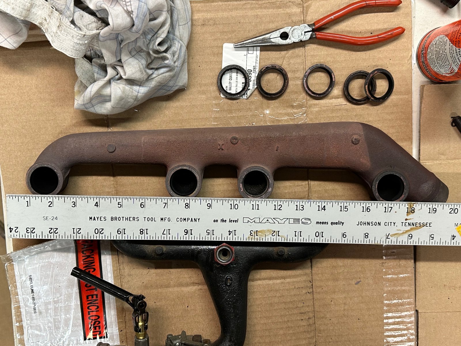

Once off the exhaust manifold was checked with a straight edge. While not perfect, it looked useable to my eyes. See the picture below.
The gaskets that were on were a copper ring with a ridge. I saw no sign of leakage and ordered a new set of the same type.

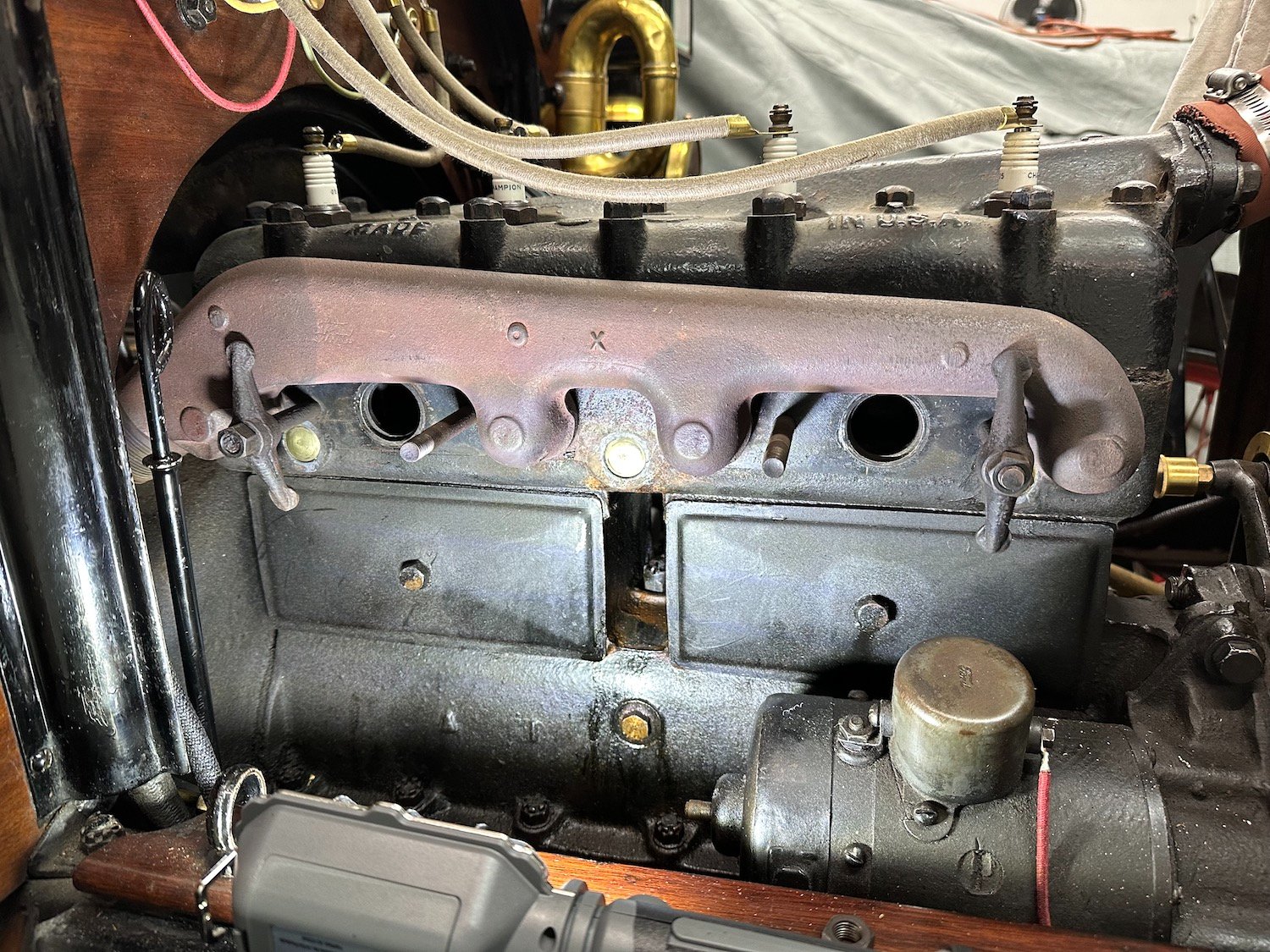

When I next have time to work on this project I would like to reinstall the manifolds. I was thinking of using The Right Stuff 90 minute gasket goop in the ports in the block to both seal & hold the gaskets in place while the manifolds are maneuvered into position & the clamps tightened. Any problem with doing this?
When I last did this on the '23, someone had told me about a trick using the stock clamps & nuts to hold one manifold in place while getting the other one in place. I tried it and it worked great. The problem is that I can't remember just how it went. Was the exhaust first with the clamps verticle?

I would use the old gland rings to make sure the exhaust manifold will fit, I have not had much luck eyeballing the ports to determine if they are straight. I have never used that type of manifold rings but see no harm in silicone to hold them in place. The manifold helpers I had ( infuses on
had) where made by cutting one ear off of two clamps & welding a tube to keep them aligned on the studs. I would put the exhaust on first with the clamp on # 1 & 4 cylinders then install the intake, then replace the helper clamps on the ends.

You'd be safe to use these anti-seize products good for up to 1600degrees. In any case the exhaust nut clamp or even a hose clamp to keep the nut getting loose is a good idea ant-seize or not.
Another trick is to use two manifold clamps (or two with one ear cut off) to mount one manifold. The when mounting the second manifold use fully eared clamps and when secure, rotate the first installed clamps (or remove the half eared ones and replace with the real clamps)

A trial fit of the exhaust manifold makes good sense. I'll try that tonight with the old rings.
That picture is exactly what I was half remembering. Installing the manifolds on the '23 went so smoothly that it was a breeze.

Looking at the photo of the exhaust manifold and the ruler, your manifold looks to be well bent, with the back port low. If so, there is no way it will fit with the manifold rings properly located in the ports. If you can get the front thee rings fitted with the lips on the rings seated in the block ports, that type of ring with the thin copper flanges may crush well enough to seal around the back port. This is not an ideal situation, as the manifold is free to "walk" up and down on the block face with successive heat cycles. Ideally, a new manifold is the answer, with a set of the reusable heavy one piece copper rings to hold it captive against the block.
As others have pointed out, anti seize is the answer on the manifold nut. When getting a tight one to free up, ball pein hammer blows on each of the flats will help to break up rust/corrosion to allow better use of penetrant.

I have been doing what Roger shows in the first photo for years. No reason to cut the clamps when doing it that way.

I think your manifold looks pretty darned good. The real test is how it fits up.
As others have mentioned, too much effort with the pack nut can get you a broken manifold.

I had a try of the manifold last night. Using the old glands the 4 best fitting ones were selected. They were pressed into the manifold and all would hold pretty well. It seemed to fit into the block OK. I have been advised to get a mirror and see if it still looks good from underneath. I'll try that this weekend.

Re: Installing The Manifolds?
Here is a pic of the car cooling in the garage after its test drive. The temps were in the mid 40s when I left for the drive and descended to the point where even the red in the Motormeter tried to go back into the radiator to stay warm. I had on three layers and that was not enough so I was very happy to head back home. This pic shows the car "cooling" off in the garage after its first drive in months.
Paul

You don't need to run the studs into the block until they bottom out.
Yes, that would make them bolts. Probably better to just use bolts next time.
While the motor was warming up at a fast idle and getting a look over for trouble, I took the 12v test light and clipped it to the magneto terminal and grounded it to the brake pedal. It lit brightly so I'm thinking the magneto works. The previous owner had installed an E-Timer so I had thought that possibly it might not work or maybe it might be spotty.
While the test light was out I clipped it to the nut the holds the cut out to the generator and grounded the other wire to a head bolt. The bulb lit about as well as if it were connected to the battery. That would seem to indicate that the generator is also working. Some good news in these tests.
Paul
Paul
