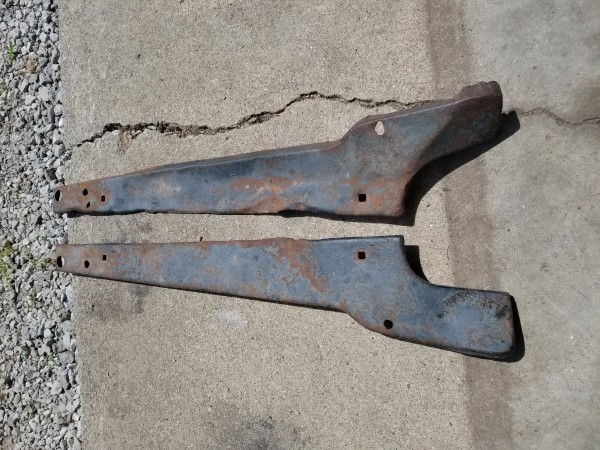

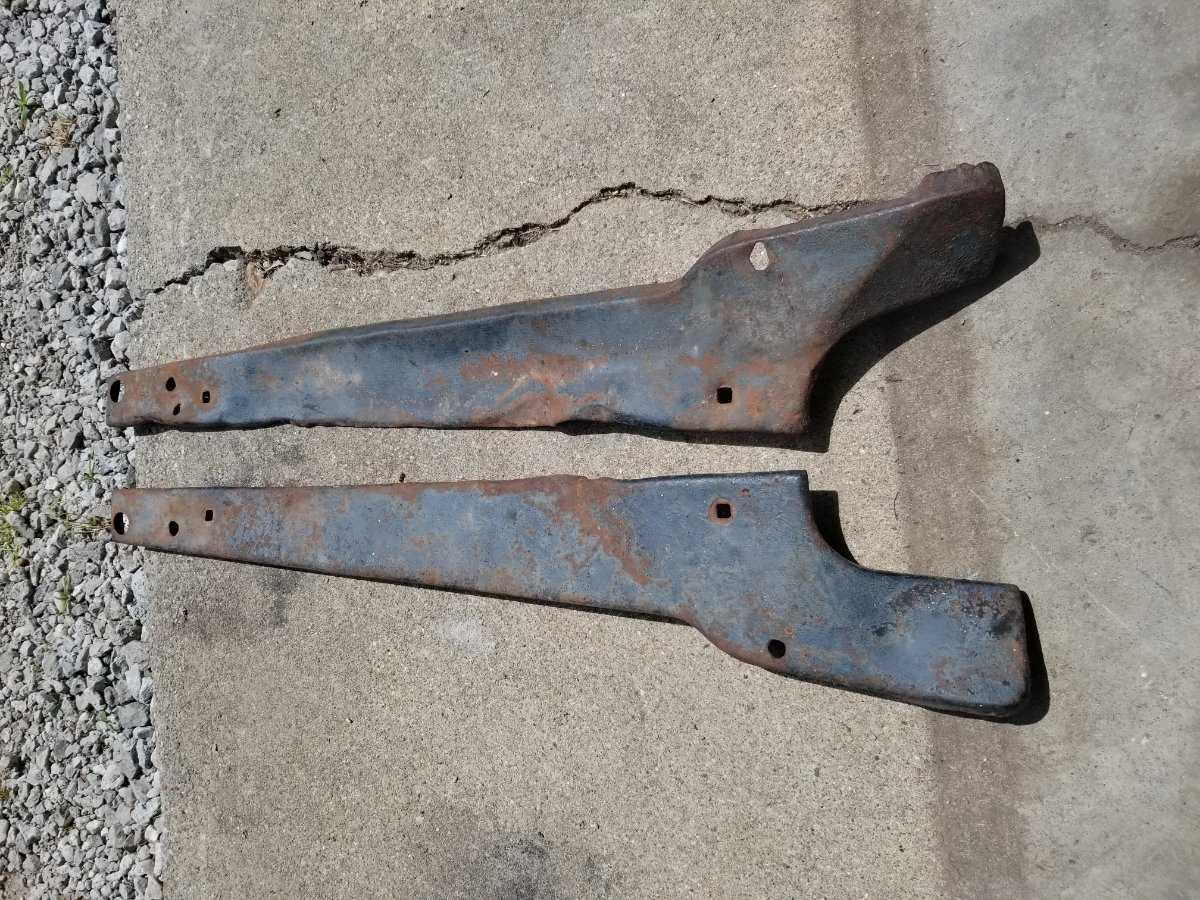

I am trying to figure out the hood shelves and how to make the wood fit. This is why.
This is the shelf I have.
This is what I need?????

Dallas, you have the right shelves. The other ones, the bent ones, are for a high radiator, you have a low radiator. Dave

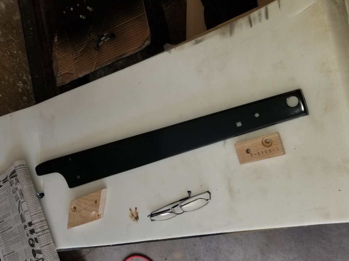

I think you are right Dave. I have the wrong wood blocks for shelves. Now I need to fix that issue. Anybody have a drawing of the correct blocks? 17-22 hood shelf blocks.

Post by Dallas Landers » Sat Jun 22, 2019 3:49 pm
I can modify these blocks to work.

On the new blocks, have they started "angling" or "egging" a couple holes with a drill and bit? I don't recall which ones.
I had "new" blocks from the late '70's on the '18 Runabout under the shelves and they needed to have a drill and bit tipped over a bit to make it all work in two thousand sixteen for me. Oh! It was for the latches! They couldn't "tip" out at all to catch the hood.

Yes Duane, they angle the hole for the spring so clups angle out a bit. Any tips on getting springs on front hood clips? Seems like it may be a two person job? I tried my valve spring compresser but not working so far.
