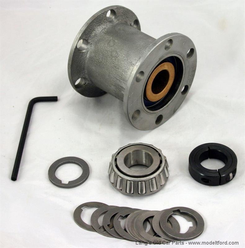

Knocking around ideas in my head.

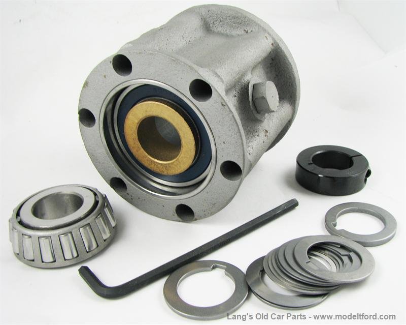

Has anyone attempted to build their own driveshaft spool with modern bearings?
if so, are there any bearing part numbers for the bearing race, conical bearing, sealed bearing, shims and collar?
I know they make kits but kind of wondering if I can get the internals and then do the machine work myself.
I am not sure if it would save money or time.
Also has anyone tried one of the various setups offered before and how did it work out?
Bryant Photo courtesy of Langs old car parts
currently no longer available

The photo you posted, Bryant was a Fun Projects Adjustable pinion kit - he also produced a "plug & play" kit. Chaffin's in currently offering a "plug & play" kit & Snyder's is offering an adjustable kit similar to John's.

I did see other vendors had kits to get the job done. I still may go that route.
Just pondering a machine job.

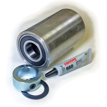

Bryant
Topic author - Posts: 1226
- First Name: Bryant
- Last Name: Shafer
Re: Modern Driveshaft spool bearing assembly
looks like it is offered for the early models also. then there is the glue in Cartridge type said to be available for both closed and open spools.

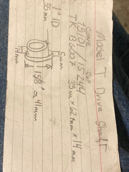

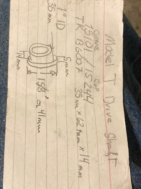

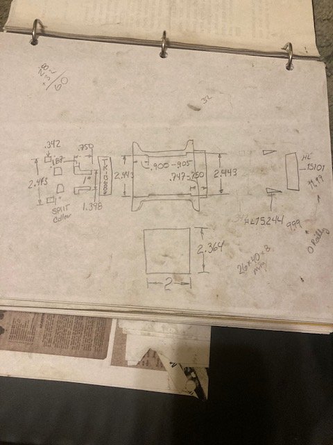

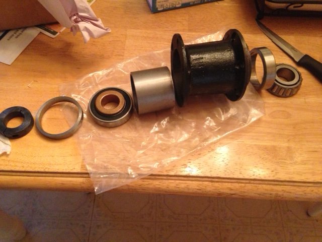

Hi Bryant,
The first modern pinion I purchased was bored off center and gave me fits trying to set the gear lash because every time re-installed the
drive shaft it changed! when I took it apart to figure out what was going on I decided to make my own. Once I figured out the issue I used it
to my advantage & just rotated the spool to get the lash I wanted. That was in 2017 & it's doing just fine. I have not used the one I built yet.
I did make some notes. I used a piece of axle tube to make the spacers & the shims are not in the pic. I used a two piece collar & machined
a recess in the shaft to lock it in place. The two piece collar requires some grinding on the screw heads to clear the I.D. of the tube. collar in the pic is the one that came in the kit. I'm not sure the juice is worth the squeeze but it is a fun project. The last two rear ends I put together I used the stock bearings that were in
super good condition. The modern set up is nice if you have a otherwise good shaft with a issue @ the pinion area.
Craig.

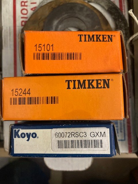

Hey thanks for the info.
I am having a hard time reading what I believe are the bearing part numbers on your drawing.
Would you be able to list them for me if you get a chance?
I appreciate it and thanks!
Hi Bryant,
Here's a little more info, The bushing I think was from Ace Hardware & didn't need much work to fit. I leave the ball bearing sealed & should have enough grease to last a life time & will keep engine oil out of the rear end & gear oil out of the
tube.
Craig.
tube.
Craig.

Craig
Thank you so much!
I will be looking these bearings up with my parts supplier.
