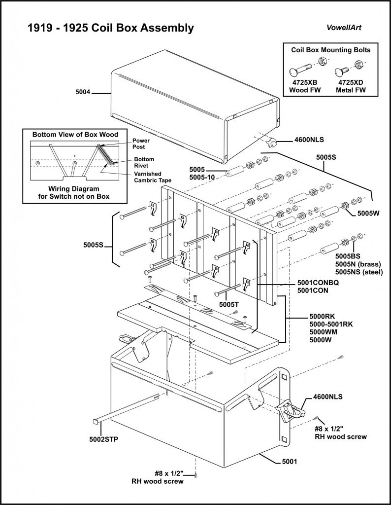

Here are the installation instructions. Skip the part about front mounted switch that was on earlier boxes.
The old contacts (original phosphor bronze) are preferred over the new ones (copper). Note in the diagram there are lefts & rights.
The wiring diagram is a bottom view, showing the wires in the grooves. You could place same water proof tape (like Gorilla) over the wire(s) slots as was done on the original.

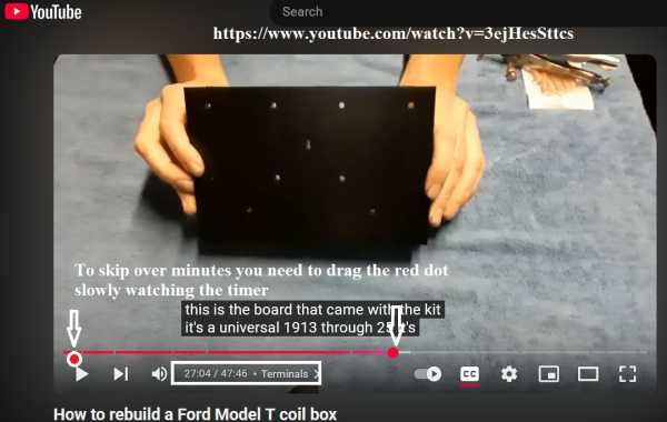

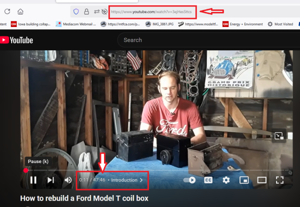

This the link to the YouTube Video that dinosBunny mentions below https://www.youtube.com/watch?v=r8jRwqF3MAY

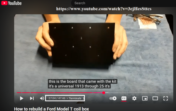

This link https://www.youtube.com/watch?v=3ejHesSttcs references the plastic board & has some good hints BUT the first 27 minutes of the video talks about the evolution of the box so you can skip to minute 27 by dragging the red line

I think you might have linked to the wrong video. I've seen this one, and it doesn't cover replacement of the wood bits; also, it's only 24:26 long, so there's no skipping ahead to 27:00...
Thanks all, really appreciate the input!
Sorry I should have added the link in the text not just the picture (correct above) This is the long video https://www.youtube.com/watch?v=3ejHesSttcs

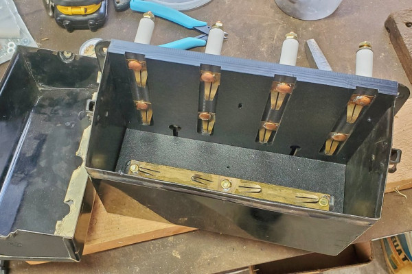

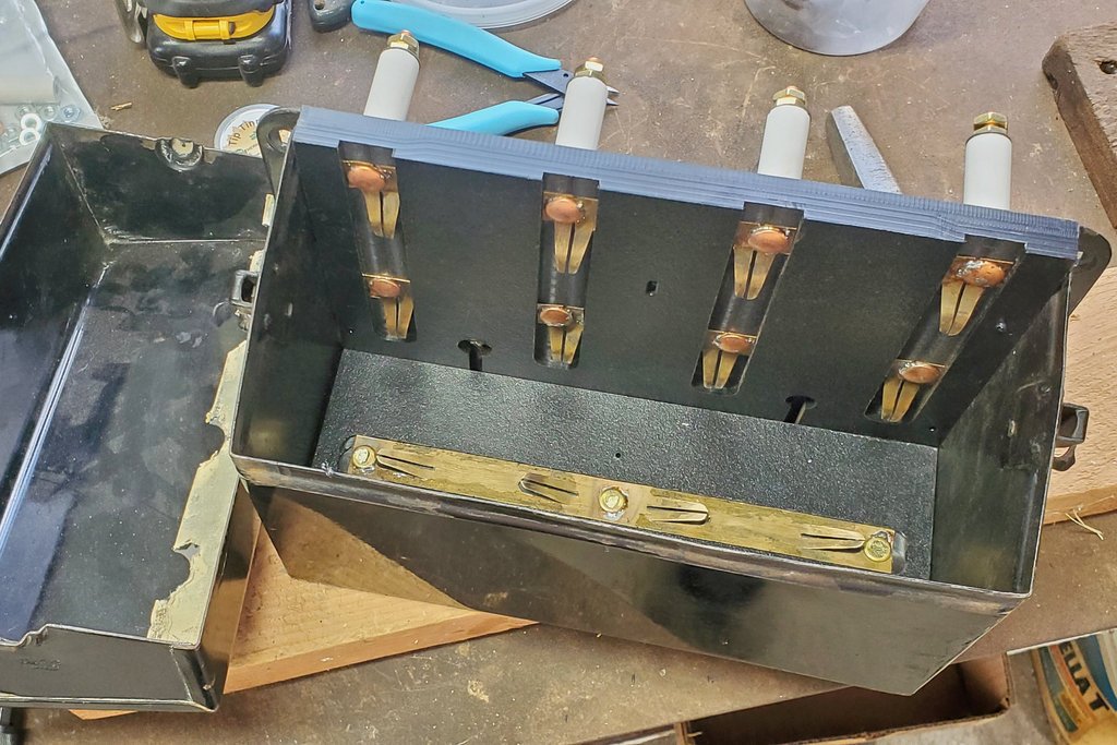

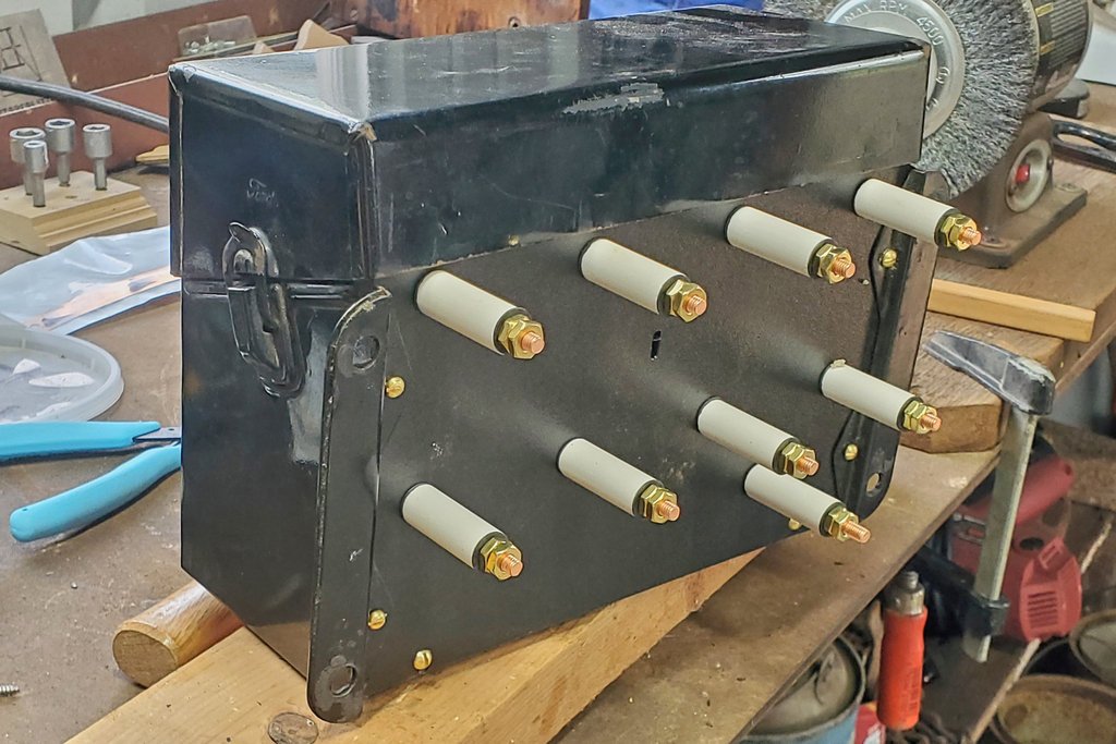

All done and ready to go, all connections properly soldered. Nuthin' to it, thanks everbody!

Are you still intending to install the brace, p/n 5002STP in the schematic shown above? It's a small but important piece.

I'll second that. The brace prevents the coils from bulging out the front of the box This results in the coils making poor contact. Some people start putting shims in as a solution causing a distorted box and more buldge

Actually, I thought about omitting it since it doesn't make getting the coils in and out any easier, and it seems to me like a properly fitting lid should eliminate any possibility of bulging. On the other hand, the coils shouldn't need to be swapped around much, if at all, and the phenolic parts should make it easier as well. In the end, I'll likely reinstall it since it's a very proper Model T move to make, and there are few things I admire more than a very proper Model T.
As an aside, the ill-fitting lid that refused to sit right or latch correctly on both ends simultaneously no matter what I tried is the primary reason for the rebuild in the first place, and now it goes on and off so absolutely perfectly it's scary. I wonder if it'll continue fitting as well once installed in the car? I think so, but we'll certainly find out for sure a little later today.
In the meantime my question stands: What does the little strut do that the lid, assuming a correct fit, does not?

Based on personal experience that strut is important and should be installed. Installed correctly, it maintains box shape and coil contact. Don't make it too tight (or too loose).
