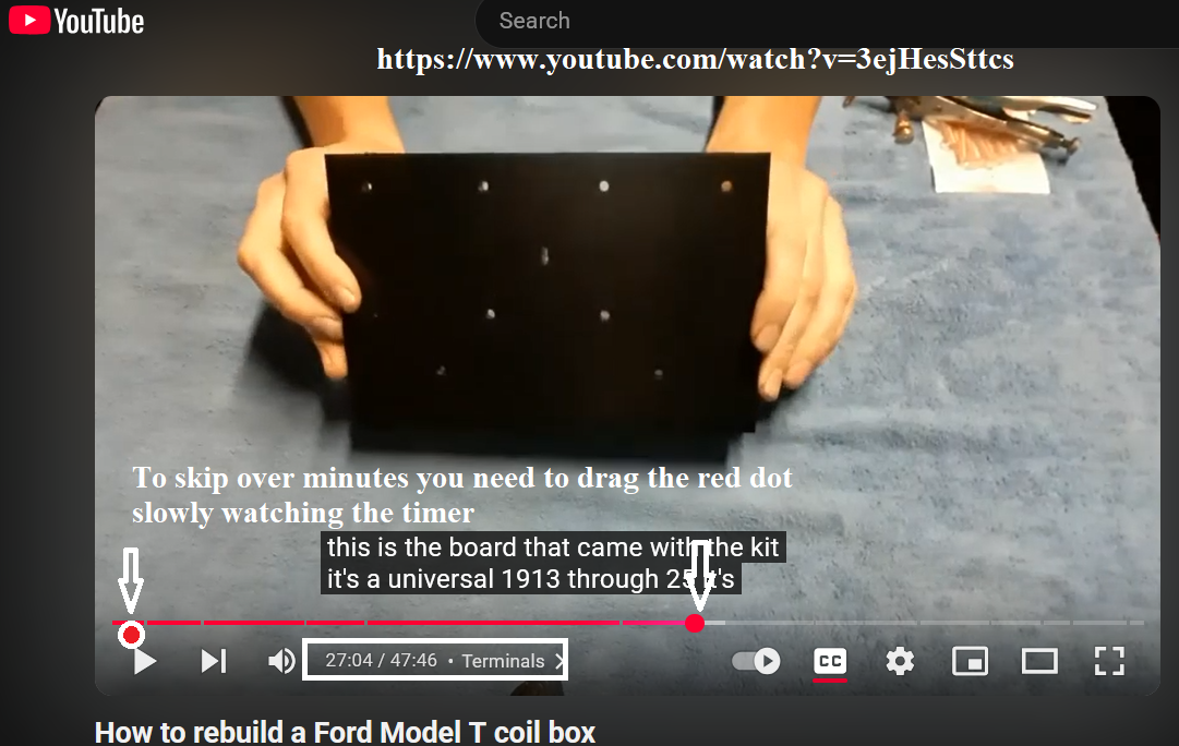

This the link to the YouTube Video that dinosBunny mentions below https://www.youtube.com/watch?v=r8jRwqF3MAY
This link https://www.youtube.com/watch?v=3ejHesSttcs references the plastic board & has some good hints BUT the first 27 minutes of the video talks about the evolution of the box so you can skip to minute 27 by dragging the red line

I think you might have linked to the wrong video. I've seen this one, and it doesn't cover replacement of the wood bits; also, it's only 24:26 long, so there's no skipping ahead to 27:00...

This the link to the YouTube Video that dinosBunny mentions below ... the first 27 minutes of the video talks about the evolution of the box so
Thanks all, really appreciate the input!
Sorry I should have added the link in the text not just the picture (correct above) This is the long video https://www.youtube.com/watch?v=3ejHesSttcs
