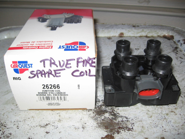

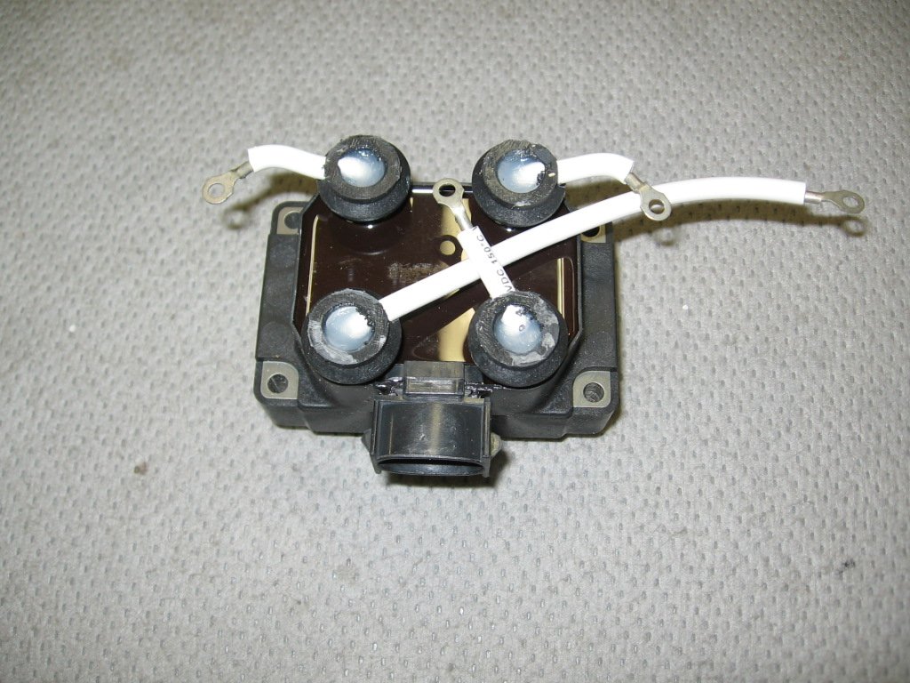

The coil inside the Truefire unit is a commonly available part, number 26266, for a Ford Ranger pickup if I recall. I bought a spare for myself years ago in case I ever need it (so far I haven't).
Mr. Bittner chose to use a unique setup for wiring the secondary output wires to put them in the correct positions to attach to the stock Ford ceramic terminals, here is a pic of one of his units:

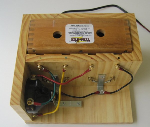

I have a TrueFire test set, but I have never been able to find the switching transistors in the Timer Cover.
The box is more reliable than the Timer cover.
The Test Set is simple to make.
A big wing nut, not shown, on the left rotates the Timer Rotor.
The metal uprights represent the block.

J1MGOLDEN wrote: ↑Wed Apr 30, 2025 6:35 pmI have a TrueFire test set, but I have never been able to find the switching transistors in the Timer Cover.
