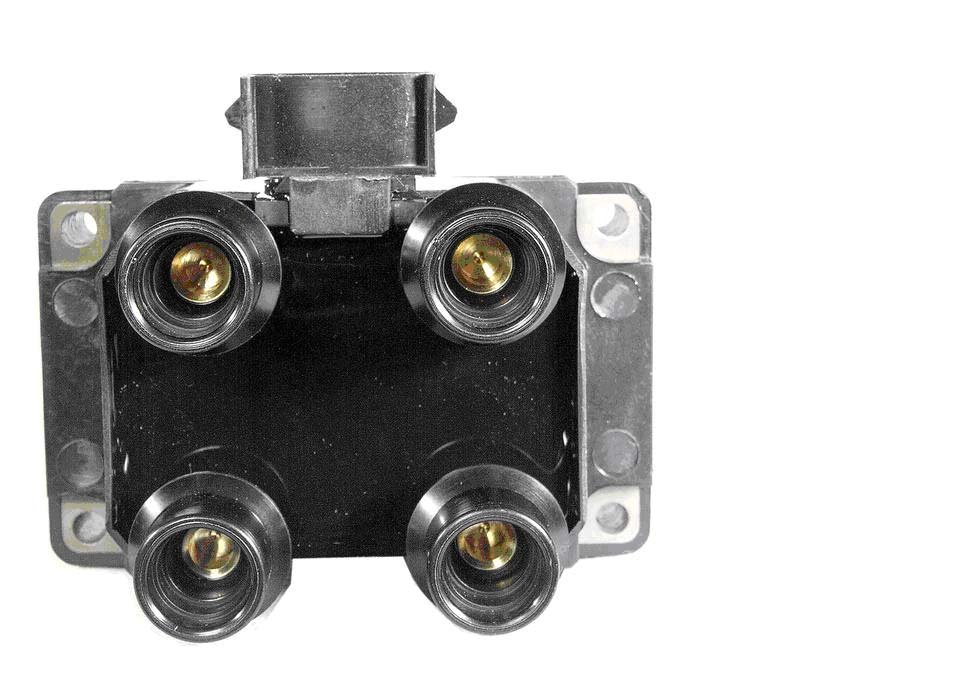

The coil inside the Truefire unit is a commonly available part, number 26266, for a Ford Ranger pickup if I recall. I bought a spare for myself years ago in case I ever need it (so far I haven't).
Mr. Bittner chose to use a unique setup for wiring the secondary output wires to put them in the correct positions to attach to the stock Ford ceramic terminals, here is a pic of one of his units:

Post by J1MGolden » Fri Feb 02, 2024 9:54 am
That part is available and common here.
The only problem is to make sure the wires are firmly attached and properly covered to prevent an arc over.

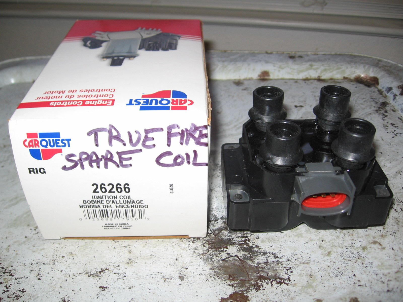

Note the availability source.
TrueFire Made in China.jpg (57.95 KiB) Viewed 5730 times
