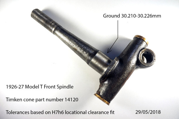

Re: Specification for spindle diameter?
These are the values I came up with when I looked into it a few years back. I don't know if these match the factory print.
In hindsight it would have been easier to contact the Benson Research Centre and asked for the drawing.

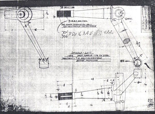

Drawing (can't see much) of 1 piece spindle. Discussion indicates 1906-1927 same diameter but a bit longer surface for roller bearings
https://mtfca.com/discus/messages/41194 ... 1391298332
Ok, so the drawing says 1.189 - 1.190 which would also conform to the 30.210 - 30.226mm measurements. I'll see if I can find someone to build up some material on the spindle and machine it back to spec. Thanks a lot for your help!
That’s what I ended up doing. I had mine metal sprayed and then ground to size.
