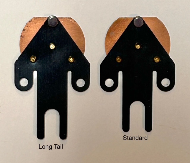

I found the reproduction Heinze spring steel was just a bit too thick so remade the points with a thinner vibrator. This addresses the issue of tuning the coils then finding they do not run well on magneto at idle.

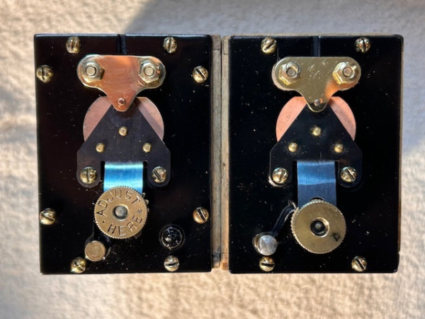

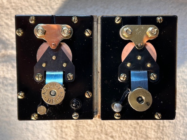

I did find an issue with some of the Heinze coil boxes that should be of interest for owners that run Heinze coils. Not sure if it’s a third party box or I variation the Heinze made. The issue is the adjustment knob is set back about .125” from the core.
These can be identified by a few differences, no writing on the adjustment knob and they use four brass screws instead of six. See photos.

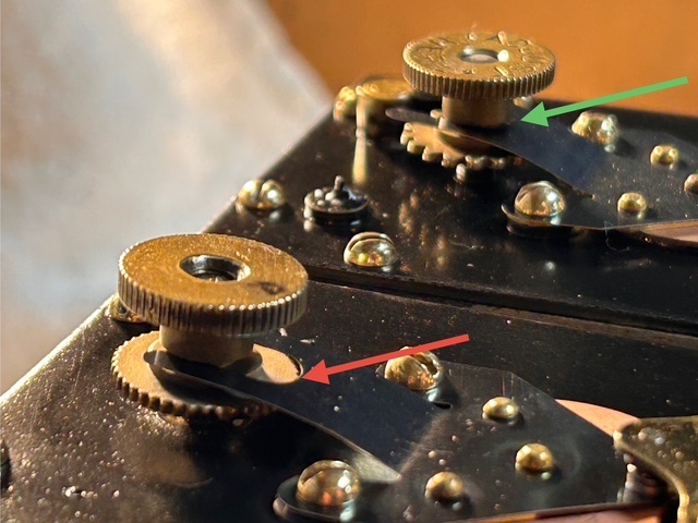

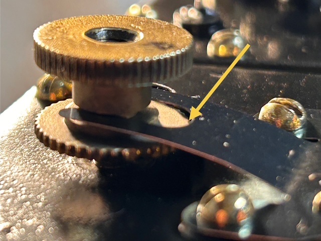

This becomes an issue if the replacement points are installed. As you can see from the photos the tail of the vibrator does not reach far enough to seat in the adjustment knob. This gap does not allow the tension on the vibrator to be controlled very well so the coil will not stable.
To correct this I made a point with a longer tail, this longer tail will reach the adjustment knob and allow the coil to be tuned correctly. Once tuned run just as well as the others.

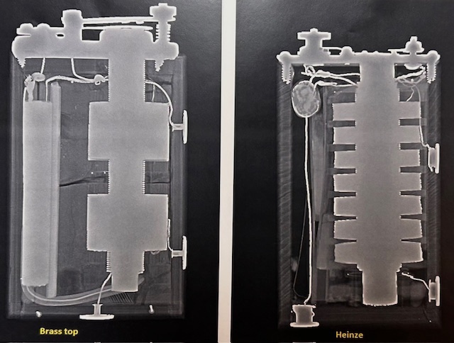

I attached a few photos of the original secondary coils since it is a unique design by Heinze, the other coil in the X-Ray is a brass top KW.
