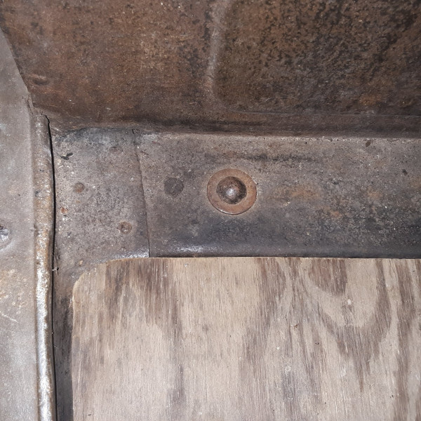

Here is a picture or the holding screw on my original early '26 touring

Thanks Mike,
My 27 does not have screw holes.
Is that a carriage bolt for the mounting bolt?
Thanks so much for all your info!
Brent
Brent

While my early '26 touring made it to me quite original and unrestored without excessive wear there are a few things that make you think.
And not just how it survived being in a barn that collapsed on it.
Only body bolts #2 on both sides are 3/8 carriage bolts with washers. The rest are all the expected 7/16-20 bolts.
I can not prove for sure if they belong or not but I put them back when I lifted the body to fix the engine years ago.
Being a just before Christmas car an assembly line worker may have thrown them in for an easy alignment.
So Yes, it has carriage bolts in the front passenger heel area and has had them for a very long time.
