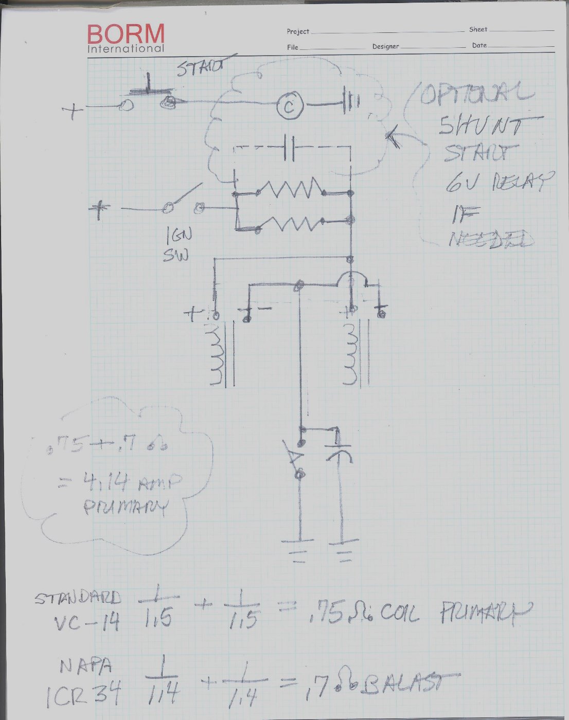

I am looking for any information on the wiring for using a Nissan twin spark distributor on a Bosch front plate setup. I have one of the distributors, the gears to reverse the rotation, and the front plate set up. It’s about time to get the thing together. Does anyone have a wiring diagram? Can I make it work with 6 volt?

Points. You'll need two 3 ohms 6v coils and a 1.5 ohms ballast resistor. I'll draw it up.

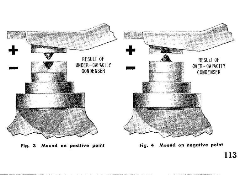

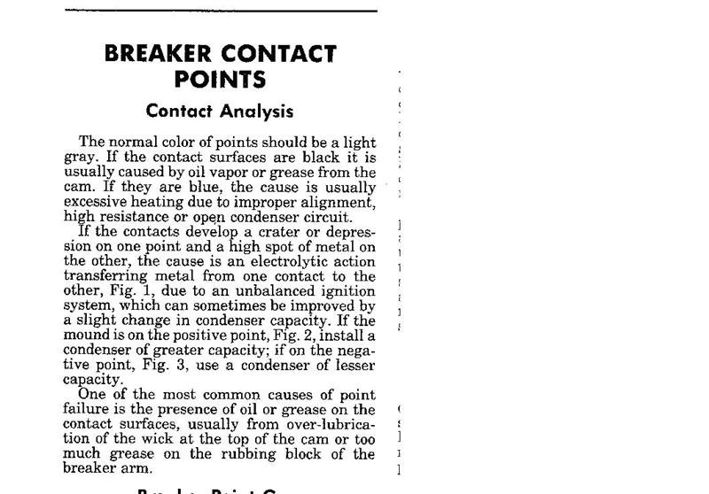

The capacitor will probably need to be increased. Since coil inductance in Henry's is not published, we may have to experiment.

Post by big2bird » Sun Jul 27, 2025 5:15 pm

Okay Morgan,
All 6v coils seem to be 1.5 ohms primary, which make since. 6volts/1.5 ohms =4 amperes.
Two coils in parallel will give you .75 ohms load, so .75 ohms in ballast is required to limit the current to 4 amperes at 6 volts.
Standard motors VC-14 seem to be the ticket. They are blue now, but you can paint them black.
NAPA ICR-14 ballast rates at 1.4 ohms ,so that is about .7 ohms in parallel, giving a primary current of 4.14 amperes. A tad high, but on a 4 banger should be fine.
I drew in an optional shunt to bypass the ballasts at start, in case the starter draws the voltage too low for a quick start. I run a 6 volt system, and have not had a n issue, but with dual it may be an issue.
I have also shown a condenser diagnostic chart in case we need to change the condenser value.
Be advised with dual propagation, your peak cylinder pressure will occur sooner, so you will have to retard the advance to adjust for this.
