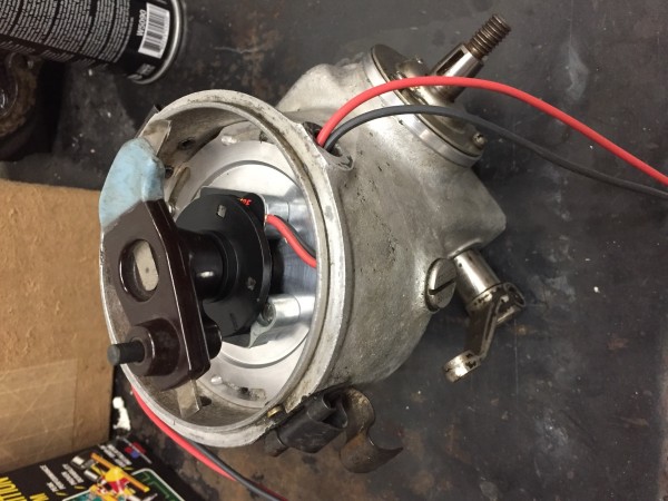

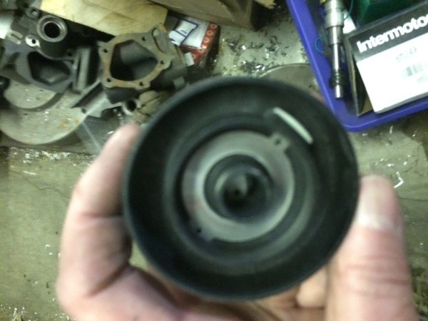

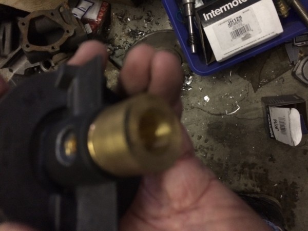

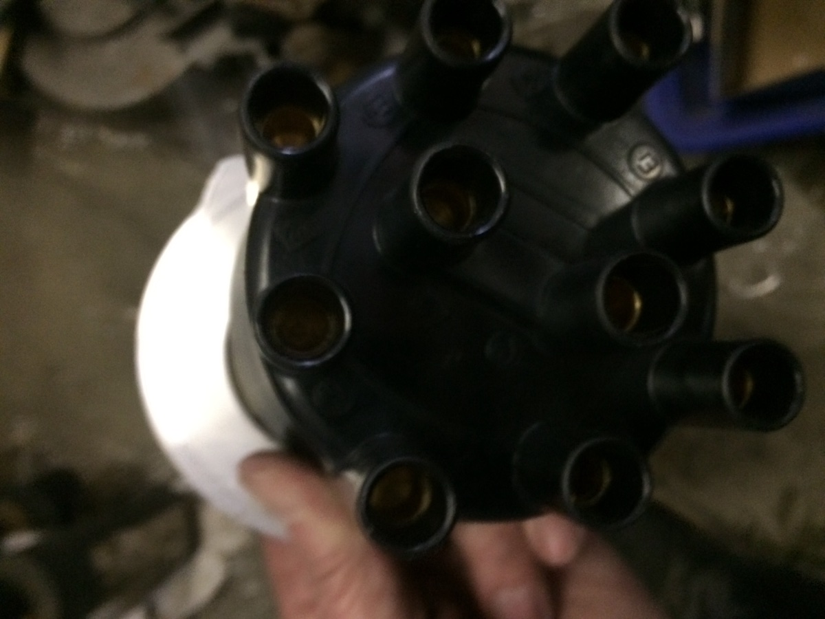

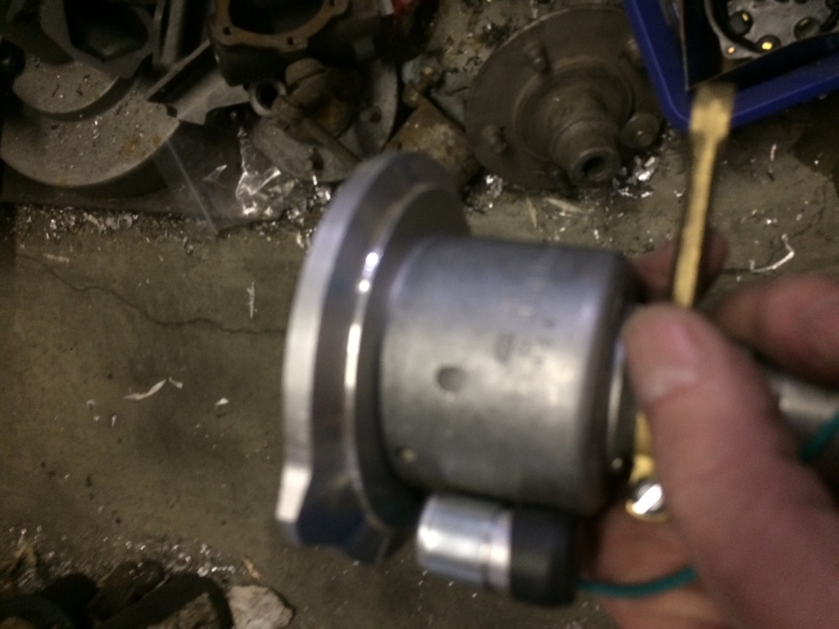

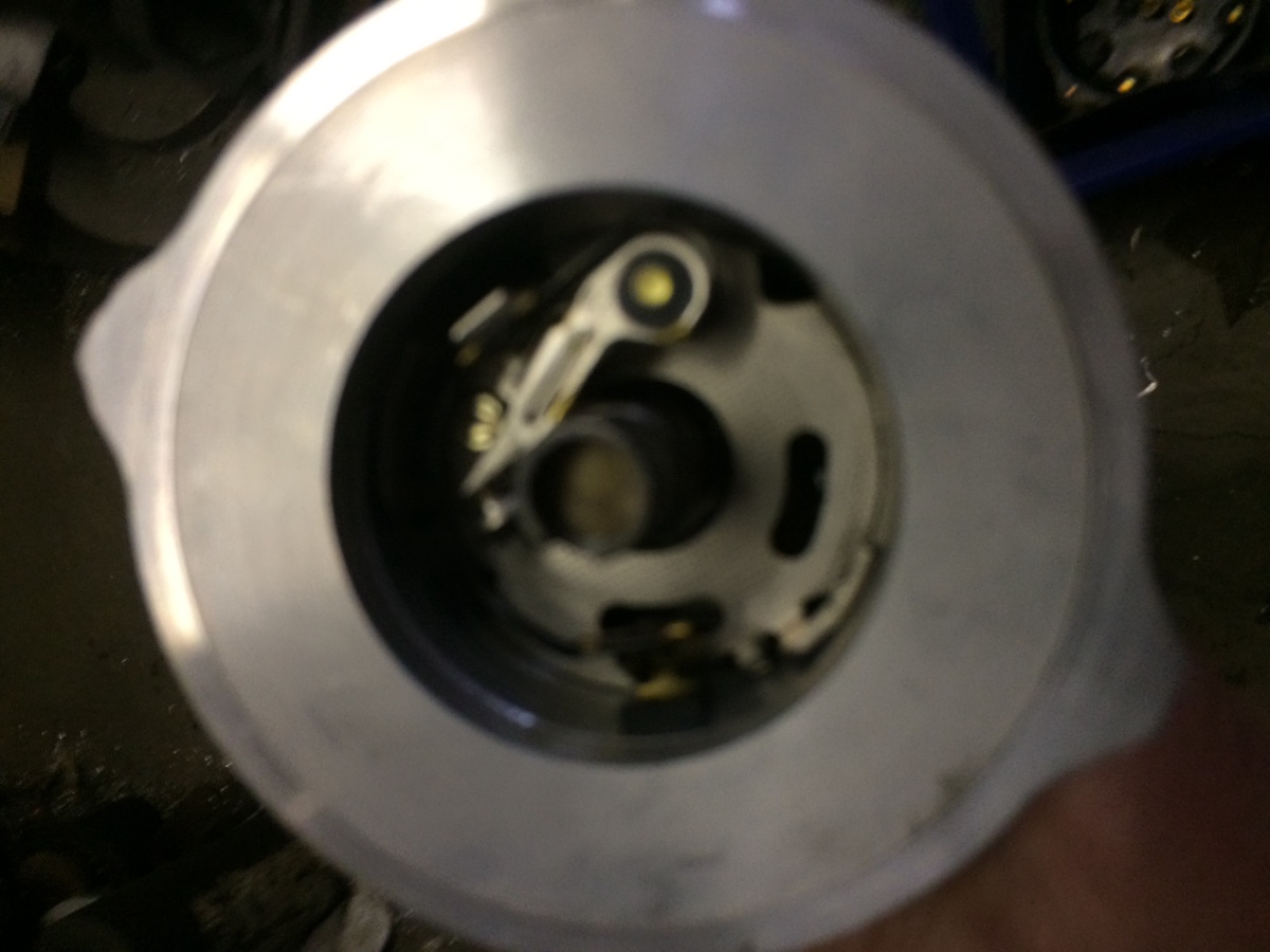

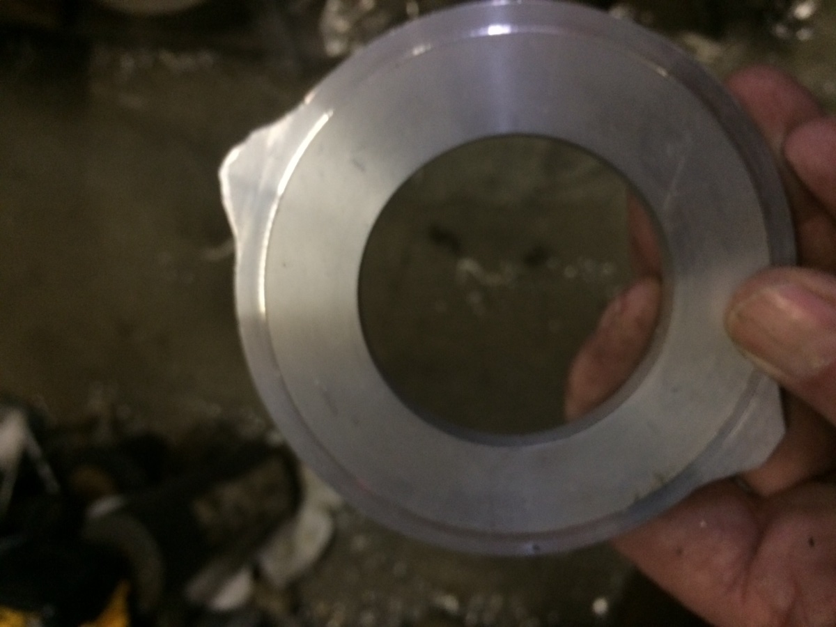

First picture is cap to Bosch distributor adapter
Next Nissan dual plug distributor cap

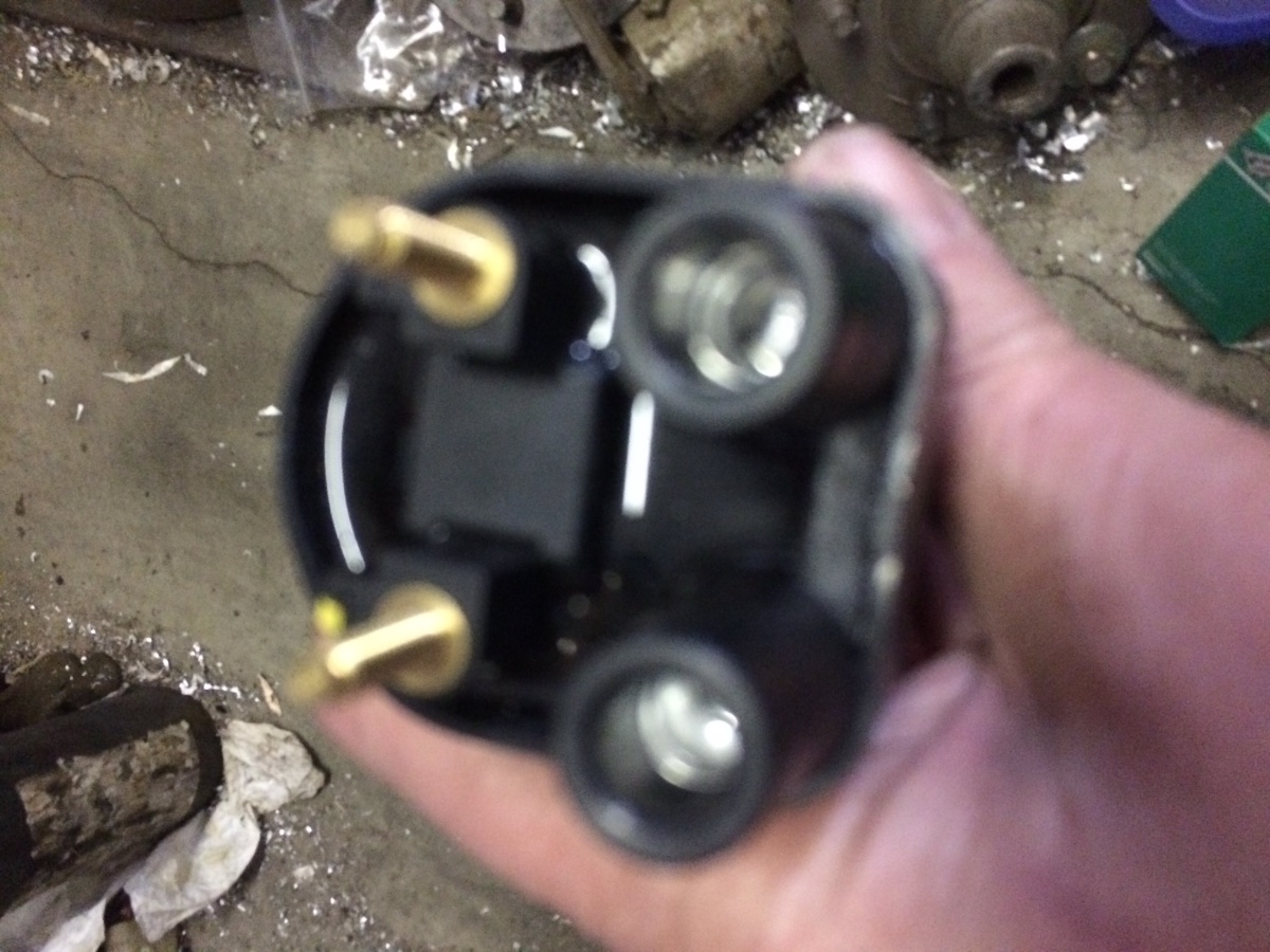

Finally Onan dual plug coil

In my case I used a distributor that bolts onto the T. Made two simple adapters and bought a available coil that is designed to fire two plugs at the same time. Simple basic ignition system!

All I will say is I spent at most 2 hours making the two parts to convert the Bosch front plate distributor. I consider that pretty “easy peasy”.

Les, I’m wondering about the Onan coil...? Is it for a 2 cylinder engine with waste spark ignition?? Or is there 2 separate coils cast into one housing?? Do you intend to add a second set of points to the 009??

The Onan coil is for a two cylinder engine and fires a “waste” spark each time. The points run off of the crank shaft.
