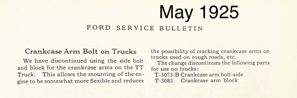

Ford quit using the wood blocks on late TT trucks, citing issues with trucks used on very rough roads. The point made above about engine grounding is a valid one. If you look at the way the T chassis is built, you will see that the engine unit serves both as a frame crossmember and as one of the 3 mounting points of both the front and rear axle. If you mount the engine loosely, you can expect less stable tracking. You also risk enlarging the engine mount holes in the frame and having the engine mount bolts girdled due to vibration and chassis flexing causing movement between the bolt and the frame. You will also compromise the electrical pathway of the starter motor circuit. There is no valid reason to put anything under the rear motor mounts, and several good reasons not to do so. Your car; your choice.

Somewhere in Ford literature, probably a late era service bulletin, there is a paragraph or two about deleting the wood blocks on TT trucks in severe service on very bad roads. I probably came across it on the Cimoreli site, but I don't remember for sure. If I had a TT in severe service on bad roads, I'd consider using one of those belly sling devices. Keeping the springs well-oiled would help, too, by reducing the amount of flex the frame would have to bear. That's true of a T or TT operating on very bad roads or under heavy loads. If I come across the information again, I'll make a note of where it is.

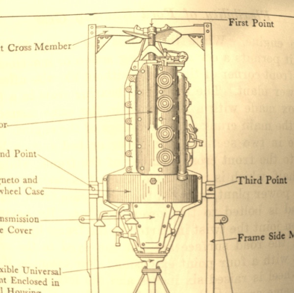

TXGOAT2 wrote: ↑Fri Aug 22, 2025 11:07 amSomewhere in Ford literature, probably a late era service bulletin, there is a paragraph or two about deleting the wood blocks on TT trucks in severe service on very bad roads. I probably came across it on the Cimoreli site, but I don't remember for sure. If I had a TT in severe service on bad roads, I'd consider using one of those belly sling devices. Keeping the springs well-oiled would help, too, by reducing the amount of flex the frame would have to bear. That's true of a T or TT operating on very bad roads or under heavy loads. If I come across the information again, I'll make a note of where it is.
Here is that info, remember though, the TT has a larger and thicker frame, so there is less flex than a T, but the TT was usually hauling huge loads on roads as you described. Plus this is a late change in 1925
How this really helps from preventing crankcase arm fractures is for me an unusual result of eliminating the larger TT wood block and side bolt. Would be interesting to know the engineering of that deletion.
IMO, doing the spring thing, where the block is removed and the upper bolt has a spring under it on a T frame isn't the best way at all.
Ford used the best designs for the lightweight T, with 3 point suspension of the engine, front axle, and rear axle.

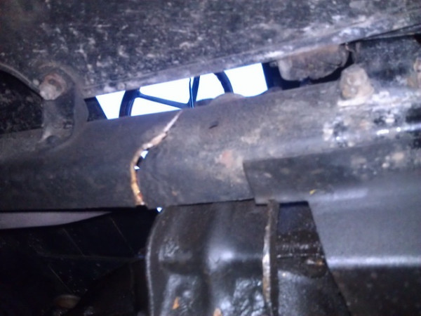

T chassis found with missing wood block and bolt resulting in this
- Posts: 7830
Re: Engine Install
I think broken pan arms and broken frames are the result of high service hours under harsh conditions, or outright abuse. A lot of cars probably ran with collision damage, too, not to mention dry rusty springs and built up springs to carry extra loads.

Hi Rich,
As I see & understand one of the genius of the T design is the flexibility of the frame enhances the suspension. Having the engine pan act as a
crossmember allows the frame to twist the same as the suspension, notice everything is mounted on three points so it can pivot in a arc.
The front axle pivots in the ball on the wishbone, the rear axle pivots in the fourth main (ball cap) & the engine pivots in the front motor/engine
mount. If the engine didn't pivot in there the engine pan would be twisting all the time & misaligning the forth main making everything unhappy!
Add years of rust under the pan ears & bolts & the starter has to ground on the nose of the pan and if that is rusty you get arcing when you try
to energize the starter. I install a battery cable from a bolt on the pan to the same place as the battery is grounded or as close as I can to the
frame. That way the starter is not grounding or arcing @ the mounts. I'm sure this was not necessary when T's where new.
Sometimes we forget that the ground is the other half of the electrical circuit.

I appreciated the refresher on the multiple “3-point” arrangements on a T that make them a superlative off-road vehicle !
