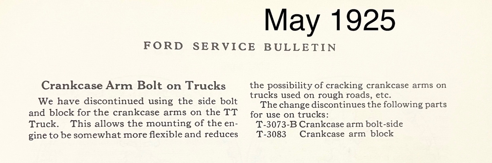

Somewhere in Ford literature, probably a late era service bulletin, there is a paragraph or two about deleting the wood blocks on TT trucks in severe service on very bad roads. I probably came across it on the Cimoreli site, but I don't remember for sure. If I had a TT in severe service on bad roads, I'd consider using one of those belly sling devices. Keeping the springs well-oiled would help, too, by reducing the amount of flex the frame would have to bear. That's true of a T or TT operating on very bad roads or under heavy loads. If I come across the information again, I'll make a note of where it is.

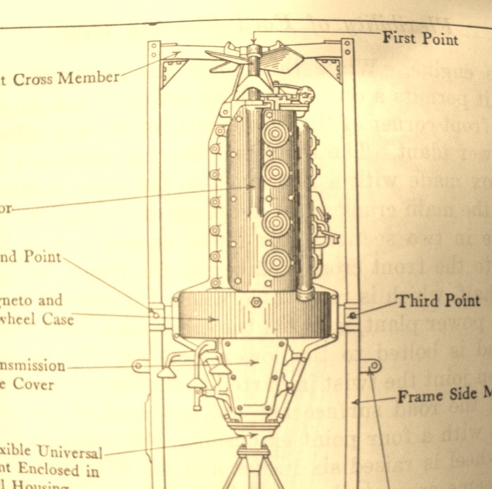

Here is that info, remember though, the TT has a larger and thicker frame, so there is less flex than a T, but the TT was usually hauling huge loads on roads as you described. Plus this is a late change in 1925
How this really helps from preventing crankcase arm fractures is for me an unusual result of eliminating the larger TT wood block and side bolt. Would be interesting to know the engineering of that deletion.
IMO, doing the spring thing, where the block is removed and the upper bolt has a spring under it on a T frame isn't the best way at all.
Ford used the best designs for the lightweight T, with 3 point suspension of the engine, front axle, and rear axle.

Re: Engine Install
Post by TXGOAT2 » Mon Aug 25, 2025 2:47 pm
The rear engine mount to frame bolts are the primary electrical system ground point. You don't want starter current, or any significant portion of it, passing through the front engine mount, the gas line, or the control linkages. Even if you don't have a starter or a generator, you still need a reliable engine to frame ground for the ignition circuit and the electric lights, if any.
