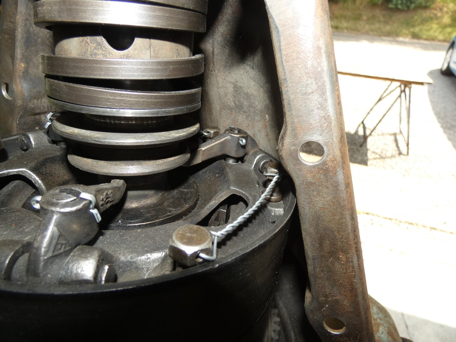

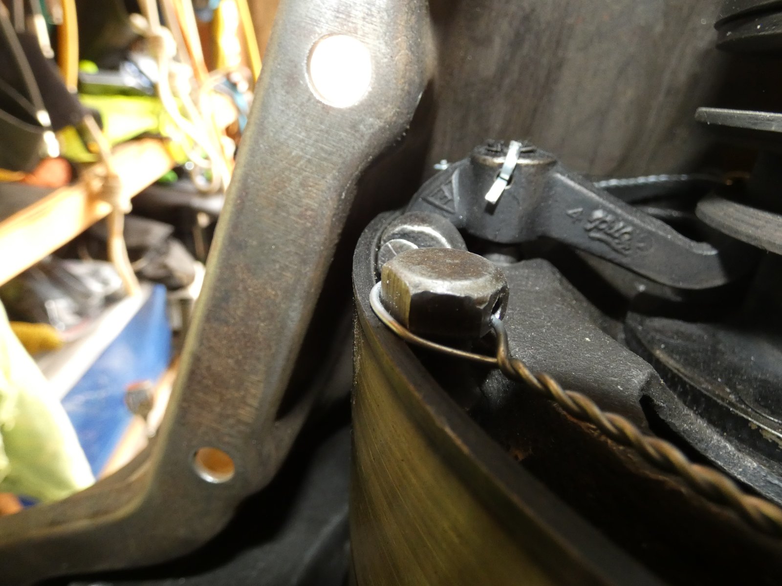

somewhere during this post there were photos asked about the oilpan and the wide drum.
A few rebuild ago I found this:
The original engine has a wide drum and a carterpan with the small inspection cover. I don't know how the previous rebuilder arrived mounting it on the engine. Here a few photos of the problem.
I changed the carterpan with a right one.
The two last photos are the wrong pan.
Good luck
Andre
Belgium
