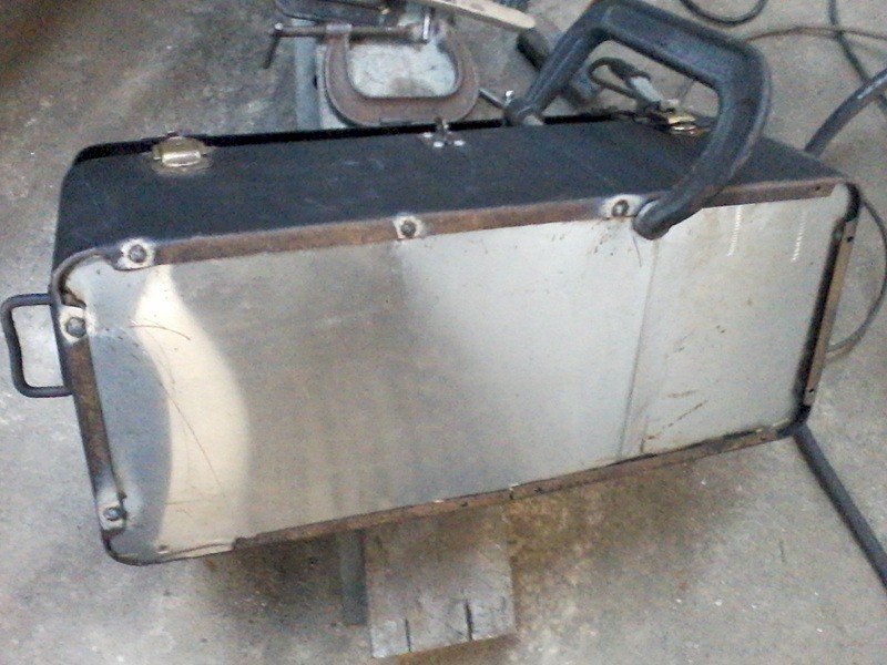

I have this old Craftsman toolbox and I plan on drilling four holes in the bottom of it to bolt down onto the running boards on the same 4 bolts near the front on the driver side. Should I put something under the box so it doesn't mess up the running boards or would it be fine metal on metal? Amd any other tips for mounting this tool box to the running board? Or potentially a better spot than that, though I can't think of any better spot.

On one application, I used a sheet of adhesive cork. However, any material that traps moisture underneath may cause rust. It needs to keep dry.
On my present toolbox, I just left it in the trunk, under the deck lid, not bolted down. Also, the bottom of my toolbox was rusted out. So, I welded in a new stainless steel bottom.

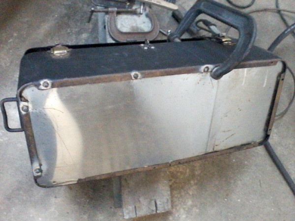

Here is what I had to do...
Vern (Vieux Carre)

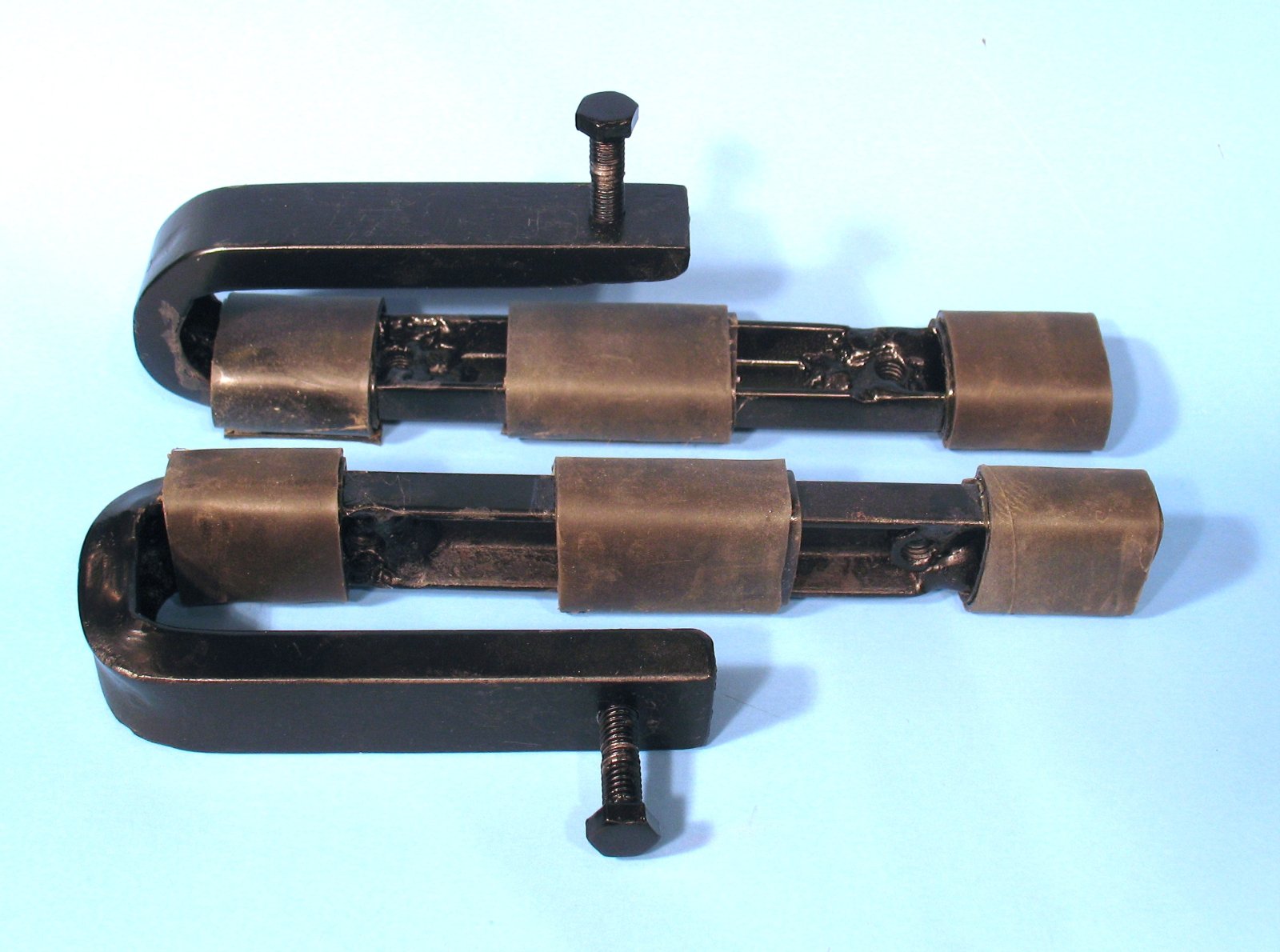

You don't have to drill any running board holes if you make clamp-on mounting brackets.
