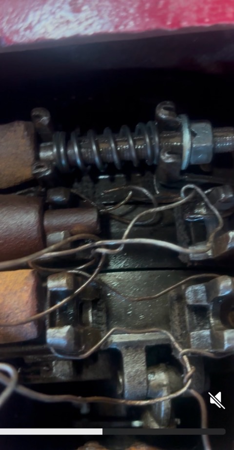

I recently replaced the brake band on my Model T and ended up doing it in a way some of you might appreciate (or laugh at). I didn’t have the proper band-changing tool available, so I improvised with bailing wire to snake the new band around the drum.
I also chose to do the whole job in the car, without pulling the hogshead. It took some patience and a few choice words, but it ultimately worked. I filmed the process in case it’s helpful to others, or if anyone wants to comment on better techniques or things I should try next time.
Here’s the video if you’d like to take a look:
https://youtu.be/Mfq15zHDguA?si=tIYA2AfIvGVJao_Y
I included both real-time footage and some high-speed sections to show the fiddly parts without making it a long slog.
Would love to hear how others approach band changes in-car — tips, tricks, or tools you swear by.

No laughing here. I used a Oxy-Acetelyne welding rod. You can also use a coat hanger to do it. 1” banding also works OK. The 1” banding with a split brown handle about 6” long makes for a good handle for it too.

Thanks, John! Good to know I’m not the only one who’s improvised a “band tool” out of whatever was on hand. A coat hanger or welding rod probably would’ve saved me a little grief, but the bailing wire did the job in the end.

Changing bands in a finished car is the best selling point for Kevlar. At 6'3", its just flat horrible.

I just finished putting a motor together and I don’t have the band clamp tool so I wired them all up with baling wire. Good for making cotter pins if you can’t find one, I’ve got it holding the muffler up on my 88 GMC where the tailpipe rusted in two as well.
Posts: 5583
Re: Old-Fashioned Model T Band Change: Bailing Wire Method
Post by RajoRacer » Mon Nov 24, 2025 2:06 pm
I use nylon zip ties to hold all together whilst replacing the cover - they USUALLY slip out from under the band ears but being nylon, if a small piece goes AWOL, it really can't damage anything.
Took the words right off of my keyboard! If ya lose some part yep they'll just be ground up!

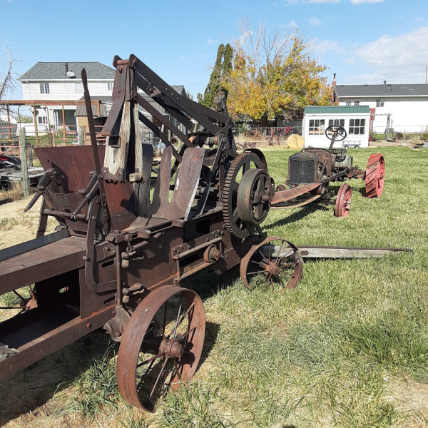

Not to confuse the issue, but here is a wire tie baler in operation. It's a 1922 Missouri Mule hay press. And hit to keep the discussion on task, Sammy T Shaw, is providing the power. Sorry we were'nt baling that day.
Enjoy, Kevin

Thanks for all the responses! I didn’t expect a vocabulary lesson, an engineering lecture, and a comedy show all at once, but here we are. I really enjoyed reading everyone’s explanations and learning from you all. I had no idea my misspelling of baling would take on a life of its own and spark so much discussion—apparently one wrong vowel can start a small linguistic wildfire. Lesson learned.
I also appreciate the comments about using Kevlar or similar materials to avoid having to redo this very often. That definitely makes sense, and I can see the long-term value in investing in something built to last.
And truly—I appreciate all the input, even the teasing. It’s part of what makes this group fun. Thanks again to everyone who jumped in with advice, corrections, and a good laugh.
Also, Robert mentioned “no attempt to true up the band to the drum before installing the lining.” I thought I had done that by fitting the band around my drum jig (as shown in the video), but I may be missing something. Robert, could you explain what I should look for or do differently? I’d really like to understand this better.

I might add that I mount my linings to the bands then soak in an old Dutch oven - takes 1 gallon of oil but can do all 3 at the same time with small sticks holding them slightly apart - a couple days soaking then I hang them over the pot with sticks to drip off - still messy but not as messy as doing it your way.

kevinf wrote:
Tue Nov 25, 2025 12:18 am
. . . a 1922 Missouri Mule hay press . . .
Kevin, many thanks for posting that !
(Worth noting these early “hay presses” worked stationary. Hay had to be brought to the press, as opposed to the “modern” balers that would pick up windrows in the field.)

. . . I mount my linings to the bands then soak in an old Dutch oven -
I do the same thing, Steve. I believe it makes a big difference in how cotton linings wear. FWIW, the Ford manual recommends it !

. . . Robert mentioned “no attempt to true up the band to the drum before installing the lining.” . . . ?
Just about every T owner who has changed bands a few times will have his own ideas, and will prefer methods (or the lack thereof) that work best for him. T’s are rugged and forgiving, so there’s a pretty wide gamut of what will “work”.
That said, anyone who has worked on any number of Ts will have noted how band linings wear unevenly, sometimes to the point of failure, when the bands are out of round or sprung. They still work, though !
The best service and performance is to be had when the band is concentric with the drum, and not bent or distorted in some way. Truing the band is best accomplished before installing a new lining. It’s for this reason I have never liked the “quick change” removable ear bands snaked through the trans cover inspection opening.
It’s all fun and challenging, and learning the ropes is the essence of the hobby ! (fun for some, not for all !)
:lol:
Rich,
I appreciate your sag advice. Similar to any of todays oils work, but some are better...
