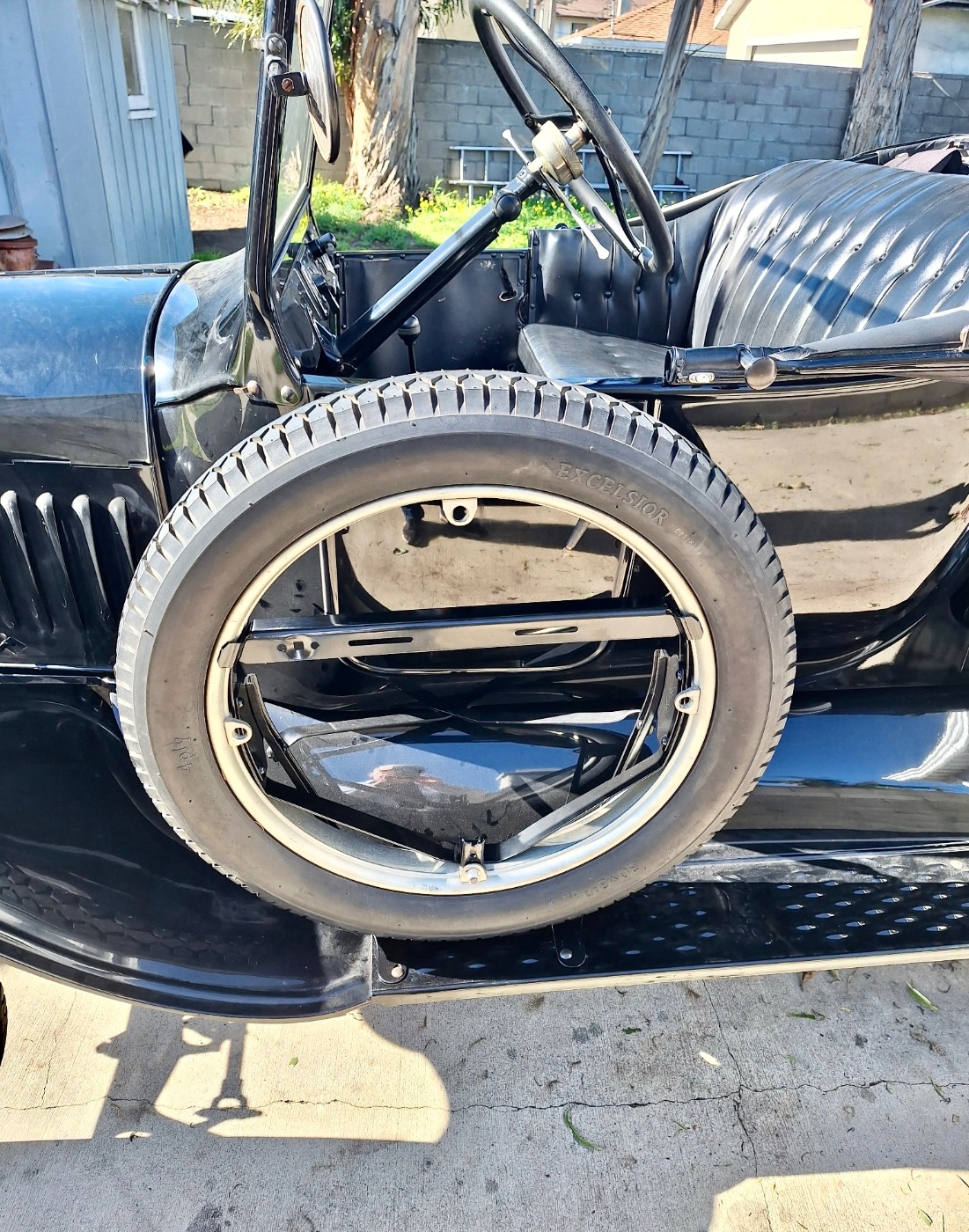

“Original” Smith just installed a side-mounted spare on his 1925 roadster pickup. Looks sharp, almost sporting - and really changes the look of the car.

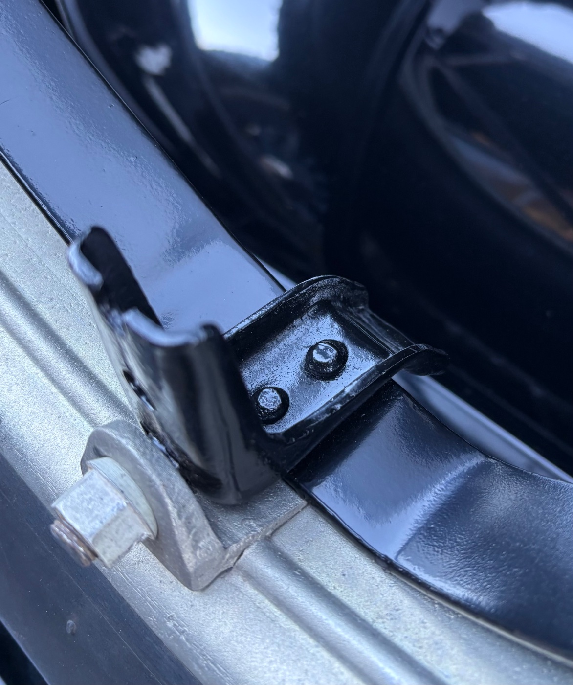

Me wonders how stable the tire sits. I dont see an upper attachment to the body. Maybe well hidden.
Clean & attractive as expected.
Posts: 7257
Re: Side mount on a ‘25 pickup
Post by Allan » Sat Jan 10, 2026 7:03 pm

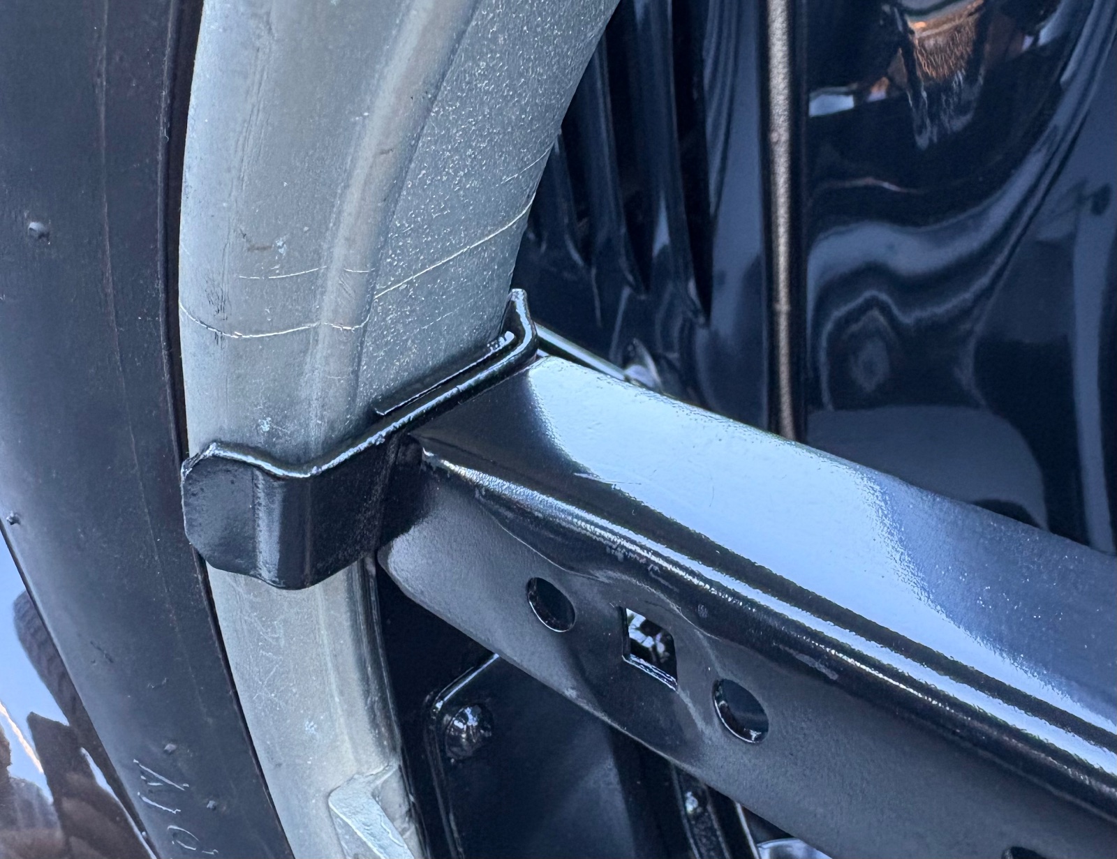

looks like it is held in place by using the inner bolts that bolt the running board and the fender in place. Neat work, requiring no new holes. Extra support/stability could be had by extending the lower mounting base to utilise the outer bolts also, again drilling no new holes.
It sure beats making a mounting from scratch.

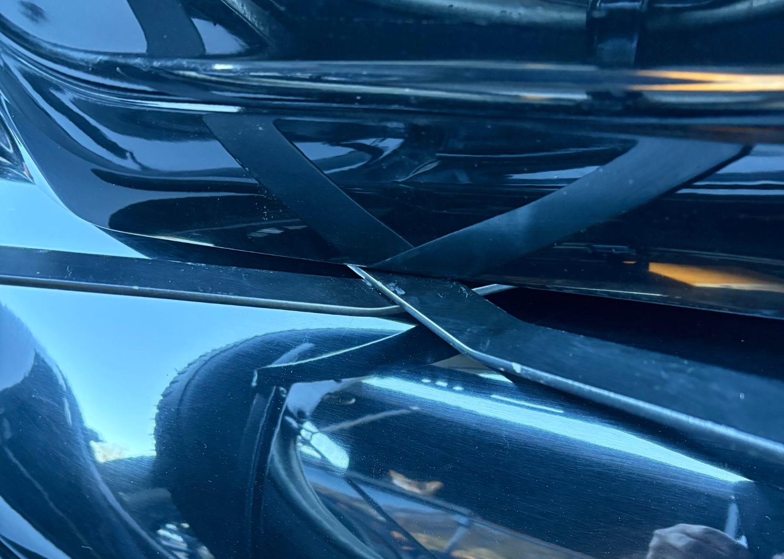

Original Smith’s slick new side tire-mount at today’s San Diego Excursion, hosted by the Ness brothers.

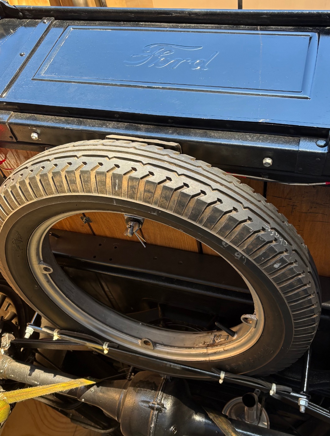

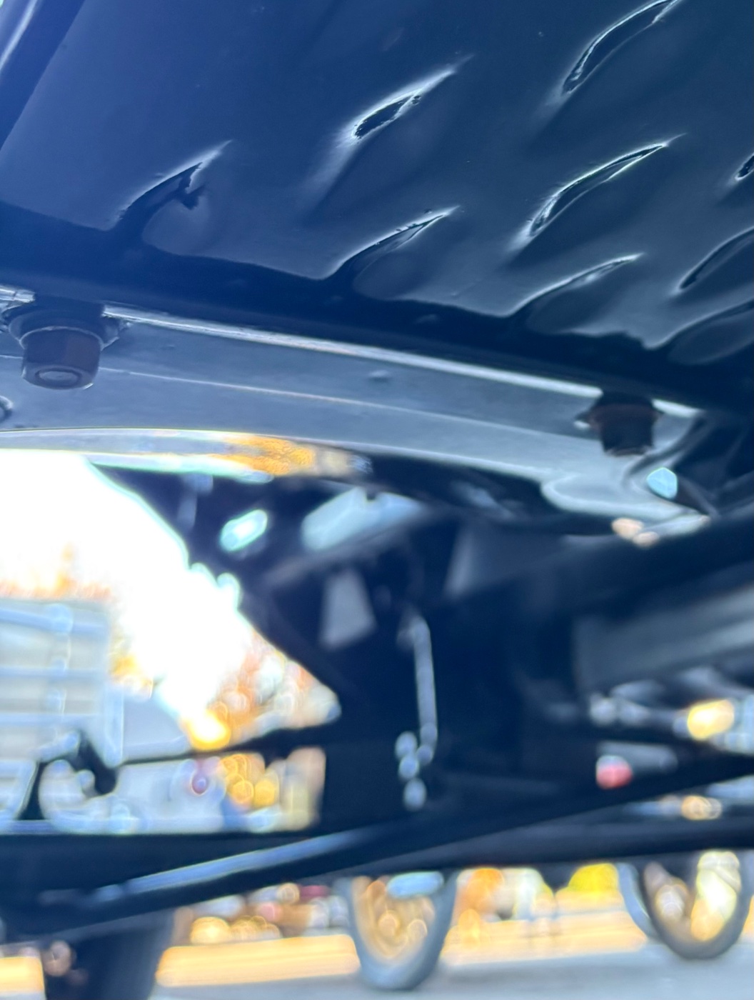

A few more details.
Original Smith’s
Original Smith’s
Original Smith’s
Original Smith’s
‘26 Ford Under Bed Mount

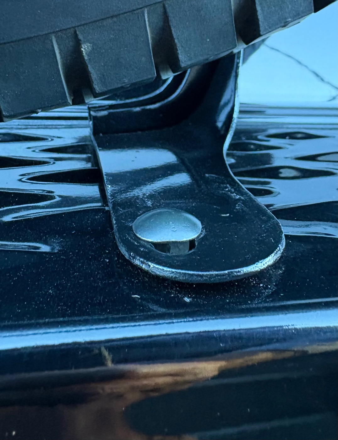

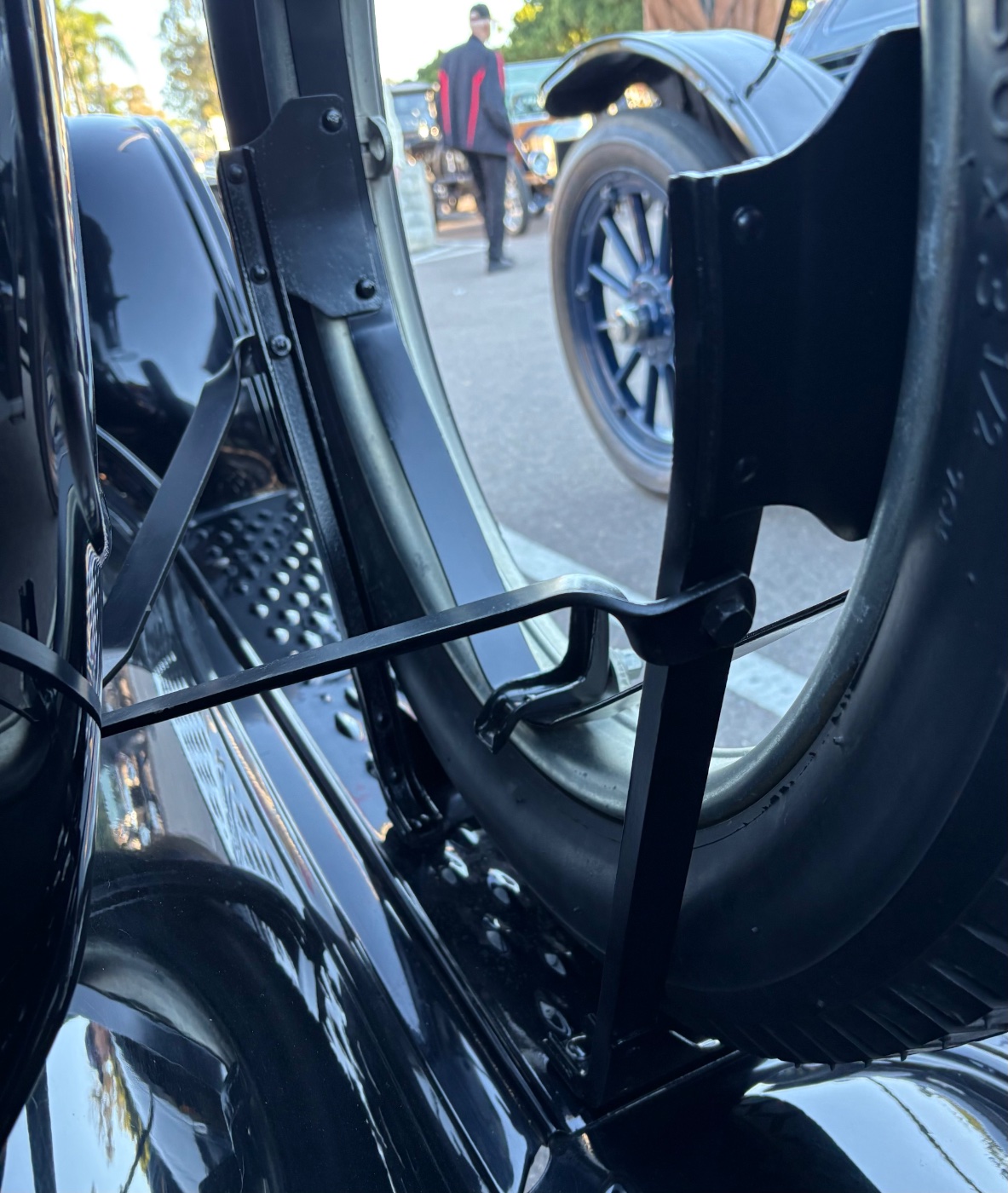

I see the struts going to the body above the splash aprons. Thats the extra attachment that limits the wiggle. Good show.

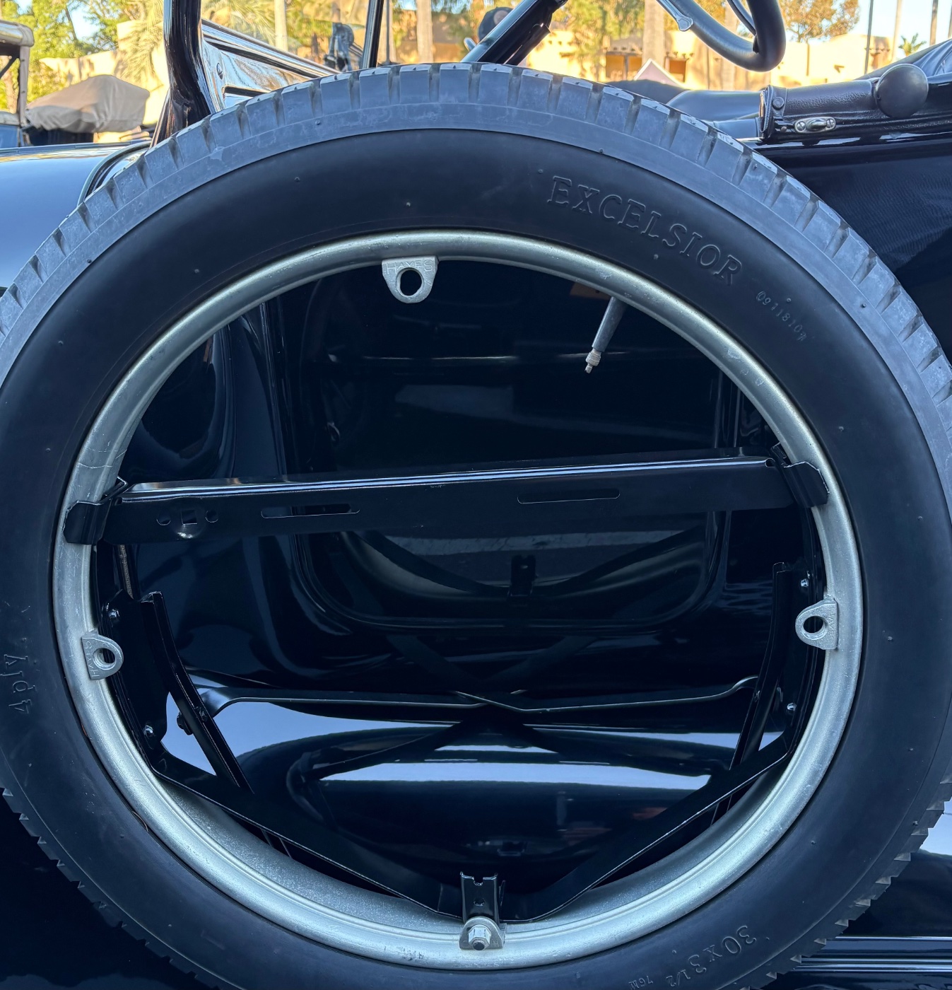

Being an Original Smith car, I hesitate(Not really) to point out that the spare is mounted incorrectly on this carrier.
Forgive me Larry.

How's that, John ? I was always learned to have the stem pointing down to prevent water entering.

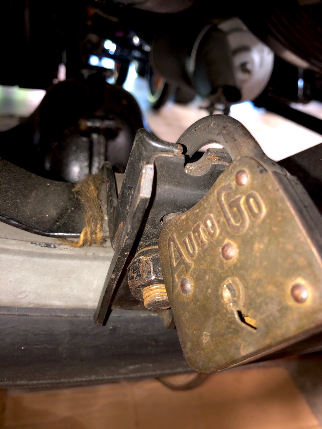

Is the 2849-D Spare Rim Carrier Clamp
And for safe keeping of that expensive tire and rim, add a padlock ;)

Actually upper rim lugs should be evenly spaced to the mount ears on the topside. turn the rim CCW about 45 degrees. The stem would left of center.
There is a clamp that holds the rim in (not thru a mounting lug)
#2849D "spare rim carrier clamp outer 19-25"
The nut holds the clamp in place. Above is a hole & slot matching the carrier mount as you see there. The hole & slot are meant for a padlock.

The first photos were posted because I don't know how to post a photo from my cell phone. This carrier was purchased by me many years ago. I restored it and hung it in the garage for several years. I decided to put it on finally and the photos show the result. This is an original aftermarket tire carrier that uses the original Ford carrier in the center. The two brackets that attach the unit to the running boards are adapted to the original. There are two straps that offer stability to the unit. One goes to the front body mount, and the other goes to the rear starter switch bolt. I drove the car on a tour down in San Diego yesterday, and the unit seems to be happy in it's new location.
