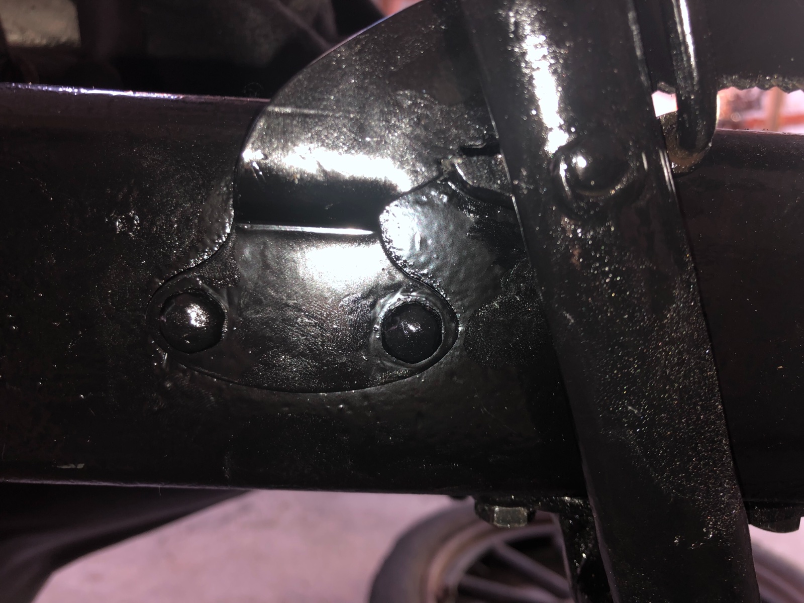

I am at the same point on my 11. With the lever fully forward where does the pawl end up on the quadrant? I welded and shaped a new tip on mine and it stops on the last or most forward tooth on the quadrant. Should it go beyond that? Also someone has straightened my brake rods. Can someone describe the bends at the rear?
- Posts: 6797
Re: Initial E-Brake Installation and Adjustment
Art
it looks like you're fine
