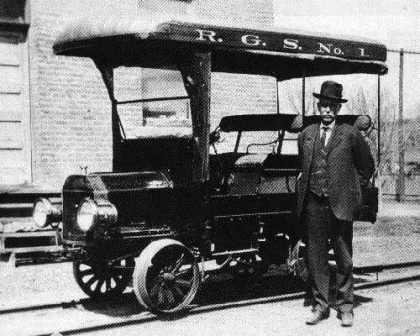

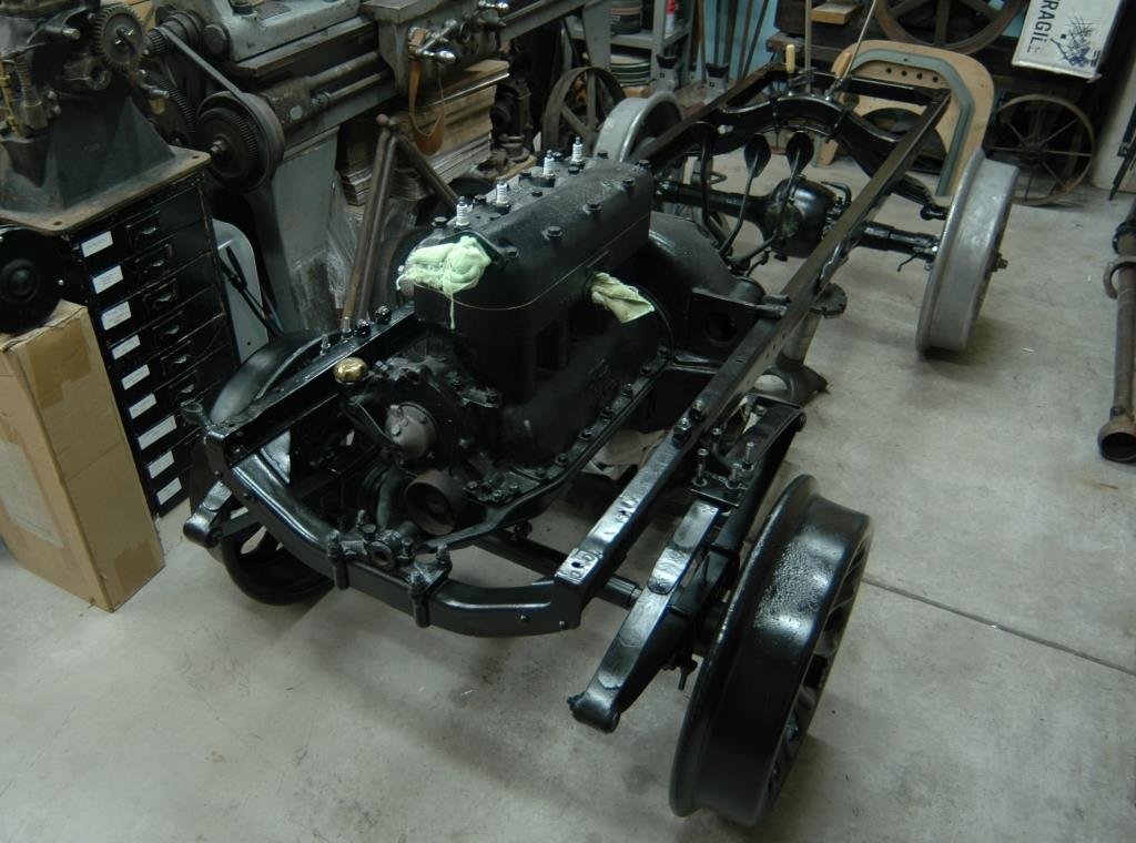

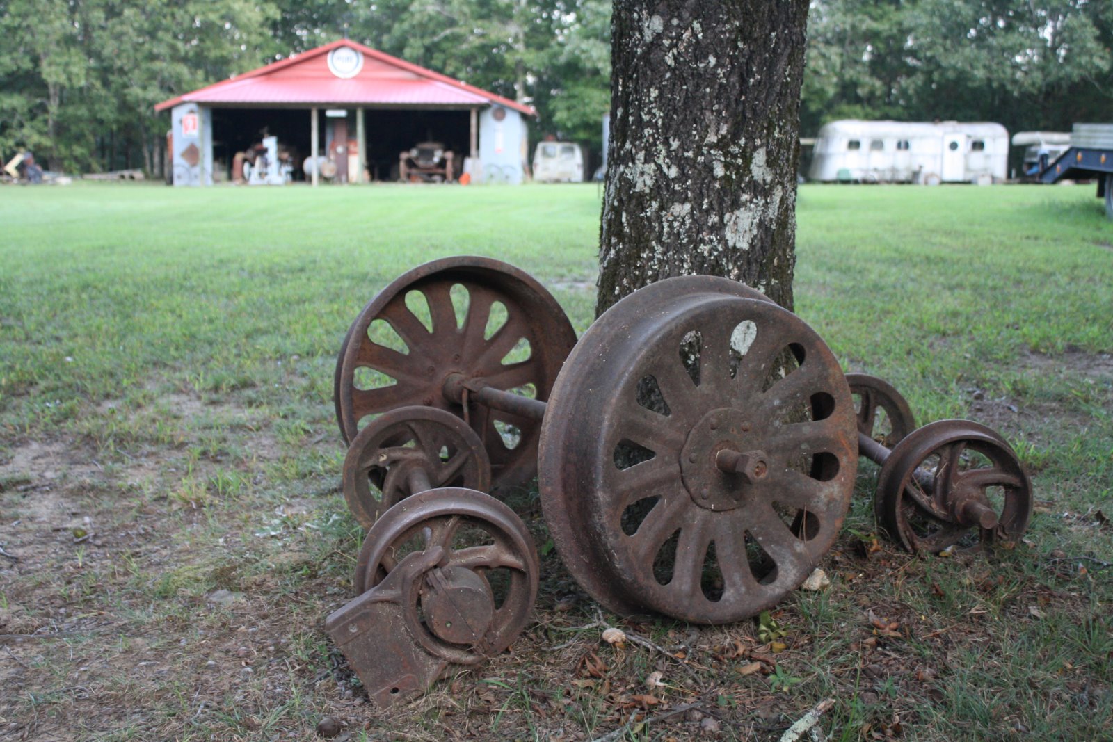

Im getting close to the end of the speedster project. So Im looking at "Next" projects ... I have this really neat set of railroad wheels and a picture. I think that is plenty enough to start a project with. :) Ive started with less .......:)
I would like to copy the picture and build the railcar. We have a defunct railroad in this area of Arkansas that I have been collecting items that pertain to that railroad line. I would like to build it as close to the photo as possible and then paint the words "Missouri and North Arkansas" on the canvas side curtains. The Missouri and North Arkansas (M&NA) should not be confused with the Missouri and Northern Arkansas (also M&NA). The Missouri and Northern Arkansas is still in operation as a freight line and tourist line. The one Im interested in ran from Helena Arkansas to Joplin Missouri. They were in business during the model T era, so a model T rail car would be appropriate. I would also like to find out what gauge the Missouri and North Arkansas rail spacing was. So far I have found nothing listing the gauge.
Any help trying to figure out details of how the framework may have been built and also what is going on with what appears to be a lady passenger in the "glare" and what appears to be a sheet metal trough near her used for ???? Also In not sure if the gas tank mounted beside the engine is used as a gas tank or something else .... ???? I probably will not make it a running car, but will get all the pieces and parts to make it look complete and in a "could run with a little work" appearance.

That appears to be a speeder or track maintenance gang car. They would have taken an old T, used the frame, drive train, and front end to make the car. Most everything else would have been whatever they decided to use. From behind the cowl/windshield most likely would have been a flat wood deck for hauling tools and materials. Maybe would have had only one seat; the drivers seat. That way there would have been more room for tools and supplies. The rear wheels might have been adapted to the original axle or may have been chain driven on a wider straight axle with a sprocket on it. There would have been no steering. The original T frame might have been attached or built into a wooden frame for the rail wheels. The car would have been left on the track at a siding or man handled off of the track. I didn't see any "wheel barrel handles" on the front so I expect they left it on the rails due to the weight. Most short lines didn't have too many sidings for the gangs to "escape" on, so the speeders would have to be man handled off the main line when a train was scheduled to run by.
As for the items in the glare, they may have been side curtains for foul weather. The sheet metal might be for adding ballast along the outside of the track. A load of ballast could have been loaded on the bed, then distributed along the ties via the sheet metal chute. Just a wild guess based on what I think the car was used for. The tank, next to the hood, was most likely a fuel tank. Easy to access and out of the way, not taking up room in the "cargo" area.
Track inspection vehicles were often much nicer since the inspectors were often senior employees and warranted much nicer transportation.

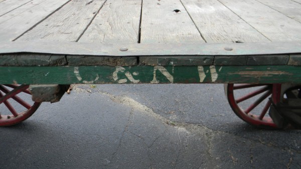

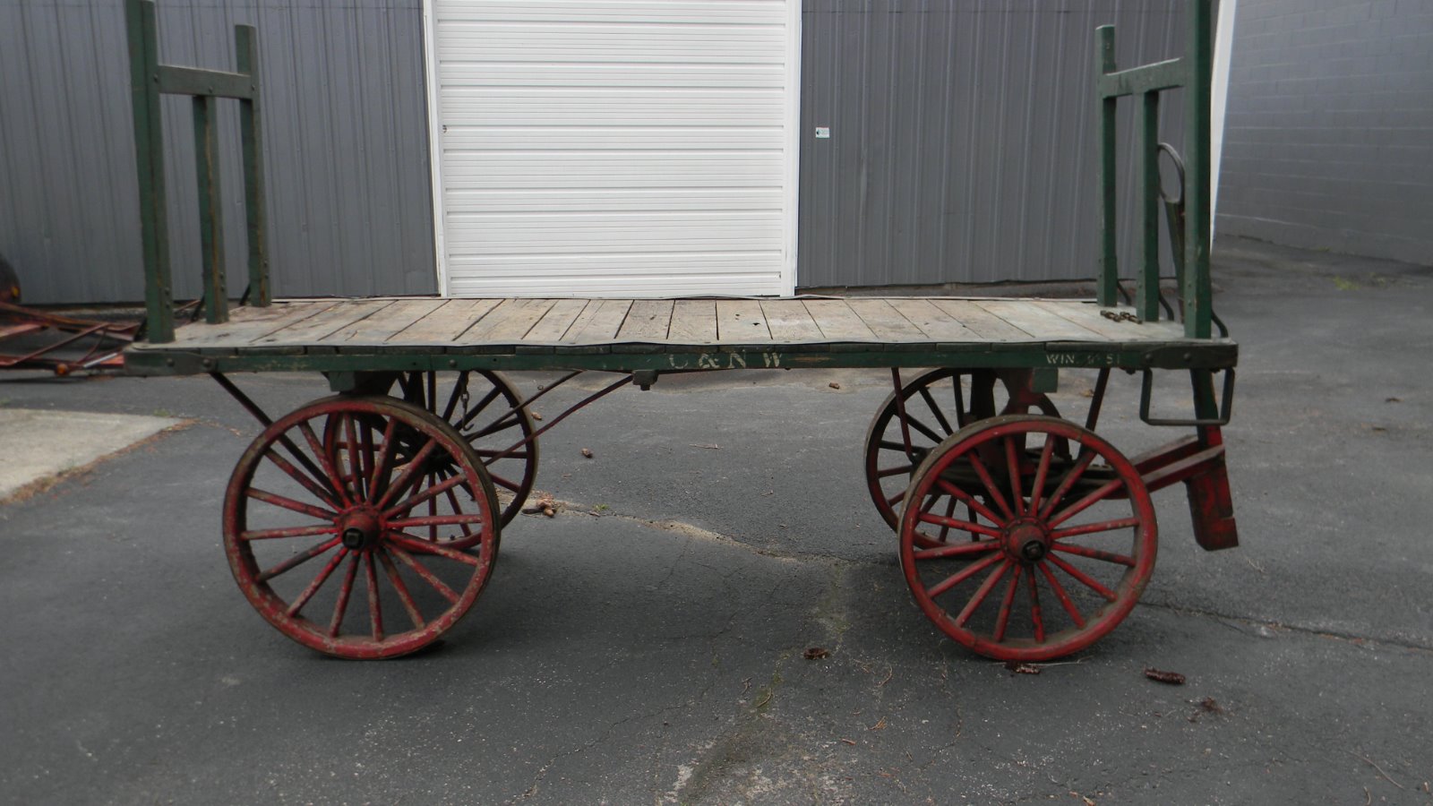

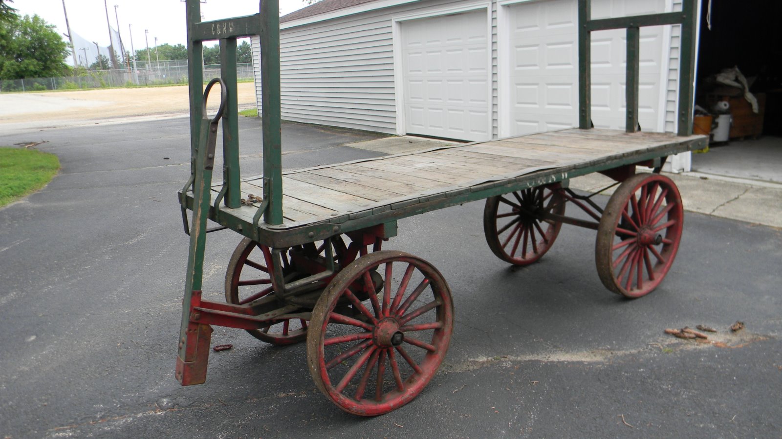

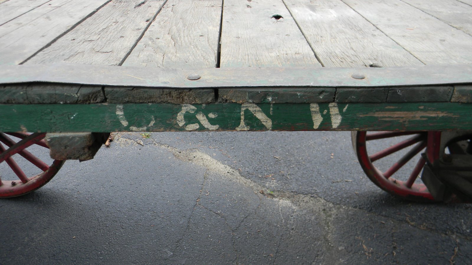

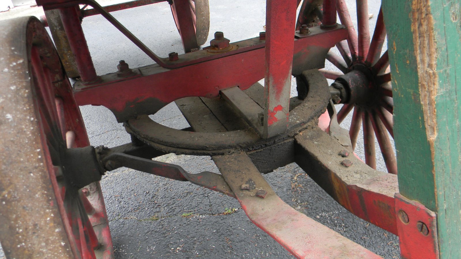

How about a original rail road baggage cart in fantastic original condition price right CNE Rail road very early, Bob

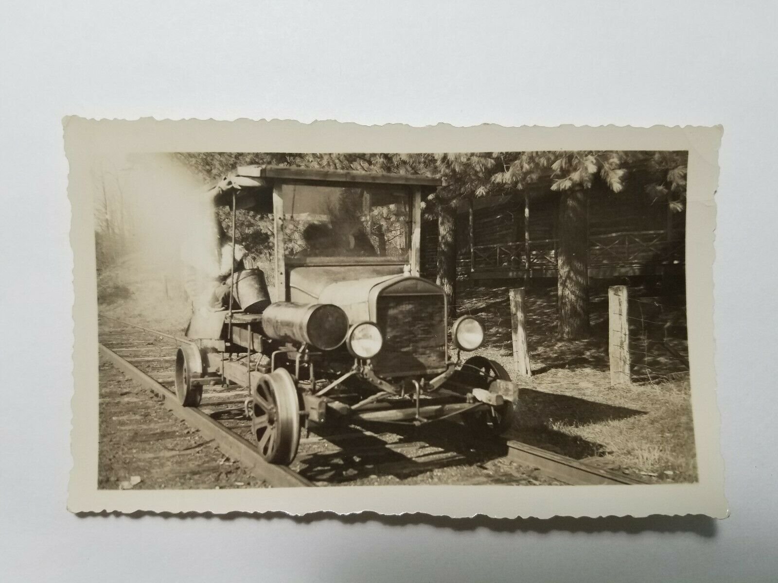

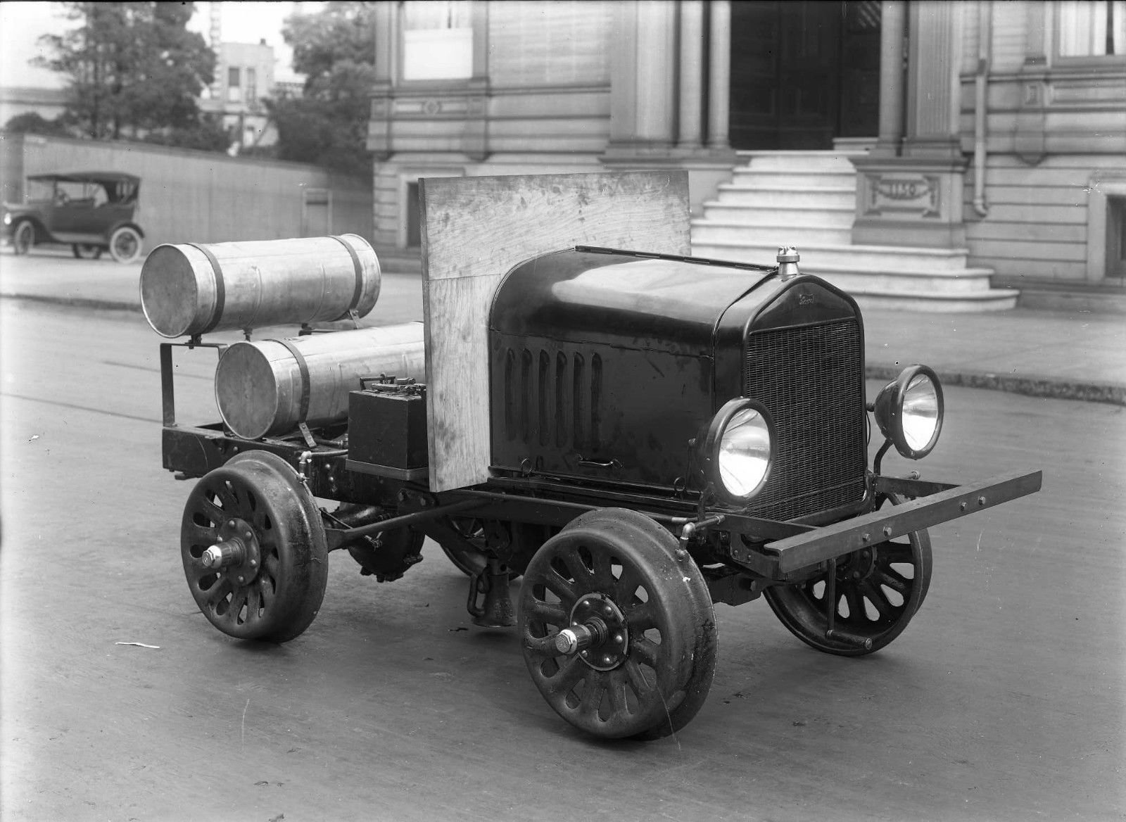

Thanks for the pics and links. It seems like the wheels with the teardrop shaped holes are fairly common. I'm not sure how involved I will make the rail car. Its mostly just going to be a static display to go with my other railroad items. For now I'm just acquiring parts and info.

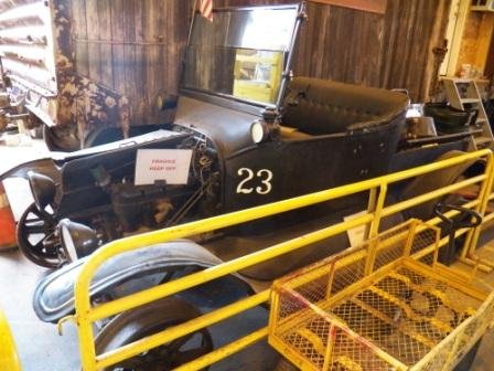

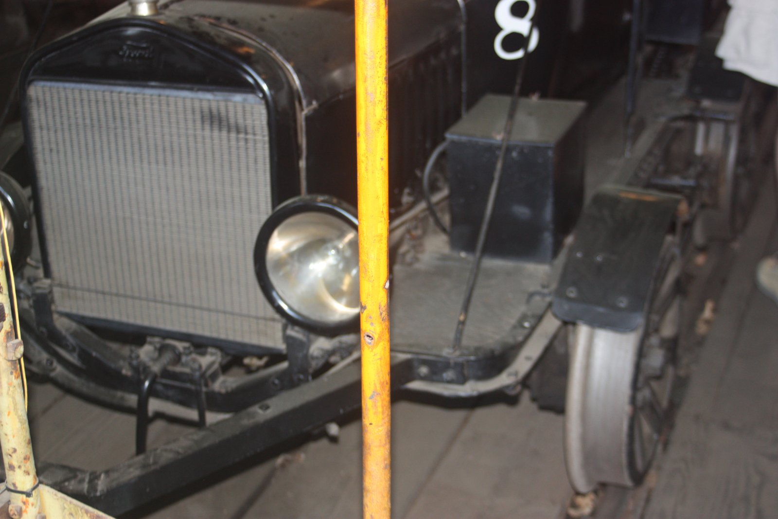

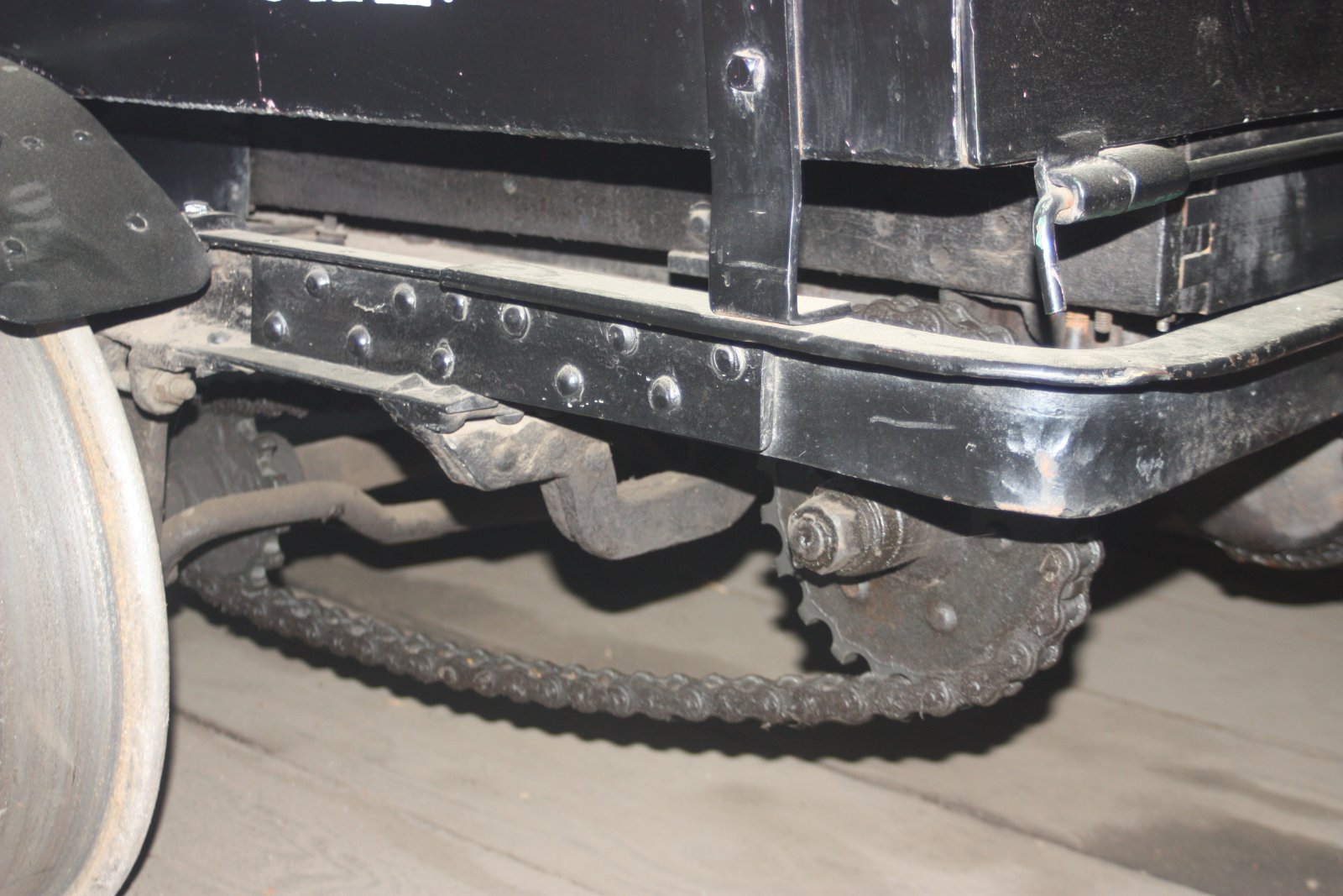

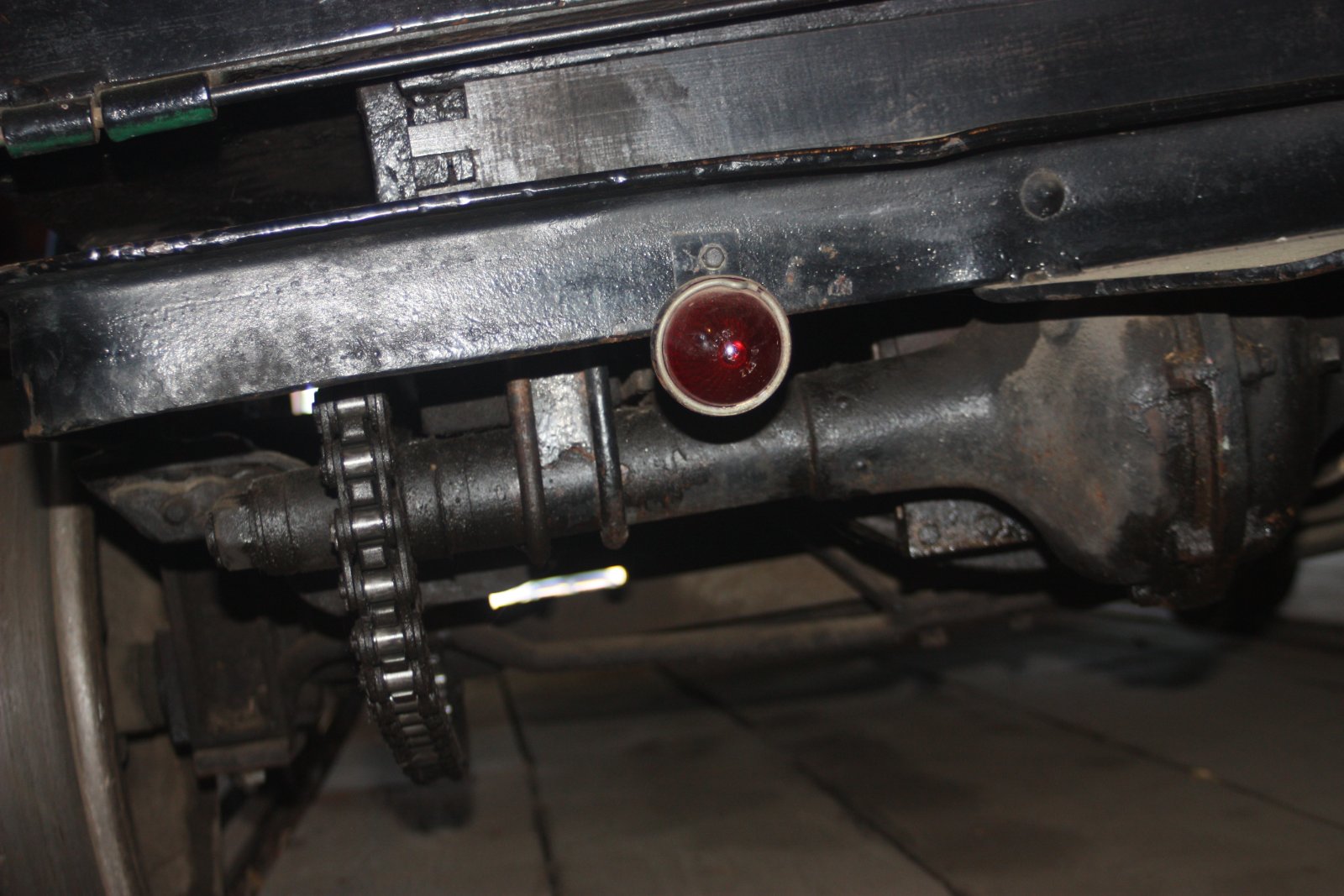

The two Brass radiator cars look to be on Kalamazoo wheels. The pair you show appear to be Fairmont. We built a '23 runabout into a railcar for the Portola RR museum, this is the only pic I could find when they were repairing it after someone ran a forklift through the pan trying to move it quickly.
We used the Fairmont axle for the front axle, bolting it to the T axle with the spindle arms cut off: this let us use the T front suspension, and the fairmont bearings. I believe we bolted it under the front axle, as the Fairmont wheels are a bit smaller than 30". For the rear axle we welded on some adapters to the wood wheel hubs; as I recall, it didn't require much addition to match the gauge; used the front axle dimensions to set the gauge.
The main problem is braking: metal on metal is not very conducive to fast stops. Most of the railcars built in the period used the Fairmont wood shoe brakes on all four wheels, we never worked that part out.
For taking the car off the tracks we figured out the center of gravity and installed a hand-cranked jack at that point--you don't need much road clearance on railroad tracks, just be higher than the railhead so you can go over switch tracks and grade crossings. put the railcar on a road crossing or "speeder" set off, crank the jack up until you can balance the car above the rails, then turn it sideways to the rail, raise the jack and roll it away. The T is a bit too heavy to just add lifting levers like the Fairmont Railcars use. You can also use the jack to turn the car around if you center the jack base over a tie.

Pleased to see you posting here David D ! You mention the single jack under the middle of the rail car.
My dad grew up in cattle country near Elko Nevada. He knew quite a few railroad people, and several of his friends from school days went to work for the railroad. One of his friends was out on the main line way East of town doing some sort of maintenance along with another man. As was the normal part of the job, they had to keep a close watch on the time for when the trains ran through. In those days, trains were known to run over 80 mph across the long stretches in the middle of nowhere. They had run out there in a similar sort of rail car with the single jack under the center of the car. The jack was still hand operated in those days, and they had certain places where a side rail was placed at 90 degrees from the main line for the rail cars to be parked on. In an emergency, the rail car could be forced off the main line into the dirt, but that was highly frowned upon. There they are, in the middle of nowhere, something hangs up with their maintenance work, and the time is getting close. They finish quickly as they can, looking at their watches. Jump into the rail car and push it as fast as the little rail car can go! The get to the side-rail, sliding to a stop and begin jacking the rail car up. They can hear the high speed train approaching in the distance, turn the little car 90 degrees (by hand), push the rail car off to the side and step back only seconds ahead of the train.
My dad loved to tell that story! I probably heard him tell it fifty times at least.

In Jamestorn, CA there is one. They ran a gear off the T rear end forward to a shortened wheelbase.
