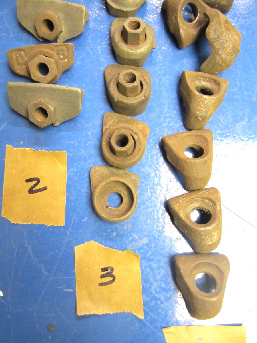

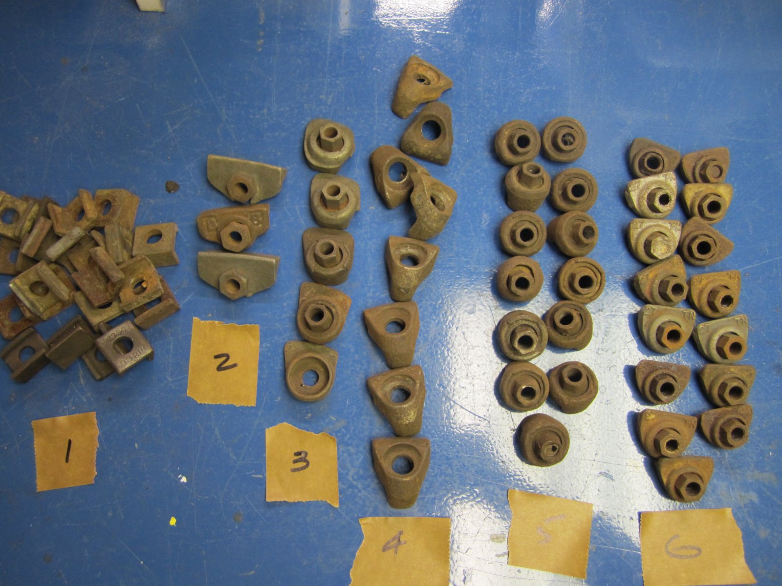

Have very little or no knowledge of rim clamps for the T or TT. Any help identifying these? Thanks

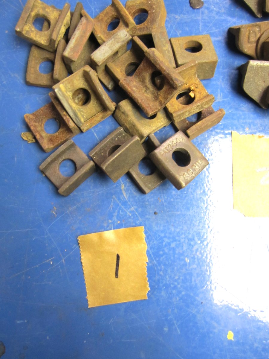

#1 looks like Kelsey lugs. I have them on 30x3.5 kelsey rims.
#3 looks like kelsey also for TT rear wheels.

Number four looks like the TT rim clamps I am familiar with. The '25 TT I had many years ago used those on the 20 inch rear wheels. I don't know whether they were used on any of the 23 inch TT rims or not. I still have a few of those hanging on a hook in my shop. Some have the "Ford" script, some do not.

Joseph, the number ones are indeed lugs for Kelsey 88 rims. At $16 each for new, precisely CNC machined reproductions now available from the vendors, you have a small fortune in that heap! Yours are much nicer, showing minor flaws, deforming and some numbers/markings which make originals so much more interesting.

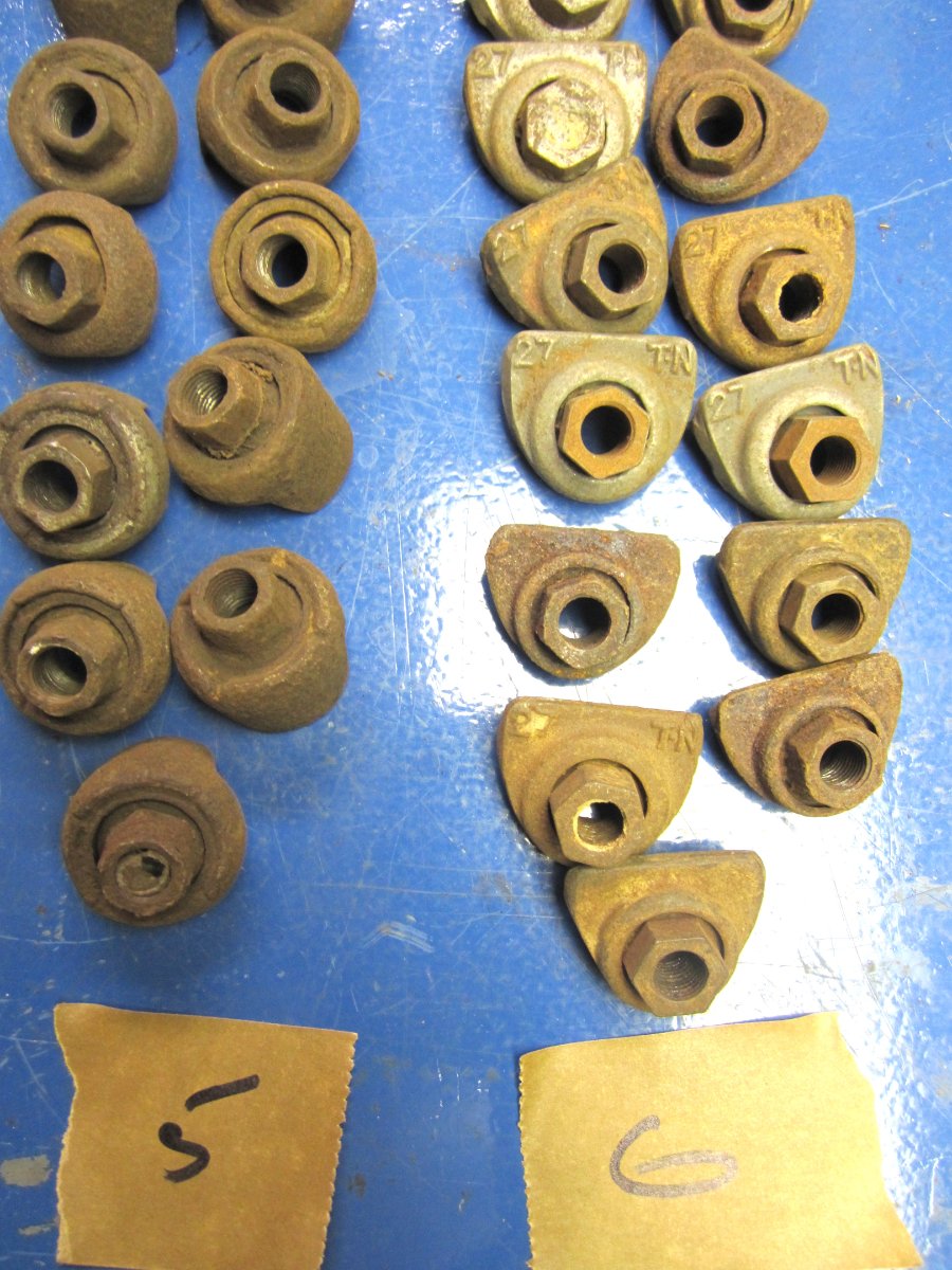

Thanks Allan, it's only a small fortune if someone pays you that! I do believe from my reading that the #6 lugs marked 27 TN is an alternative these for the Kelsey 88 rim

#5 are also lugs for the Kelsey # 88 rims. # 6 I'm not familier with, but am reasonably sure they aren't for the Kelset #88 rims. It would help to see the back side of those. Dave
