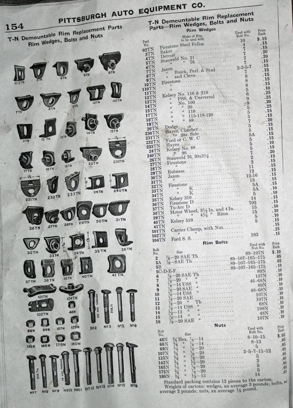

Thanks Allan, it's only a small fortune if someone pays you that! I do believe from my reading that the #6 lugs marked 27 TN is an alternative these for the Kelsey 88 rim

#5 are also lugs for the Kelsey # 88 rims. # 6 I'm not familier with, but am reasonably sure they aren't for the Kelset #88 rims. It would help to see the back side of those. Dave

Post by henryford2 » Sat Sep 14, 2019 6:38 am
You're right, I miss read this chart. This is what I am following to help identify these.

Great catalog page for reference , Joe. This will help me identify a good sized pile of weird NOS rim bolts I have.

Wow, I had no idea how many different styles there were... :!:

We sometimes forget there were other cars than ford back then. Ford did use many different types, but they were only half the car population then. I’m still riding in the back of your flivver, Dave. It was a dream ride!
