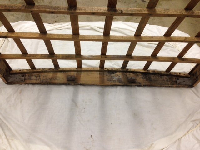

I was at the Benson Ford Research Center last week to document the C-cab roof construction in advance of my upcoming TT restoration project. Was able to get copies of all the wood top pieces, side curtain assembly, and visor. One of the things I was interested in learning is what the actual process and materials were used on the top installation, but the drawing for the roof assembly was missing. The prevailing method today for a closed car top is a layer of drill with a layer of padding then the top material. Back in the 1970's I followed that process for my 26 coupe with the exception of adding a layer of chicken wire...not a Ford model T method, but made for a nice tight top that looks as good today as when I installed it. What do we know about Ford methods and materials for the C-cab top...was a layer of drill and padding used or did the top material go directly over the wood structure? None of the original C-cab photos I have seen show any outline of slats, or any starving horse appearance which makes me think there was drill and padding. Guesses I can make, anyone know?

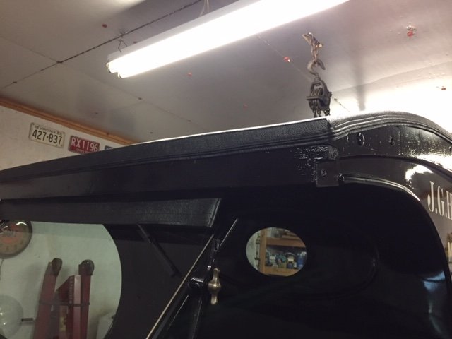

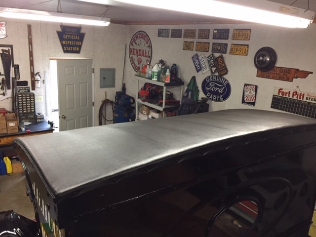

My high roof C cab had minimal remnants of the original covering that consisted of burlap and the typical oil cloth. There were no signs of padding but with so little left I couldn't say for sure if there was padding or not. On my top I used a layer of black duck cloth followed by 1/8" of cotton with the Ford grain material on top. I also followed the original edge design where the back section was nailed and then folded over and held with tacks. The side and front used hidem welt. There seem to have been different methods when new for the top installation as some of the factory photos look to have metal side and front beads while others appear to have hidem.
The original windshield flap was also in my truck. It was made of the same material as the roof and had a layer of burlap sandwiched between the front and back oil cloth pieces. The flap is secured by tacks to the inside upper roof wood panel.

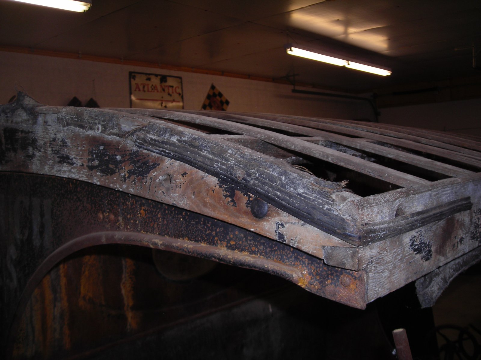

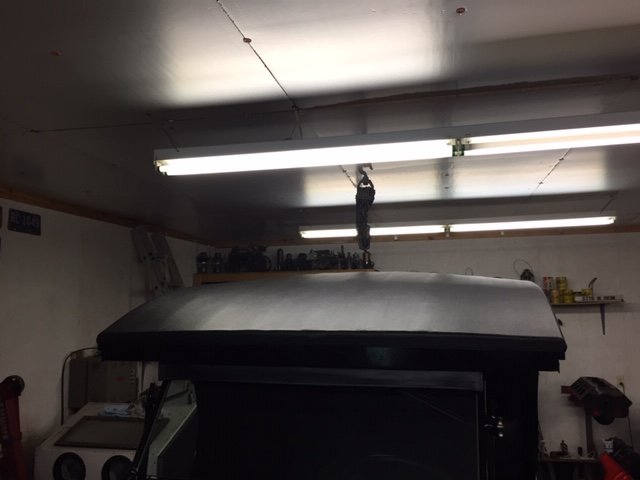

Also, the roof does show the roof slats but it is minor as long as the roof material is tight. I expect that they showed some originally too but don't show up well in period photos. They certainly did not have thick padding. An overstuffed roof on a C cab doesn't look good.
Justin in Western PA

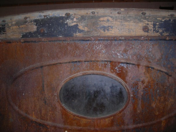

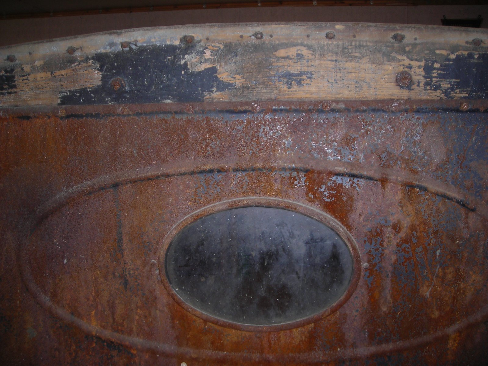

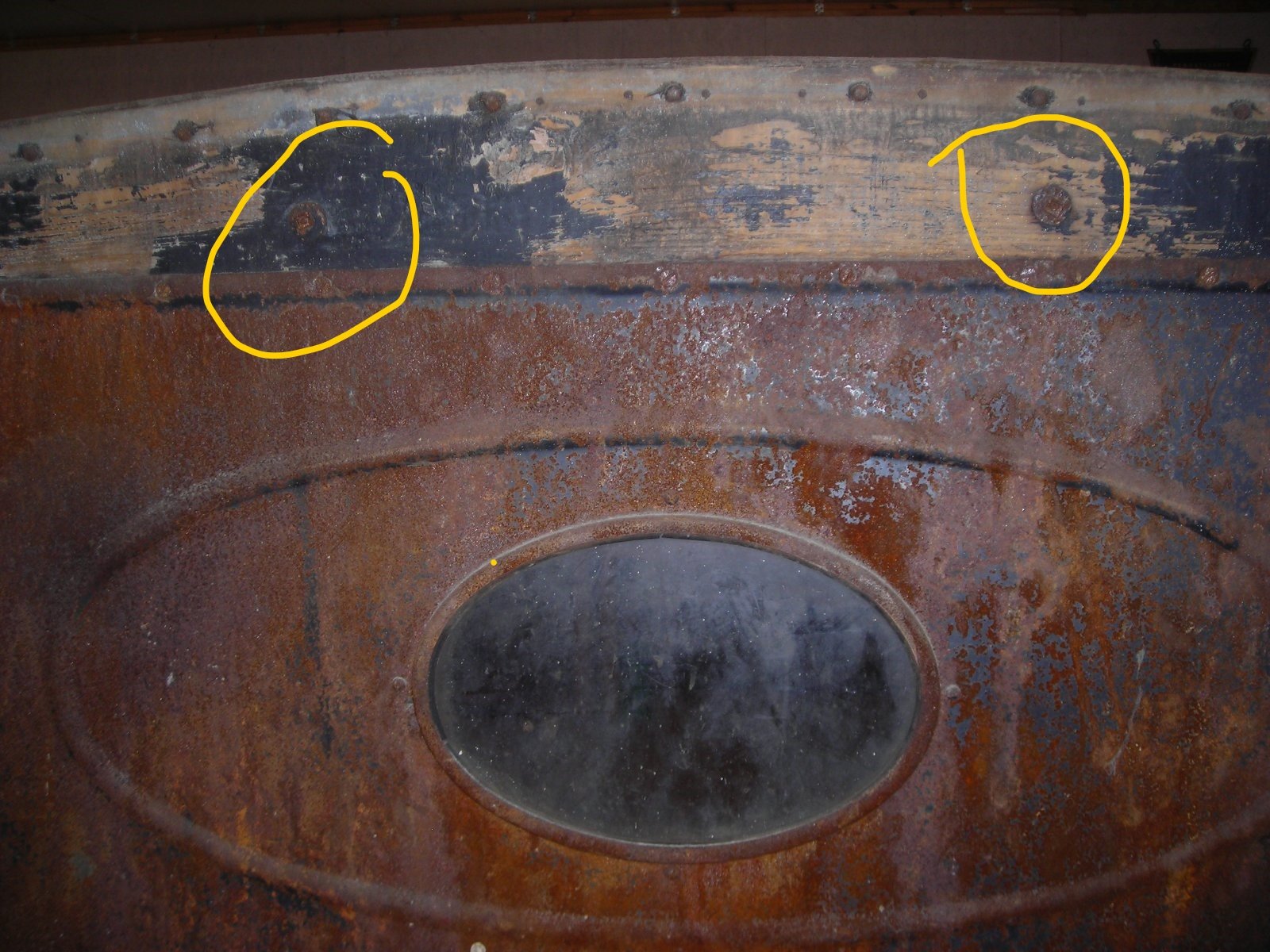

They are the top, center bolt for the rear curtain brackets. The other two lower ones are wood screws.
