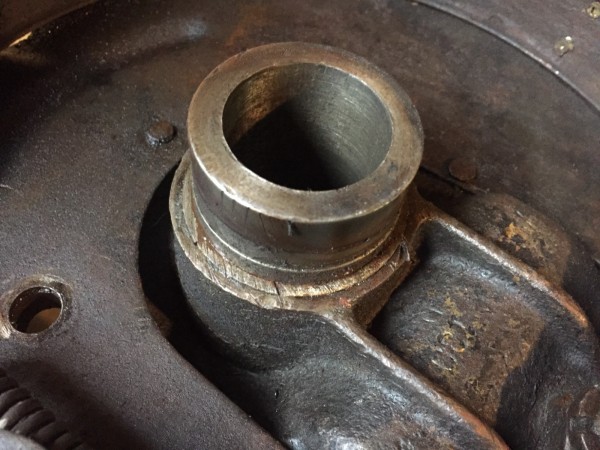

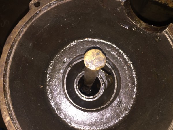

Removing “Dummy bearings” from rear axle tubes with safety hubs
Before I fight myself or damage something...
Does the dummy bearings/sleeves just pop out after removing the lock screw where the grease cup would be ? Or will I need to rig it up in my press ?
I need to replace the axle seals that are behind them.
I have a slide hammer with a bearing removal attachment for the bearings, which should do the trick. Or I can pull the inner hub off and press it too. The bearings seem right but I will replace them anyway after all this.

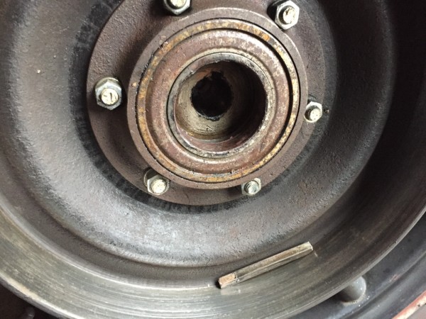

Topic author - Posts: 2345
- Last Name: Hanlon
- Location: NE Ohio
Re: Removing “Dummy bearings” from rear axle tubes with safety hubs

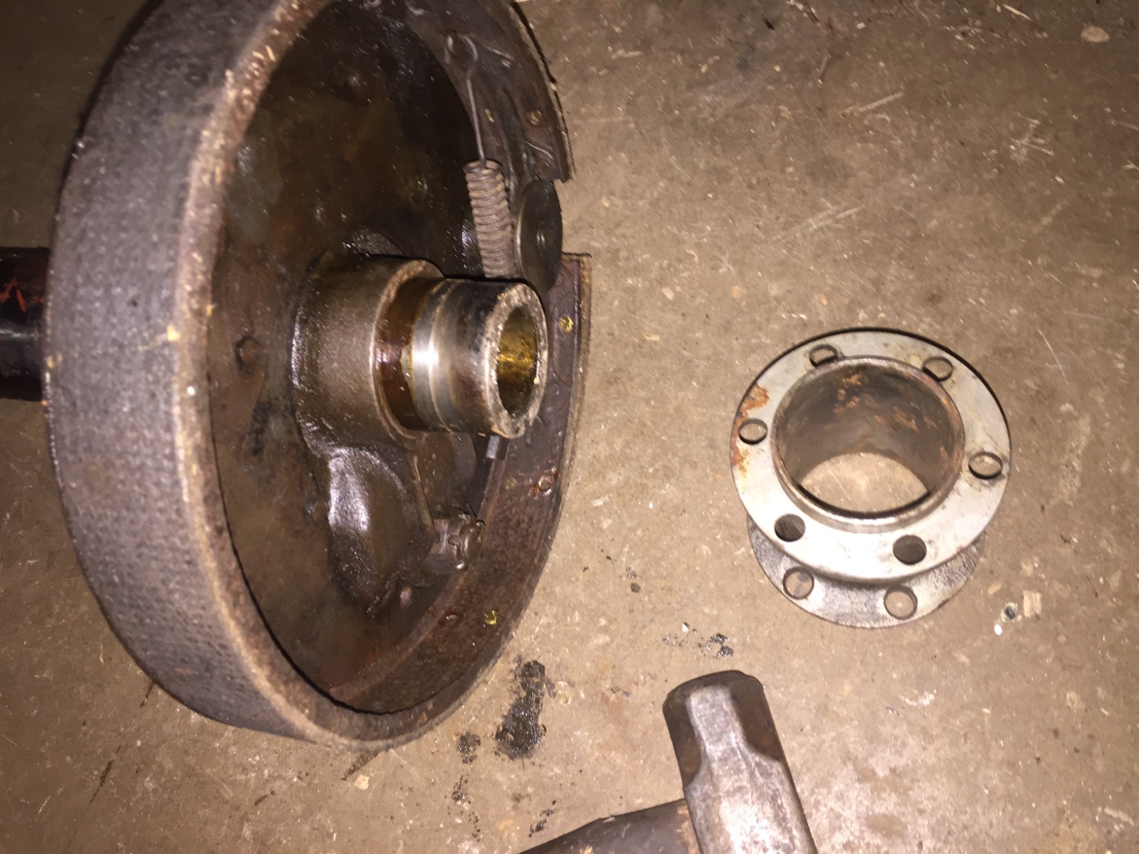

Mark, from what I understand, these are an early version of the modern safety hubs.
The only difference is the new ones have a snap ring on the outside between the spokes. This will hold things together if an axle snaps.
I’m considering cutting a grove for a ring. The weight is still being taken off the axle shaft and onto the housing, so I think the likelihood of a breaking an axle is much less.
The slide hammer might work, but I have the axle all apart and not easy to support to whack on it, but maybe they’ll come out easier than I expect.
Hank, I was going to put some sealer around there and the axle to hub fit. I had oil in the brakes, but shouldn’t with this set up right.

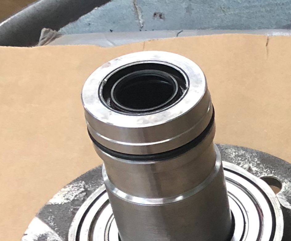

I greatly appreciate it Hank !
I have a good friend who’s a machinist
I want to get it apart and see what’s in there now. There’s a remnant of a modern seal rubber on the shaft and the rest looks like it is behind the dummy shaft. Once I get it out, I hope I can match this stuff up at Akron Bearing supply.
I believe the dummy or stub shaft has a couple o-rings now that I’ll replace.
Probably looks similar to yours.
Steve, are you saying the whole assembly should come out of the housing when removing the wheel ? And the modern bearings are pressed on the dummy shaft ? I had no trouble with the hub puller popping the taper loose and the wheels slid off with little effort. As long as the axle nut is on and the axle shaft doesn’t break... it ain’t goin nowhere.

When I made these I found considerable variiation in the diameter and the machined finish in the axle housings. Consequently, the clearance between the spiggot and the housing means a press fit is not readily achievable, or necessary.
I do not install them with solicone as a seal because it can make removal difficult. I use a Loktite 510 flange sealant which does not harden. It also means that an O ring or two are redundant complications.
IIf you have difficulty pulling the spiggots you could drill and tap two holes in the end so a couple of studs can be fitted to allow the whole to be pulled out.
Hope this helps.
Hope this helps.
- Posts: 339
- Joined: Wed Jan 09, 2019 6:48 pm
- First Name: Eric
- Last Name: D
- * REQUIRED* Type and Year of Model Ts owned: 1914 Touring, 1915 Speedster #32, 1916 Touring, 1927 Runabout
- Location: Greater Portland area
I thought that the point of safety hubs was to keep the wheel on the car when the axle shaft breaks. My “floating” safety hubs look like the pics that Hank posted, the flange of the bearing assembly is bolted to the wheel and the long part with the inner bearing and seal slips around the axle and into the axle tube and gets retained by a lock bolt that replaced the grease fitting on the inner side of the brake backing plate. That bolt is not a set screw holding the bearing carrier tight, but it acts as a removable “bump” inside the axle tube that the fat interior end of the bearing carrier cannot slip past. To remove my rear wheel now, I have to remove the lock bolt and the whole hub and bearing assembly pulls out of the axle tube by hand in one piece with the wheel after removing the axle nut and breaking the taper loose.
From your pic, it looks like the flange of your safety hub and outer bearing have separated from bearing carrier that slips into the axle tube. I didn’t know that they could come apart while still bolted to the wheel. But yeah, the bearing carrier inside the axle tube should pull right out after removing the lock screw.
Eric

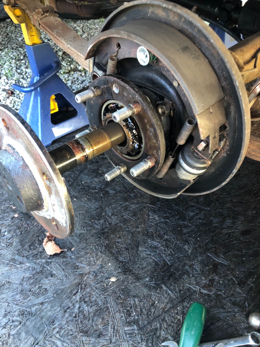

This is on my 1960 British built Ford Zephyr MK2 sedan, Talk about AWESOME engineering! A real floating safety hub.
All the Best,
Hank
All the Best,
Hank

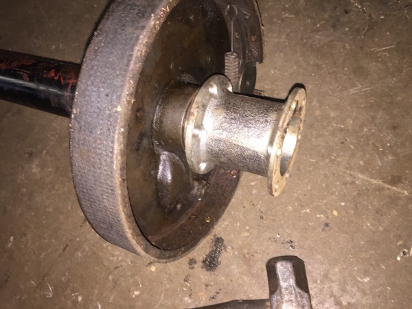

- Last Name: Hanlon
- Location: NE Ohio
I hope to get back to this maybe Sunday, supposed to be warmer and my press is in my not heated barn behind my garage.
My opinion is that this setup, regardless of not holding the wheel on in an axle shearing event, will greatly reduce the chance of breaking an axle.
I just wonder what others think about this.
Anyone running a similar setup ever had an axle shaft break ? I think the weight being supported by the shaft and Hyatt bearings is the “breaking point” when they do break. I don’t think I have enough torque to twist one off...

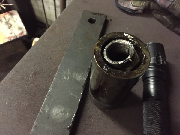

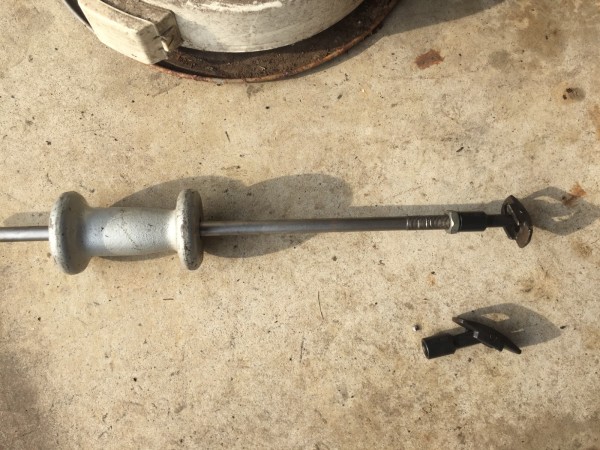

- Last Name: Hanlon
- Location: NE Ohio

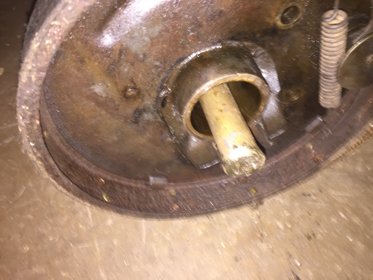

So I tried the slide hammer on the dummy bearings today. Problem is that the dummy and the rivets are too close together for the bit to flip and catch only the dummy.
Also the ID of the rivets inside the tube are about the same as the dummy bearing. So I can’t catch it easily from the inside.
Any suggestions ?
I also got the seal out, but don’t see getting it back in without pulling the pieces out.
Any suggestions ?
- Last Name: Hanlon
- Location: NE Ohio
Good idea Hank !!
I think I have something that I can push against from inside and found an old spool fits nicely on the outside to support it.
Gonna try to get it in my press this way tomorrow.
I found a 3/8” flat bar that’s wide enough and just clears the rivets on both ends of the tube.
If this is a no go, I’ll try the drill/tap trick.
- Posts: 6904
Hank, that is how I make mine, holes drilled and tapped just for that purpose, as I mentioned in an earlier post. If for some reason they are pressed in, it may take a press to get them out again .That will require some tricky bits to engage on the inner end of the spiggot and to support the backing plate in the press.
Fingers crossed!
Fingers crossed!
- Last Name: Hanlon
- Location: NE Ohio
I got the sleeve out !!
Before getting it in my press, I found the piece of flat steel I had was still hitting a rivet inside the tube.
I eventually found a large axle nut from a half shaft from something. Dropped it in the tube and fished it past the rivets and it caught the sleeve. Long brass punch and sitting up on the old spool, knocked right out with little effort.
I think it will work better on the other side with the seal still in place.
Thanks all for your help and suggestions.
