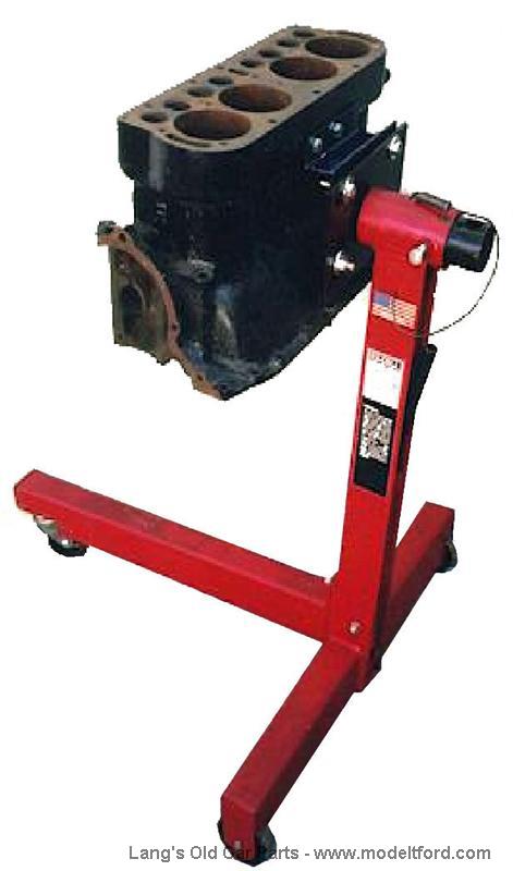

Hey Mopar-man what you have is one of the universal engine stands like the one in the picture below.

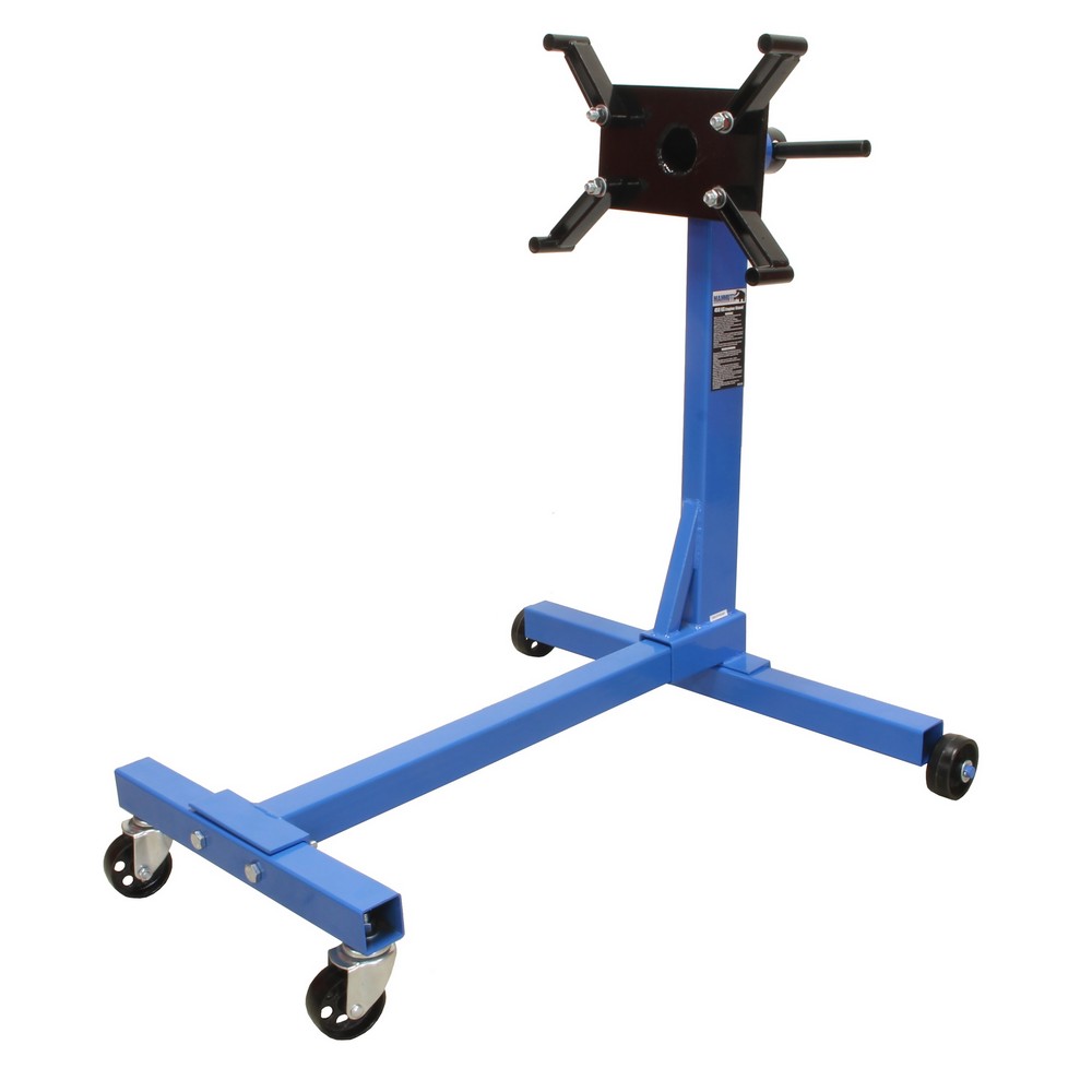

You can simply drill 4 holes in the corners of the mounting plate you purchased from Lang's and mount it to your stand, as in the second picture, or you could weld a pipe of the right outside diameter to the plate from Lang's, but then you would have to drill some holes in that pipe to match with the holes in the stand you have so you can fixate the engine in a couple of orientations depending on the work to be done on your motor
