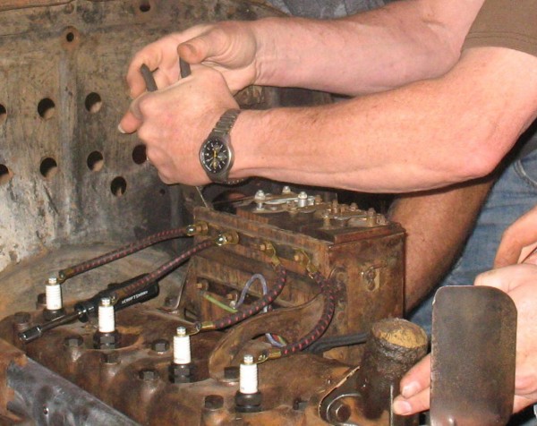

A bunch of experienced Model T guys couldn't figure out how come there was no spark...
...until Verne came back from lunch and pointed out what we obviously had wrong.
This shows correct wiring with a normal timer.

Steve your close up of the coil box wires shows how things can get upside down without thinking about it!
I had to look twice or so before I caught on what’s upside down. Guess I’m getting old and slow. Good point to bring up though. Those simple things can drive you nuts sometimes.
