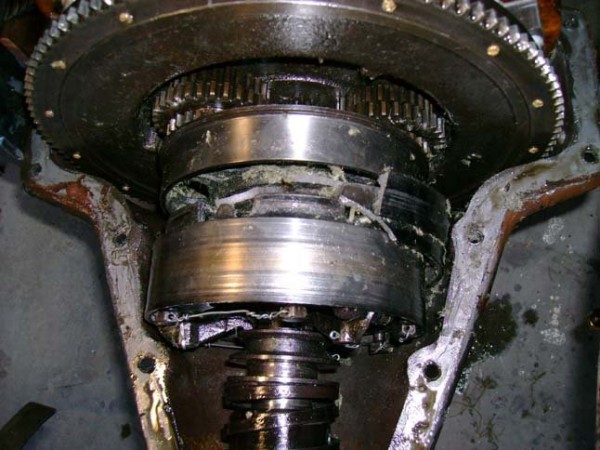

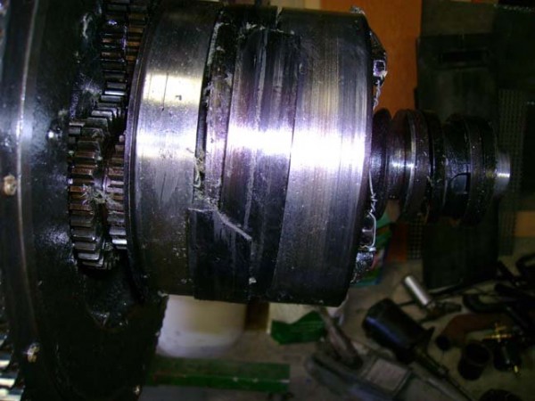

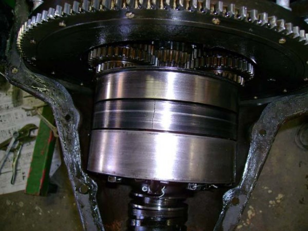

After you get it adjusted, it is very important to check that the low band is not too tight. If it is too tight you risk cracking the low drum. I had this happen to two drums before I discovered the cause of the problem. It was the low cam and low notch which were worn and I could not get the pedal to lock the band with the floor board in place unless it was adjusted too tight. This problem also leads to need to reline the bands often because they tend to slip if you set it loose enough that the bands are not too tight. I hope I have not confused you. If the band is too loose, the pedal will stick down, but if it is too tight you get the cracked drum. When you can't get the adjustment right you have a worn out cam and notch. See pictures attached

Ouch Norman!
