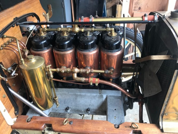

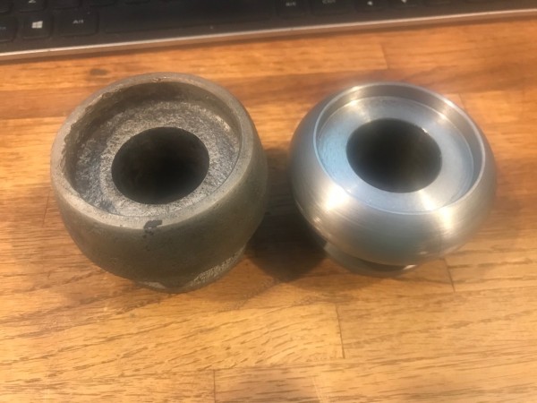

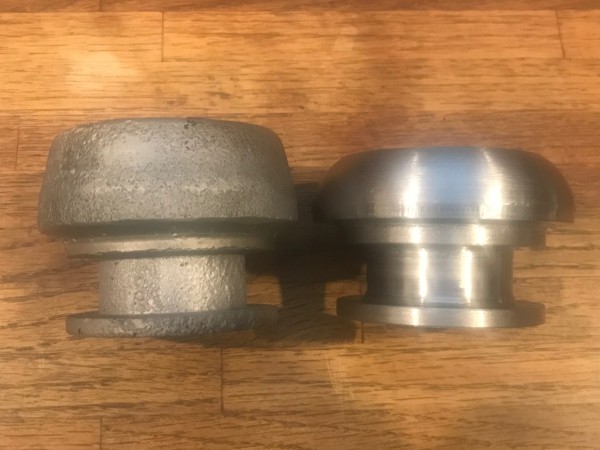

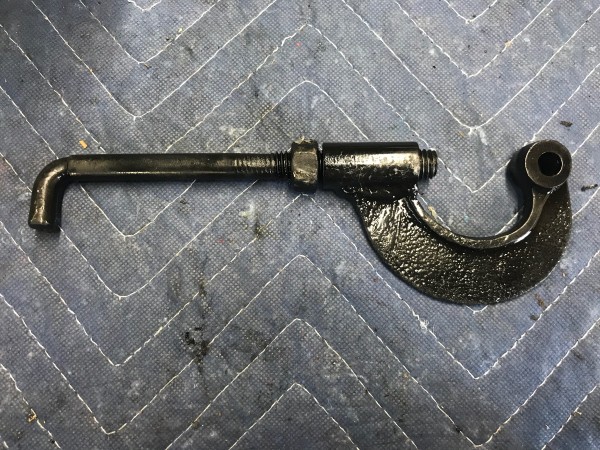

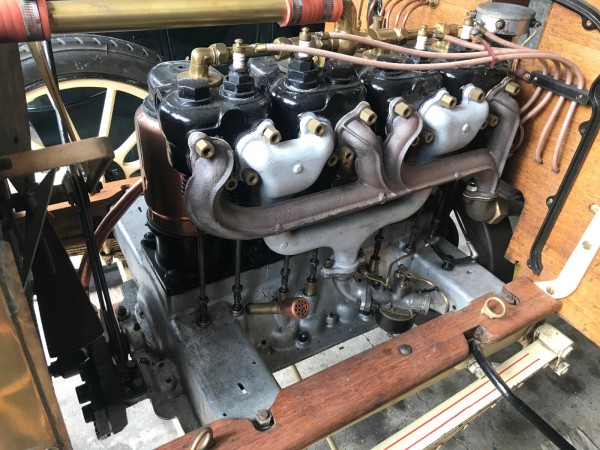

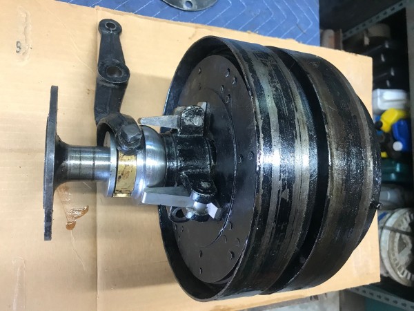

Pictures of the engine and some of the new transmission parts.

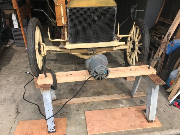

The gear reduction motor works great to turn the fairly tight motor over at 32 RPM.

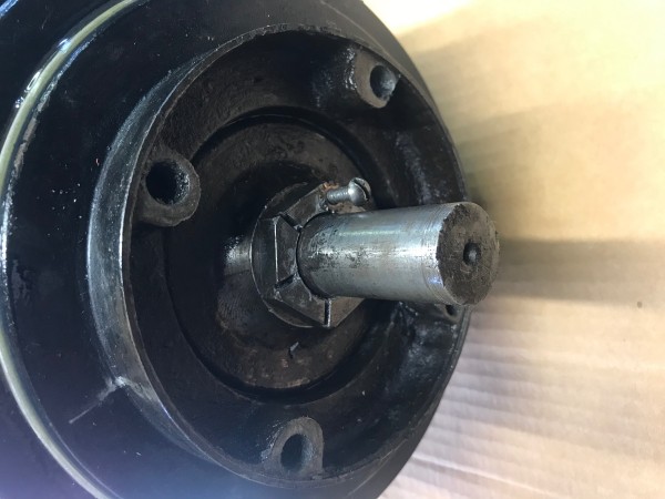

This is the high speed cone that the clutch fingers ride on. I don’t know where the old one came from. But as you can see, it’s different from the new correct one.

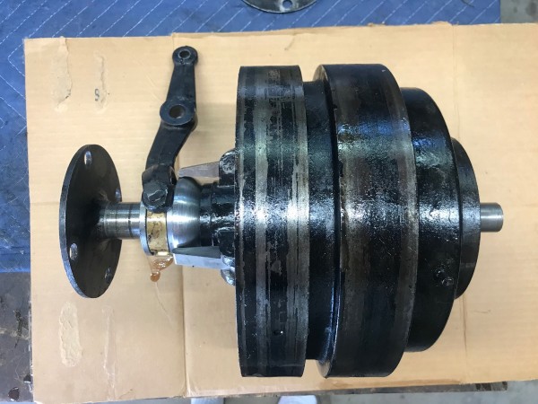

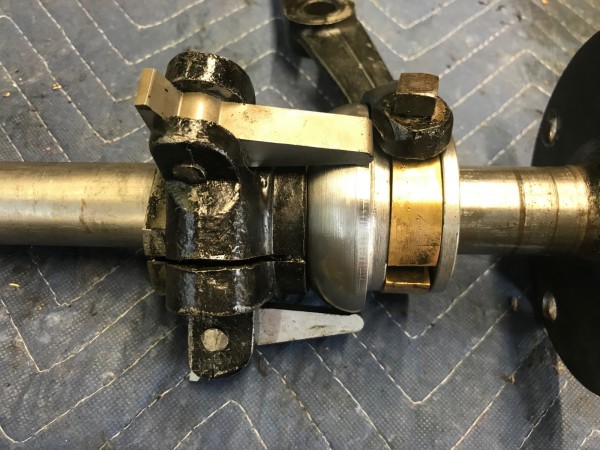

The transmission is now back together. There has to be a certain amount of clearance in the transmission so it rotates freely. The clearance is set by the nut on the end with the set screw. Any ideas on what this clearance should be? In thinking .025-.030?

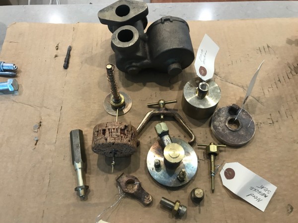

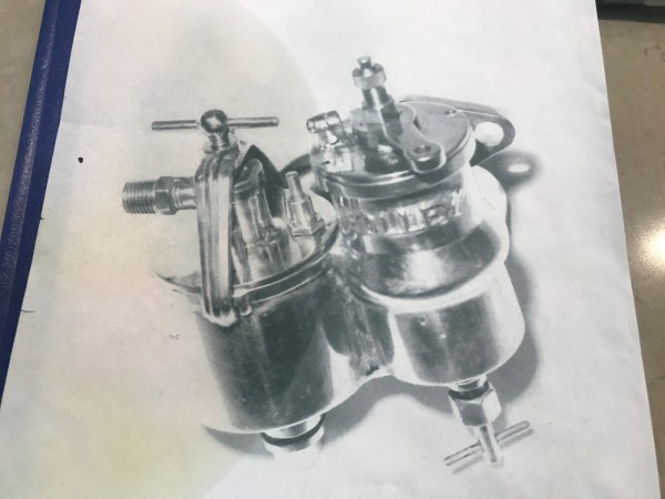

Kim, what would the B have had for an original carburetor??

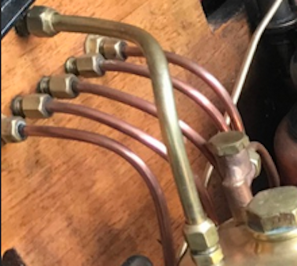

I think I understand most of what I see there, but what's the story on the copper tubes coming out of the firewall?

Steve, the brass tank is an oil reservoir pressurized by exhaust gas. Oil is fed up to a valve block where drip rates are set. one for each cylinder and one for the transmission ball cap.

I have some early holleys that are different than what I've seen..if you can send me a photo or drawing I may have one.

The Early Ford Registry has Gene Kristoffy's drawings for the "B" Holley carburetor. He made one, (or more), from scratch for the complete "B" engine/s he manufactured many years ago.

Thanks Jerry, I made most of the missing parts off those drawings. There is still a fair amount of work to do on the carb.

Stan, here is a picture of the carb and it’s current condition.

Wish I had a couple of those but they are different than what I have.
Depending on the actual design, needle and seat is a pretty small problem.
