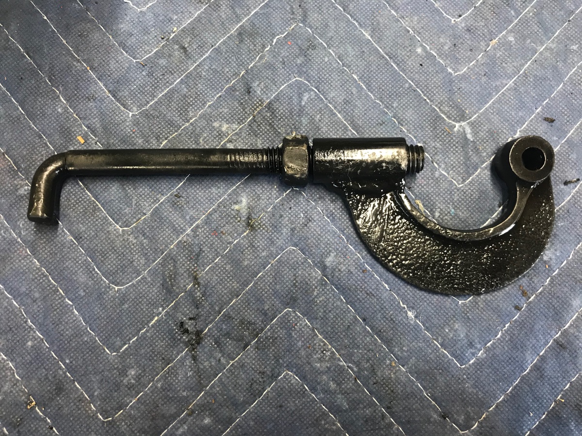

This is the high speed cone that the clutch fingers ride on. I don’t know where the old one came from. But as you can see, it’s different from the new correct one.

The transmission is now back together. There has to be a certain amount of clearance in the transmission so it rotates freely. The clearance is set by the nut on the end with the set screw. Any ideas on what this clearance should be? In thinking .025-.030?
