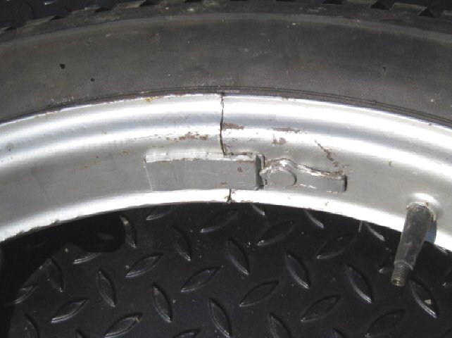

Some of the rims have a clue on the lug that attaches the rim to the wheel.
The early Firestone rim had five lugs, but the later ones only have four lugs.
Removing the rim and looking at the split area method of attachment is a good clue.
This is the later Firestone rim that did not have their name on the lug.

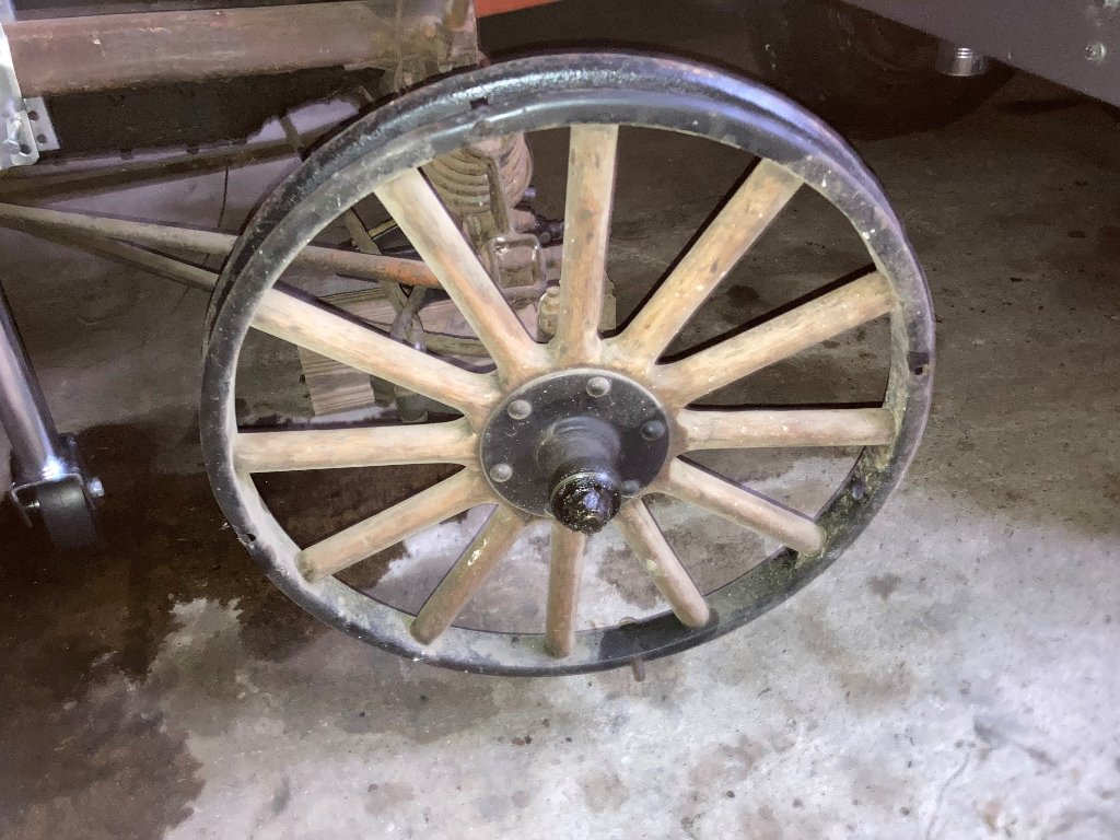

My loose front wheel spokes seem OK but the rim is not tight to the fellow. One of the bolts (rivets?) in felloe has backed out (toward the center of the wheel) by about 1/4 inch.
If I find 30x3.0 front wheels and rims of the same make as my demountable 30x3.5 rear wheels, will the rims fit either wheel? In other words can I carry just one rim with tire to use as a temporary spare for front or rear?

You can put 30x3-1/2 demountables of the same style on the front so you will only need one spare mounted on a matching rim. To do that you need new wheels and rims in the front that match what you have in the rear and since the wheels you have in front are 30x3 you will also need new tires. What you want is 30X3-1/2 wheels and rims all around. That's not correct for your car but lots of people have done that to be able to carry a usable spare instead of having to repair a tire on the road and carry two different spare tires and tubes.
- Posts: 2294
- Last Name: Juhl
- Location: Thumb of Michigan
Re: demountable front wheels
Hubs are readily available, and felloes can be found. Sometimes the outer part of the hub will be "expanded" by being beat on too many times and won't let you screw a hubcap on. Felloes can sometimes be out of round or flattened by being rolled on without rims and tires installed. Buy from someone who knows what to watch out for. Originally your car had 30 x 3 wheels in the front and 30 x 3.5 in the back. When people converted to demountable wheels "back in the day" they usually went with 30 x 3.5's all around. If you can track down some decent felloes like what you've got on the rear and some hubs, there are some good wheel rebuilders that can make wheels for you. Stutzman in Baltic, Ohio is probably the closest. I had a couple of wheels made up in that manner.
- Posts: 6928
Others have pointed out that you need to match the front wheels to the back ones. We need to see what you have on the back to tell you what you need on the front. Photos will help. Without them, we are all left making general comments which may or may not be of help. Already there have been posts of photos of 21" split rims, and mention of Chev rims. and accessory Firestone 5 lug wheels.

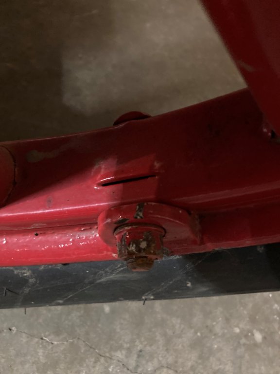

I've attached a photo of my rear wheel lug. The nut is tapered. The felloe has a "louver" that is not being used - do I have a mismatch of parts? This seems to work OK. Any advice will be appreciated!

To me, that felloe looks a lot like Chevrolet. That's how my '27 one-ton is made. They have a square clamp that rests on that raised edge.

It's a Model T wheel - '21 or '22 - used a separate lug with a rim nut shaped like a top hat.
- Posts: 6605
Martin
photos are worth 1000 words! It looks like you have a FORD or Hayes rim on a Kelsey wheel. Happens a lot, but not the best combo for the long term as they are not really made for each other even though they may appear to fit, they don't fit that well.
You're starting with mismatched wheels/rims...so your going to want to find rims which match your wheels, and then purchase a set of rims/wheels for the front. This way everything will match.
Alternately, if your rear rims are in GOOD CONDITION, and the spokes on the wheels are fair/poor, if you remotely think you want to respoke the rears, then perhaps you want to respoke and REPLACE those felloes with Hayes Felloes, keep your rims, and then find matching wheels/rims for the front
This plan may be more easily done, because it seems to me that GOOD RIMS are harder to find than GOOD FELLOES, so perhaps keeping your rear rims would be the way to go rather than keeping your rear felloes. The point being, get your rears up to snuff (whatever that means to you) and then work to make a matching set on the front. Clear as mud?
Forum Member Mark Strange did a marvelous job with photos to show a series of correct/incorrect combinations of wheels/rims...to see correct rims on correct wheels, and wrong rims on wheels, take a peek here for info: http://www.mtfca.com/discus/messages/50 ... 1434340728

That red felloe is a Kelsey loose lug wheel, which is what I have on our 23 Coupe.

Thanks for the photo. Chris has nailed the felloe. It is a Kelsey loose lug item, which takes a U shaped lug and the top hat nut mentioned in a previous post. Both nut and lug are available from Langs.
However, the rim with lugs is not a match for that wheel. Only Ford lugged rims will bolt up to that felloe. Hayes rims with the foot on the lug would need to have a depression in the felloe for the foot, or the foot of the lug would need to be ground back. None of the lugged rims actually fit as designed, by wedging on the inner land on the felloe. Felloes for lugged rims have a wider land on the inside, onto which the rim is wedged. The lug bolts are there just to maintain this wedging effect. That Kelsey felloe does not have the wider inside land. The four lug bots and a Ford lugged rim will work, so long as the bolts are kept tight.
Our Canadian sourced cars used Kelsey loose lugged wheels right up to the late 1925 models, so they are more common here. In the USA, lugged wheels were introduced earlier, and so are more common. You may find it easier to find a whole set these rather than a pair of Kelsey fronts. It should also mean that lugged rims should be more plentiful. However, good used rims are difficult to find. The good news is that both loose lug rims and fixed lug rims are available new. The choice is yours. You will have in the vicinity of $400 worth of tyre and tube on each corner, so new rims are a good investment to protect these.

Thanks to all who have educated me! I bought a parts car that has two front Kelsey "loose lug" front wheels that seem OK, and three rusty (but not terrible) Ford rims. I already have this Kelsey/Ford combination on the rear so I'll end up with four Kelsey wheels and five Ford rims.
My question now is what is the best way to clean these wheels to prep them for painting? The rims can be chemically stripped or sandblasted, they seem easy. Should I trust a sandblaster to stay clear of the wood spokes? Can anyone recommend a sandblaster (or "media" blaster) in the Chicago area?

Fixed lug rims on Kelsey loose lug type felloes is not a good mix. Demountable rims are designed to wedge on one side of the felloe. All the 4 bolts do is maintain that wedging effect. They are not drive bolts like they are on modern cars. Kelsey loose lug felloes are designed to have the rim wedge on the outside rolled land on the felloe. They are slightly smaller in diameter than the felloes that take fixed lug rims, so fixed lug rims on Kelsey felloes will be relying on the 4 lugs and bolts to stay tight on the wheel. It may work, but will not work as intended.
