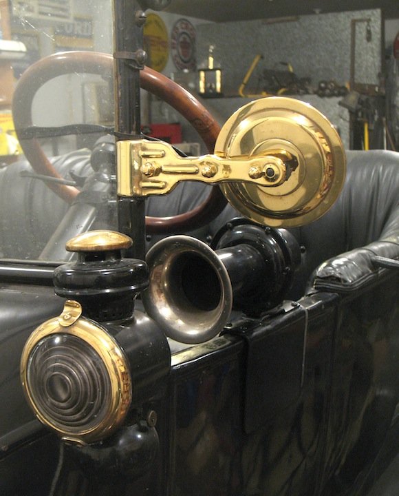

On the touring I have an old windshield mirror, also from a bunch of auction plunder.
I think new glass for it was $2 or $3. I made the clamp from a piece of electrical conduit, again with an inner tube pad to save the paint. No holes needed.

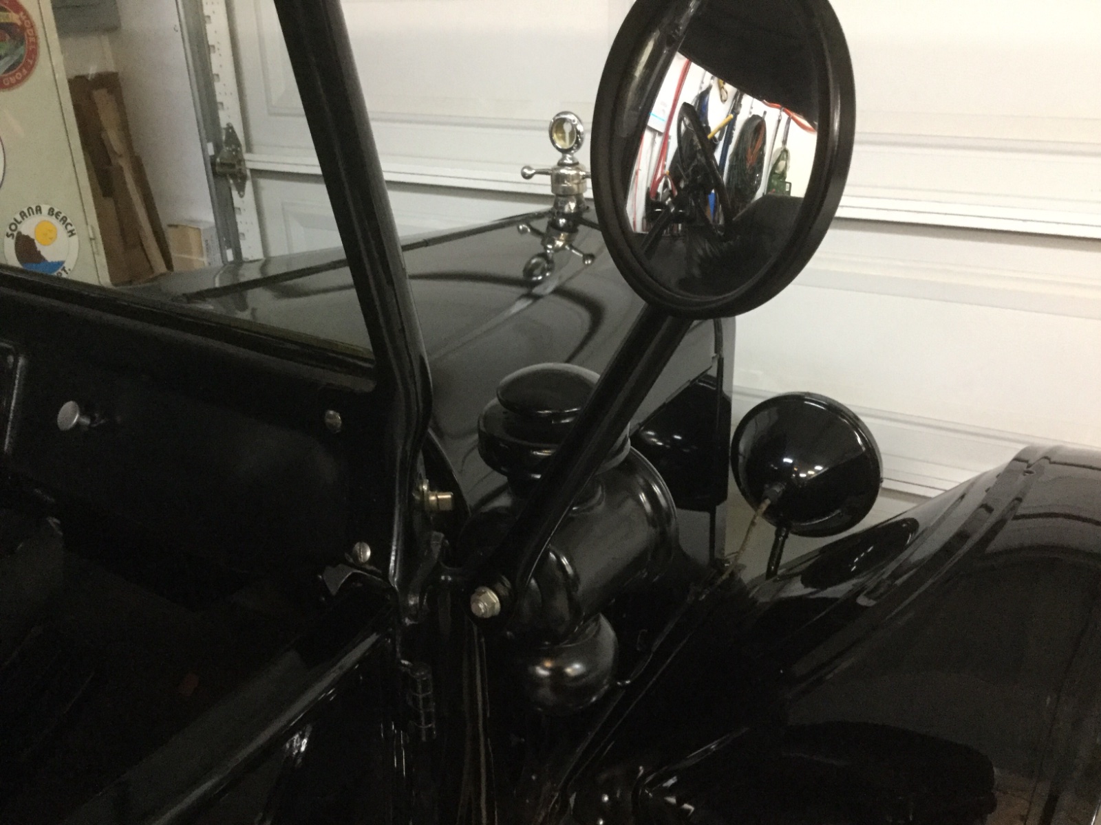

I have the same side mirrors attached to the windshield frame. The factory bracket was so flimsy that it was useless, so, I cut 1/8 inch brass plate to put inside of the original holder one for each side and now it is nice and sturdy. Also have an old piece of water hose under the clamp to keep from scratching the frame. I do like the bracket that rich made but i have no access to a lathe to make the fancy parts. Frank

You can make a very stable bracket out of electrical conduit. You will need a little bit longer bolt that goes thru the lamp and bracket.
Posts: 5495
Re: Side Mirror Options
Post by RajoRacer » Mon Jun 01, 2020 7:41 pm
Clever mount there, Dell !
