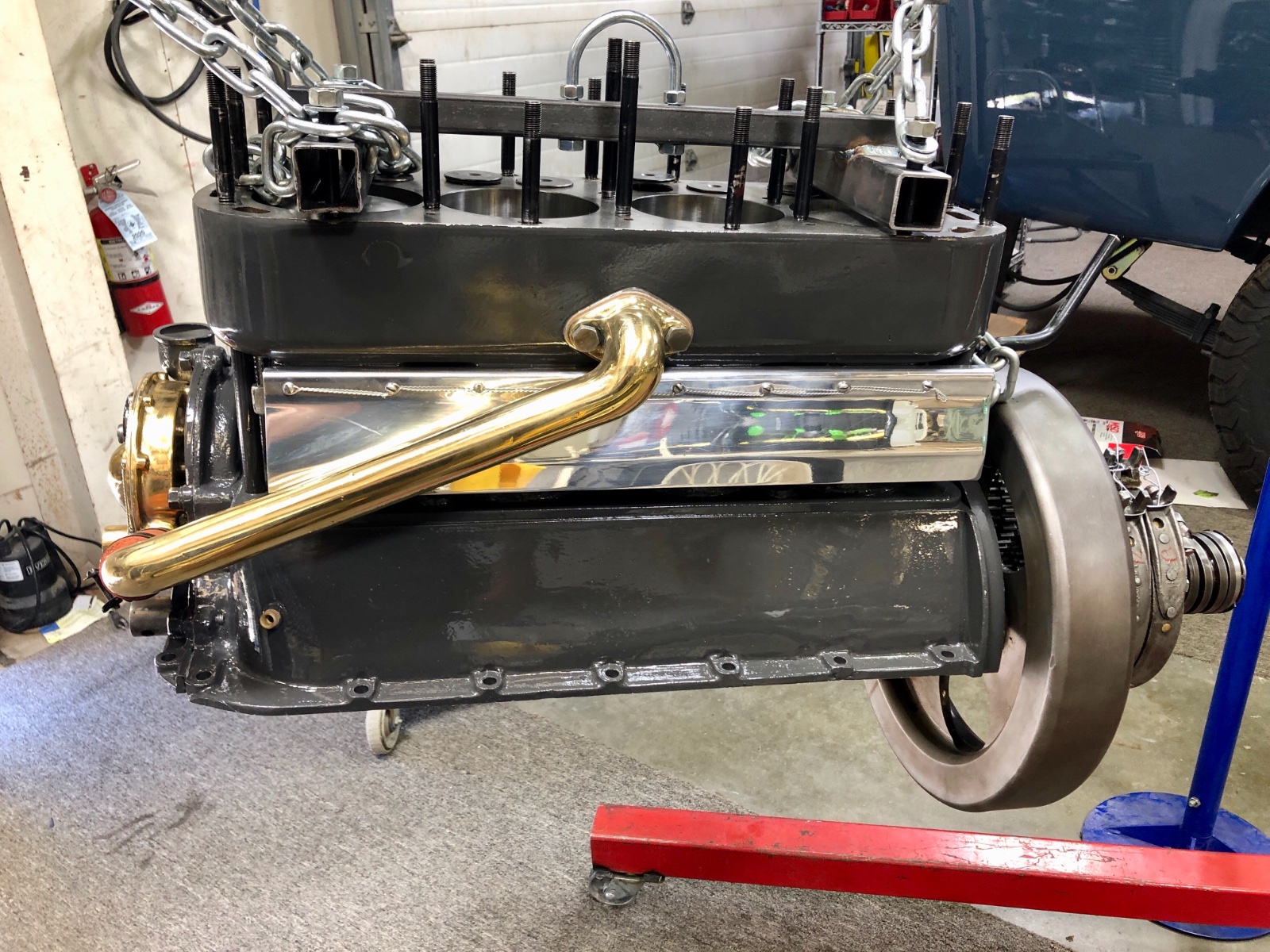

Our 300 cu in motor is almost finished. Tony Schafers, lead instructor at our local college took on the motor after some damage last summer. This is how it looks now. Awaiting the headgasket, then back together and into the car. We’ve had tremendous support with this project, from Fawcett Restoration in Canada, Dean Yoder, Mike Vaughn and Bruce Van Slone with electrical and transmission, and Ben at No Coast Custom and Rod. Stan Howe rebuilt the big five ball carb, and we’re about to put it on the road again.

Such a big beautifull beast that motor...
were those extra oil lines an original fixture or did you add them for safety ?
Thanks for sharing the pictures !

What happened to it last summer that caused it to be worked on again?

I think I overheated the motor last summer, and there was scoring on the pistons and cylinder walls. Fortunately we were able to hone the cylinders, but needed new pistons. When Tony got into the motor, the crankshaft also didn’t turn well (videos below) and was binding. The shaft was straight and the bearings were fitted, but evidently not in line. He did a little sanding and brought everything into line.

Now Rob. Was that a test to see if we noticed in the first video that you tightened the nuts on the bearings too tight and forgot the shims, and then you left off the bearings and nuts in the second video so it would spin so well? Everything looks so nice and clean. Does Tony scrub that shop down every night?

Rob,Was that very heavy flywheel balanced while the other work was done? Bud.

Bud, the motor was balanced by Fawcett restoration last year. We only honed and replaced pistons and rings, so hopefully everything is still in balance. We shall soon see...........
