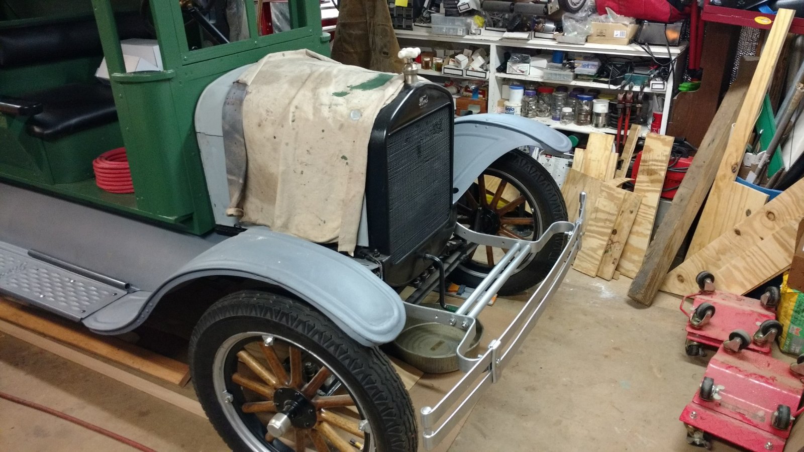

I was hoping someone would start one of these because I've done some things. Didn't see one so I'll begin.
I finnaly finished the front bumper on my Delivery/ Hack. The mounts are the rear mounts from a 1930s A with a tiny bit of modification and the bumper is from a 30s A also.
I also finished the Chalkboard side panels for the car. These slip in and lock and easily come out depending if you want to drive a delivery or open it up for passengers as a Hack. The Chalkboard will make it easy to change the logo or sign depending on the mood of the day.

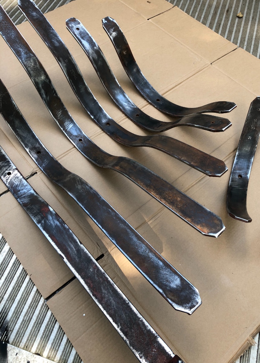

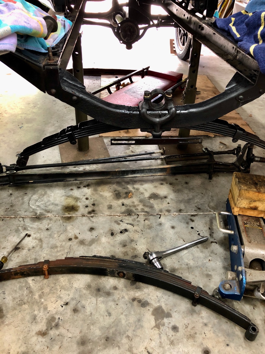

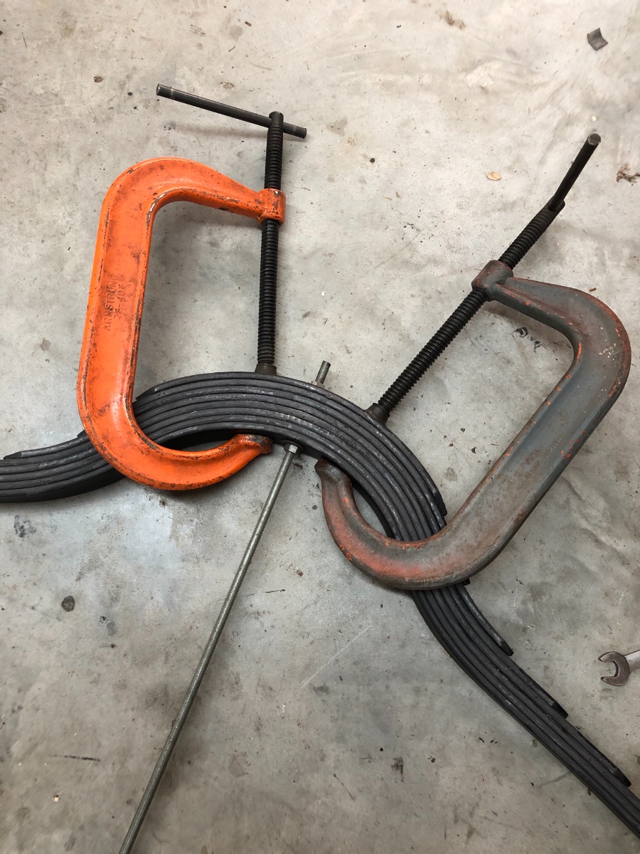

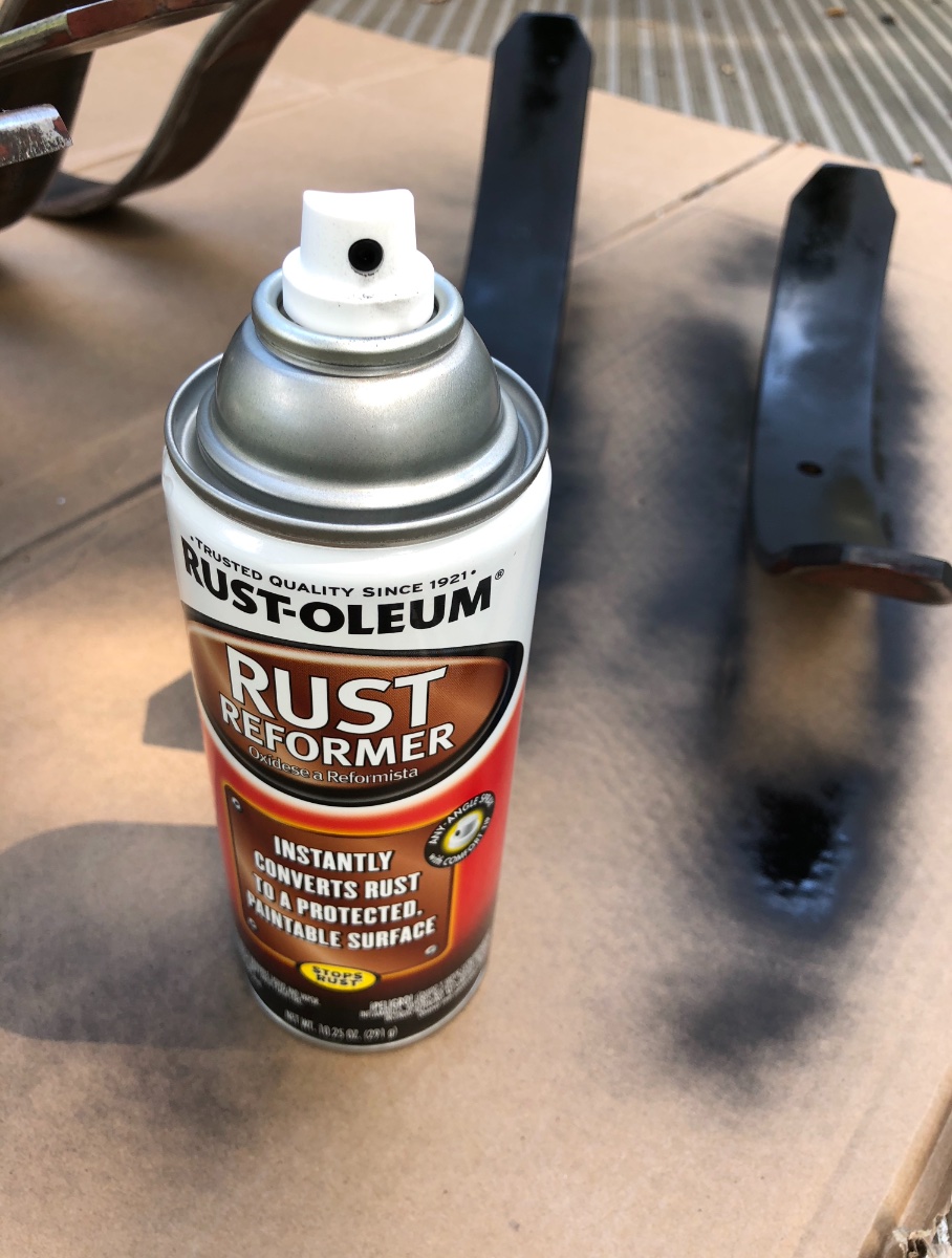

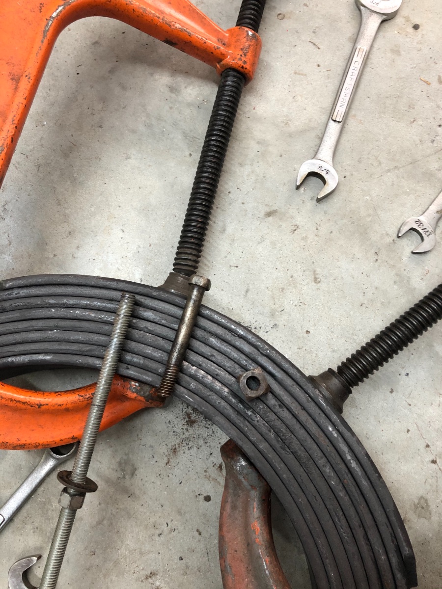

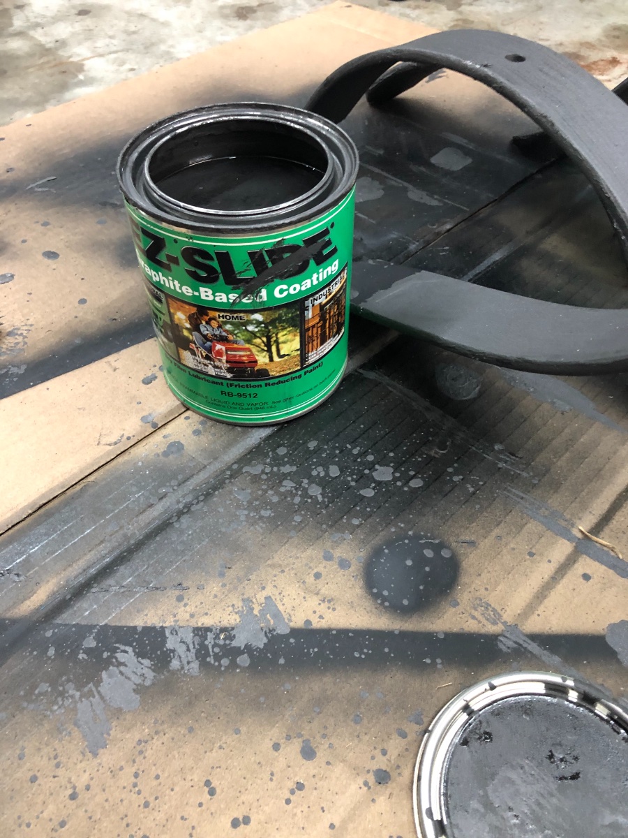

While the motor is out, took apart the front end for rebuild.
The front spring was a put together of some straight cut leafs, and was worn. So replaced it with a fresh rebuild, leafs sanded down, primed, coated with graphite paint, and then covered with nice black. The axle was in rather poor shape too, one perch fell out, both yokes were well worn at the upper hole, and one side had stripped threads. The wishbone sported a very 'egg' look at the ball, never saw one that worn, like a tear drop egg! In fact, two shims fell out from the crankcase socket! Was too worn to shim, should never have been used to begin with. That piece is being replaced too.
Now all the parts are inspected, fixed, painted and ready to go back in place.
. Another axle that was ready to go, another tie rod, and new tie rod bolts, drag link was salvaged and ok, and another wishbone with solid very round ball of right diameter.

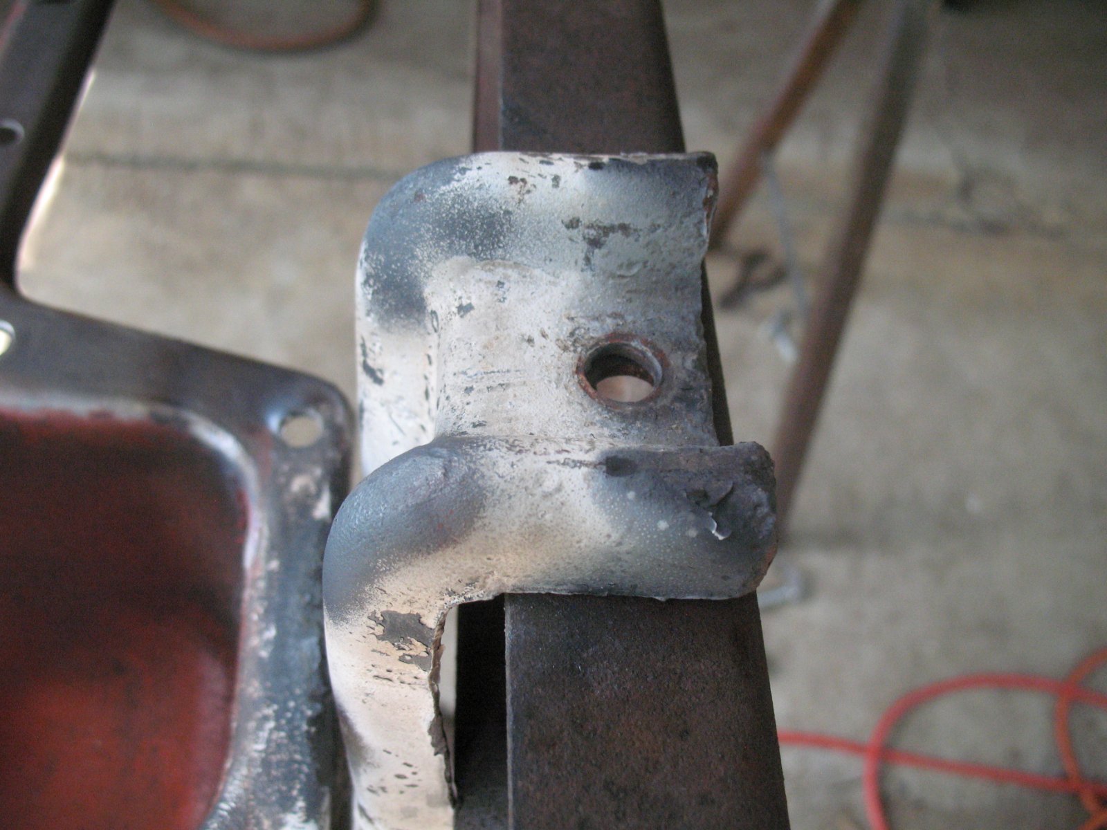

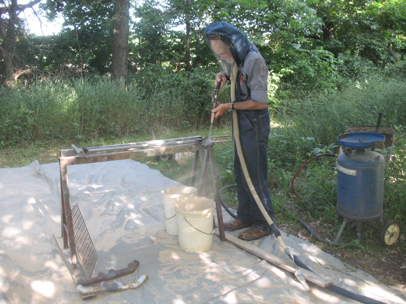

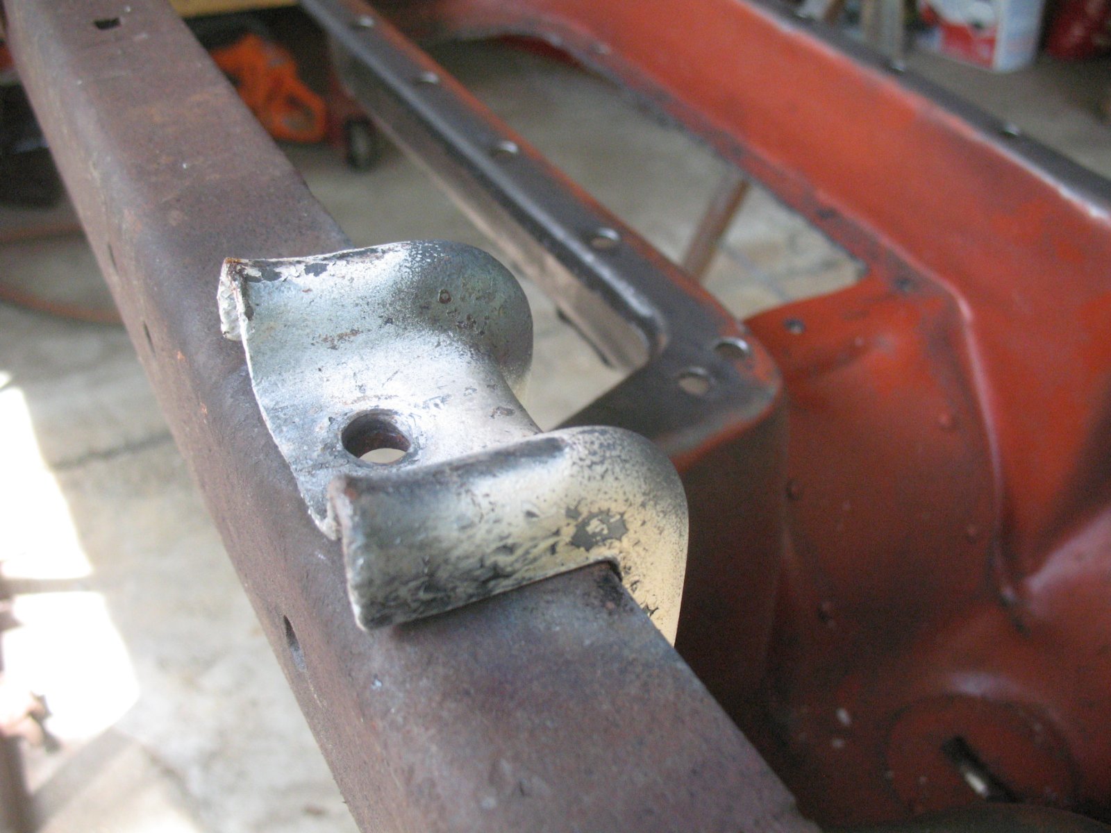

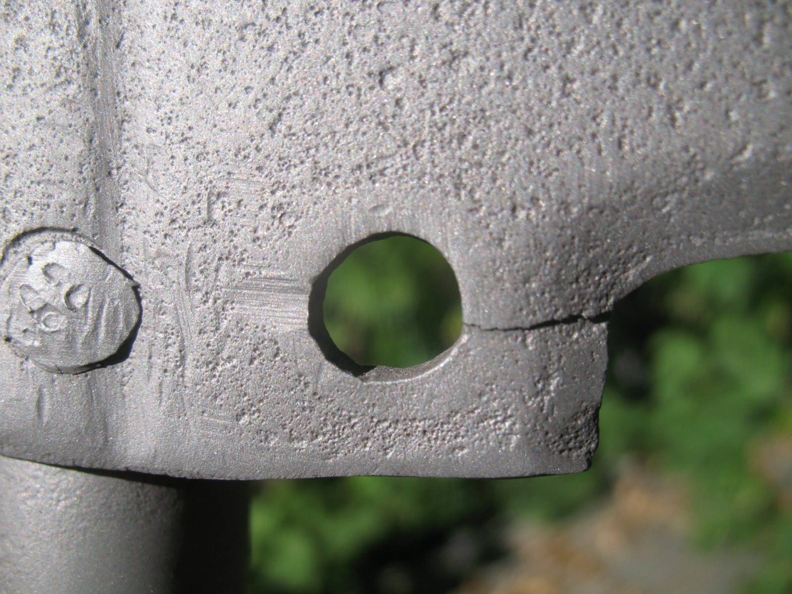

I never posted any T work in May because I didn't do much. Busy with other stuff. Now I'm back in the game, fixing Lizzie's broken windshield. I replaced the broken upright with a piece cut from a junk frame. Did a couple of manifolds while I was at it.
Blasting in the cool of the morning.
Uh-oh... That's not good.
Digging out the crack for filling.
Crack filled.
Crack filled.

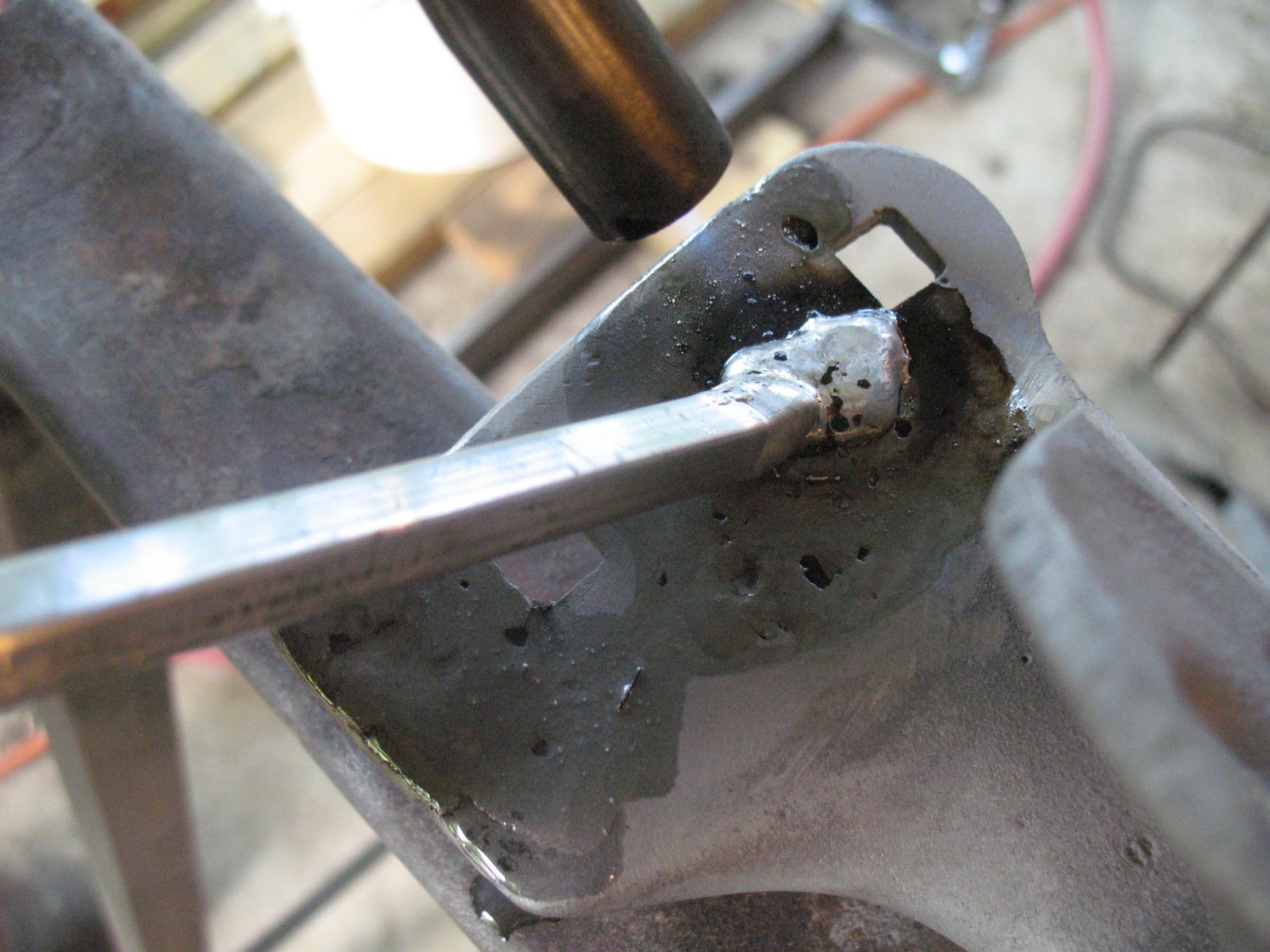

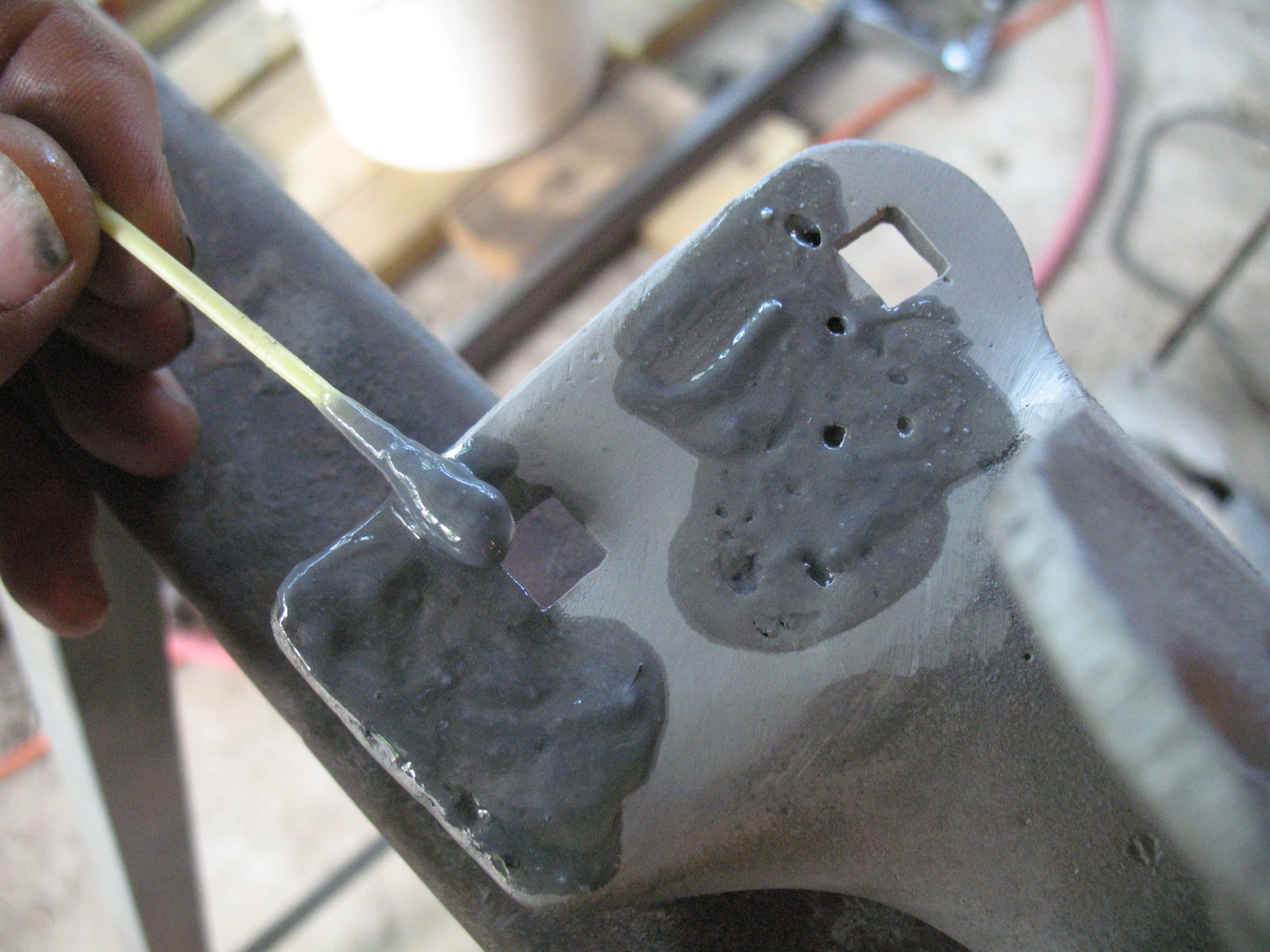

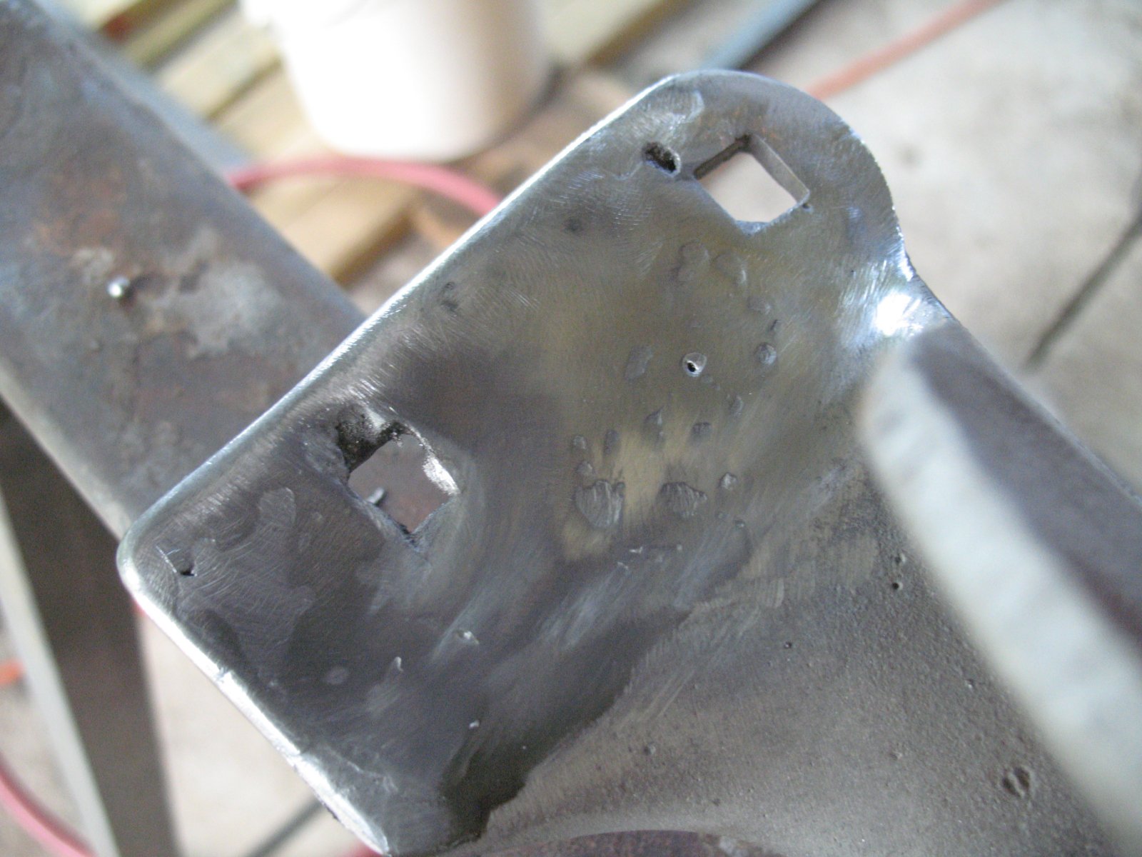

Earlier I repaired these rounded-out carriage bolt holes, and today's job was to fill the little craters around them.
Slathering on the flux.
Melting on the body solder.
Spreading it around, trying not to burn up my stick.
Nobody will ever accuse me of being a skilled body man. I'm calling this good enough for gummint work.

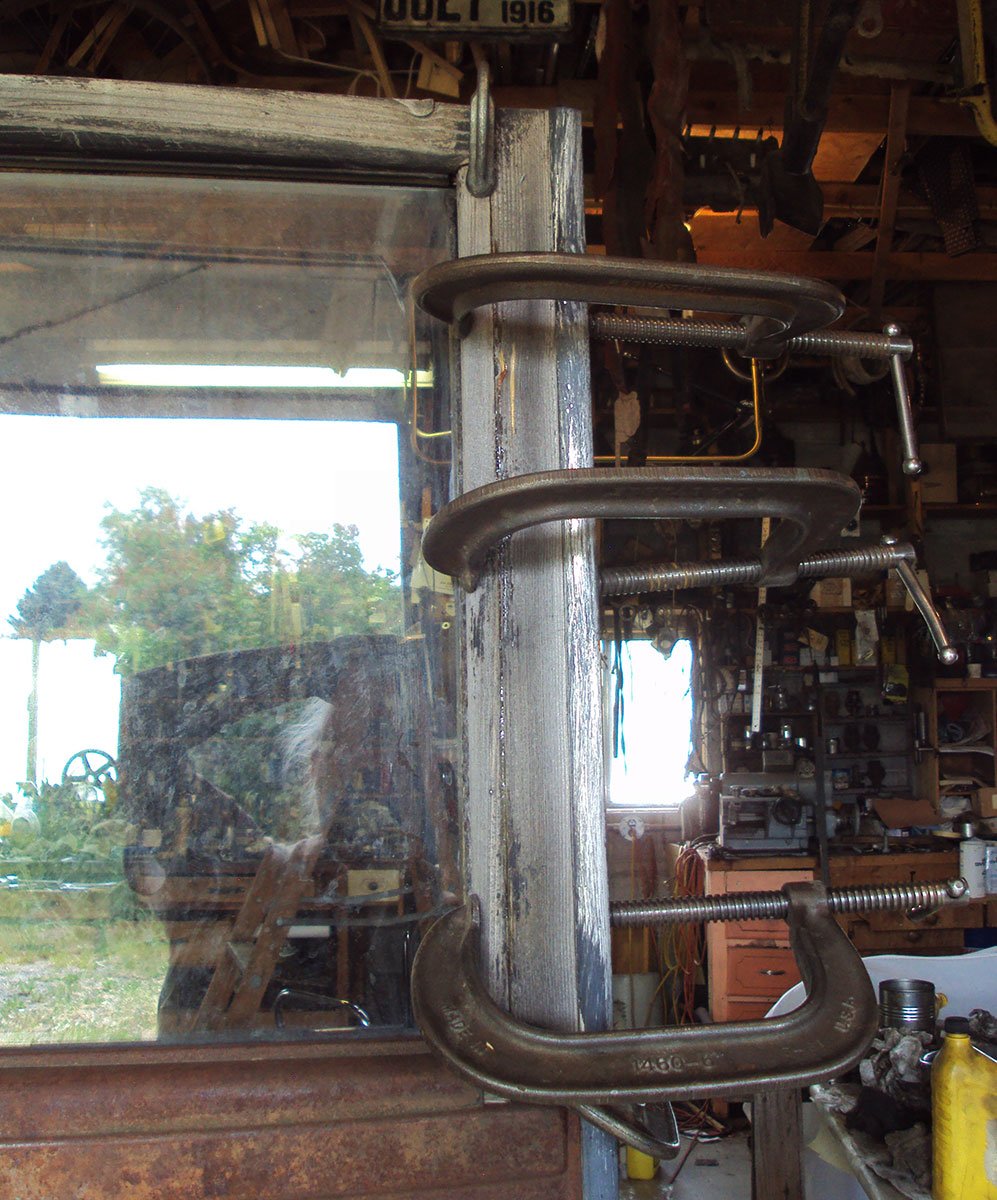

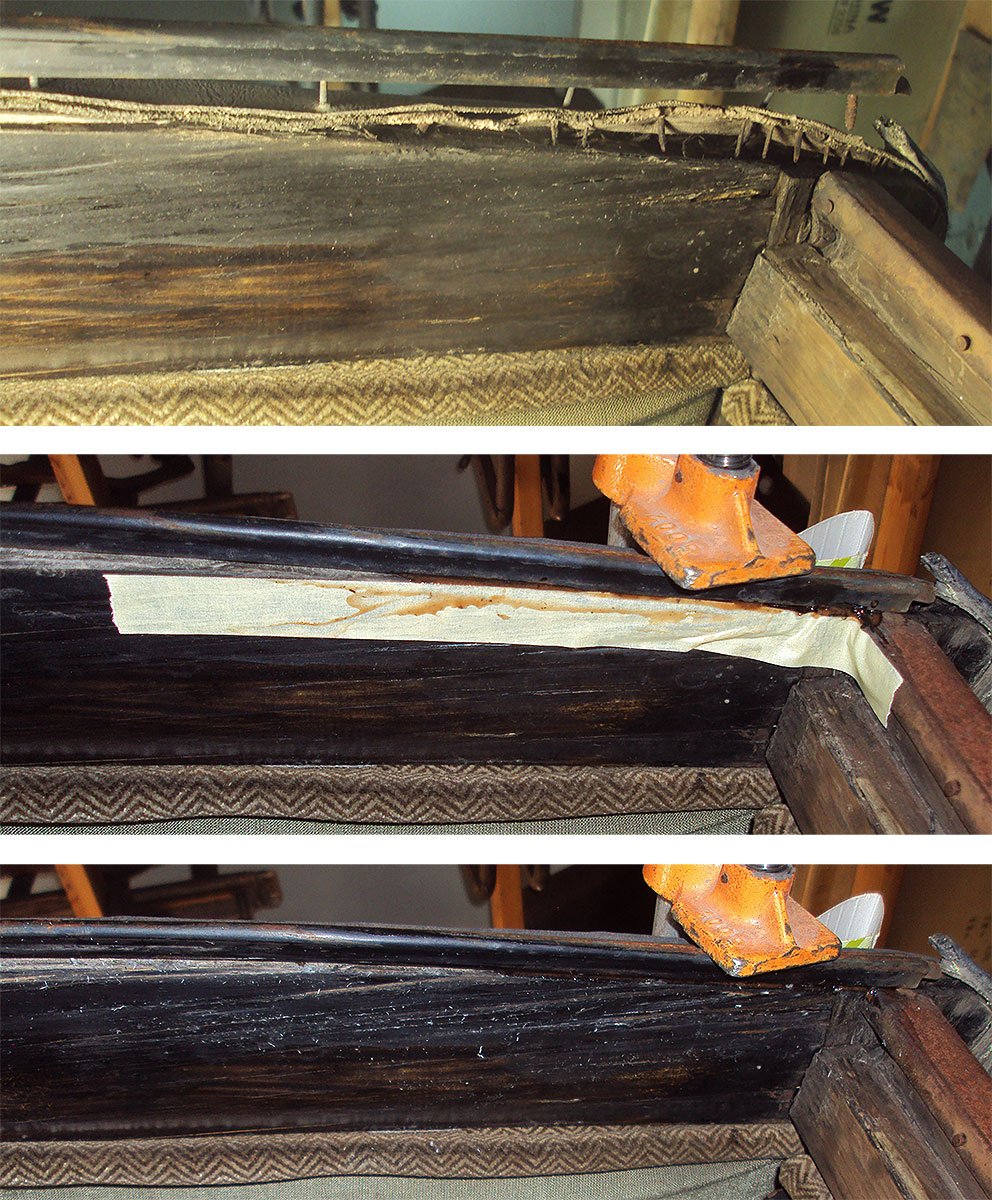

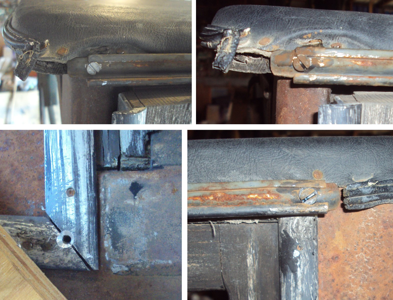

These 3 photos are looking up at my rain-rails at the front of my Coupe top. When I made these rails I made them straight and bent them on the car. I knew the pine would cause problems and here the nails have pulled out as the wood gets old (7 years). Today I mixed up some West System Epoxy that is a dozen or more years old. The 2 fluids still pour out even at 10% left each. I dobbed the epoxy in and pulled both sides in using a furniture clamp. I will let it sit overnight and see how well it worked.
I had enough epoxy left to re-glue two moldings back in place. The one shown and one above the quarter window. These had been glued with Elmer's and no nails. Not bad for 7 years I suppose. As with the rest of this car I am experimenting with different things that may not be the best choices but I'm learning a lot from it.

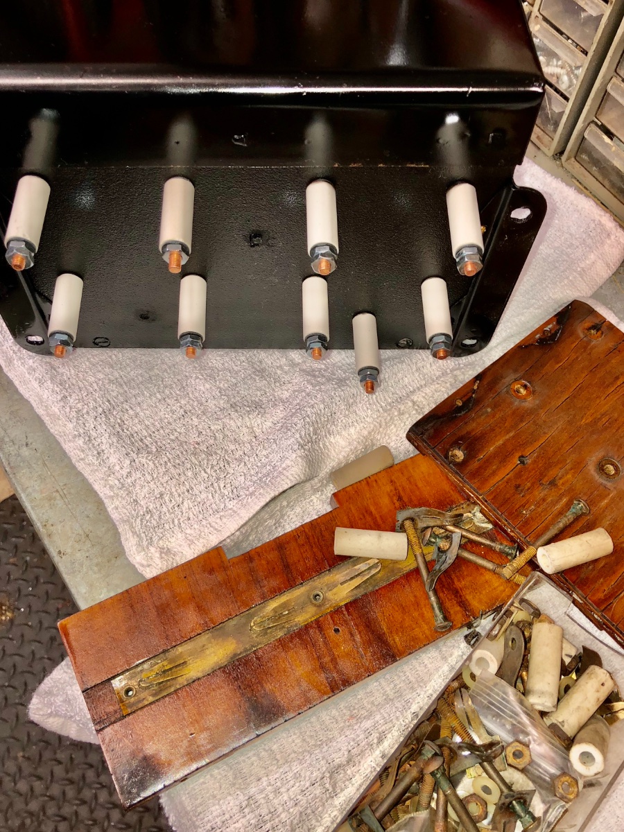

Some clean bench time, rare thing in the garage, usually doing some greasy, gritty stuff.
So received the plastic rebuild kit for the '25 coil box, and new brass screws, nuts, and porcelains, along with new bronze contacts.
The old box had been restored in the past reusing contact and porcelains, and with heavily varnished plywood that was about splitting apart.
Now the box is good for at least another 50 years.
Every contact and brass screw got soldered together for best electrical connections.

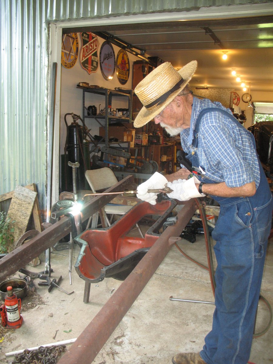

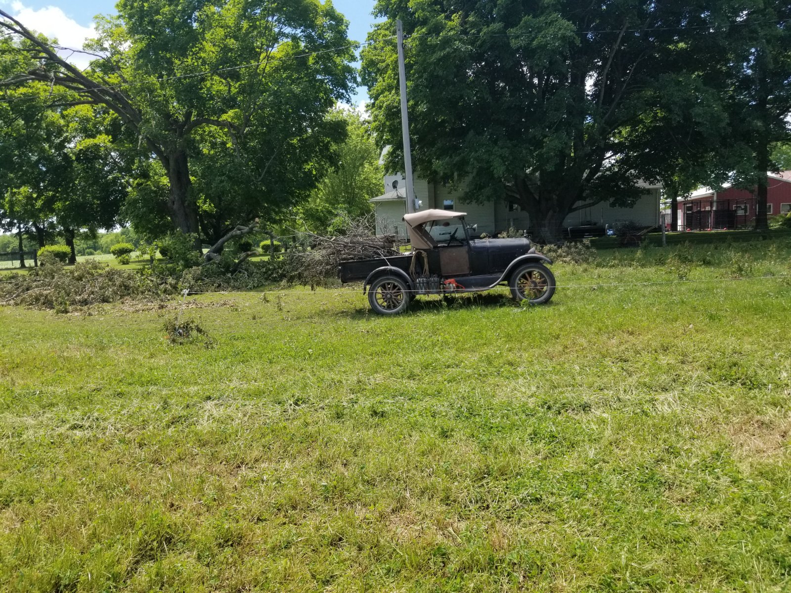

Well after 2 1/2 days without power after the storm, it was time to clean up some damage.
Who says work cant have fun mixed in.

Dan, I like your coil box rebuild. I recently bought the parts from Lang’s to do the same rebuild.

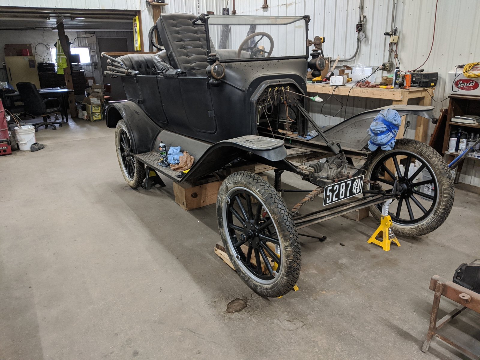

Wrapped up over a month of concentrated effort to get the 13T running, again. Over the last week-ish I made a new gas line, cleaned the carb, set the timing on a new anderson anco flapper style timer, and got the old girl running for the first time in years. (Well for a few moments before I had to stop it so the engine didn’t overheat due to no radiator. Have one on order with Brassworks)

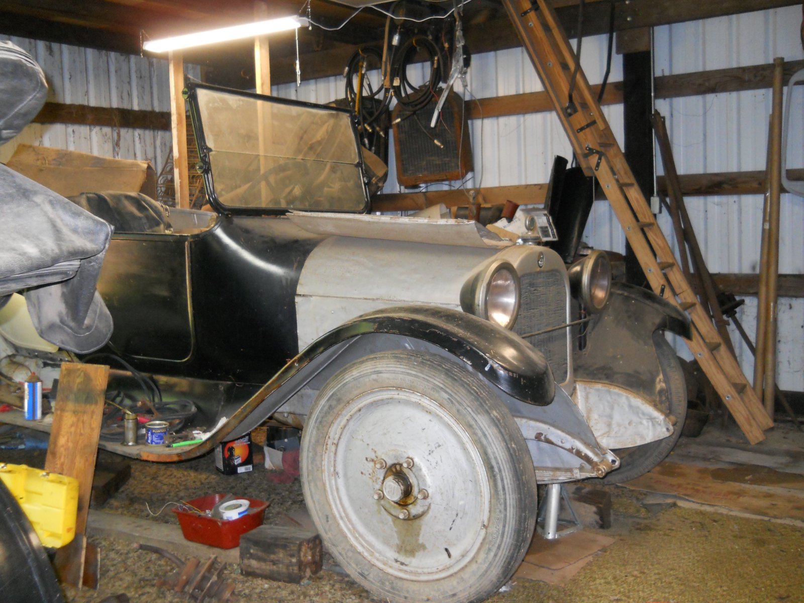

Squirrel
- Posts: 140
- Joined: Sat May 30, 2020 9:54 pm
- First Name: Jim
- Last Name: Forbes
- Location: Sierra Vista AZ
Re: What have you done in June 2020

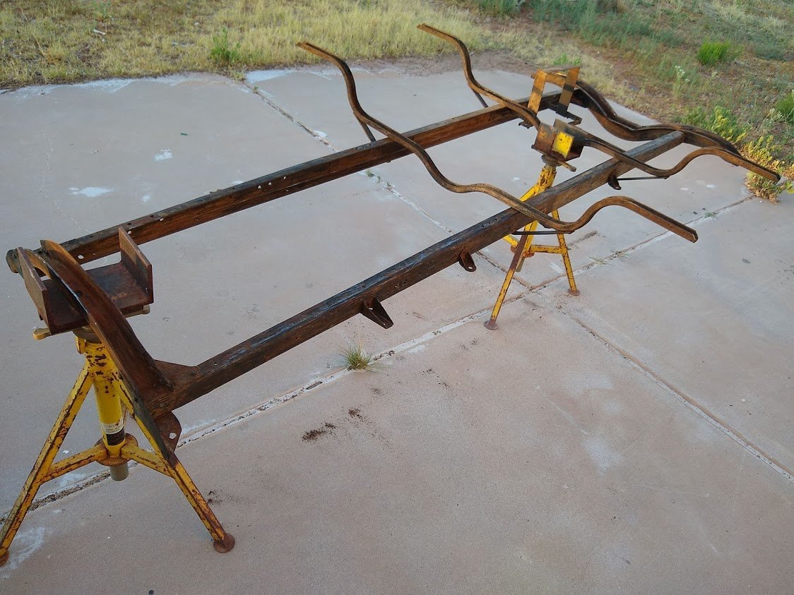

Took the coupe apart enough that I'm going to sandblast the frame tomorrow...
the fun part will be getting the car all back together and driving while it's still June 2020. I think I can make it.

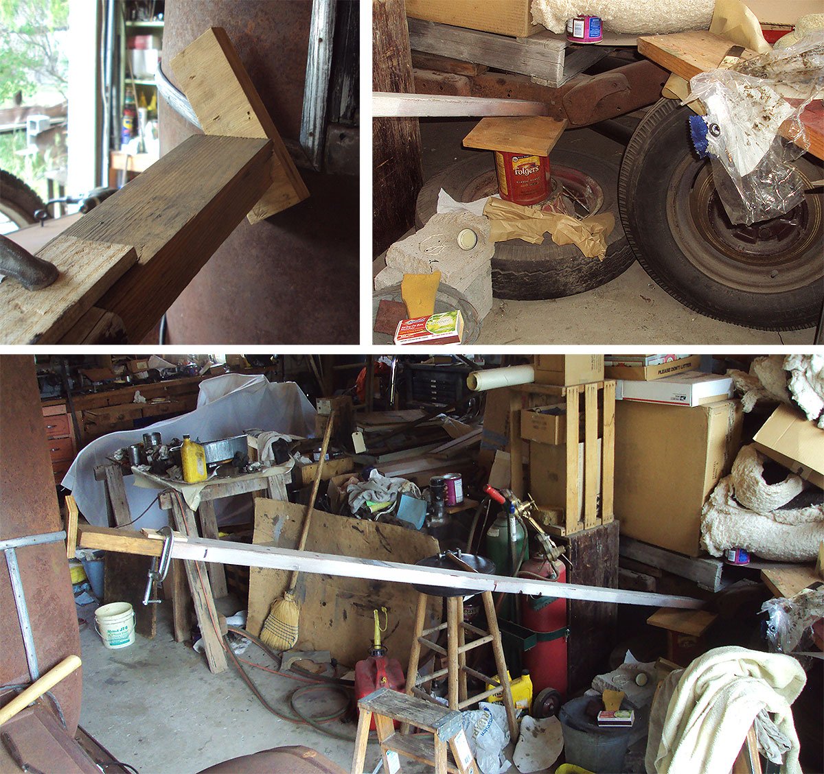

The repairs to the rain-rails reported Friday seemed to work. I installed some long screws to help hold them tight against the roof structure. Some thin paint followed by rusty waster hides the shine.
As it turns out some of the new aluminum moldings are working away from the body. My solution was to force them back in place using a 2x4 against the wall and then against a heavier chassis. Then drill and countersink for a wood screw and grind the head flush.
I though some might enjoy the improvised board where a C-clamp won't work.

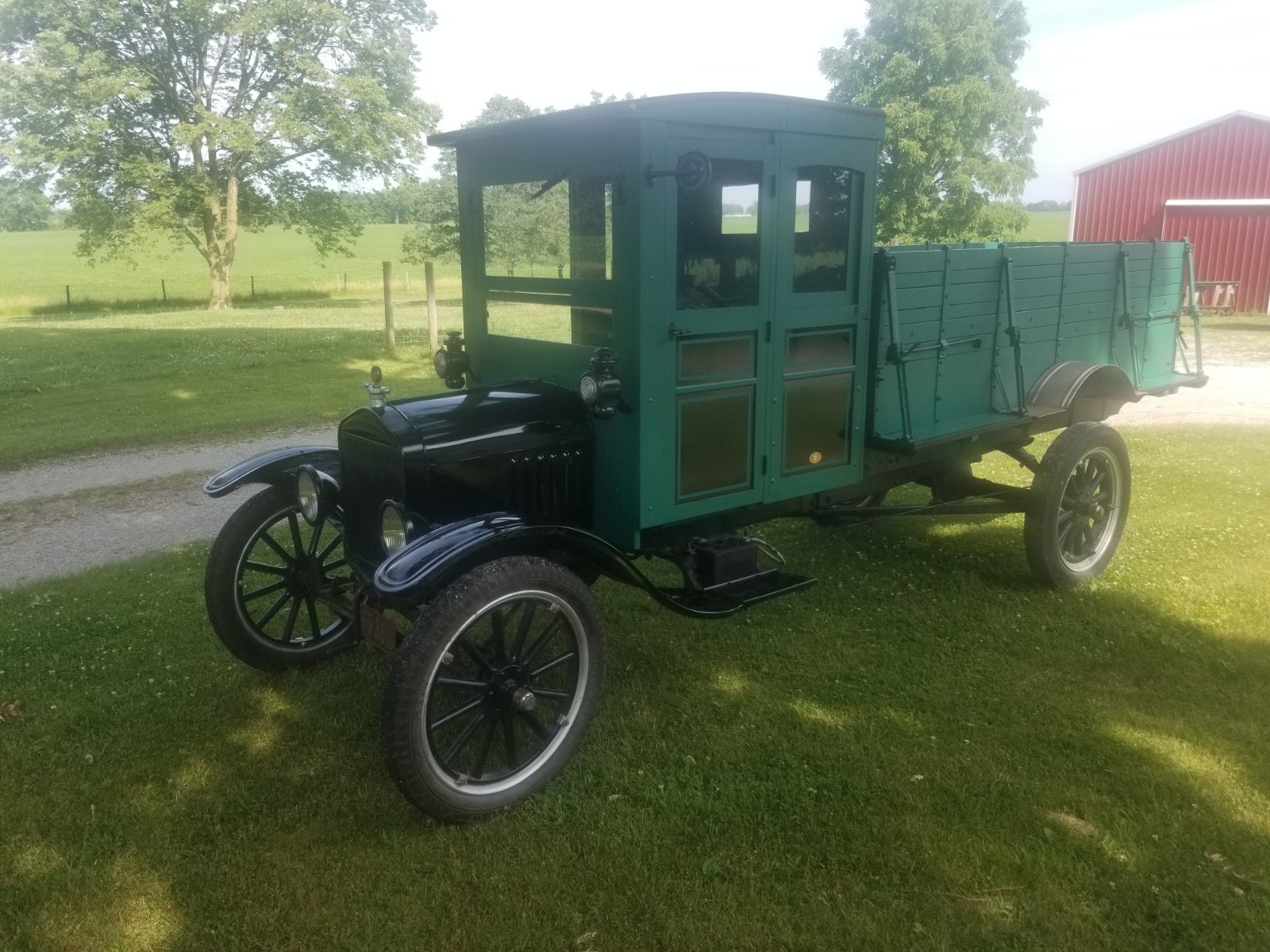

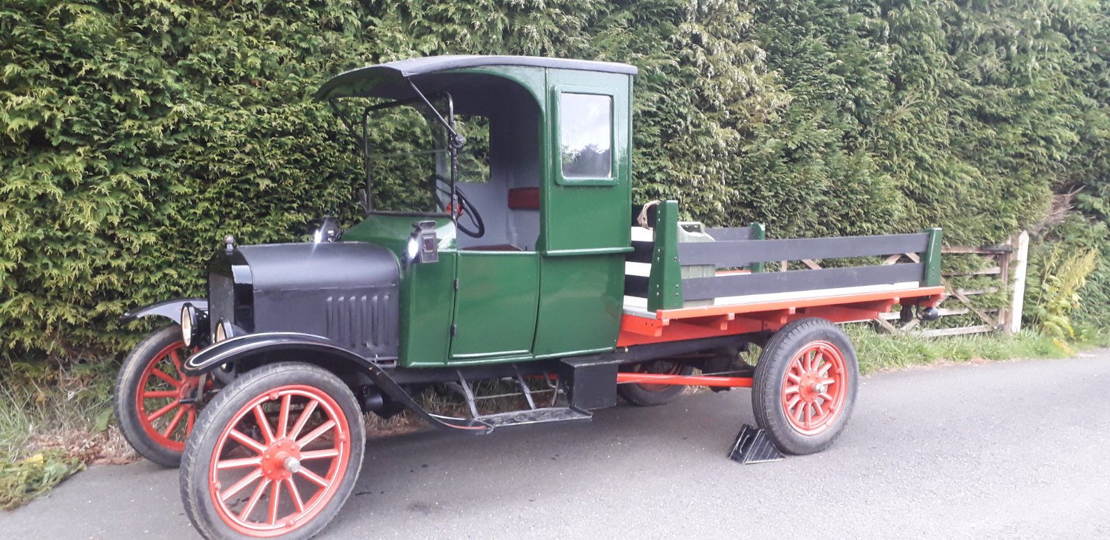

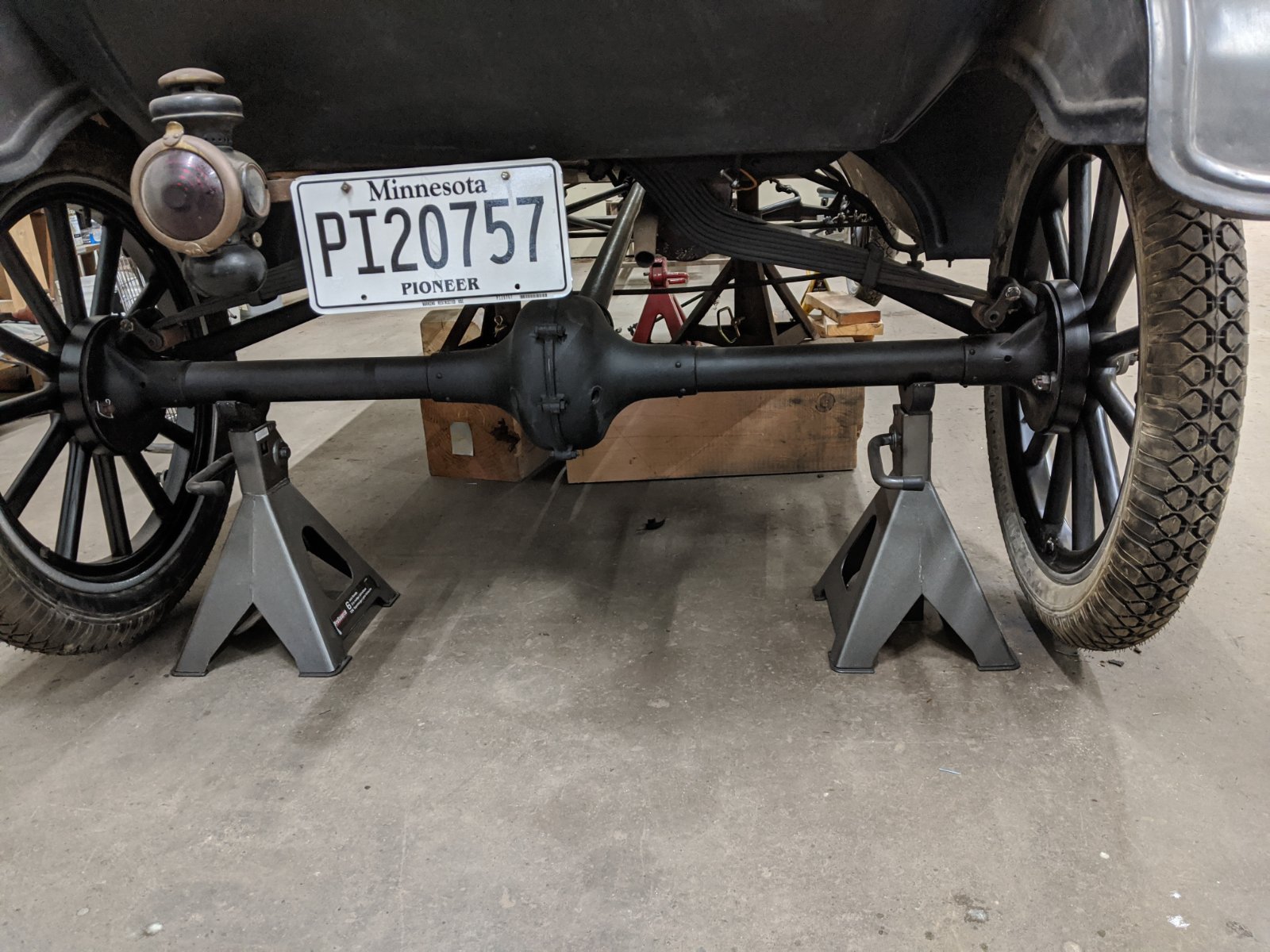

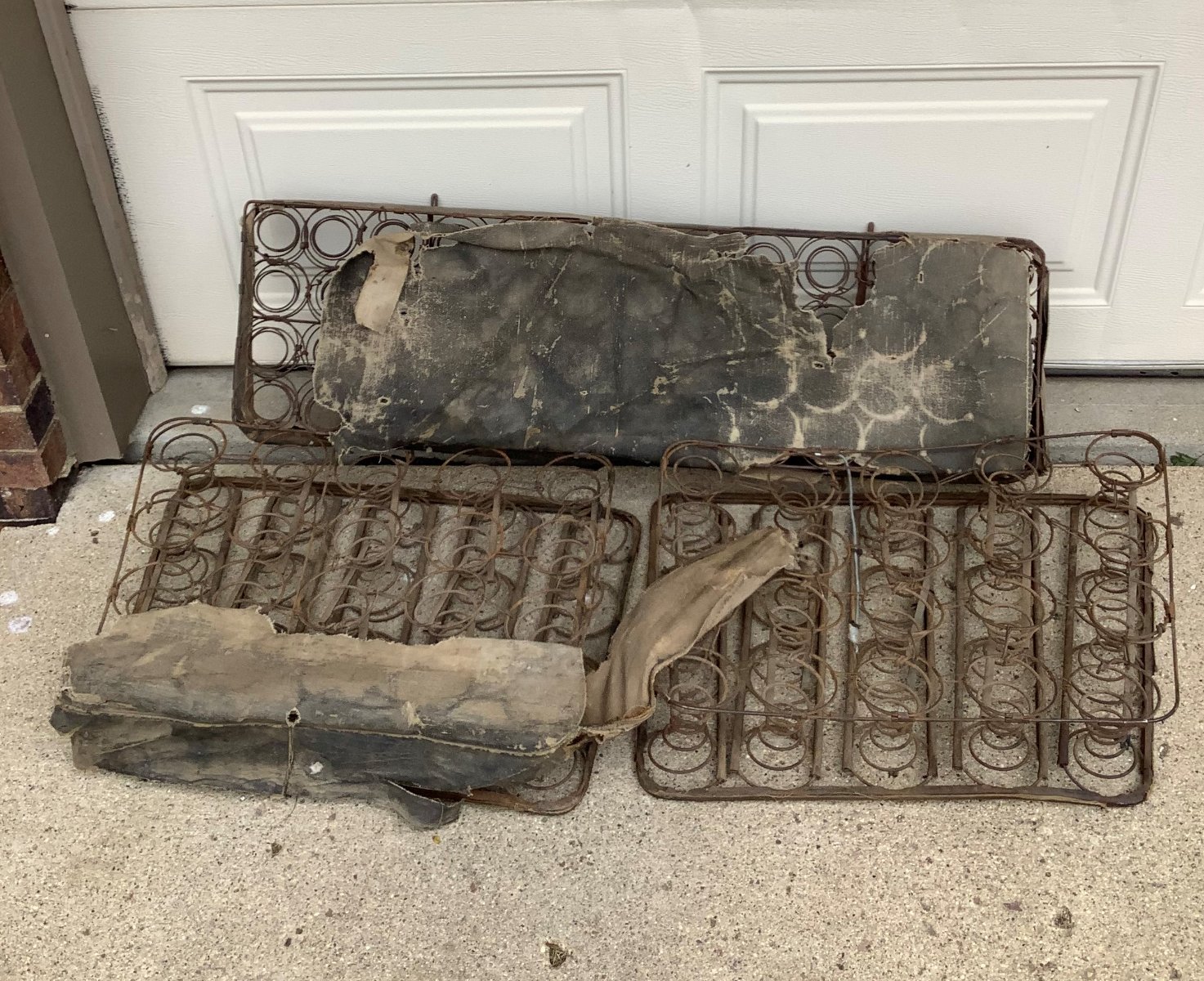

Lots of thumbs up from family members with this one. After sitting on bare springs, boards, foam, bare gas tank etc, we ride with some comfort.

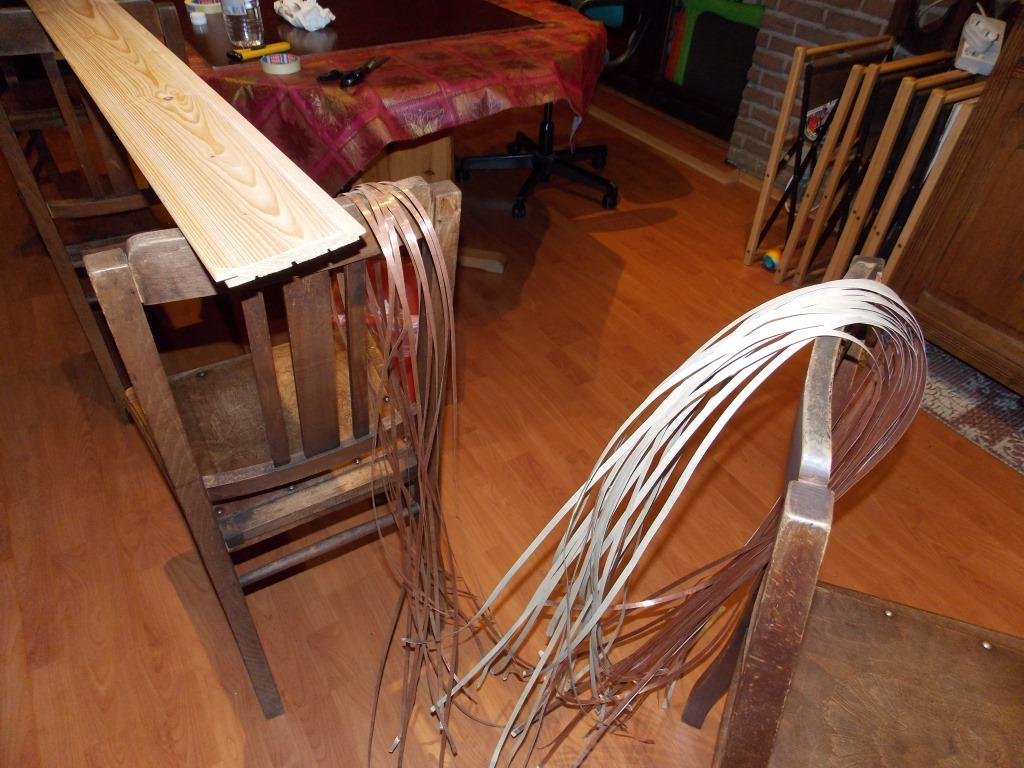

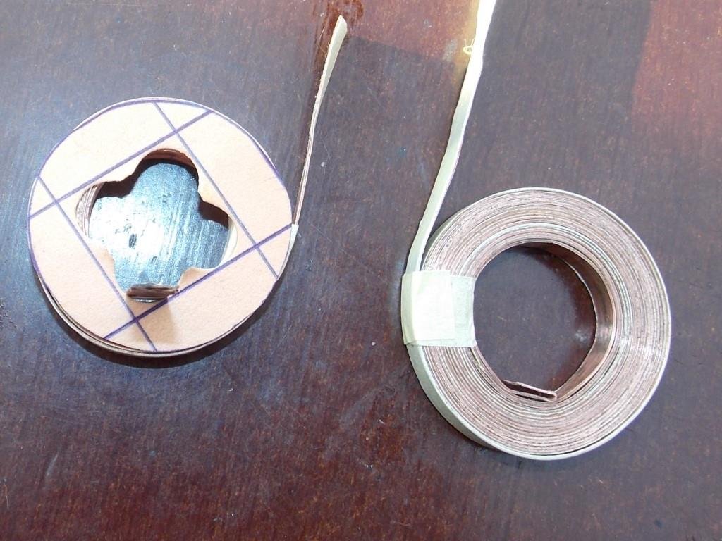

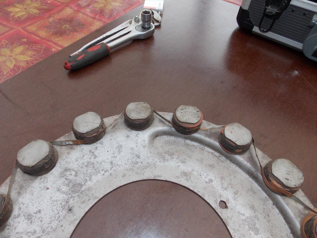

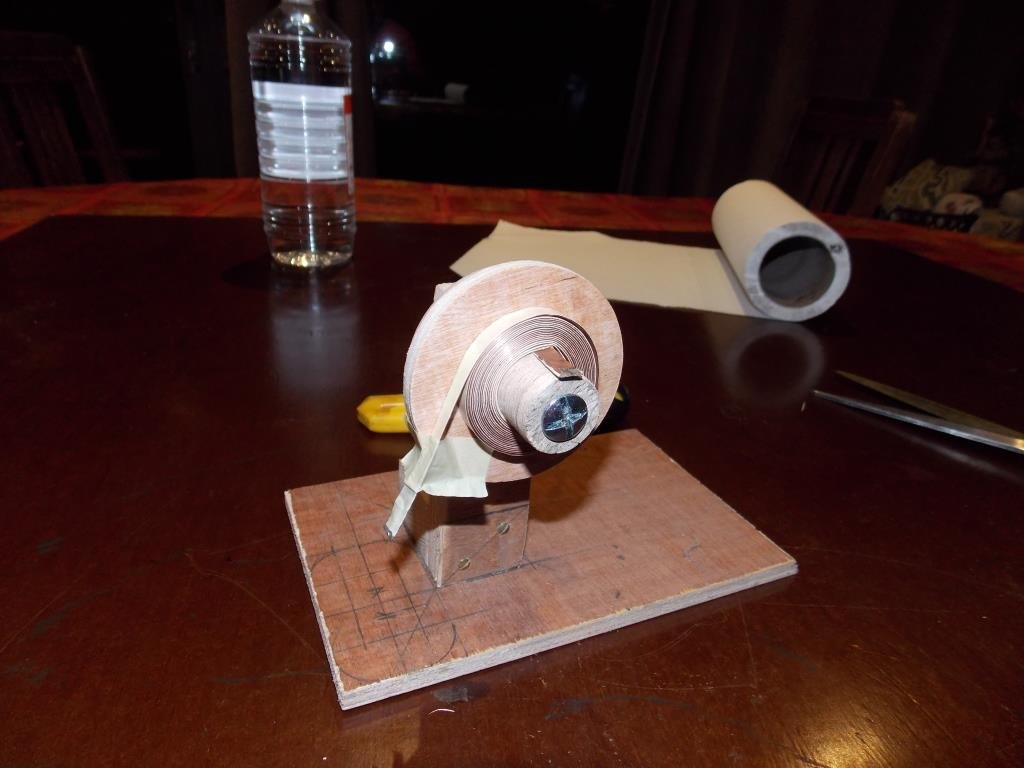

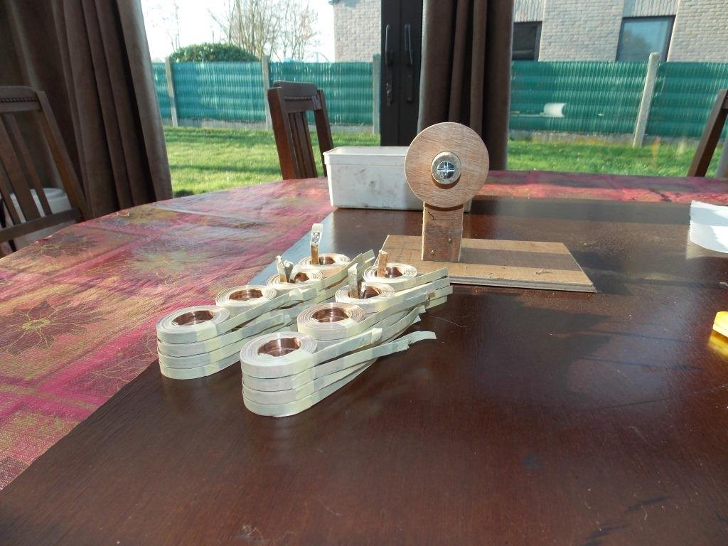

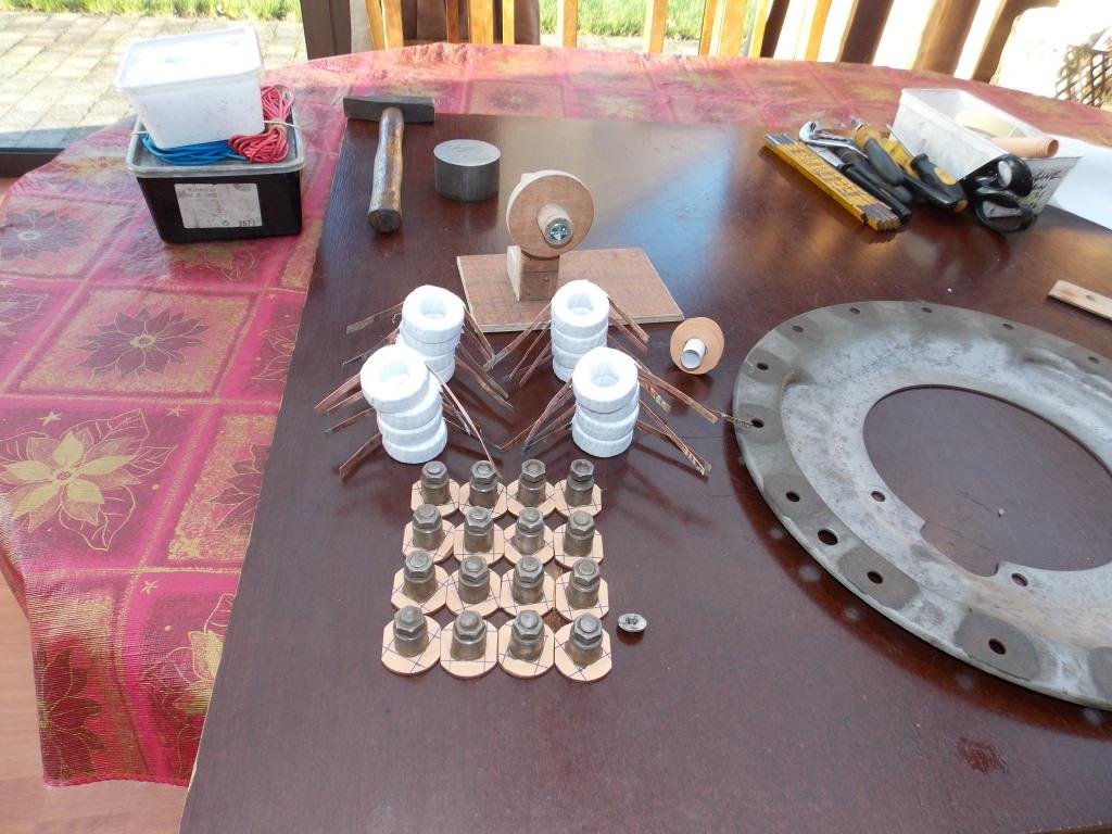

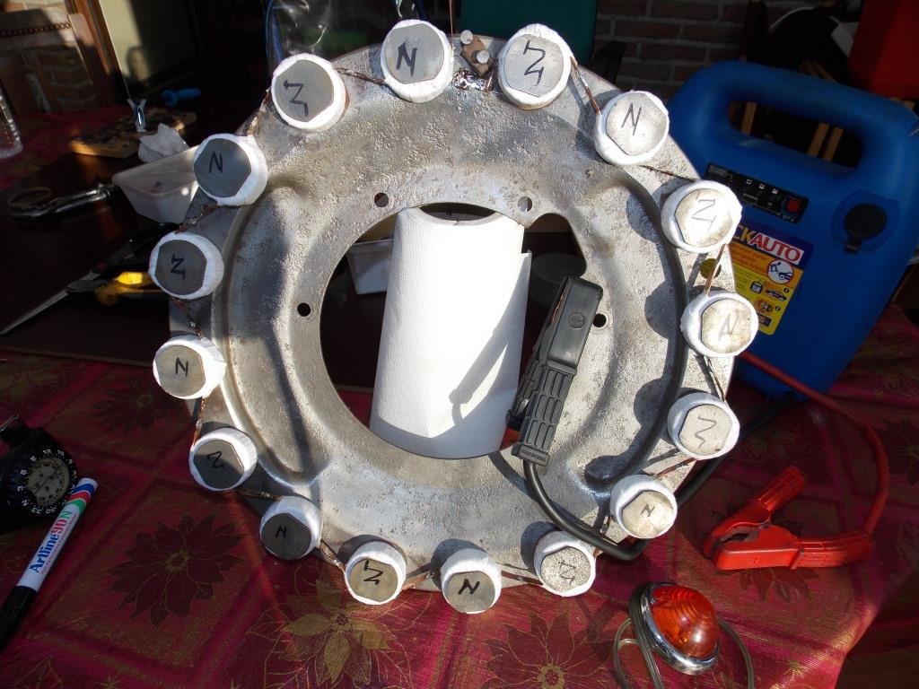

Nearly finished the rebuild of a 1912 magneto coilring.
I will post a few photos of the job in the next 3 posts.
Her are the first.
Andre
Belgium
Her are the first.
Andre
Belgium

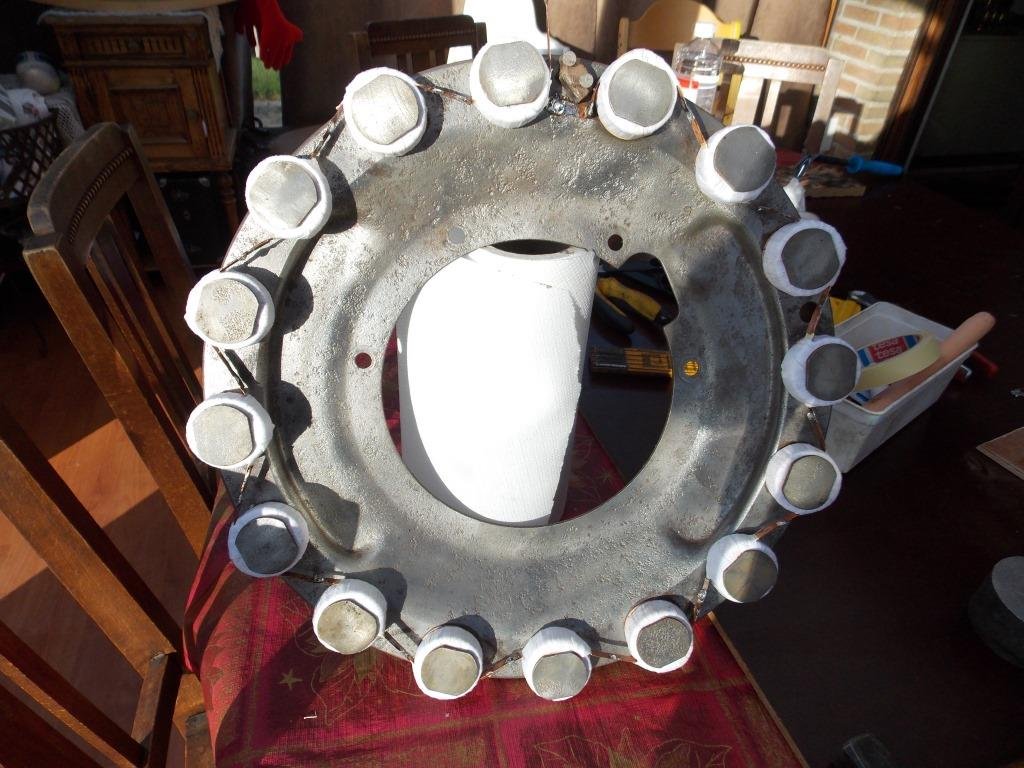

second

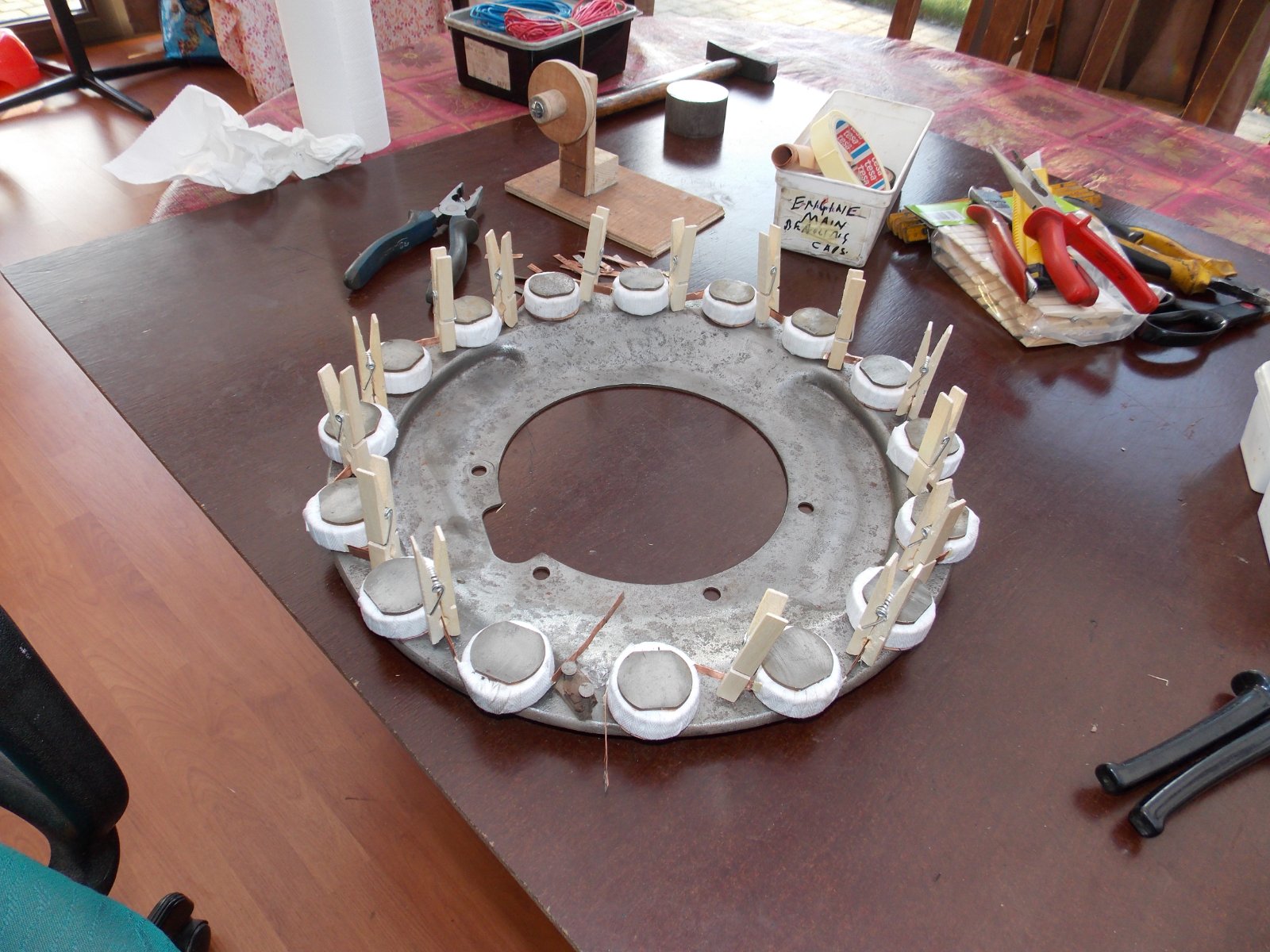

Last post.
I need to build a new contact point and coat the coilring.

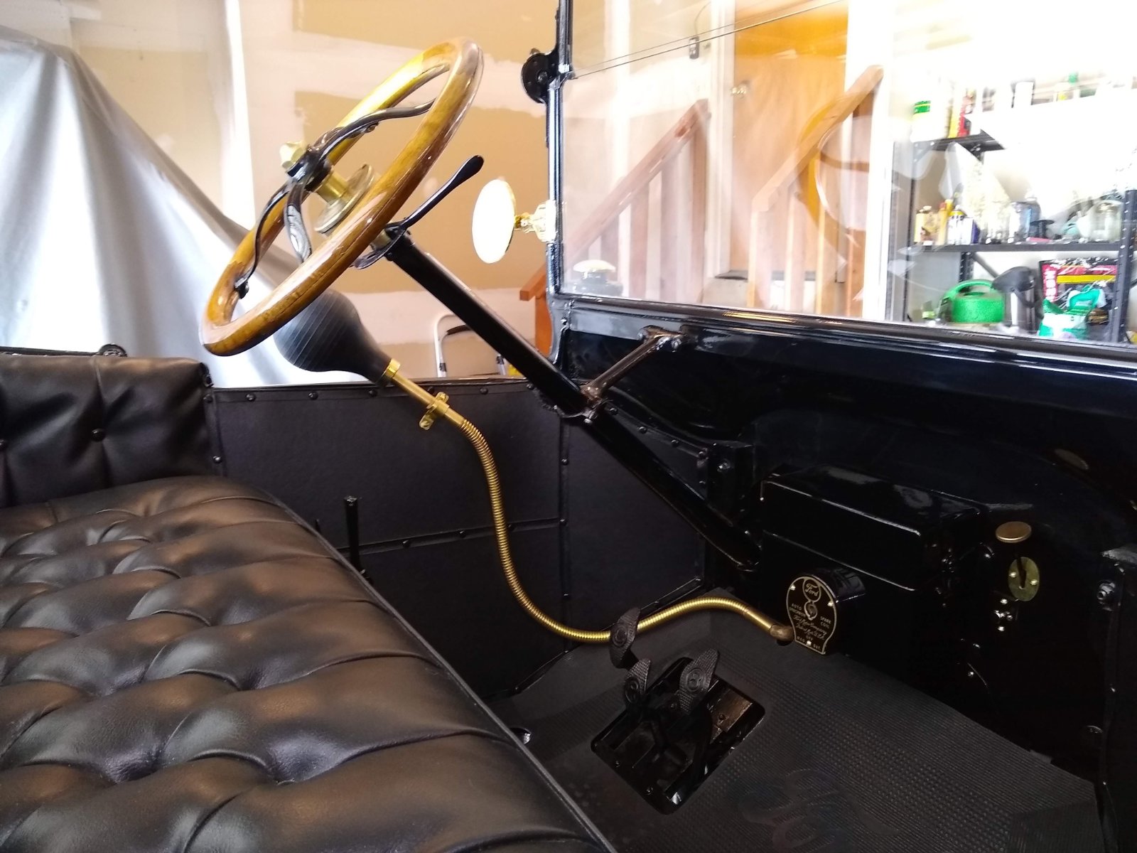

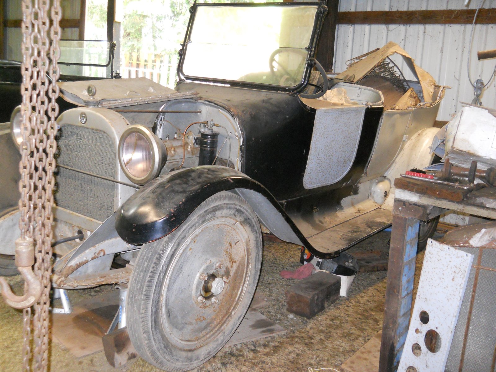

How about finishing up a 25 year restoration? Mark and Phil Eyre's '11 Torpedo is done. Looks like a decent job to me...
Seriously folks, the car is absolutely stunning.

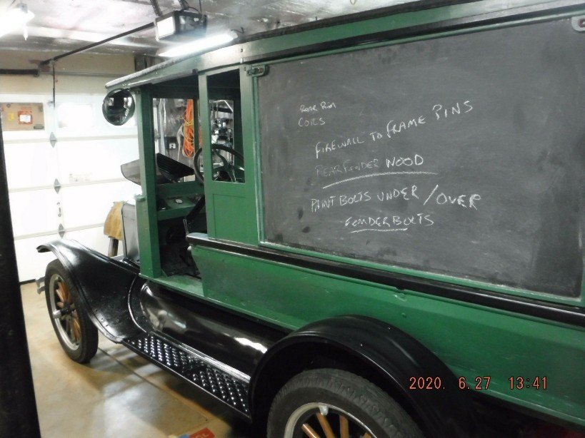

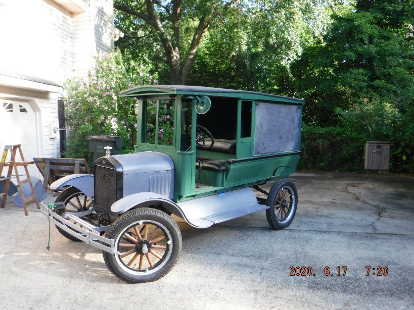

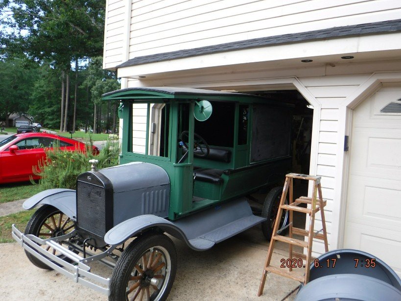

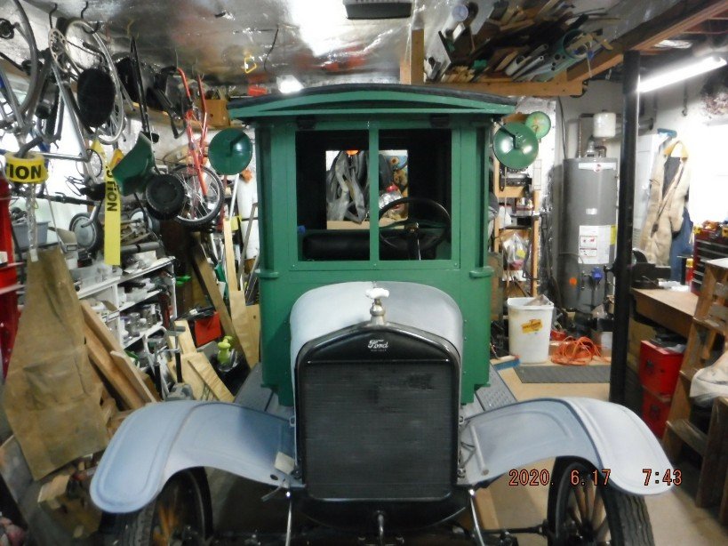

For the first time I pulled out my Delivery/ Hack out of the garage. I needed to spin it around and put in the shop the other way in preparation to lift the body to remove the fenders and splash shields. It took 7 months to build the body and the whole time I kept worrying that it would be to tall. It clears the door by 1 inch. No problem.
I wanted to finish all the body movement before putting in the Windows.
Just give me time to Rust and I'll be good as new.

Remember, you can always let the air out of the tires,or at least some of it, so it fits a little better under the door. Then air them up and go for a ride.
Mark Nunn
- Posts: 1287
- Last Name: Nunn
- Location: Bennington, NE
Jim, with only 1" clearance I would suggest wedging a board between the ground and the open garage door to make sure that it is open as far as it can be and stays that way. You put too much into your truck to risk damage.
- Posts: 2547
- Last Name: Strange
- Location: Hillsboro, MO
- Board Member Since: 2013
Most garage door openers have up and down stop adjustments on the control unit. Adjust the up stop so that the bottom of the door rises up enough so that you have use of the entire height of the garage opening.

Also thinking of switching to kevlar or wood bands and now would be a convenient time to do that.

Off topic! LOL I spent the day getting the 1920 Dodge running.
After doing some moving around and taking down a fence I moved the 25 into the back yard. Between bring over the extra Dodge parts and very soon the car, I have a T rear end to build. Can you spot the Ford parts, no not the Hasslers.

Mark:
you will really like the Dodge Brothers touring … I have had 7 DB cars over the past 35 years , currently have a 1925 touring … powerful and reliable cars … also , the Dodge brothers club offers much technical support as does the MTFCA … if I can help with questions please do feel free to ask ...always an optimist...Gene French

Thanks Gene.Gene_French wrote: ↑Thu Jun 18, 2020 9:14 amMark:

Rebuilt the rear spring on the '25 Coupe, 8 leaf.
Used 6" grinding pad, cleaned off rust, and rounded the contact edges of the leaf ends for good sliding.
Now a coat of primer, that keeps rust stopped.
Let that fast dry, then coated the contact surfaces with graphite paint.
All-threaded rod and pulled the stack together, then held it fast with large C-clamps.
Lastly, pulled the all-rod, and placed the proper spring bolt and nut.

Drove the TT to beakfast

Dallas, The TT is a beaut and looks like you're putting 'er to good use! Nate

Thanks Nate. Its pretty dirty from living in the barn but I think its at home there. Its a real joy to drive.

I just wish Dallas would paint those rear fenders! Just looks tacky man! Are you from Tin-A-See?

Hank, T's are never really finished are they.

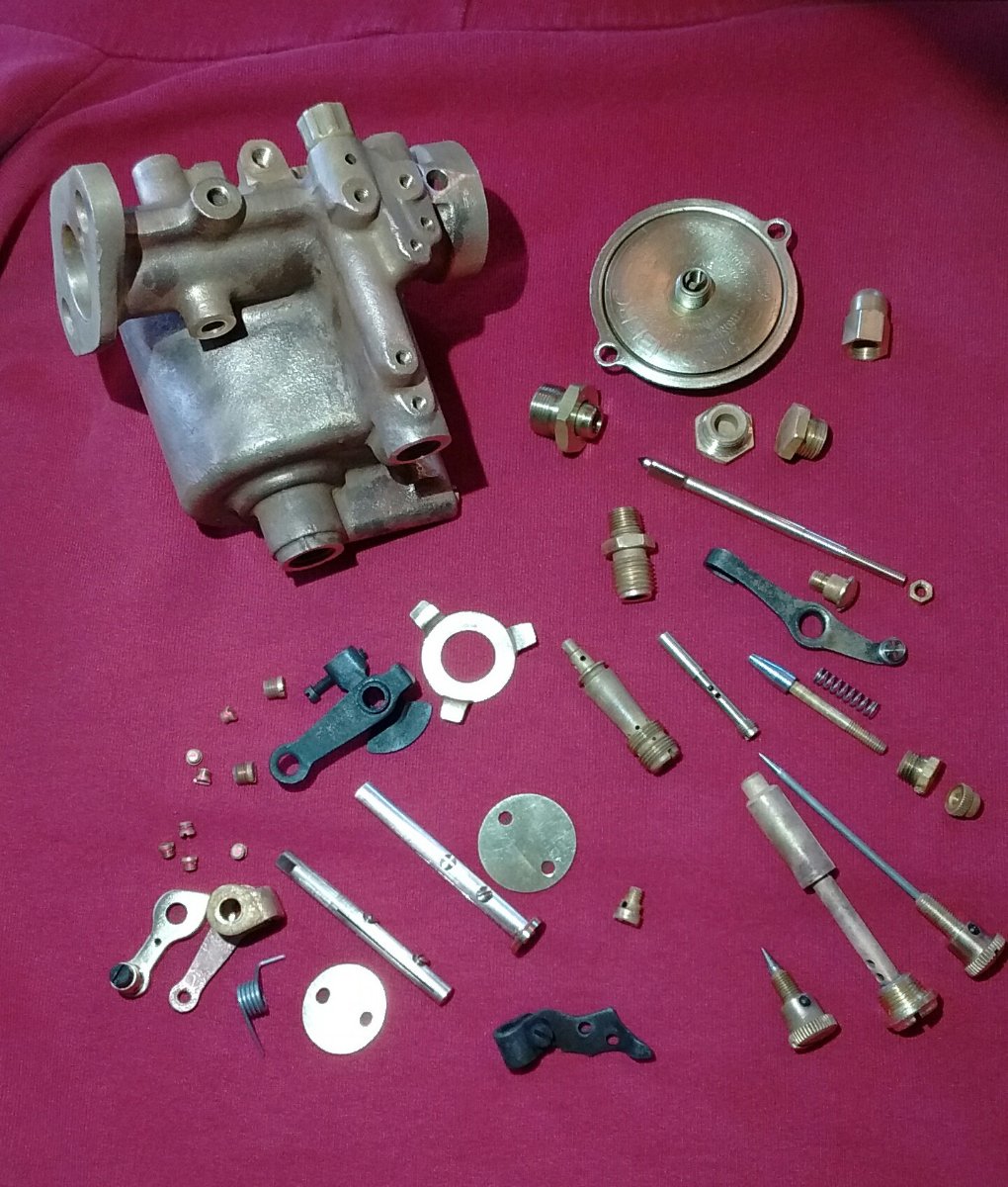

Finishing up another one. Clean, but not gussied up yet for it's photo

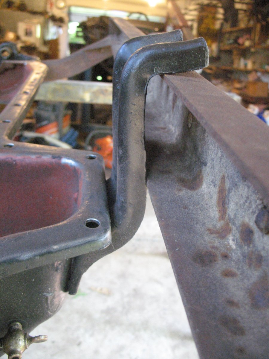

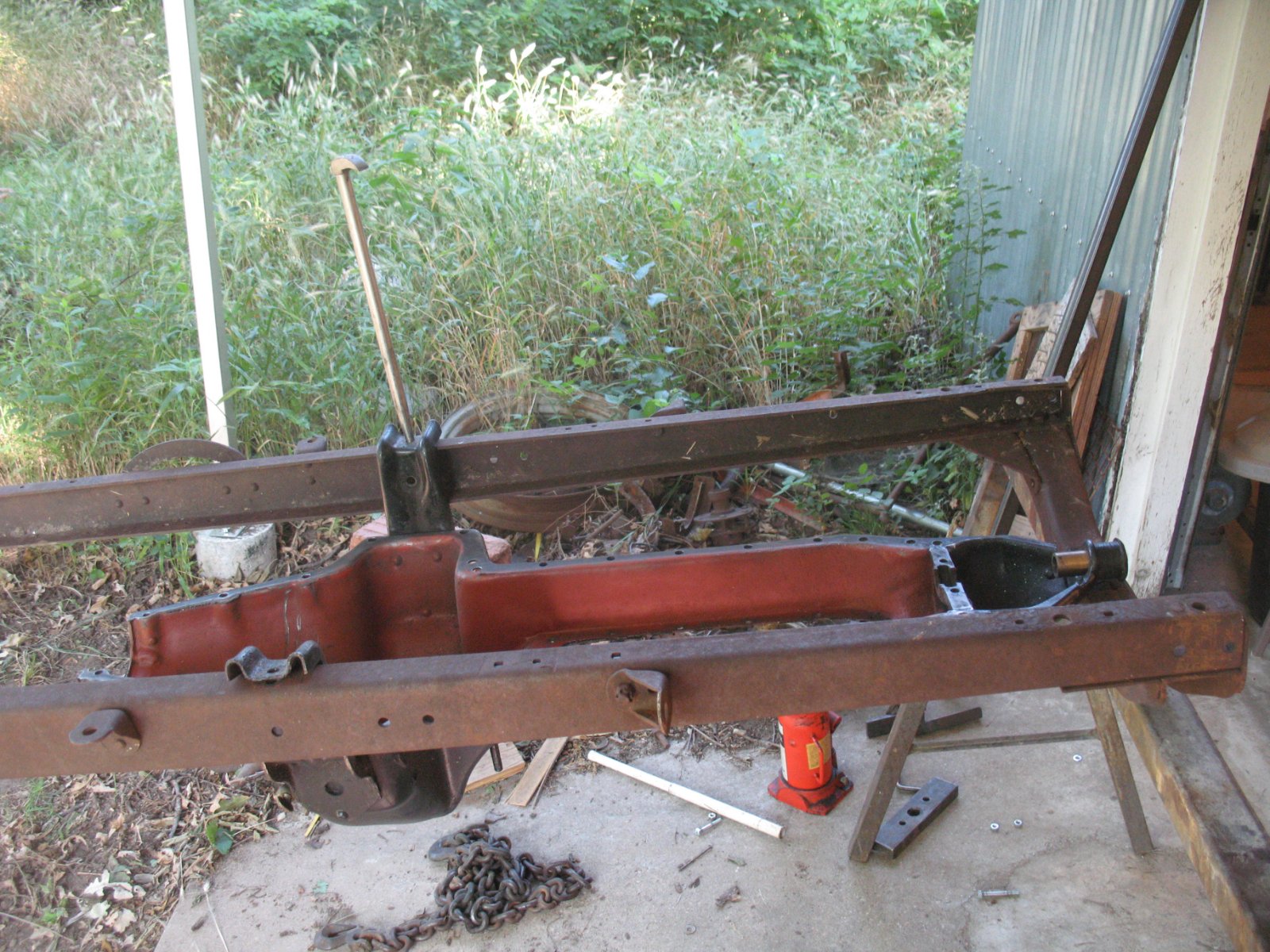

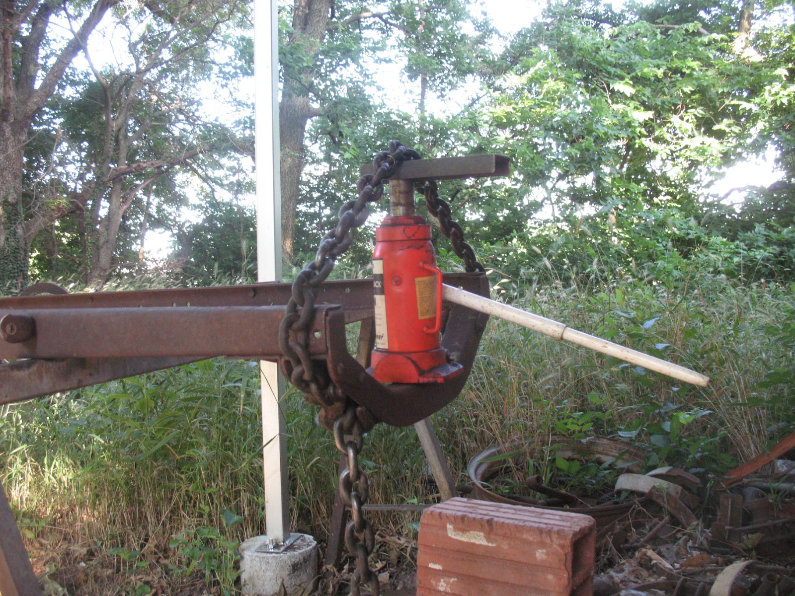

I've spent most of June on other chores, but just did this bit of Model T work. The patient for this treatment was the pan from my 1923 touring.
Before doing the actual job I had to adjust a frame to the correct 211/2".
There were two problems with the pan arms. 1 The holes didn't line up with the frame holes.
2 The ends angled up off the frame rails so much that I had to raise the front of the body to get the engine out of the car.
It would be pretty tough getting a bolt through that.
Apply pressure with clamps and heat to orange.
- Posts: 7397
Heat to orange, line up holes, let it cool.
Sitting much flatter, hole lined up.
Ditto on this one.
Ditto on this one.

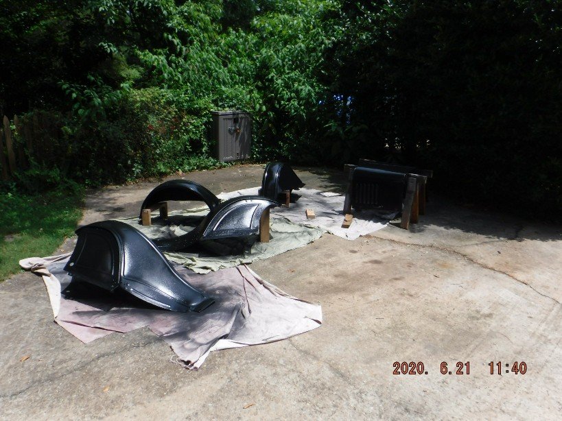

June has been a good month to get allot done. I have jacked up the body, removed and painted the fenders then reinstalled. Painting betwen storms was a bit tricky but i managed it. I have also come to think I will paint a chalkboard on all my vehicles, it makes it easy to keep track of what need to be done so I don't forget.

When I finished restoring our 15 runabout in April, the one thing that I wasn't happy with was the anemic chirp that came the reproduction reed. Well yesterday the local Flatland T's club had a workday at Gary Paulsen's place to work on an upcoming T display at the local museum. I mentioned my horn reed situation to Gary, who shortly afterward brought me a box of vintage reeds for me to find a better one.
After I got home I swapped out the reed and wow, what a difference. It now sounds like I have a large Canada goose trapped under the hood! I didn't know how nice and loud that horn should really sound. It is great that we have people in the T community who are willing to share their knowledge or parts on occasion with a fellow T owner.
For those that don't have a bulb horn on their T's, the reed goes in the straight tube just below the bulb. Also shown in the picture is an aftermarket steering column brace that I added. Our 21 touring has one, and before I added this to the 15, you could tell a difference in how solid the column feels. Like a transmission screen and outside oil line, I think that this is one of those aftermarket items that's worth having.

Reinstalled front and rear axles along with wheels and tires. All rebuilt. A huge thank you to Andy Loso! He did all of the rebuilding.
Wheels are from Stutzman's. I'm only the reinstallerr![attachment=1]IMG_20200628_155527.jpg

Michael, what is it? The car looks like 1915, but the front plate is 1916.

Good eye Mr Jelf! You are correct. I just haven't got around to fixing that. I'm hoping I can trade my '16 plate for a '15.

Being a new owner I look forward to driving my Manchester built 1921 TT with some trepidation! Today was no exception. I have owned the truck since October 2019 and have only driven it 3 times.
Covid19 "lockdown " has been spent changing the colour from a garish red and white to a more sombre green but, the wheels remain red. There have been many other jobs to do as old vehicles often have. Today however was a special day. I have found out that it was registered to use on the highway for the first time 99 years ago 29th of June 1921.The old girl didn't let me down!

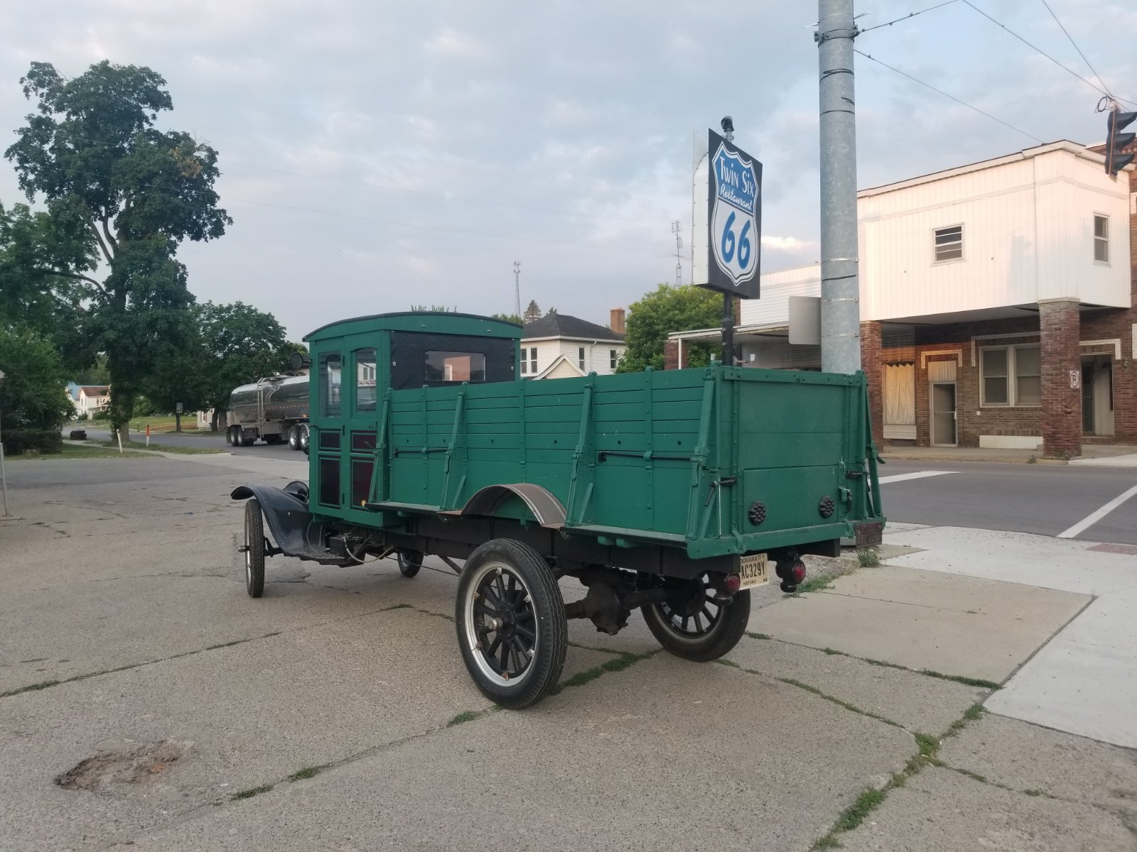

It wont let you down if you dont let it down. Very nice and I like the green.

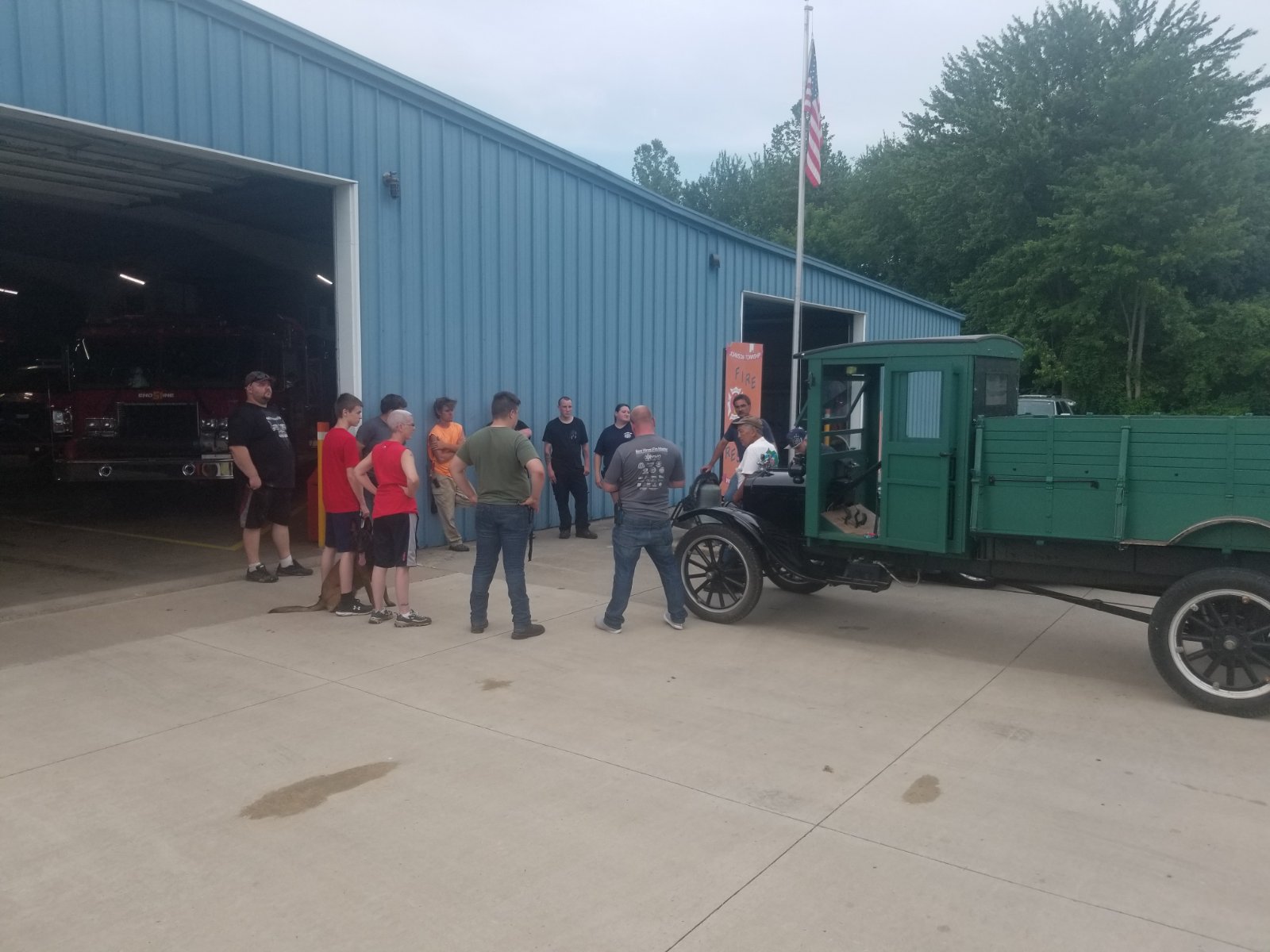

Like tonight. I drove to the firehouse for our work night.

Ended the month blasting an oil pan and a pair of engine pans.
