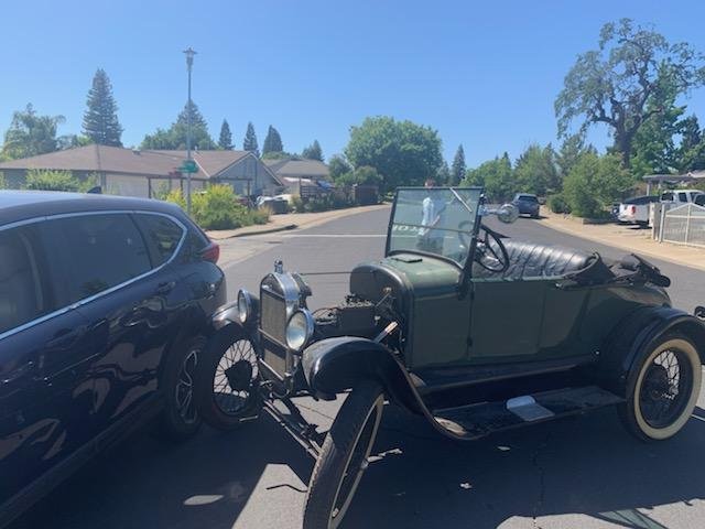

I was hit by a distracted driver. Serious fender and front end damage. Possible frame damage. Is there someone near Sacramento that does good body and fender repair. Be great if they did chassis repair too.

Kind of a weird picture. Can’t tell who was coming or going. What actually happened?

Could you explain how that happened or have some other pictures such as damage to the other car? From the angle of the picture, it looks like the damage is on the wrong side of the car. And I don't see any damage to the other car. If you were coming out of a driveway, the court is likely to say you are responsible, but if you were going straight and the other swerved into your lane, it would be the other driver's fault. Did your car spin around so that it looks different in the picture than it really was? And lastly, is the other car in the picture the one with which you collided?

Sad to see what happened to your car, but at least the people were not injured.

The crossmember is probably bent forward on one side and bent to the rear on the other. Damage looks the same as my buddy's 26 Im working on. His was restored and new interior but the suspension was left wrecked. He purchased it that way not knowing what was wrong with the car. It sounds like you have a knowledgeable person giving an estimate. Hope it all works out for you and glad nobody was injured.

Norm, the accident happened at a residential intersection. The intersection was shaped like a T. The other driver and I were approaching each other at the intersection from each side of the T top. She had a stop sign, I didn't. She came to a stop as I was turning left to the stem of the T in front of her. I had just started the turn when she accelerated from the stop sign and hit me. I stopped my car about 1/3 of the way into the turn thinking she would either stop herself or a go around me. No such luck. She didn't even see me. Hard as it is to believe, that's the way it happened. She stated she was looking at some landscaping but I distinctly remember seeing her looking straight ahead. I suspect she was lost in thought and oblivious to her surroundings.
The injustice of it is, having a modern car, she can simply deliver her car to any body shop and have it repaired. I've yet to find a repair shop that can correct chassis damage to a Model T. Even the classic car restoration shops don't offer that service.
That being said, Erik Barrett in Auburn has offered to repair it. Thank you Erik
The other part that is disturbing is I have spent 1 1/2 years working on this car and just completed a 100 percent mechanical restoration. Cosmetically the car was excellent when I purchased it, but the mechanics were a mess. Its the longest restoration I've ever done and I've done a few. When the accident occurred I was in the final stages of carburetor adjustment and on a test run.

.... I stopped my car about 1/3 of the way into the turn thinking she would either stop herself or a go around me. No such luck. She didn't even see me....
So if you hadn't stopped she would have hit you broadside, likely that would have caused the T to tip over on top of you. Mention that to your insurance agency.

Scary thought. You see from the photos how far she turned me after the collision.

Sorry to hear about your accident , glad you weren't hurt. As for the fenders you can buy new ones for around $550 via most of the Model T suppliers listed in Model T suppliers. I bought two for my 26 Tudor from Snyder's a few years ago and they needed some minor adjustments.

From the looks of that fender? Unless it was already in poor shape with lots of welds and too much filler, it should be an easy repair. About a day bolted to something solid (the frame?) and a come-along rigged in just the right direction. Pulling it back slowly while relieving stresses using the usual hammers and dolly blocks, should have it ninety percent straightened. Finishing and painting would take longer than making it look decent, but one would have to do all that with any used fender one would choose to use. I have straightened fenders oh-so-very much worse than that a few times.
Just a thought to consider? If I recall correctly? About two years ago, Phil Lawrence had a really nice frame for sale at the Auburn swap meet. I "think" it was a '26/'27 (I could be wrong?) and I know it did not sell at the meet. He wanted good money for it, however all the hard work was done, checked, straightened, running board brackets included, sand blasted and ready for paint.
If the other driver had a stop sign, and you did not? Legally (I am NOT a lawyer!!!!!) she would be one hundred percent at fault. However, it has been quite awhile since Califunny has followed its own laws.
