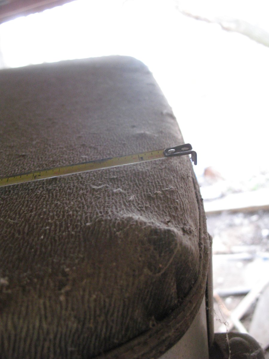

Posts: 7398
Re: Fordor Roof Dimensions Needed
Post by Steve Jelf » Wed Feb 13, 2019 10:56 am
OK, here's what I found on the 23.
I put the end of the tape even with the edge.
At the front hinges.
Between the doors.
At the rear hinges.
At the rear corner.
Post by Rich Eagle » Wed Feb 13, 2019 11:02 am
Leave it to Steve to come up with a good, logical way to show dimensions. I do so enjoy seeing the close ups of that original Fordor. We loose something when we make them look purdy.
Post by Kenny Edmondson » Sat Feb 16, 2019 5:16 am
Steve, thanks. That’s what I needed.
