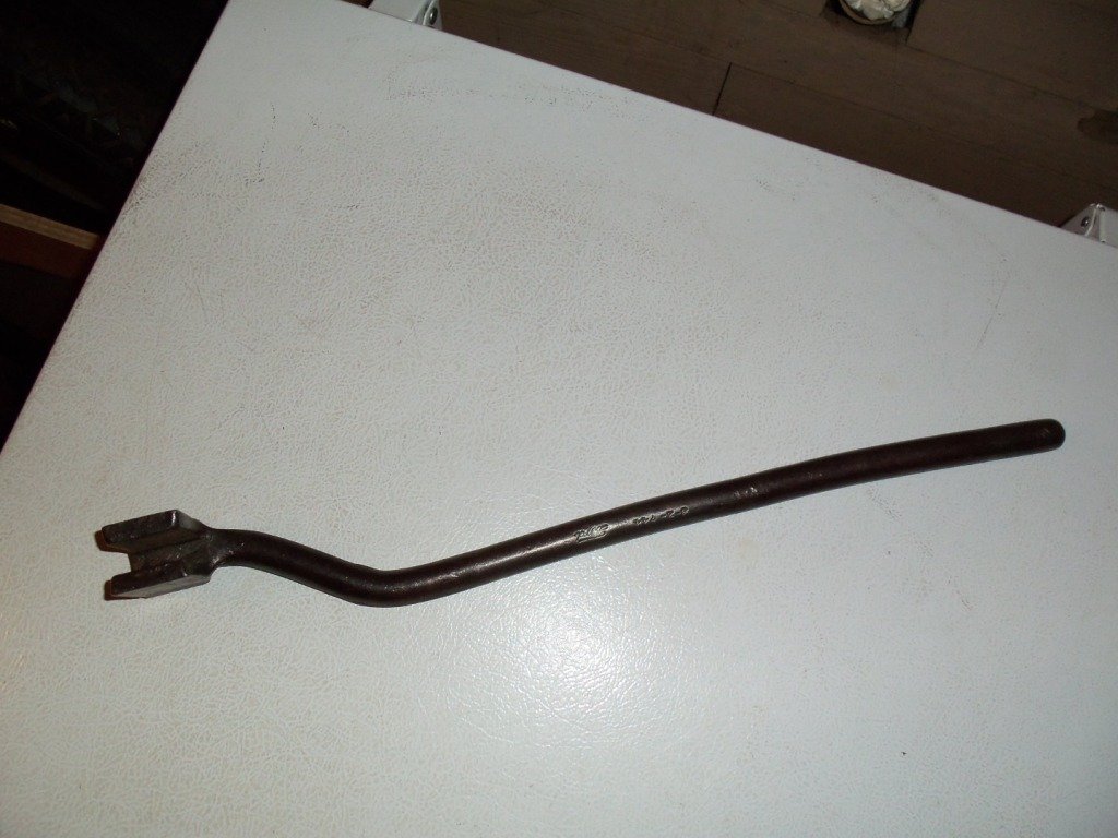

This is a Ford Z tool - it's used to bend the pedals cold and would place your reverse pedal centered between the other two as it should be !
Well, ok, I'll agree with the reverse pedal needing to be contered.

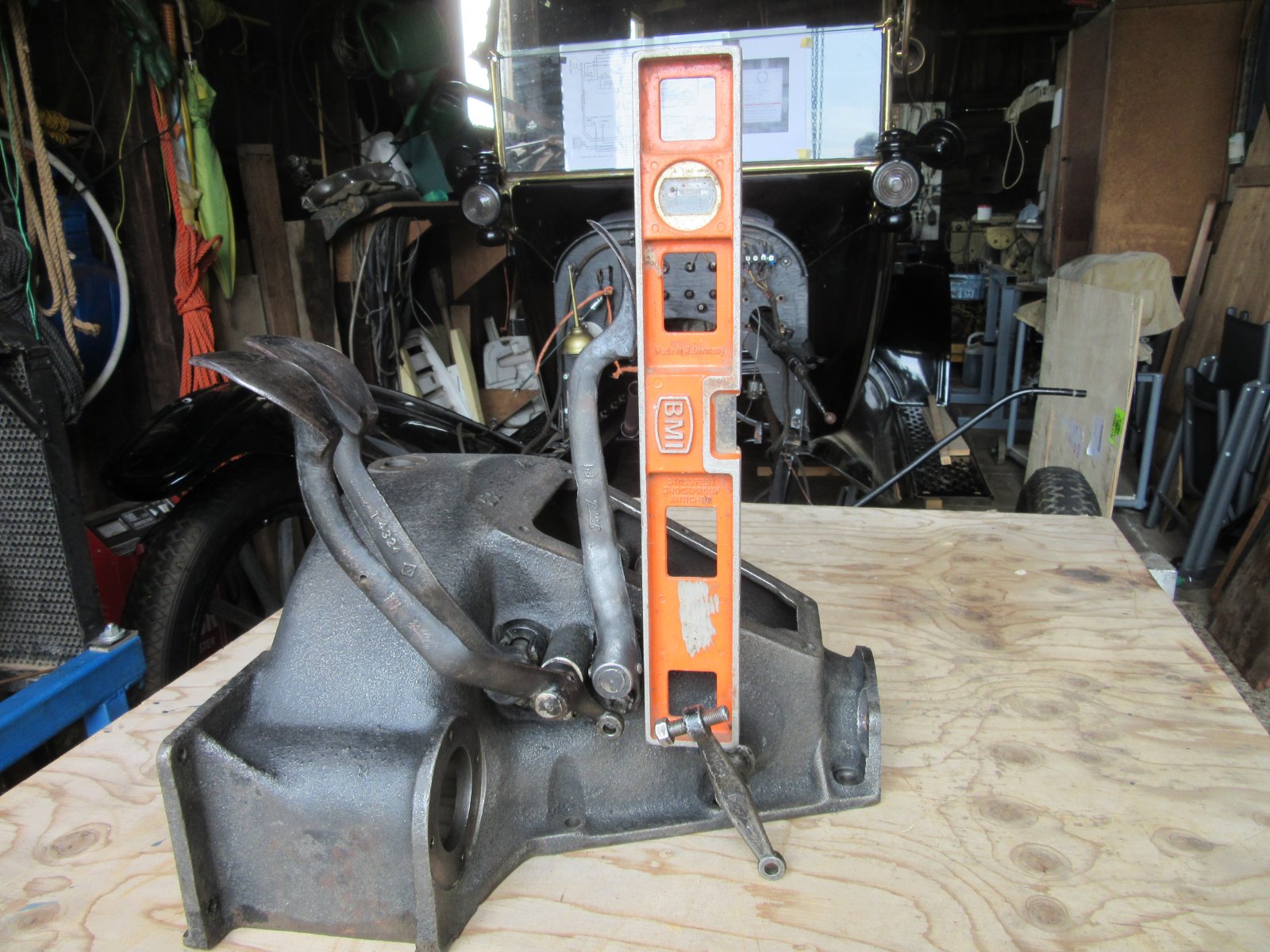

Post by ABoer » Sun Jun 21, 2020 3:59 am
Hi all ;
I bend the brake pedal warm , so he is vertical [picture] .
For the other two I don't have a good measurement till now .
But the reverse is mostly OK .
But first I weld up the Pedal supports # 3436 -3442 .
So there is not any forward movement of the pedals, only sideways .

That’s a great picture. I’m assuming when you say welding up pedal supports, you are welding/building up the 2 cam surfaces and not actually welding the cams to the hogshead!?

Rob , Yes I am building up the 2 surfaces on the cams ,
and also I put some O rings between the cams and Hogs Head

I have done the O ring reaming, but purchased new pedal cams. Was going to try to maybe build up the pedal cams to eliminate slop, but reticent to try to machine/grind down the two surfaces to keep them evenly contacting the hogshead cams.....
