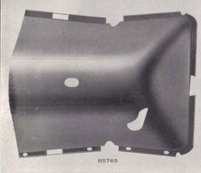

As I prepare to pull the engine on my 1923ish Touring, I've found one of the more difficult things to do has been removing the splash pans.
I have had no love for these things ever since I had to fight with them when removing the Pitman arm from the steering shaft.
My question is: are they really necessary?
Would it be a big mistake to leave them off?

I have planned to put them on my cars for 55 years. :oops:
They can't hurt.

Rich has it right, IMHO. I have a nice pair for each car, but they are in a tub marked with the car name. I like things complete, it’s a mental problem, I know. When I croak, the new caretaker can install them along with the shackles without grease fittings, the original oil fill cap, the original crank pulley, etc etc. Henry didn’t put much lipstick on the pig, and I don’t think the effort would have been worthwhile, if not needed. Most of us don’t have any idea of the roads traveled back then. Deplorable is an understatement. Can you picture an engine compartment filled up with mud, because that’s what it would have been like. Just MHO of course.

My opinion - When Model Ts were new, road conditions of the day made splash pans advisable, especially in mud. Today, when nearly everyone rolls mostly on pavement, not so much. With advancing improvements in the road system, splash pans became vestigial or non-existent on new cars before WW II. I have an idea your flivver may run a little cooler without them, but probably not enough to be a big deal. Splash pans can be great when you drop tools and fasteners though ! :lol:

So far, all of my driving has been on paved roads, so my splash pans are all painted up and sitting in the basement. :)

Henry thought expense worth it so engine pans are on my T’s. Buttoned up for drives!
May help with airflow out the hood louvers too. Completes the engine compartment, otherwise when you lift the hood, the motor is hanging in space, with only the view of ugly pavement below :D

It's all about the cooling... the pans are a PITA but they really do make a difference with the under the hood airflow... I pulled mine off, only to put them back on after my car became a teakettle... on the motometer it went below being permanently at the redline... when I put them back it returned to normal.
Say what you will, but the T was a pretty well engineered car, and were there not a need for those pans they ouwould have dispensed with them. After all - a muddy engine isn't that big of a deal, but an overheated motor is a HUGE deal...

While Ford used a pan on each side of the engine many other manufacturers use a complete belly pan to accomplish the same thing. As far back as the 1900s they were being used. My Maxwell had it's in place when I got it. It was filled with grease, oil, dirt, leaves and bugs. Cleaning it out I found broken windshield glass and a few miscellaneous nuts and bolts. It was kind of a treasure hunt. The greasy mix reached a level where water would float on it leaving a ring of lacy rusted metal. I have restored it and plan to install it on the same schedule as the Ford pans. My White Bus and '07 Buick had them originally but are long gone. Ford pans were high enough I suppose they didn't fill up.

My 1917 REO has a giant belly pan that runs from the front crossmember, under the radiator, back to the transmission frame in the middle of the car. it also has 2 more, that interlock with the belly pan, and close up the sides of the frame, right up to the fenders. They obviously spent a lot of effort making and fitting them.
I think the explanation about keeping the mud out is probably correct. When you look at the photos of early motoring, the roads are below atrocious.

Given the penny pinching design of the Model T, that suggests there's a need for the pans. Ford did not include unnecessary parts. I don't find them particularly awkward to remove and replace, and I'd have to wonder why anyone would constantly need to do so. Besides, if something falls off in the engine compartment when I'm driving, there's a good chance it will still be there when I get home.

When traveling the air in front of the radiator is at a high pressure and the air flow through it can be enhanced by creating a low pressure area in the engine compartment (i.e. Bernoulli Principle). The more air flow through the radiator the more it cools. The splash pans & hood are necessary to make a low pressure compartment and the louvers aid, not only as a method to expel the air but their shape also creates an external low pressure area pulling the air out of the engine compartment. Without them (one or all) air turbulence would result and the low pressure area wouldn't be as effective and the radiator's cooling would not be as efficient. When stopped its up to the fan to create the air flow for the creation of the low pressure zone. Obviously not as much when traveling.
And like in modern cars the hood and splash plans keep water, dirt and mud off the engine and out of filters.

Have them on my '26. No problems with cooling and I do believe it keeps some of the road dust and debris out of the engine compartment.

I use mine. Installing or removing them is a minor inconvenience. As the other guys have said, Ford put them there for a reason.
My reasons:
1 I like to drive on country roads;
2 They often catch the tool or part that I drop so I don't have to crawl underneath trying to find it in the dirt and grass and rocks.
