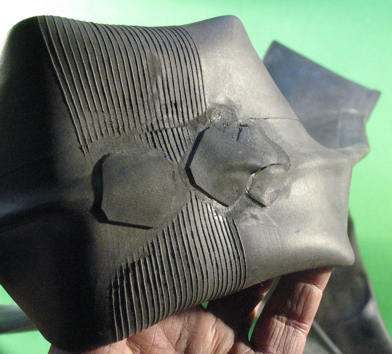

I'm not ready to trust the Indian (Custom Classic) tubes again. According to one of the guys in OZ (Allan I think) there was a run of them folded and packed before they were sufficiently cooled, and they tend to split. Being a slow learner, I patched one seven times before I figured out what was going on. Maybe those are no longer in the supply chain, but until I'm sure of that I'm sticking with the other brands.
Note the patches are all on the fold. Having to patch a split patch should have been a hint.
