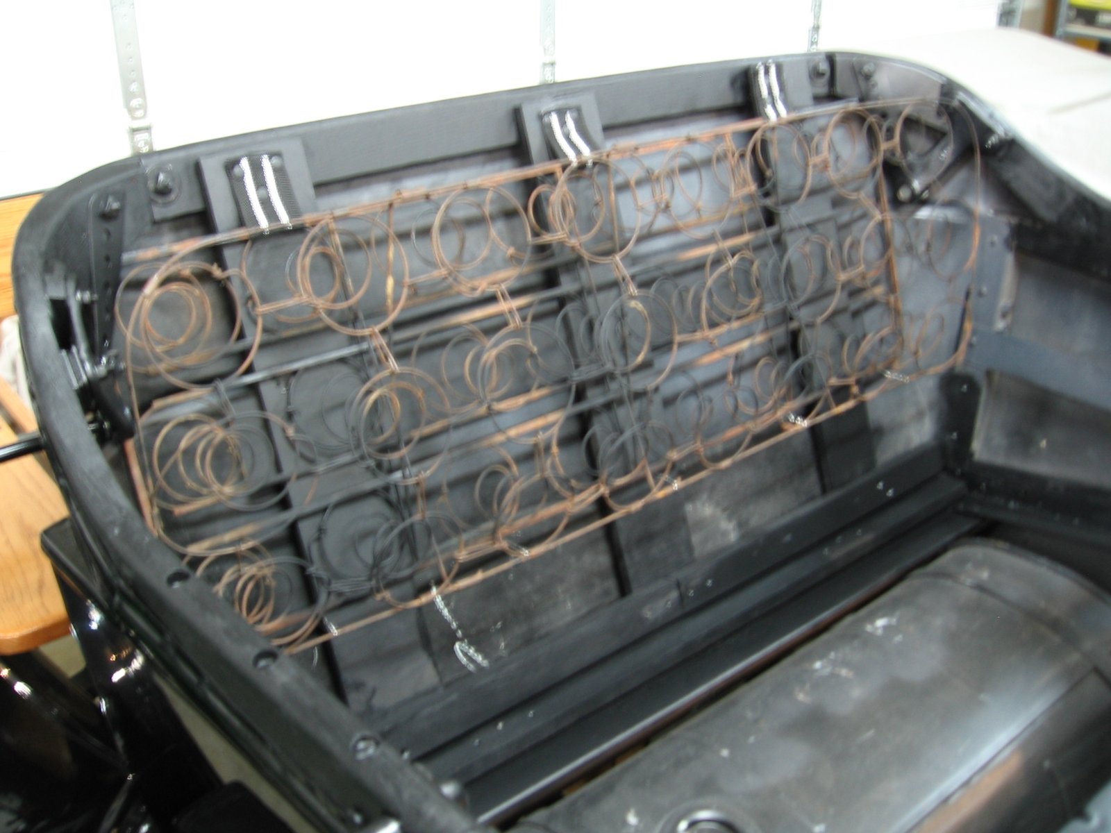

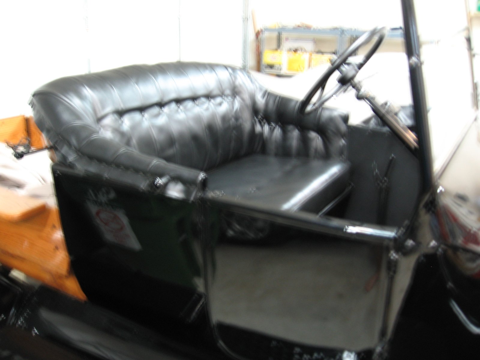

Here are some more pictures from the roadster upholstery and top installation on my 1924 cut-off touring (now a pickup). The car came to me with a Cartouche upholstery kit for a roadster, it fit the front seat of the touring just fine. If it had been up to me, I would have bought a Classtique upholstery kit for the front seat of a touring, it probably would have fit event better. One tip - buy some extra cotton batting to supplement what comes with the kit, it will allow you to add more fullness to the upholstery pleats.
The seat back springs on touring cars just sit on the sheet metal from the factory, but I decided to fabricate up some wood support slats like the roadsters came with.

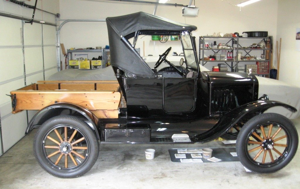

Post by CudaMan » Wed Jul 01, 2020 7:44 pm
Here are a few photos of the finished car with the top complete and custom side curtains (from Classtique) installed. You can see a few wrinkles from having to stretch the top so much at the rear corners to meet the notch in the rear curtain. Still, not bad for a first attempt IMO. :)
