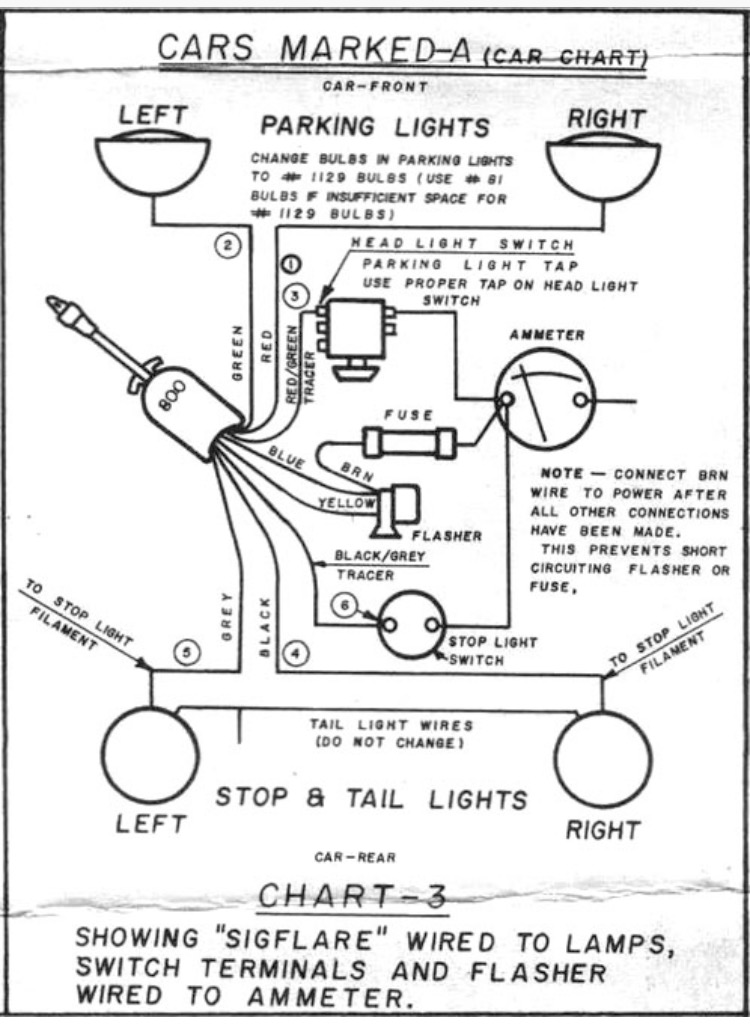

I know there are some electrical whiz kids on this forum - I've read some posts/threads exhibiting impressive electrical knowledge and would sure appreciate some sage electrical troubleshooting advice regarding a problem I'm having getting my turn signals to flash/work correctly. This could apply to any 6 volt car, so I'll try to be brief...
Installed a Signal Stat 800 turn signal switch in my '40 Ford and wired it to work additional add-on bulbs as the signal lamps in front (not the tiny park lamps), and then spliced into the stock tail lights as directed by the wiring diagram. Still 6 volt system using 6v bulbs and a Wagner #535 6v 3 prong flasher. The front bulbs are 6v #209. Brake lights work as they should. I have wired it according to the factory diagram (see below) and have it connected to a "hot all the time" power source. The system works, sort of, but the interval between the pulses is VERY short and the flash rate is VERY rapid - almost quadruple the speed of normal flashers. Consequently, the lamps are not very bright since they are flashing so fast. It's very difficult to see them working in the daytime. Am I missing something somewhere? Is there something in the circuit to check that might be causing high resistance or...? There are no dumb questions at this point. I'm completely stumped!

Some flashers flash rapidly when they are not loaded enough, this is so you can tell that a bulb is burned out. The 209 bulb you are using has a lower CP rating than the 1129 bulb specified in the drawing.
It might just be that the flasher is working like it is supposed to, but not how you want it to work.
Try adding another bulb to the circuit, just to see if it will flash the correct speed with 3 bulbs connected, instead of 2, That will tell you if I'm right...or not.

As Squirrel said, you are probably not drawing enough amperage with the small front bulbs. A 535 is a thermal flasher meaning that it has a bi-metal spring that curls as it heats and pulls away from the contact. The interval between flashes is determined by the time it takes the spring to cool and straighten out. Not enough load means a short cooling period and a quick flash. That is why there is a fast flash when a bulb is out. A quick look on the web shows that various 535 flashers are rated up to 5 amps, or 32 candle power, or up to 4 bulbs, or 50 watts. You said you spliced into the tail lights, probably meant stop lights, as you said it was according to the diagram, but double check since the stop light filament draws higher current. Also make sure that the stop light switch now goes through the turn signal switch and not directly to the lights as it originally did.
Also, if you are still positive ground, make sure that you are switching negative wires, and not running positive current through the switch. I also seem to recall a discussion many years ago about using these turn signal switches on positive ground cars (Model A.) If I remember correctly, there was a problem with the pilot light (the one on the switch that indicates the flashing.) Since the modern switches are made for negative ground but now attached to a positive grounded steering column, the pilot bulb was causing a problem when switched on. When a single pilot is used for both directions, it gets its ground through the filament of the front bulb that is not flashing. I think the solution was to leave the pilot bulb out.

Very informative and helpful observations from everyone, thanks. I will be looking into some of the questionable areas mentioned in my setup to see if I can uncover the culprit. Back later with further developments.
