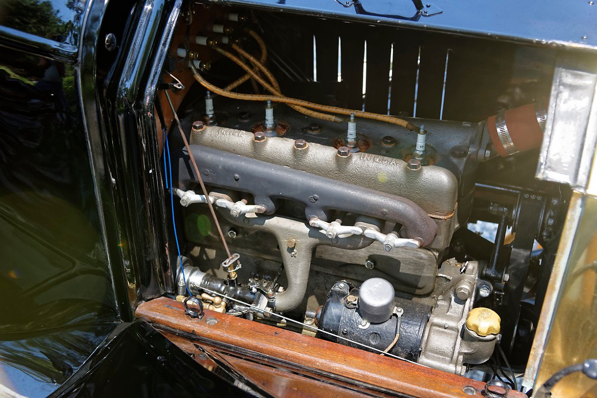

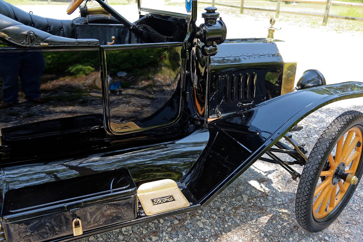

Hey guys,
I inherited my dad's 1916 Touring. I would like some of you to go over the pictures and tell me what's right, what's wrong and anything else you might add.
To begin with it is a 1916 (1222277), I have the original engine in my garage. It currently has a 1924 engine in it for ease of starting. It is 6 volt. I have changed out the spark plugs for modern ones because they all leaked. It runs well. I know I have a hot exhaust valve on number 3. (some may spot the paint coloration) I know the wheels and steering wheel came black from the factory.
There are more pictures on my google drive that have very high resolution. for instance, You can read the K-1 stamp on the speedometer.

The only thing I'm seeing, the front hubs have been up graded to later ones, a change that I would leave as is, they are a stronger hub around the outer bearing.

One item I see is the generator brush cover - the gap where the retaining screw & nut is what should be straddling the cutout post - someone seems to have done a little handy grinding of the band for clearance !

The speedometer drive is "whonky" - it should be loosened up at the pinch point & rotated so the cable attachment point is pointing towards the rear of the car.

Beautiful anatomically correct touring. Only things I can add are super picky: the 4 manifold clamps on the ‘24 engine are the heavier ‘26-‘27 and installed upside down. And someone smarter than me on this Forum said Model T s never had brass top prop nuts. Also, the front top prop nut left side is missing....I said left side-not drivers side-just for you Allan

Should it have man hole Oilers on the tie rod bolts and spindle bolts, steel ones?

The only thing I could find, outside the 24 engine, is a common occurrence. The upholstery nails in the doors are way closer together than is usual. Restorers often do that. The usual gap between them is approximately 2 1/2".

@RajoRacer, Thank you! Should I replace the generator brush cover or is it only a judging thing? I can take a closeup of the speedometer gears and maybe you could annotate to show me what to do.
@George House, I can reinstall the manifold clamps right side up. I think the 'brass' top prop nuts are actually painted. We're talking about the nut on the top rod anchor point just above and behind the rear door upper hinge?

@Model T Mark, Steel oilers are all I find on Lang's.

A lovely car, mostly correct as far as I can see. Exceptions are the "natural" wheels you noted, mostly a modern fad*, the step plates, and the modern hose clamps.
No manhole oilers are being made as far as I know, so my 1915 wears the brass twist oilers on the shackles and the "modern" flip tops elsewhere.
*All Ford wheels came from the factory painted body color until 1925 when varnished "natural" wheels became an option. I believe very few people ordered that option. Other than advertising, how many period photos show Fords actually wearing "natural" wheels? Mighty few, if any.

Jeff, the manifold clamps are on the correct way round for 1924, but they are 1925-7 items. The foot which rests on the manifolds is flat on each side, so the clamp can be installed either way, allowing the dealers to stock just the one part for any T. On the later cars, the manifold studs were shortened, [to save a cent or two?] and the new style clamps were installed In the opposite orientation to those on your car. These shorter studs had a rolled in ridge, up to which the studs were inserted in the block.

Personally, I would not worry too much about anything on the engine as long as it is working well and safe. A wrong engine is a wrong engine. The wrong manifold clamps work fine either direction, and as long as the generator cover keeps most dirt and rocks out,? No big deal.
Generally, I think cars should have engines as close to correct as is reasonably possible. If the original engine is a viable option, it should be using it. But that can come later. Part of the problem is, that once the car and engine become separated, they tend to lose each other. It is easy enough to add the parts necessary to add a starter onto a pre-starter engine. The pan/lower crankcase is not so important. Later ones are stronger than the early narrow nose pans, and the difference isn't critical (although many people including me can spot them easily). Basically, the flywheel for the starter gear, the hogshead to hold the starter, and a battery added somewhere along with cabling and a high current switch and you are good to go. The earlier engine block with all its differences and the low head (your car is on the edge of whether it should have the early low or later high head), the most important pieces, can remain in use with the car. Model Ts do not use a lot of battery power. Many people over the years have toured with model Ts for many years by simply using a trickle charger to top off the battery every couple hundred miles. If the car runs well on its original timer and coils ignition, and the battery does go dead, one can still start and run the car to finish the day. Lights can either be setup to run on on the battery, or the magneto, and there is a way to setup the magneto to charge the battery if one is concerned about battery power.
Overall, that is a fine looking model T! Probably better than most. You should be able to get a lot of enjoyment from it without many changes. Be forewarned, model Ts can sometimes kick their caretakers where it hurts. They do break down, sometimes leave one stranded. In return, they can give their caretakers a personal connection to history, and culture, most people will never be able to know. They can be challenging. But they give people a sense of accomplishment most people never find. The journey becomes more important than the destination. Model T clubs that tour a lot have a way of showing you things in your own neighborhood that you didn't know existed. One of the best hobbies ever.

Wow, what a beautiful car. The only thing I can see looking specifically at the two front wheel photos, and it may be the camera angle or my 78 year old eyes, is the lack of caster. If you are driving this car at speeds above 15 MPH, then all is well, if not there is a chance that the axle is in backwards or the spring perches are on the wrong side. I saw this once before on a 1913 Hershey show winner after the owner quietly told me that he couldn't handle the car at speeds above 10 MPH. Anyway lets hope it's the camera angle or my bad eyesight.

It might be due to the wheels being turned to the left. It handles quite well at 35. So, I suppose it's OK.
