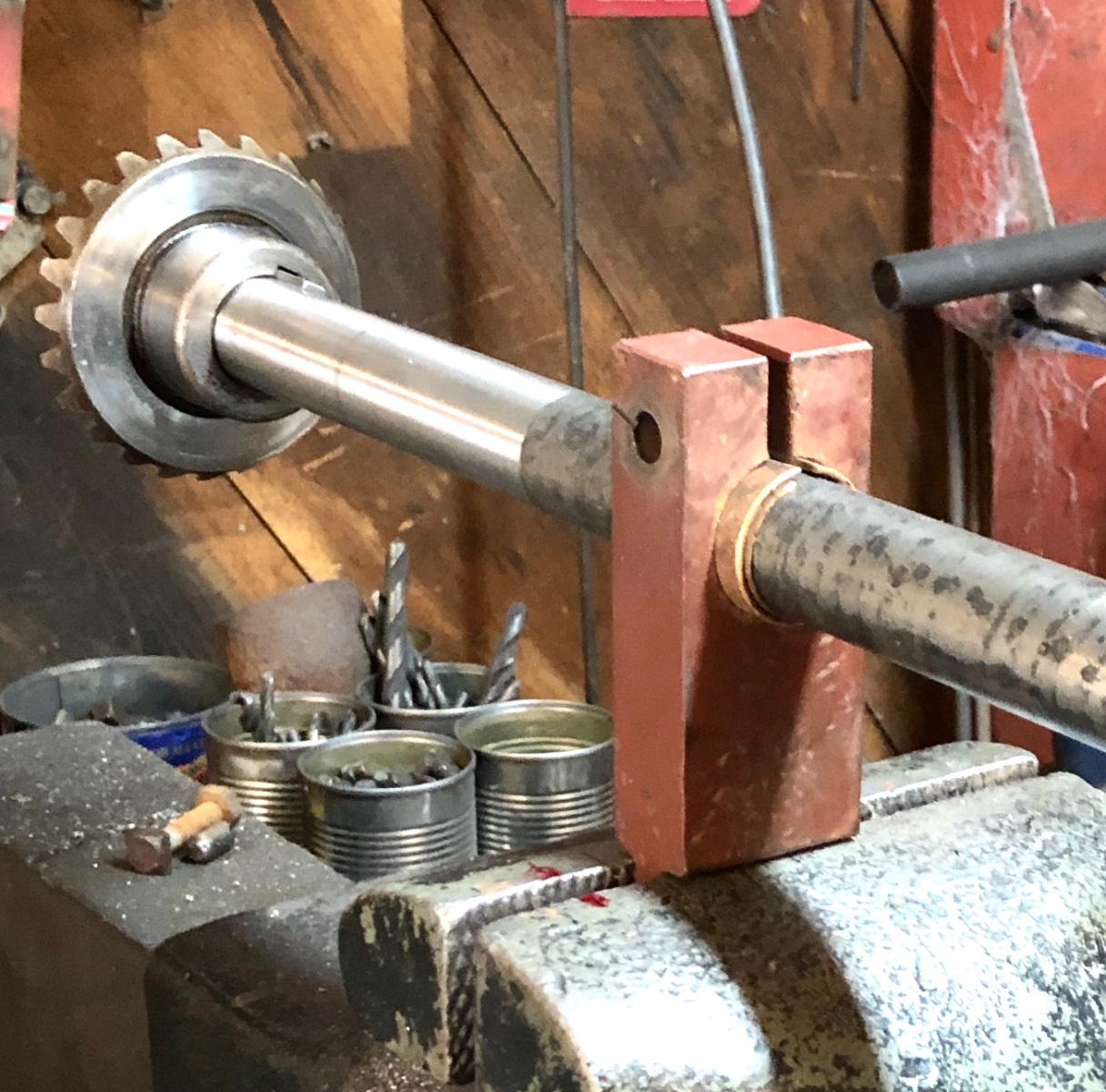

- Posts: 3813
- * REQUIRED* Type and Year of Model Ts owned: ‘12 open express,'23 cutoff, '27 touring
Re: Pressing rear axle gear out...
Pressing off the gear is two steps, but goes pretty well with press and fixtures.
Now putting on the gear on the new axle, without harming the taper end is the plan.
More than one way to skin that cat.
First try was to use a Model A hub for support to the taper, which was greased, and the Model A hub since it is different size would allow easy release. But the long shaft was hard to hold upright to get a good start onto the gear.
So did a switch and improvised a beefy split- clamp to secure the shaft higher up, with the clamp resting on the press bridge. That worked really well to get the gear on and down.....but...
just a little way. (note in photo you can still see 1/2 of the key exposed).
Seems when we added some WD-40 to the gear, that slippery lube ran down the shaft and made our makeshift shim stack of brass in the clamp slip, so wouldn't hold the axle up.
But easy fix, wiped clean with lacquer thinner, and added a longer grade 8 bolt to the hole in the split- clamp, and tightened that up firm on the new axle shaft. That did the trick! This improvised split-clamp held amazing, and back on the press the gear was fully pushed down to expose the key groove.
Improvised split-clamp holding fixture on axle shaft

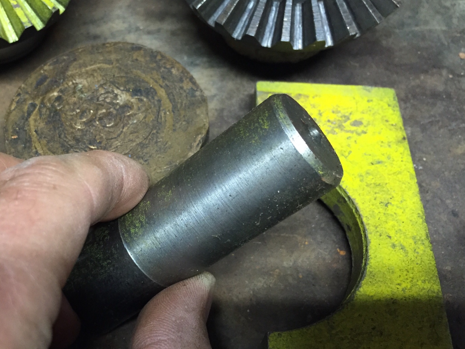

I used a model A hub with an axle shim to hold the taper to press it. I made a hollow spacer to fit inside teeth.
